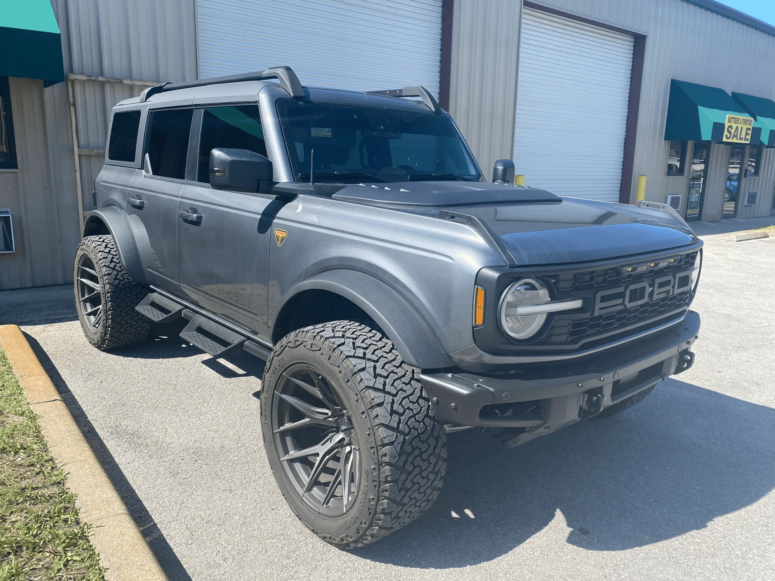

2022 Bronco Wildtrak
3” Icon Spacer Lift
Home made 3” body lift (zone blocks/ranger bolts)
RC tie rod sleeves & bushings
RTX Moab 17x9 0 offset wheels
Nitto Trail Grappler 40x13.50R17
Cost: $1600 w/o tires
Initial thoughts:
-I used the BB premise to relocate front bumper, IMO it doesn’t give it a clean look, too much gap between bumper and grille.
-rear crash bars brackets appear to be ok for regular driving (I’m going to chop them just haven’t yet)
-front crash brackets gotta go, I chopped mine but will probably order JKS max tire kit as chopping the front brackets is ugly due to their design
-going to have to trim front plastic “skid plate” as tire rub @ 24 degrees according to dash. Not sure what that means for the fancier skid plate options
-I thought it would be a complete dog on 40s. The 2.7 w/4.7 gears seems to be adequate for everyday driving. Your not going to win any races or get awards for fuel economy but adequate for DDing. Will hold 10th @ 65mph even in moderately stiff wind. I thought I’d be cruising around in 9th or even 8th on the highway.
Hot damn, that looks sweet! Am I wrong in thinking that you have a 6" total lift?

It is 6” of total lift. A moderator or someone changed the title.
I was curious because I have a 3" Zone spacer lift and just put 37's on and I think it looks like could easily go bigger! Just not sure how much?
