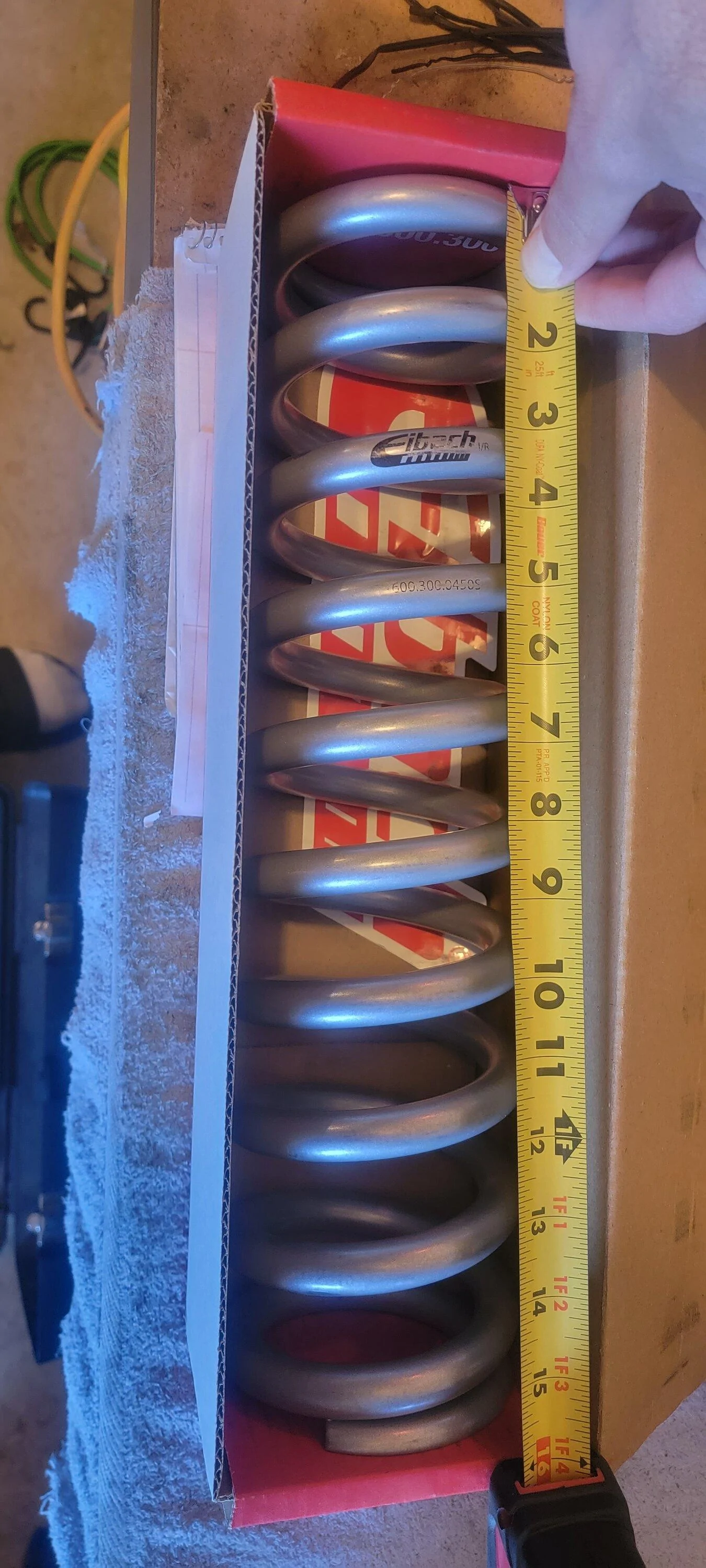

Eibach lists the spring rate on the front coil. Eibachs come with linear 16x450# coils on the front Pro-Truck 2.0 Adjustable Coilovers. Here is a photo of the coil that comes on the Eibach Coilovers.
Ford Bronco Bilstein 6100 vs OEM Kits 20230205_101519

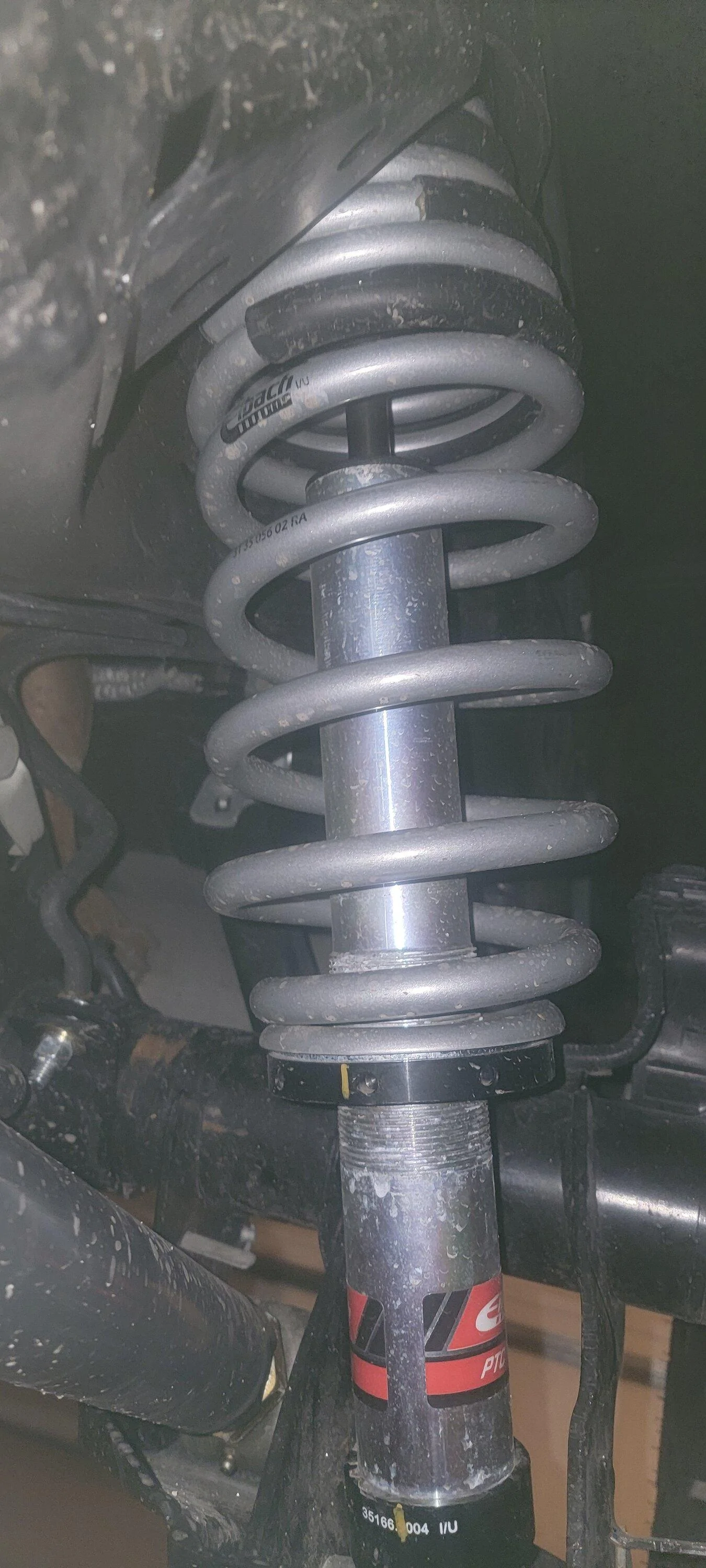

I replaced the fronts with the "heavy" coils. The "heavy" coils are 16x550#. I don't have a good photo showing the "heavy" coils as they are on my Bronco.
The rears are progressive so no weight listed and Eibach currently doesn't make a "heavy" rear coil. I'm hoping Eibach will release a "heavy" rear coil in the future to compete with Bilstein and OME. Here is a Photo of the rears on my Bronco.
