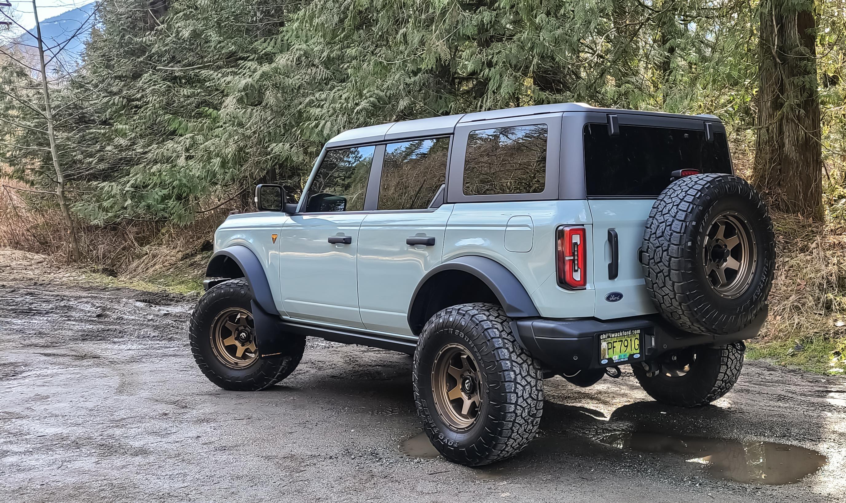

6100's on my Badlands 2.7, non Sas on 35's! You may lose half in lift up front tho... Front and rear set to perch setting 5, highest setting. Mine still has a little rake. Maybe the front badlands springs are a bit softer? Either way they work and perform great!

Looks great. Maybe they settled a bit. The fronts are 2.6 inches right at 5? What was total lift in front once installed? Would have thought the kit levels you out pretty good.
