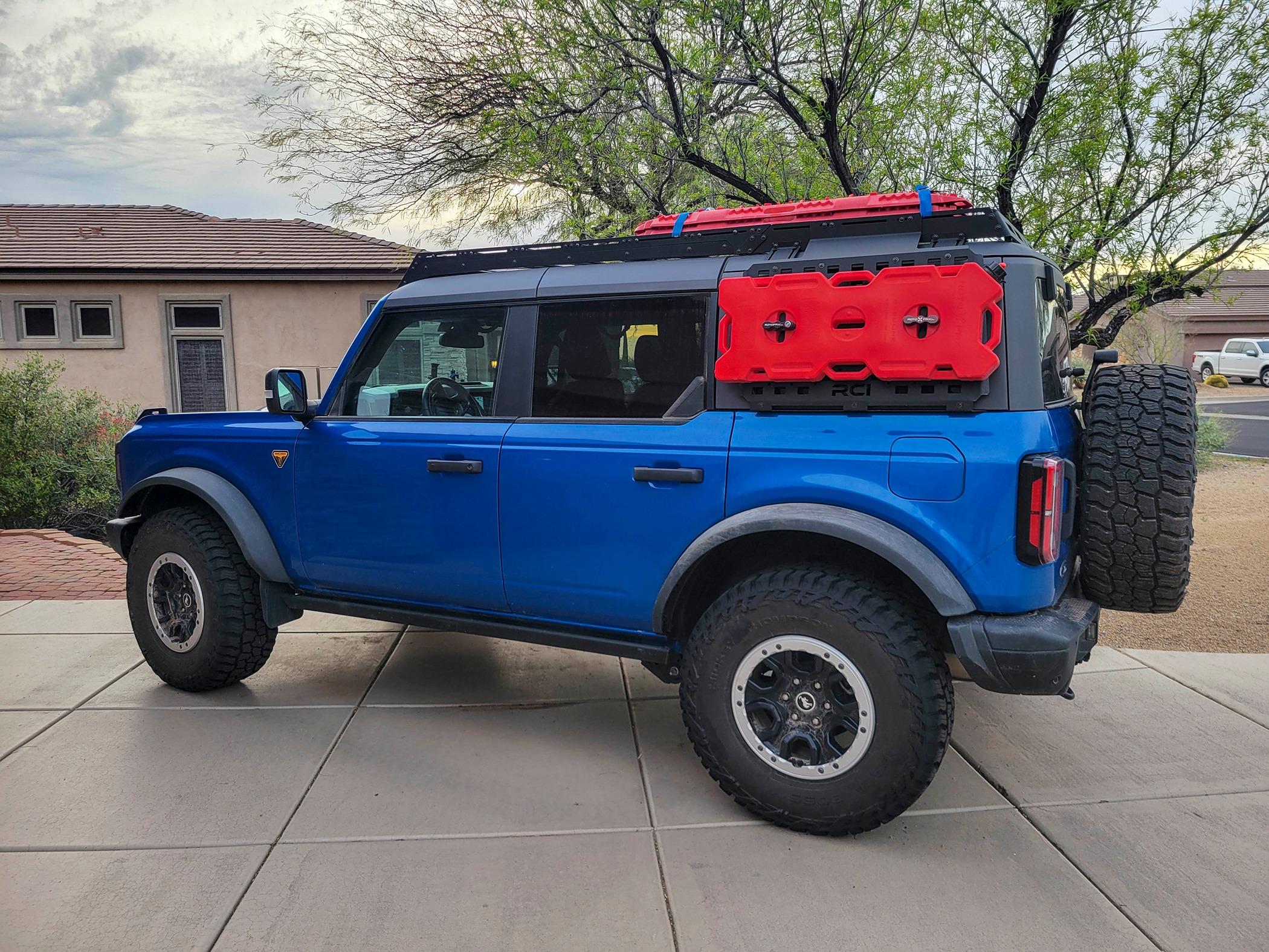

Anyone hear if the Eibach heavier rear springs have made it to market? Been almost a year since there was activity on this thread and I'm hoping Eibach released it during this time. I don't really see it on their website?
I'm deep into an overlanding build and have added a lot of rear weight losing 1.5" from stock ride height on a BL SAS 2.6 4 door on 35's. Rear is now 1/2" lower than the stock front, but I'm about to add an aftermarket bumper and winch which will get it close to leveled it out, or more likely with a front end slightly down rake. Problem is .... I need more clearance under the rig. I'm banging up the cross members on each side of the transfer case. They sit pretty low now (10.75" ground clearance now without aftermarket front bumper and winch). So, I need to at least get back to stock ride height +0.5" to 1" or so to go where I used to go with my Rubicon on 35's. I'd prefer to stay with 35's, rather than go to 37's, but I'm not hard over on that. I might add aftermarket upper control arms anyway to allow a bit more articulation.
I'm open to other thoughts on how to accomplish this build goal. The Eibach's are really attractive for performance and price for an overlanding build, and ride height adjustability without removing the coil overs is a HUGE plus. It's hard to imagine getting the ride height and rake perfect on the first shot, and removing the coil overs to adjust is a huge PIA.

Really good point on a small puck in the back. I have no doubt that the Eibach adjustability will allow me to level it out. I just want it leveled (well ... with a small forward rake) with a bit more ground clearance than the stock SAS. A lot of feedback I've read here from Eibach customers is that you don't get the amount of lift they advertise. Perhaps that's because of vehicle weight? I know in my case, I'd never get what they advertise, but getting some lift above stock would be terrific. If it's touch and go, then going to 37's would grab an inch.

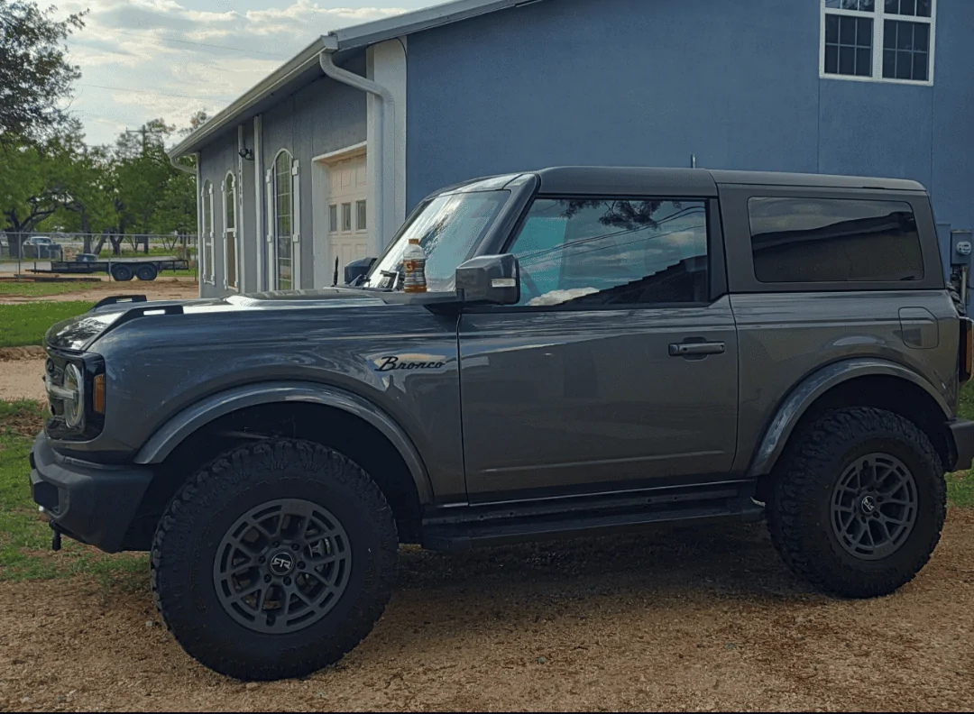

Personally I am trying to still decide whether I am going to 35's or 37's, but this is my OBX on 33.5" tires and non-sasquatch Bilstein's. As far as weight, my Bronco started off at 4416 pounds as delivered, probably closer to 4750 now.
Ford Bronco Bilstein 6100 vs OEM Kits Screenshot_20240312-101114
Ford Bronco Bilstein 6100 vs OEM Kits IMG_20221006_185615
I am pretty sure that can already run 35's as is, I have a ton of room under there. I have the Eibach's and a 2" body lift waiting at home to be installed, but life is on hold until my father gets out of the hospital.
That's one beautiful rig! I like the carb grey on black. Nice subtle accents. Hidden winch is tucked in there nicely too. Such a clean look! I hope your Dad improves soon. Mine passed away last year just before I got my Bronco :(
mpeugeot
May 14, 2021
9,147
18,936
Sorry to hear that, my dad is a fan of all vehicles, but hasn't been in the Bronco yet. As far as the look, exactly what I was going for, highway stealth. I typically act the fool behind the wheel - this combination keeps me off the radar in more ways than one.
