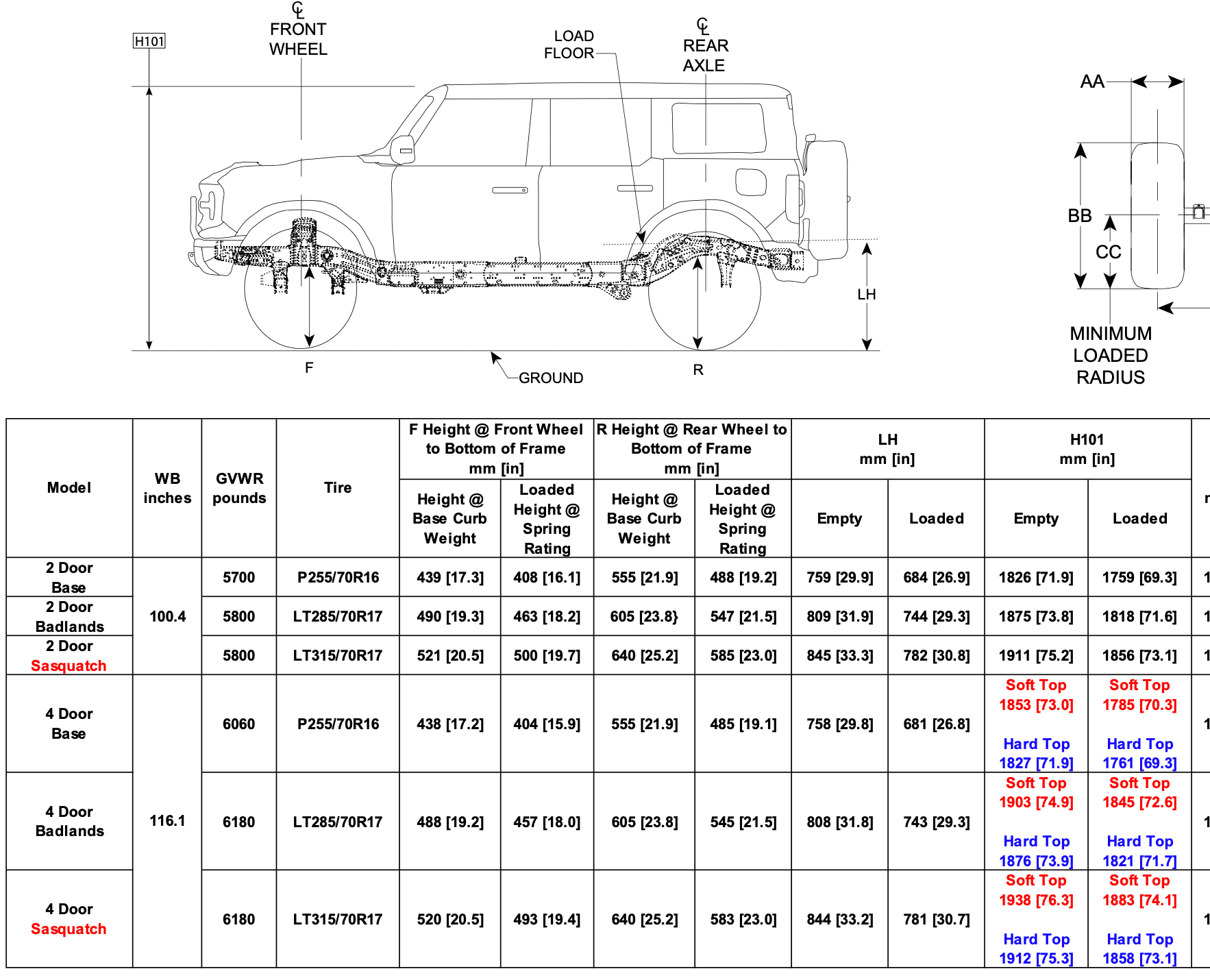

How tall is BD with MIC top ? Only see height with soft top online. Thanks

I don’t see stock black diamond on here ?
A 4 Door Black Diamond with hard top empty Height:
-Without SAS you'll be a touch over 71.9"
-With SAS you'll be at 75.3"

Thanks. Didn’t see it there. So 6 feet. Empty. Thought it would be a touch bigger than that.
