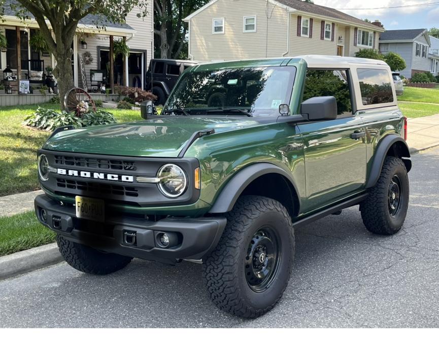

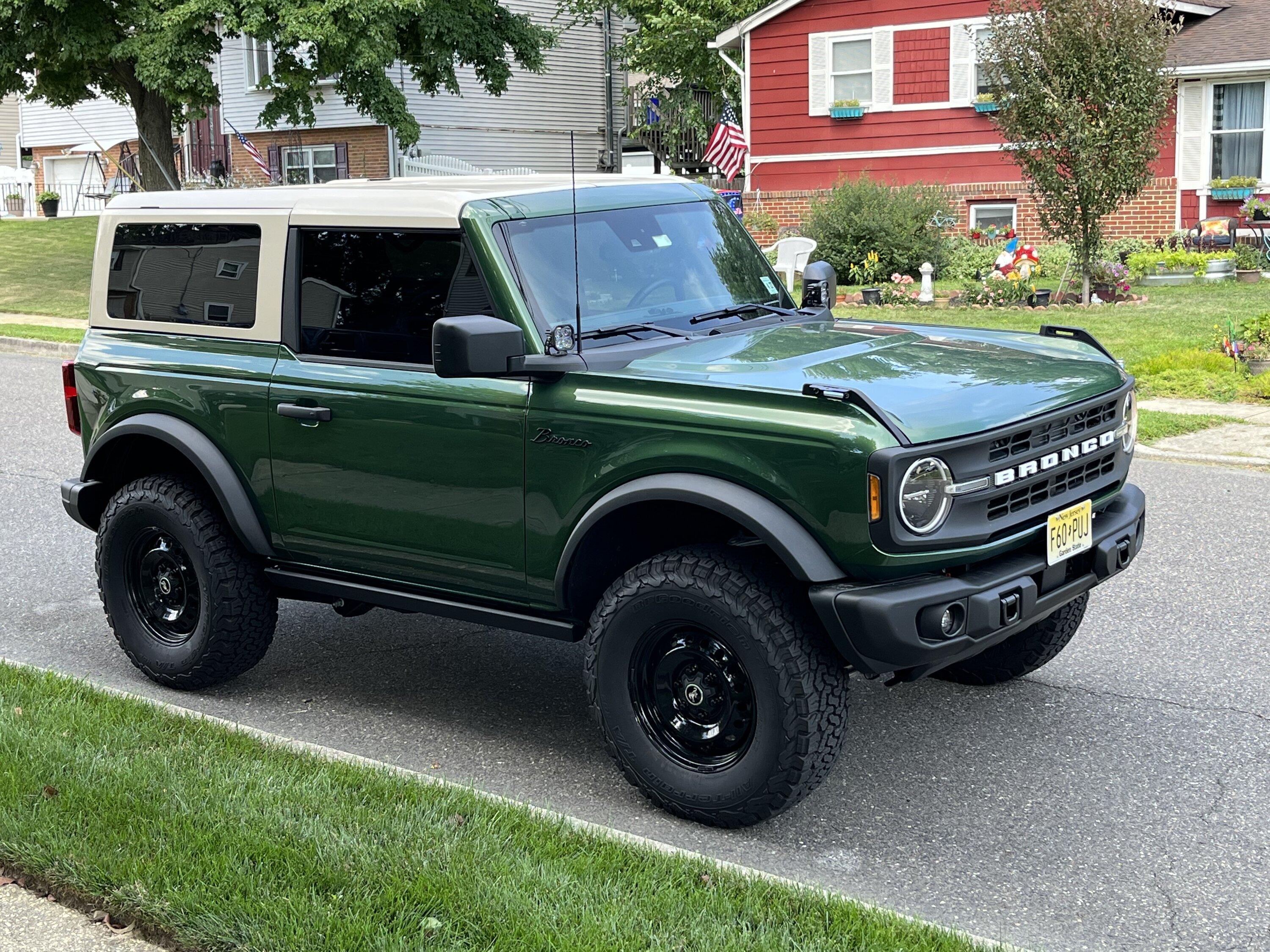

Looks great. Hailstorm was brutal. Think they fixed 36 dings. I considered going the painted wheel route too. Couldn’t find a wheel I really liked. Almost pulled the trigger on a set of method 301 polished. They were 0 offset and I wasn’t sure how the poke would be on standard flares
Do not change from the steel wheels…….paint or powder coat if you wish, but those wheels look killer on these rigs.
I just got a set for my Badlands 4dr that’s are currently at the powdercoater…..khaki tan.
I love the 2” lift too.

I’m digging them more and more as the days roll on. As much as I’d like a little poke and wider stance I don’t want to go Sasquatch flares. I lived with 2” of poke on my F-150. Every trail water hole washed the side with mud and stones. I can’t deal with trail wash and paint chips on the bronco. These look great. Wider and taller than the stock 31”. Thinking it stays like this 👍🏼

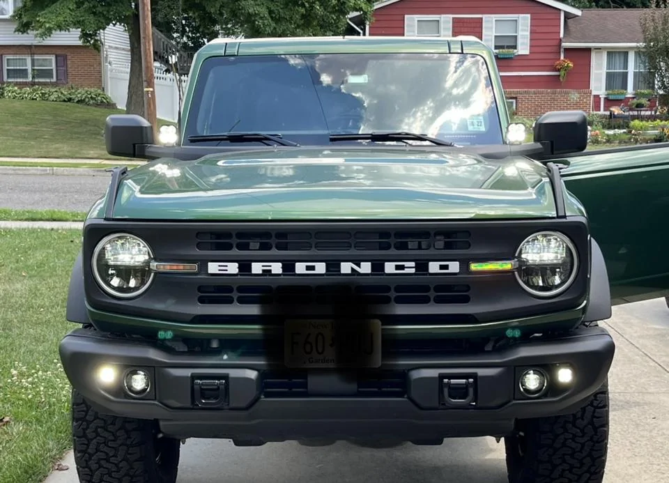

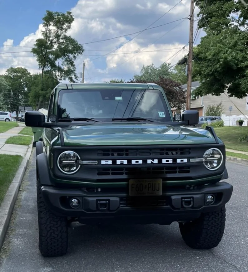

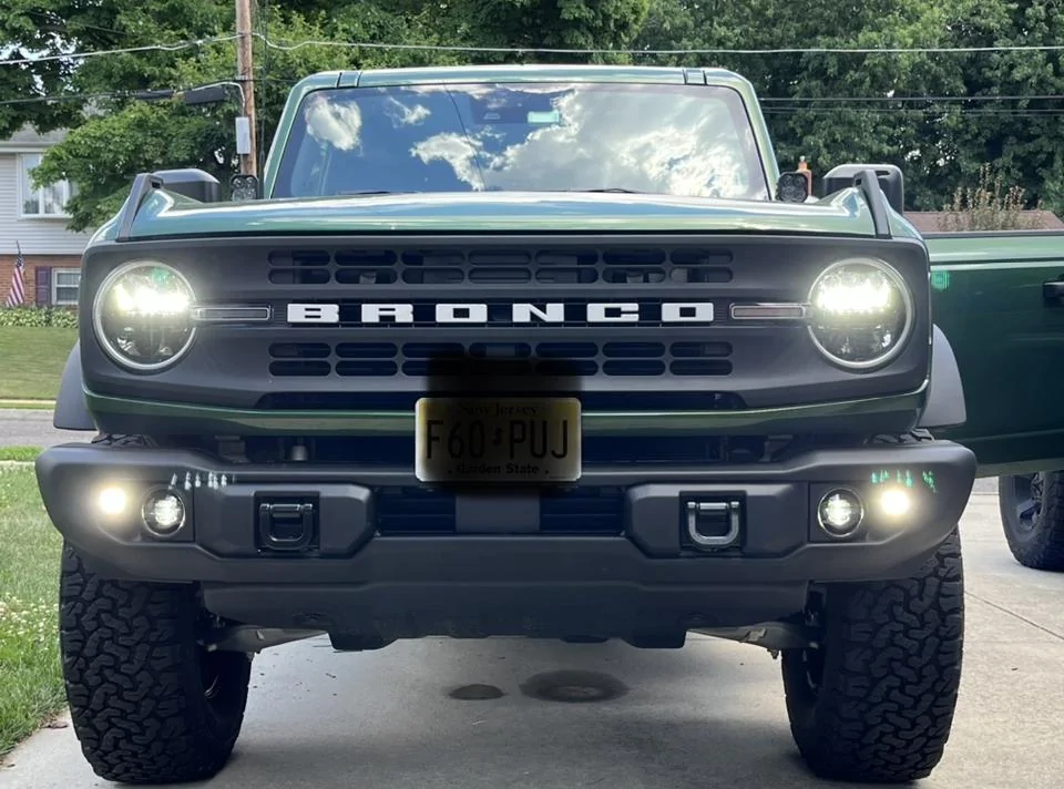

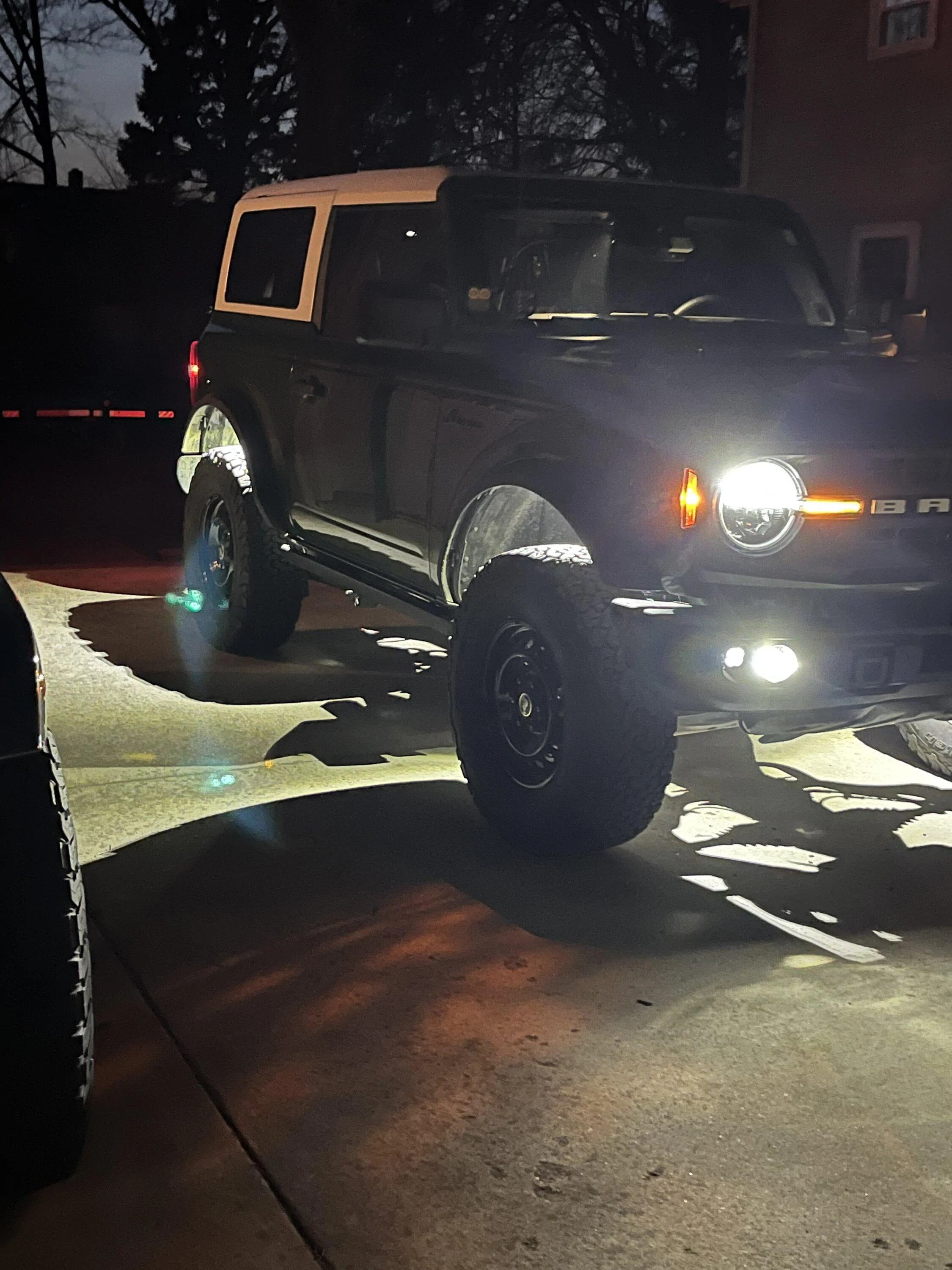

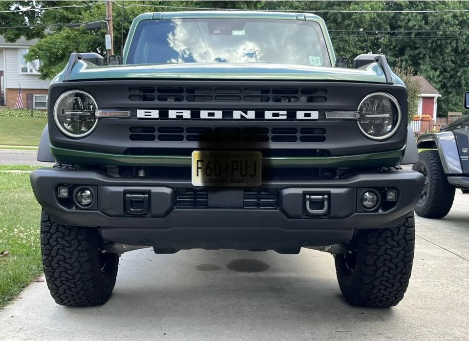

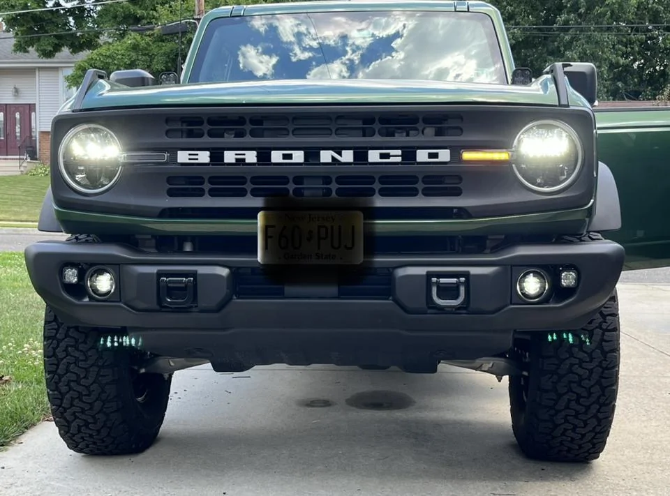

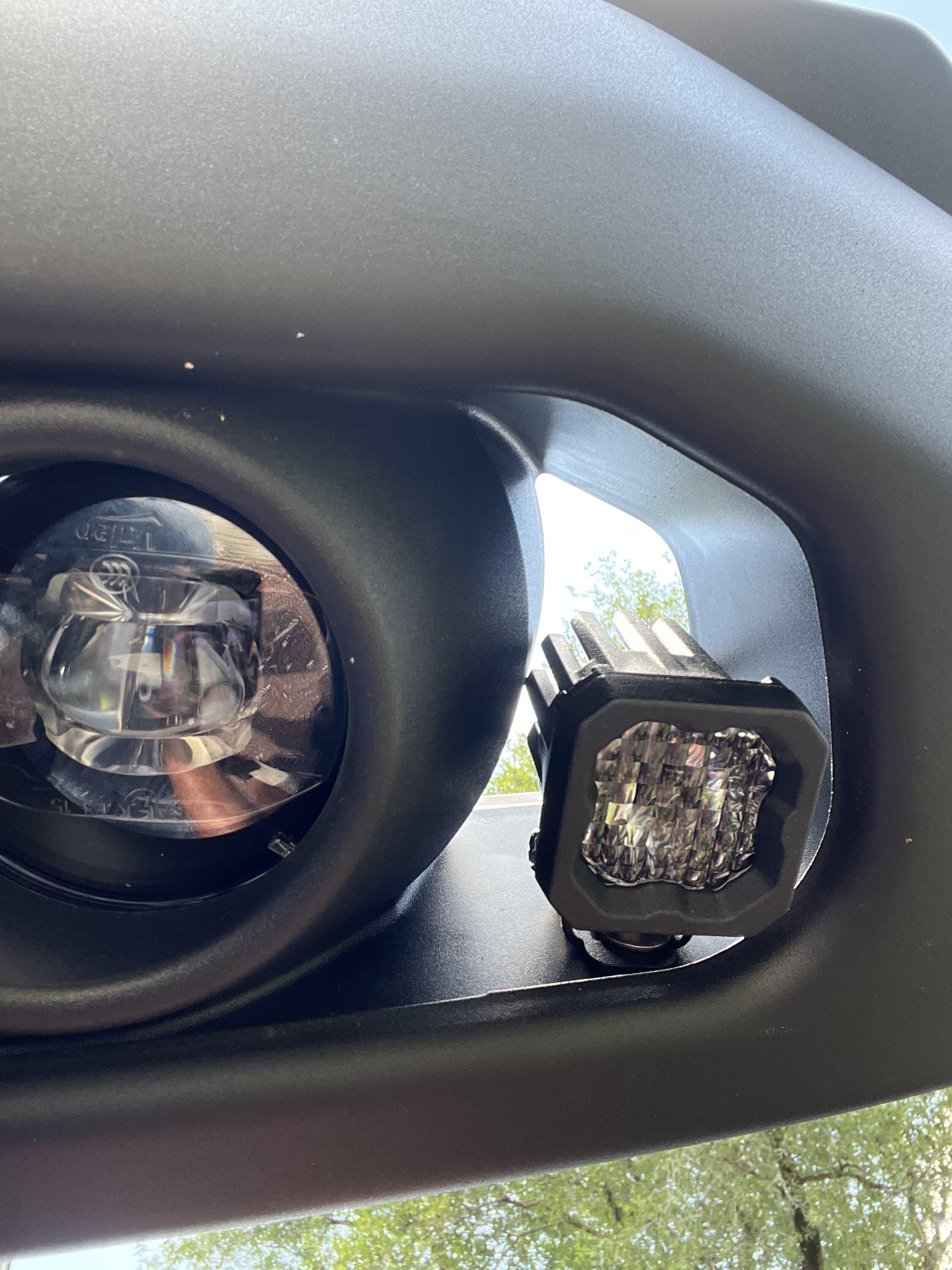

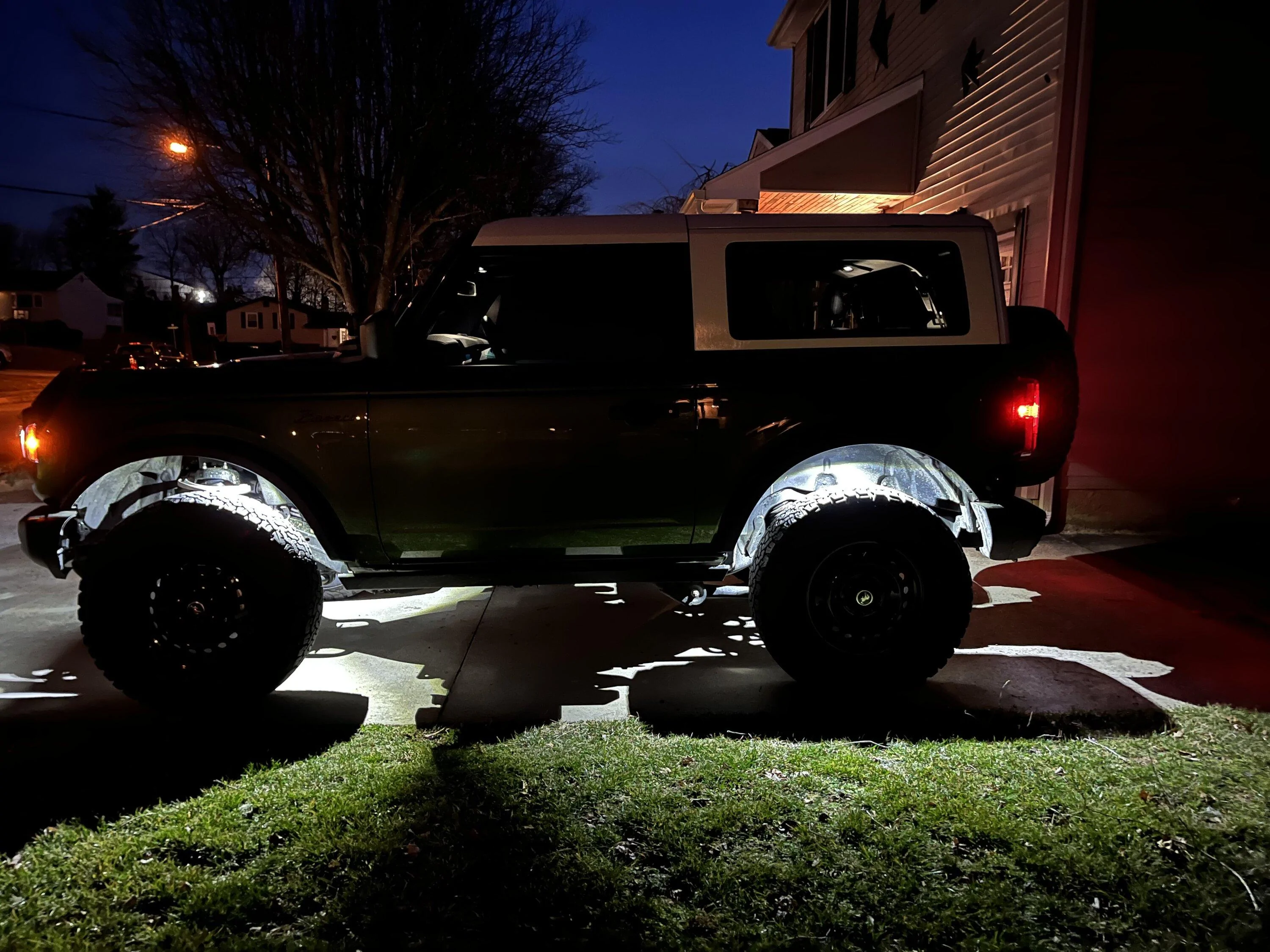

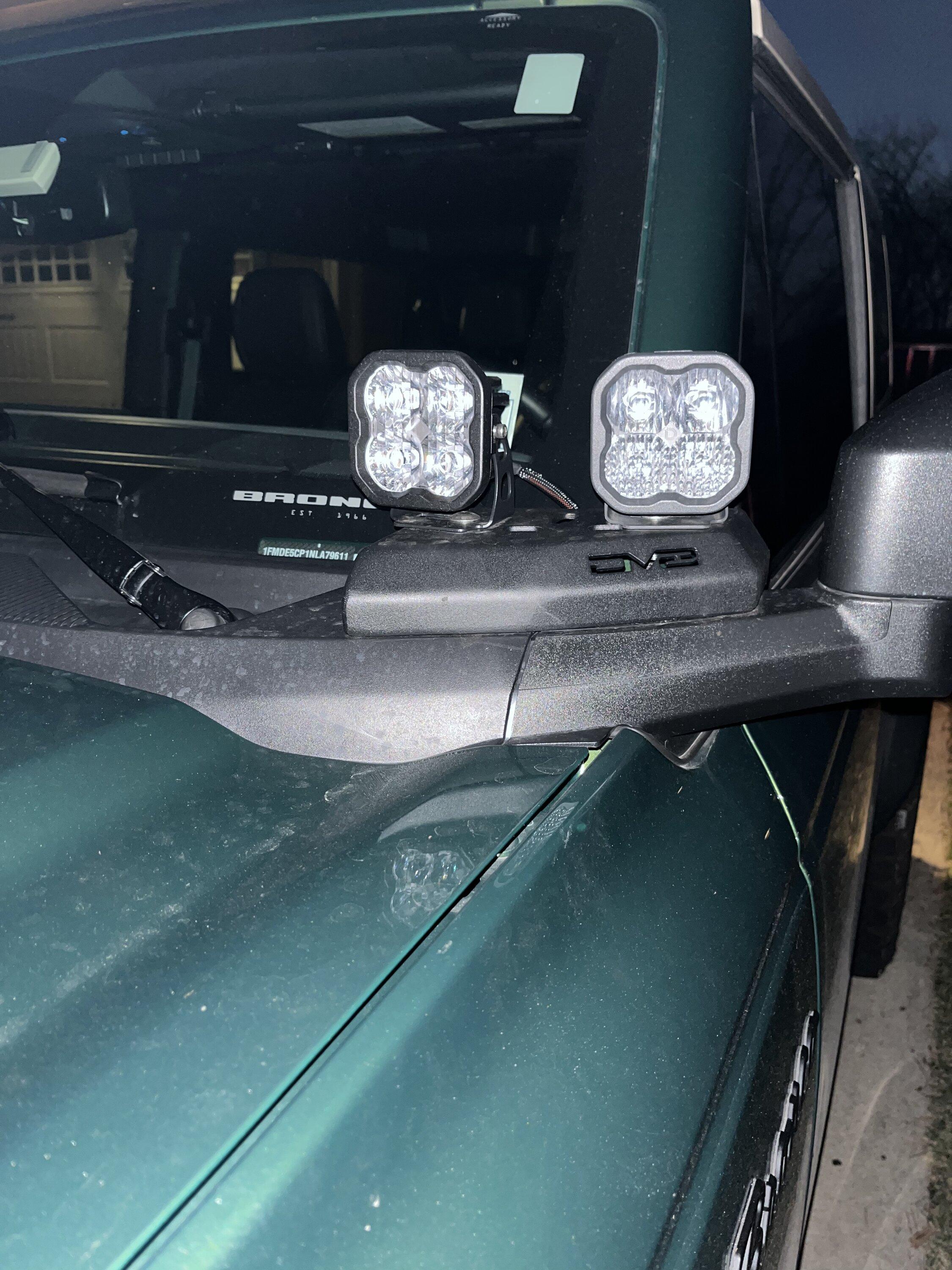

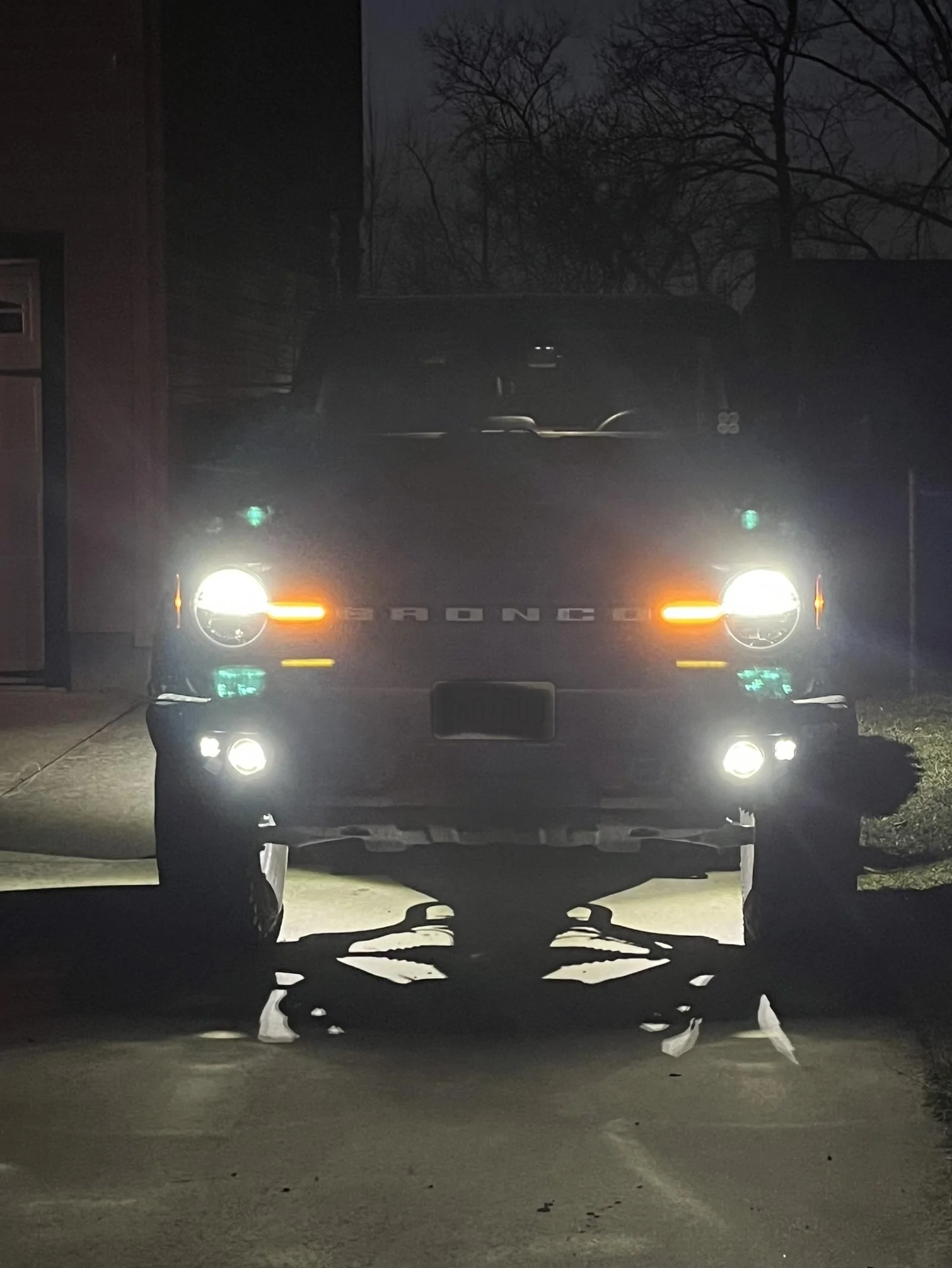

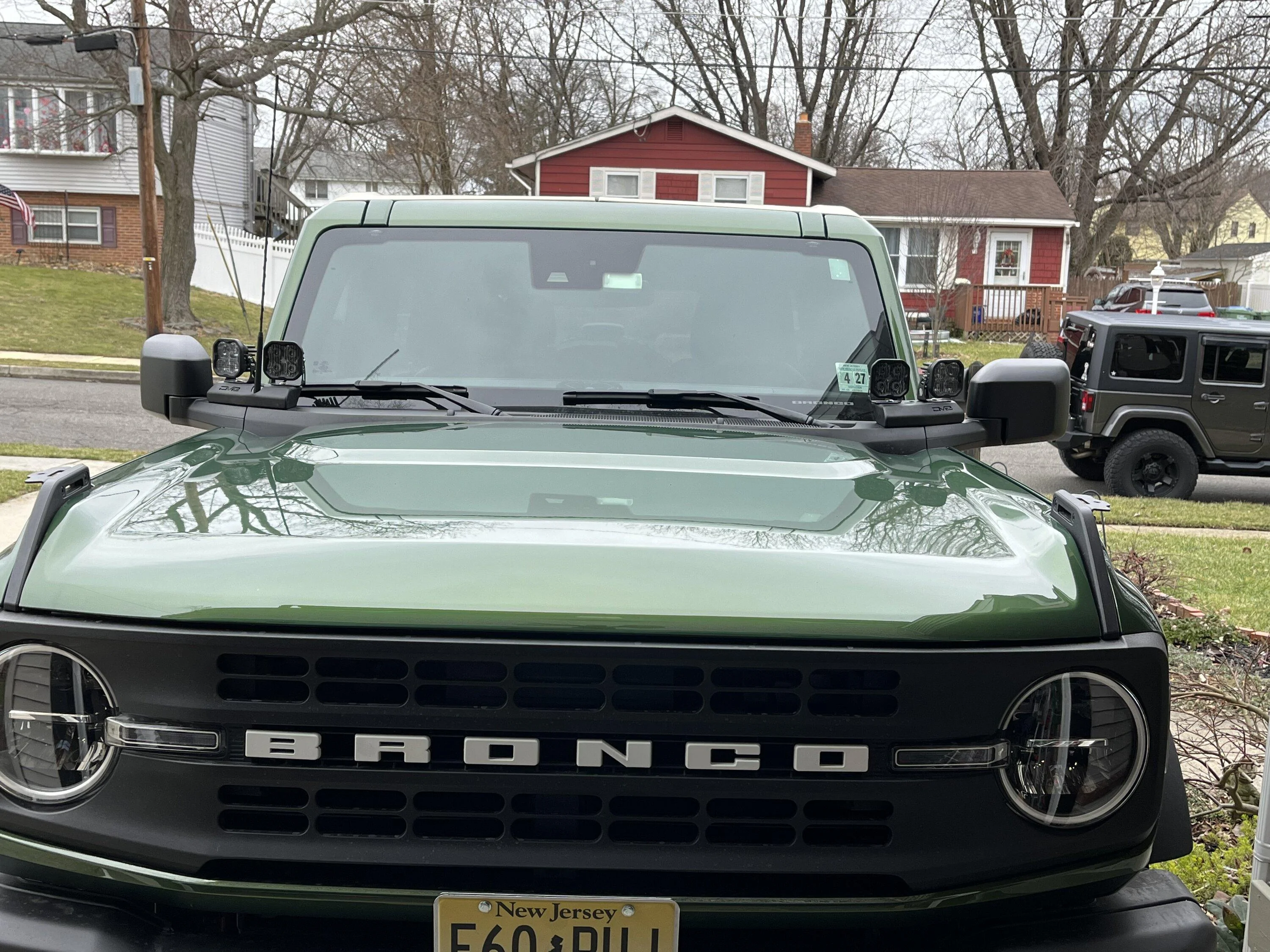

Been a while since I got started on this. Been hot. Too hot. Anyway. Following @Tarheel_Wes thread for the diode dynamics C1 fog lights I mounted them up today. Using the white back light hooked to the standard fog and the full fog on an aux switch. Camera doesn’t pick up the backlight well but it’s there.
Here’s the mounting
Ford Bronco Black Diamond Mild Build B0D3A92F-4866-4730-94FE-2DCB50EBBC4E
Ford Bronco Black Diamond Mild Build F18DCC1A-5B74-4999-AFF9-9BAFF608B258
Lights Off
Ford Bronco Black Diamond Mild Build 04B8D912-574C-43FB-82AA-6F555D5F1563
back light on with factory
Ford Bronco Black Diamond Mild Build 351CC11D-76FF-4164-B8A6-B454CB8911F5
Fogs on
Ford Bronco Black Diamond Mild Build 1626F1E4-2FB6-42E9-B083-052307F442BB

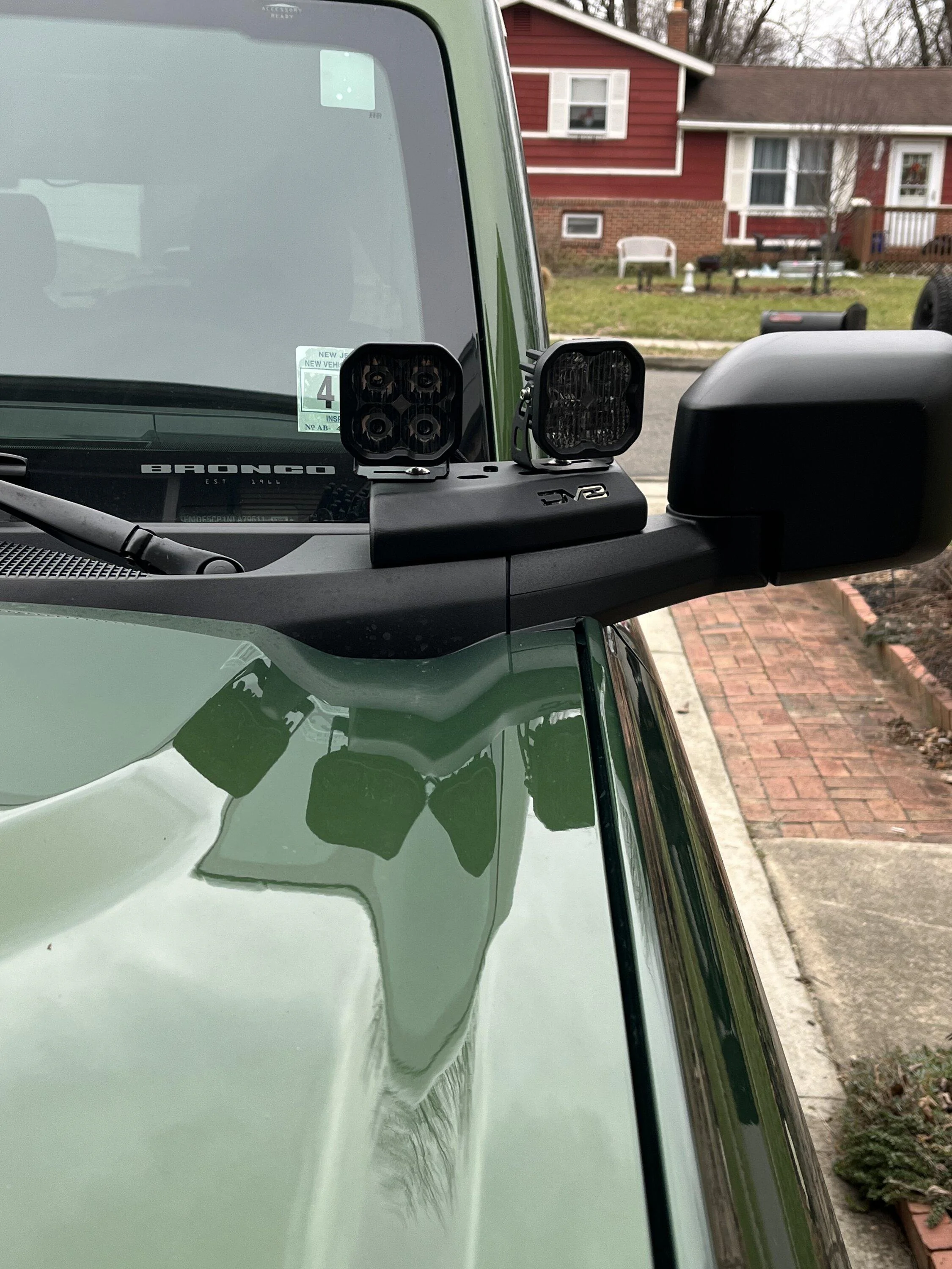

Bumper and A Pillars on
Ford Bronco Black Diamond Mild Build 1CBC5AE1-6402-4DB2-8EA5-BF84DD964D63

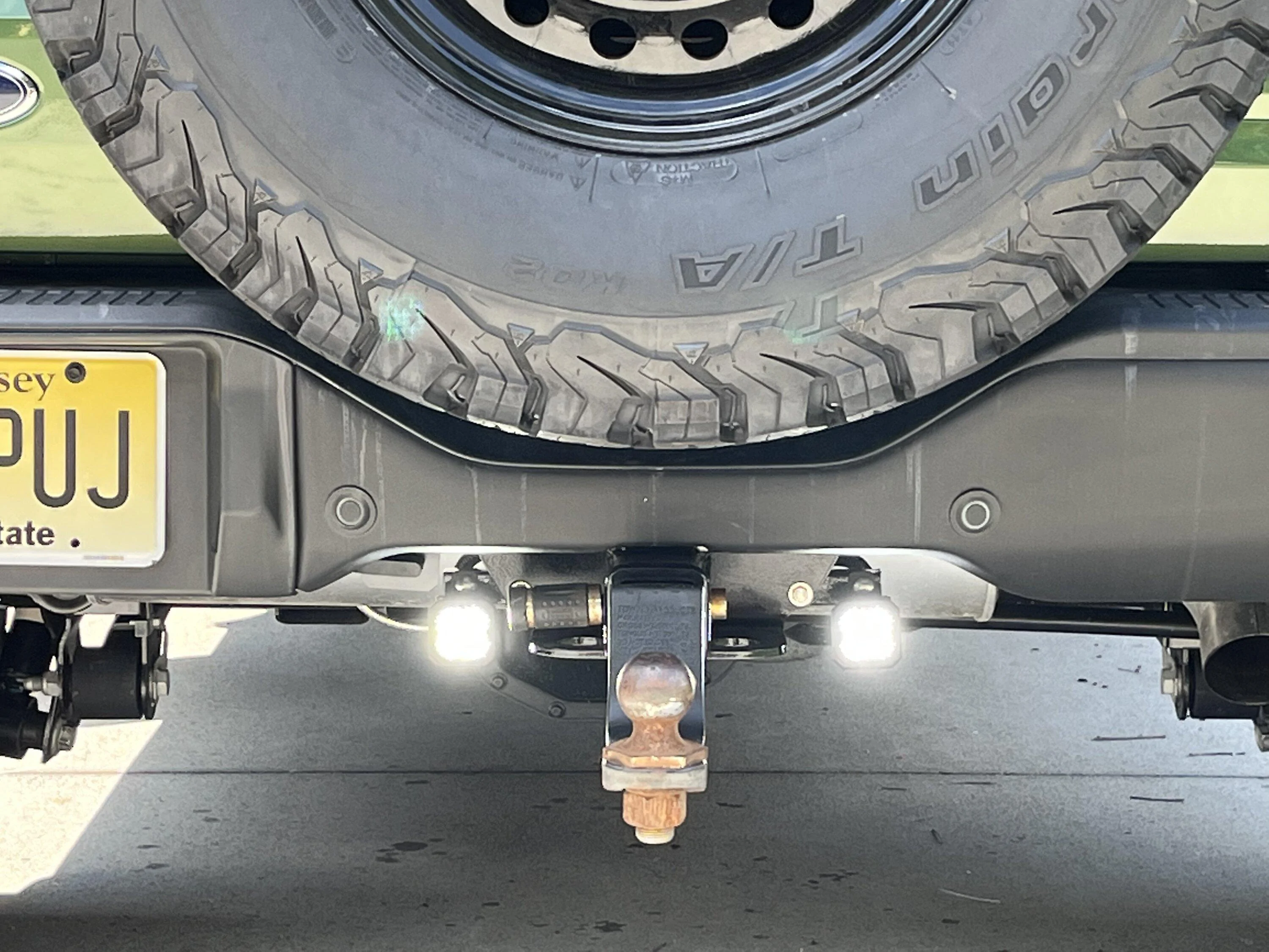

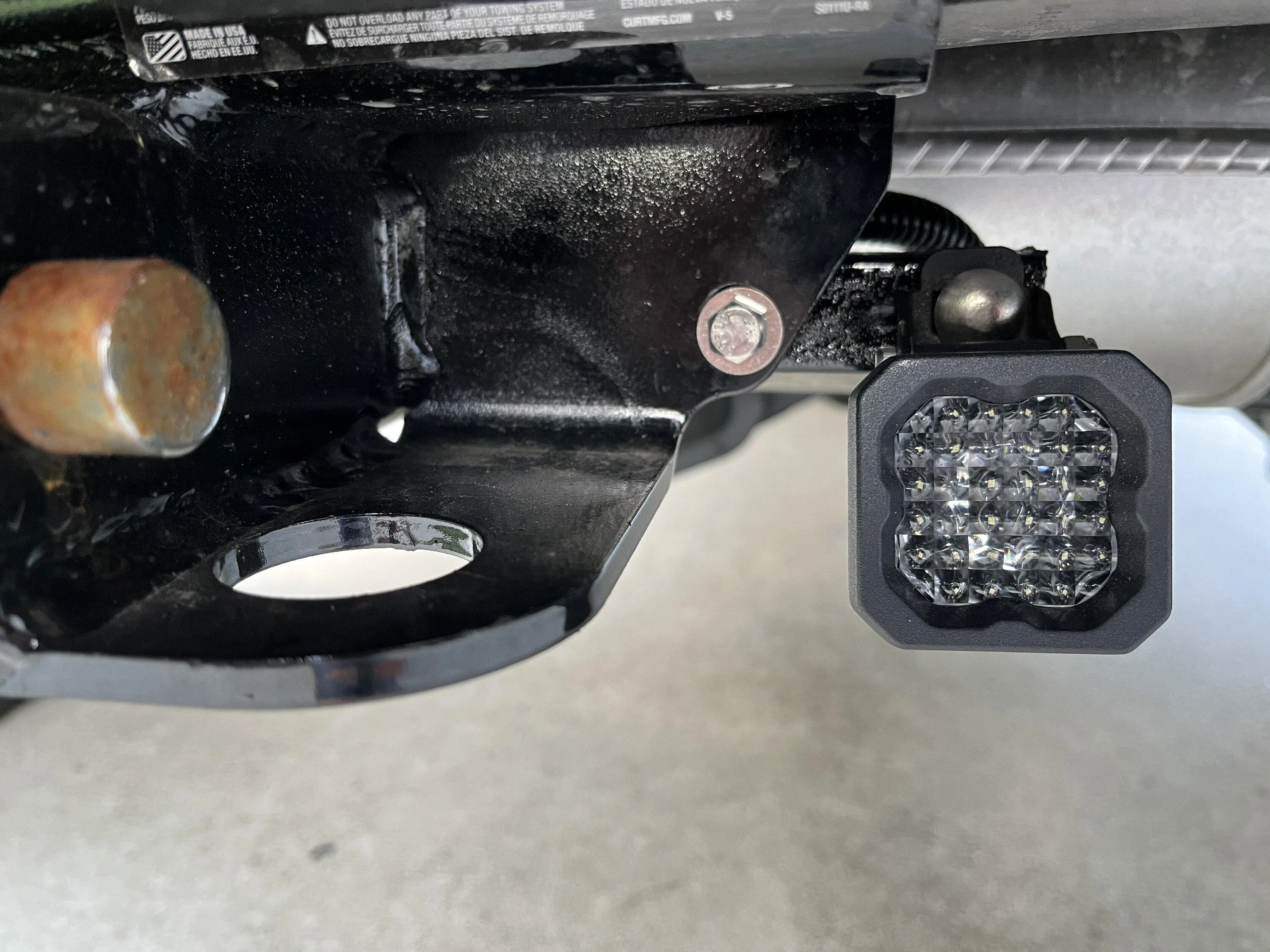

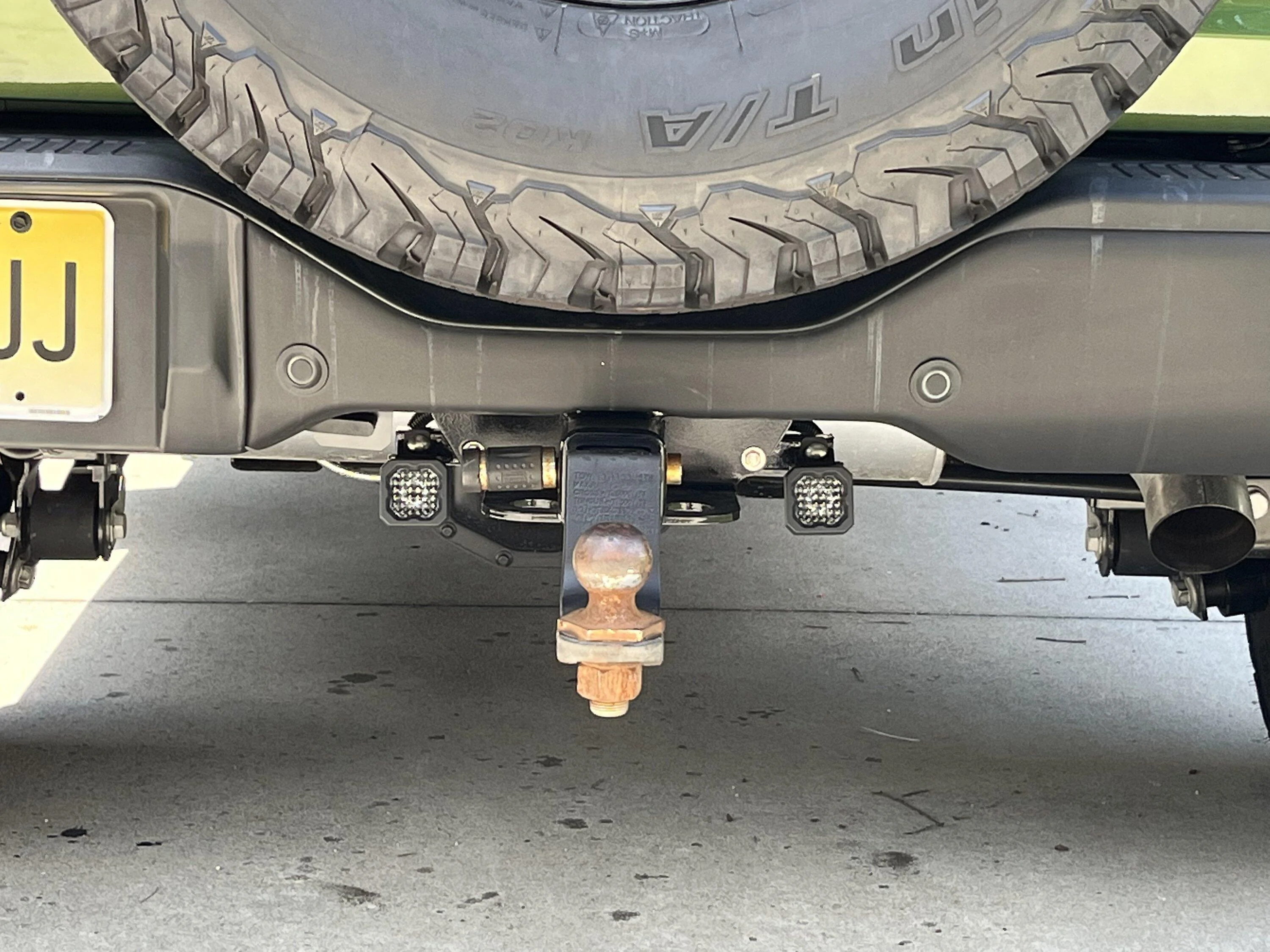

I also added rear diode dynamics C1 fogs on the rear hitch. They hang slightly lower than the hitch but perform well
Ford Bronco Black Diamond Mild Build 86E7B6BF-C34C-4FFF-8EAE-503A8D84D486
Ford Bronco Black Diamond Mild Build 3C4F5A57-2C02-42ED-AAD8-484DBE2A67F5

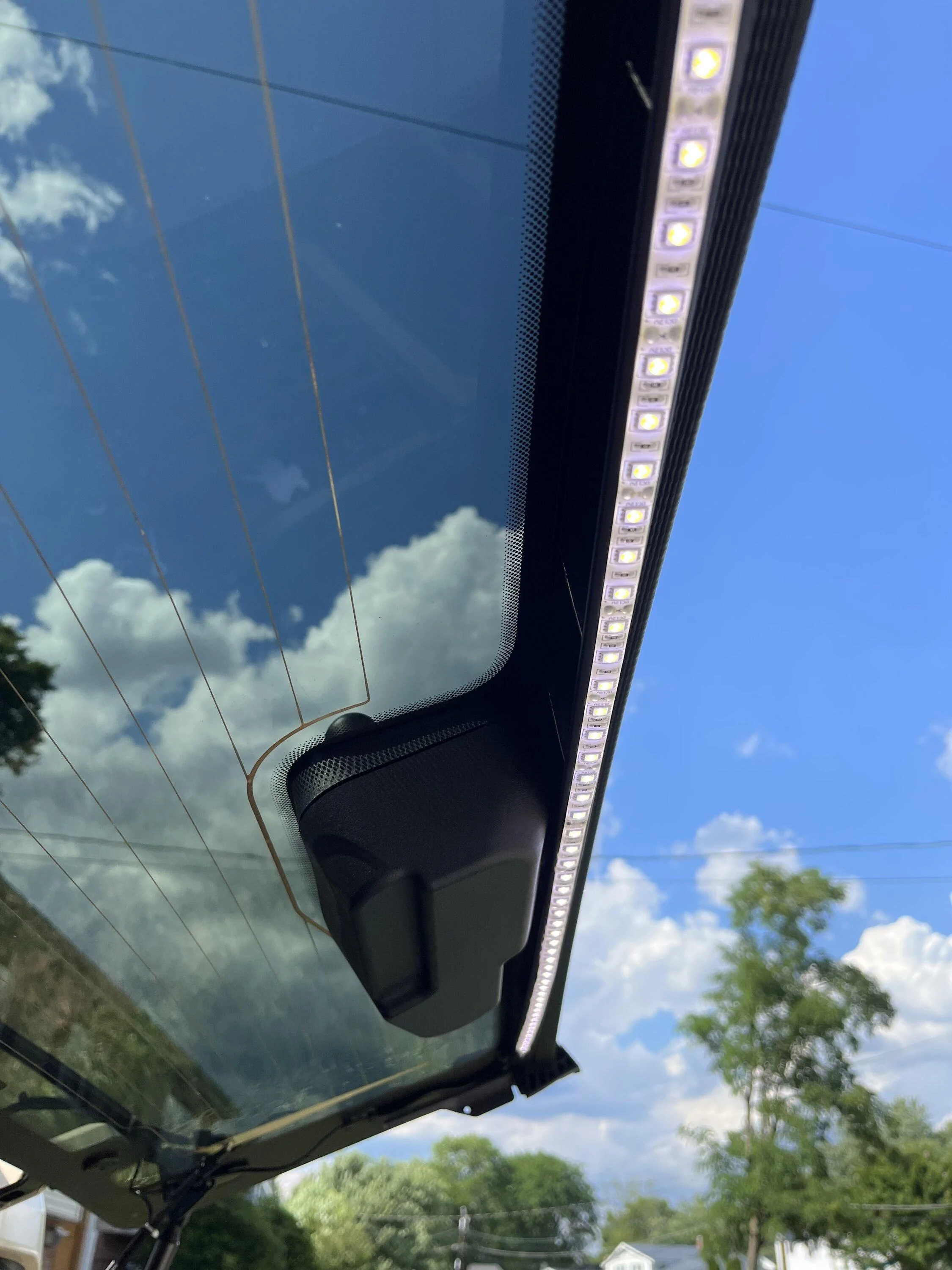

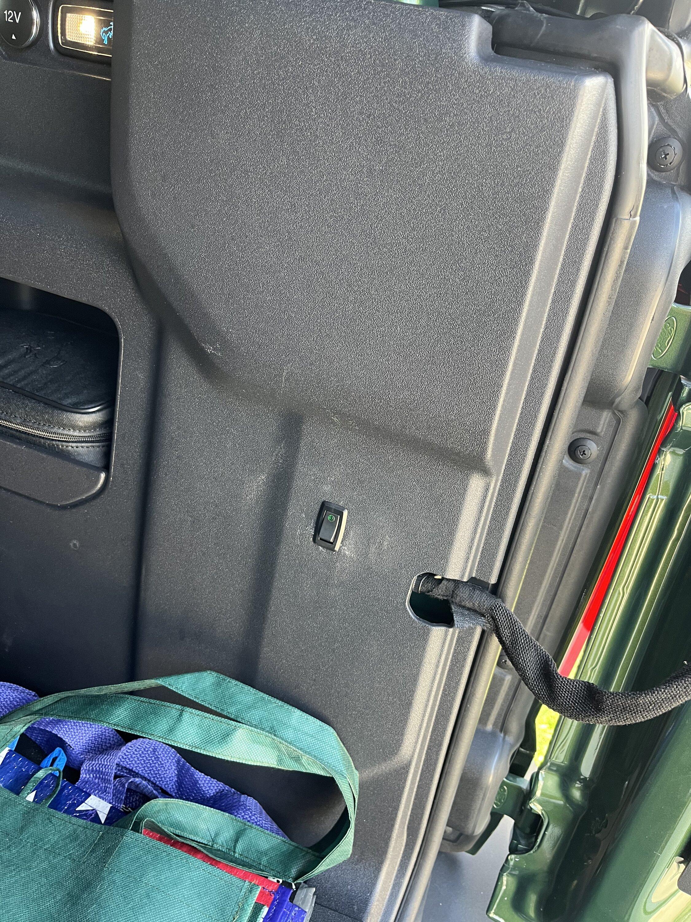

Added a strip LED light and switch to the rear gate. Lights up the area behind the truck and the tailgate table. Will come in handing during night time fishing trips and early morning hunts.

Very nice man....what type of lens did you get in your C1's?

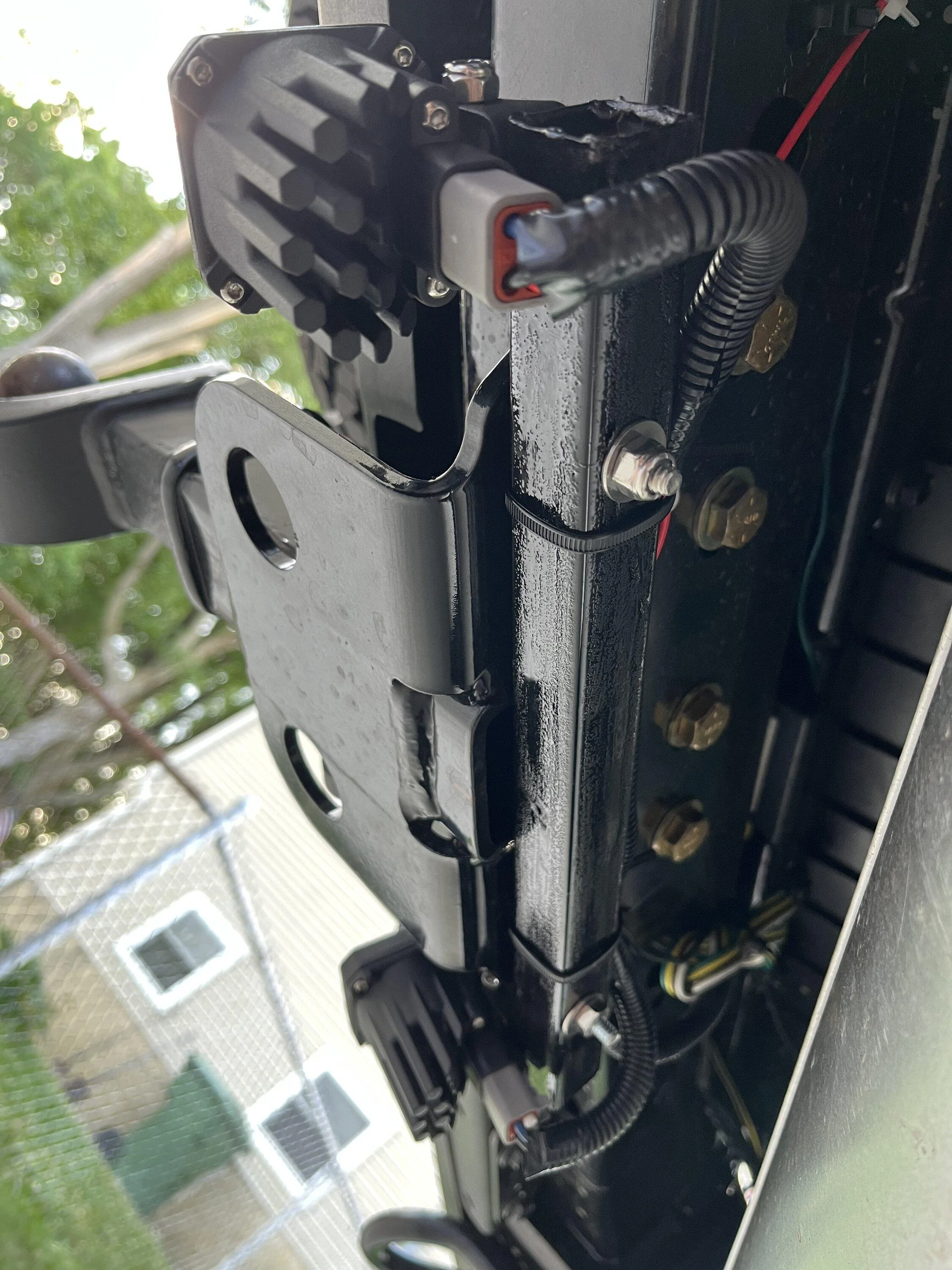

Can you share any details on how you mounted the C1's in the back on the hitch ?
I was contemplating mounting some flush ones into my bumper, but still pretty afraid to cut the bumper....I wanted to get the ones with the red backlights and tap those into my tail lights, and have the main beam come on when you throw it in reverse.

thanks bud. I got the C1 pro white wide for the front. The rear is sport white fog.
For the mounting in the back I used 1” square tubing. About 17-18” if I recall. POR 15 inside and out then flat black cover spray. Used two existing holes in the curt hitch to fasten the tube. Put the pods on the outside edge of the tube. I used the provided bolts but if I did it over I’d buy longer stainless and thru bolt it. PIA getting the bracket tight. Not using the backlight feature on the rear so wired it up to aux switch 5. Here’s a few pics. May help clarify my description
Ford Bronco Black Diamond Mild Build 768D8C1C-263F-46EF-9D68-FC90BF8783AD
Ford Bronco Black Diamond Mild Build 66EA4A47-0EBF-4D4F-9D5F-CC722AD03B31
Ford Bronco Black Diamond Mild Build 6419466D-8B27-4447-A22D-53AEF753C1DC
Due to the plug lock they are angled up a bit. But since they are not driving use the angle actually helps light up the area behind the bronco.
Hope that helps
and thanks for your write up on the C1 mounting in the front. Worked out perfectly

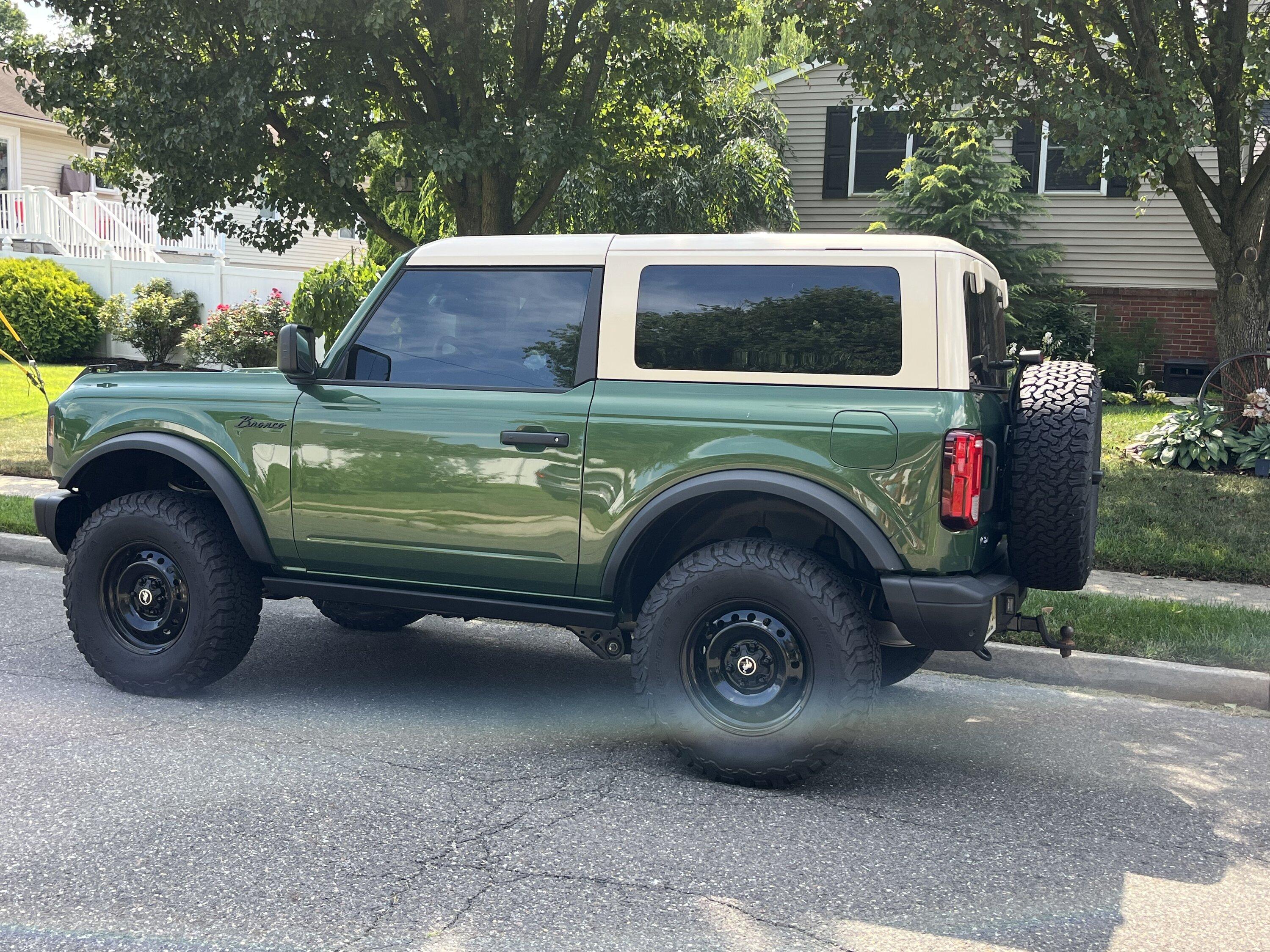

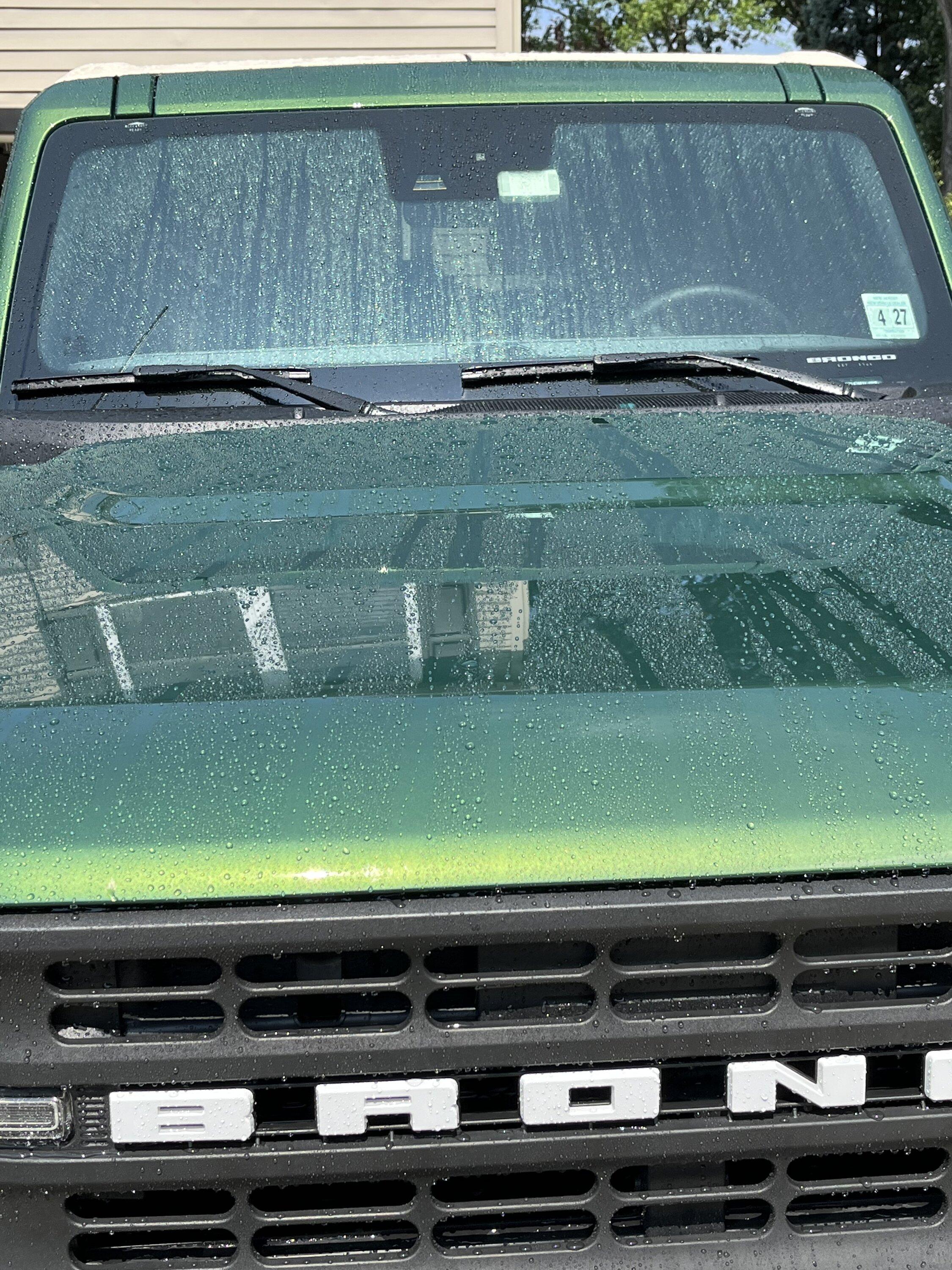

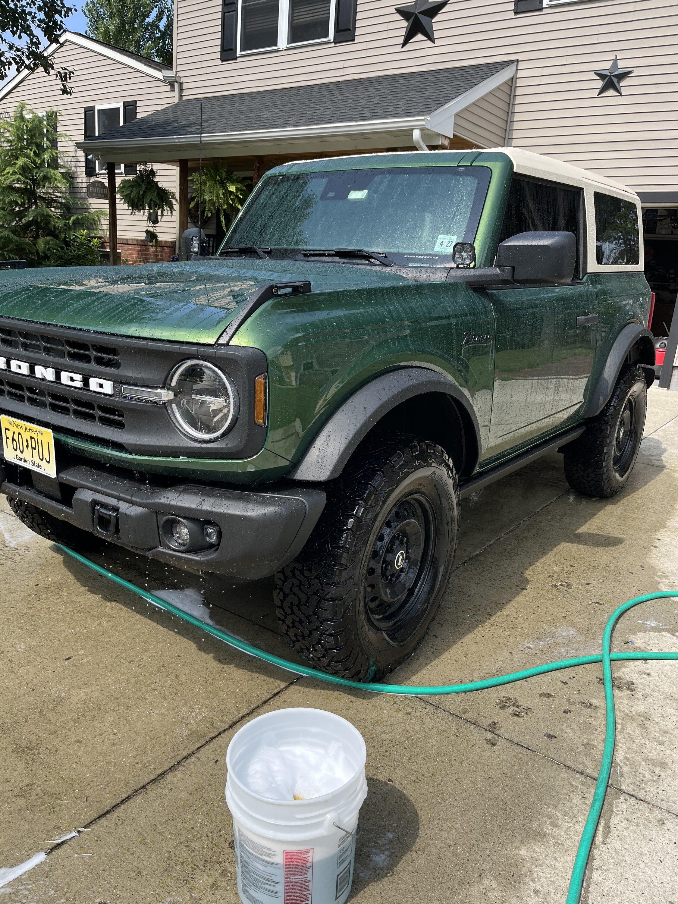

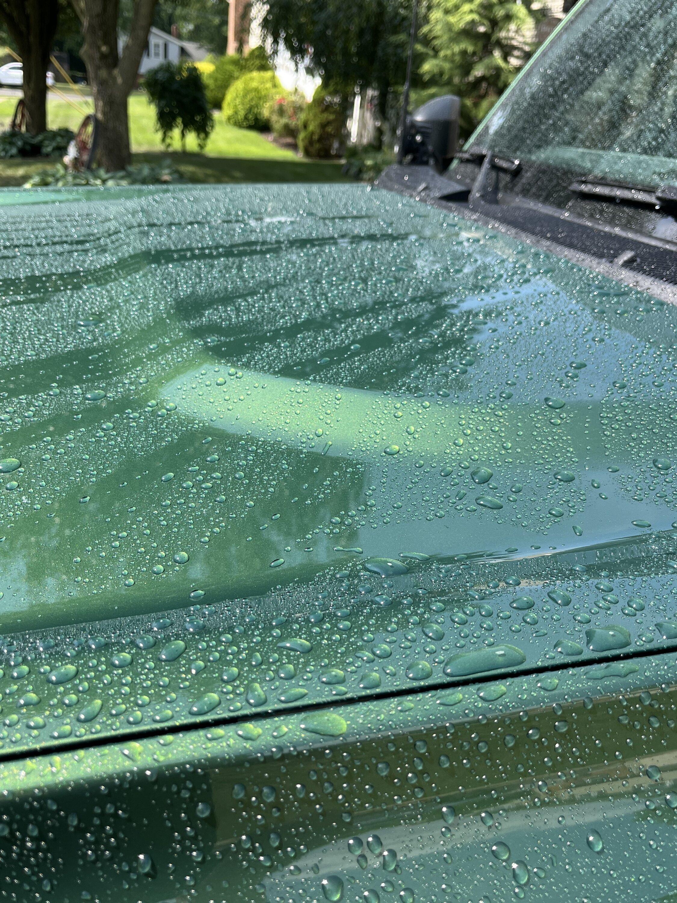

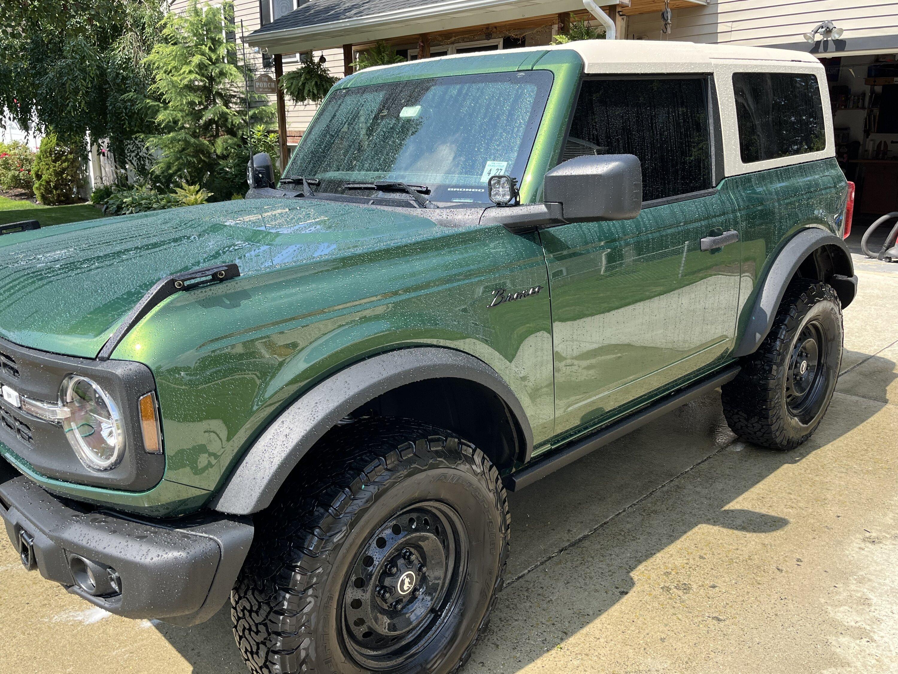

Took the day to detail the bronco. Thought it would be all day but that PPF and ceramic coating. Damned easy to clean and always looks freshly waxed. Water beads up and runs right off. ShoreStrike did a phenomenal job on the coating.
Ford Bronco Black Diamond Mild Build 7C8E52D0-A944-4B1B-B581-EEE7E6805EED
Ford Bronco Black Diamond Mild Build 27D7FADD-647E-4924-BA89-B498E0C7226E
Ford Bronco Black Diamond Mild Build 1D74E189-BFCB-4C9B-ABDF-F352E60E86BB
Ford Bronco Black Diamond Mild Build 91B8E938-606C-4FD1-8203-E5DC43C387CF
Ford Bronco Black Diamond Mild Build B25FC856-C2C1-4052-B969-2FA518B464A8
Left enough time to claybar and wash the wife’s Sahara.

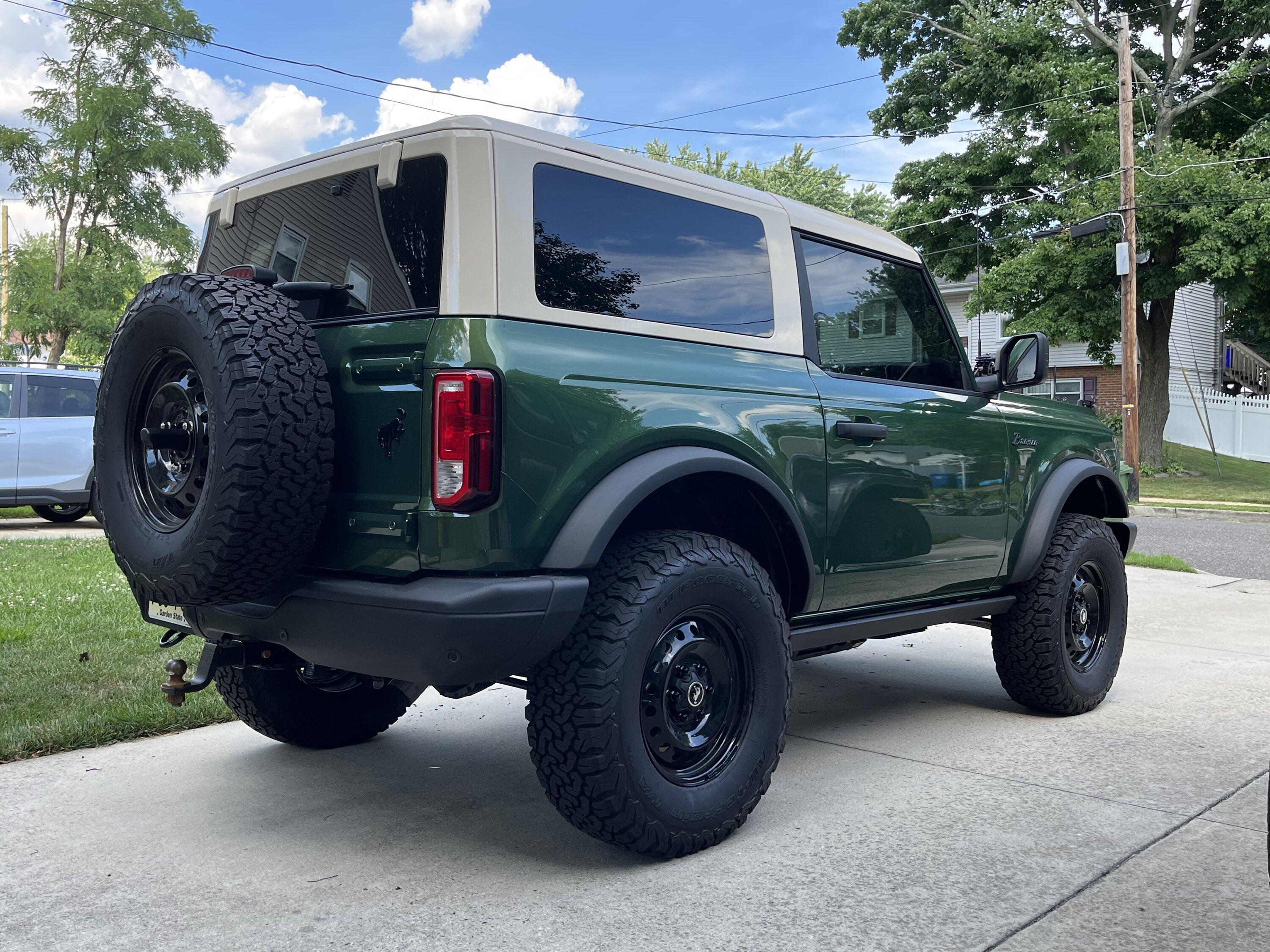

Been a while since I posted here. Giving the credit card a little break. Anyway, I had an issue getting a trailer tongue on the ball. The 33” spare tire sits lower and the tongue lock hits the spare when hitching up. Rough Country has a tailgate/spare tire support and relocation bracket. Got that installed tonight and gained approx 2” of space below the bottom of the spare tire. Makes hitching up trailer simple and supports the spare more on the hinges and less on the tailgate. Only complaint I have is they should have provided all black bolts. They sent gold bolts and silver nuts. Can’t see them from the back (blocked by the tire) but from the side it’s obvious they should be black. Overall pleased with the install and end results.
Ford Bronco Black Diamond Mild Build 03437668-DE88-4F4E-B2AD-17727343F8B8
Ford Bronco Black Diamond Mild Build A8A0EE07-039F-48FD-99E7-EB0975D37AB7
Ford Bronco Black Diamond Mild Build 940279FC-BA29-49EB-864A-EE5F06C4AF72
Still working thru the rock lights I’d like to install. Also ditching the lighted grill letters. Trying to keep it simple and useful. Progress, slow but steady.

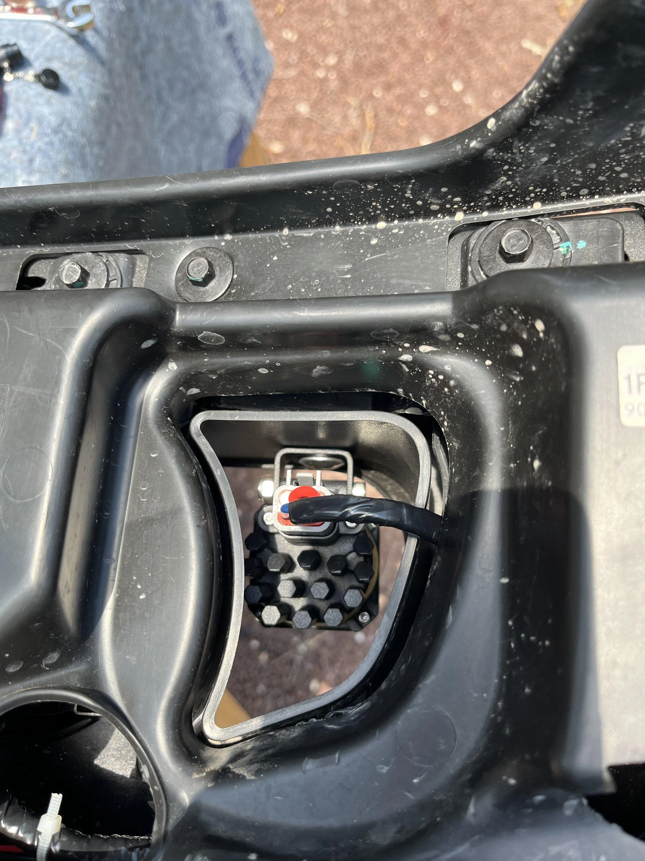

Hey, nice build! Quick question. Do the tow wiring harness and the reverse lights plug n play kits both plug into the taillight connectors?
Were they able to plug into each other without any issues, if that makes sense? Or, did you have to do something special to get both of them to work?

the trailer plug is a plug and play kit that connects to tail lights. The 2 pod lights are connected to the auxiliary switch. Not the reverse lights. Hope that answers your questions

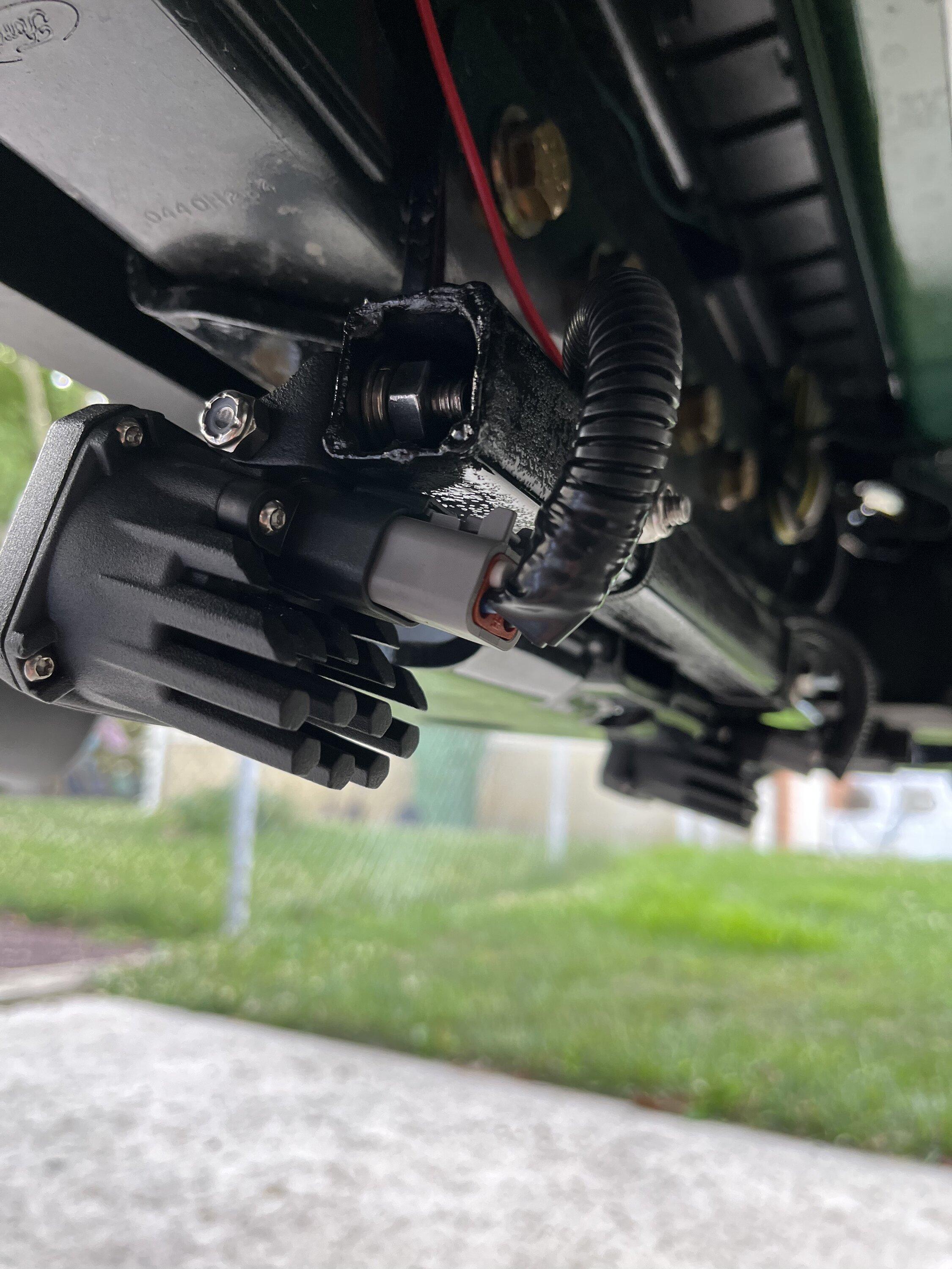

Filled in the last uplifter switch today. Rough Country rock LED lights. They do a great job lighting up underneath the running gear. Previous to this I installed the DV8 dual light pod and a set of ditch lights. Not a hardcore build or off-roader but just the right stuff for my needs.
