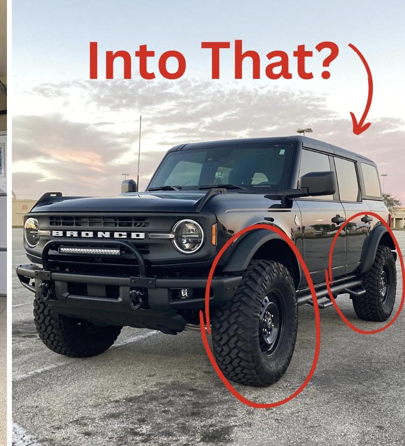

I'd like to achieve a more utilitarian look for my build. Came across a perfect example of what I had in mind. Want to suck the tires in more and steel wheels.
  • The example bronco is a Black Diamond with a 2” level kit and 315/70/17 Nitto trail Grapplers on stock steel wheels
  • My rig is a Badlands with the Sasquatch package
Question: Can I put this exact wheel and tire combo on my rig to achieve the same look? Does anyone know any reason why there would be a problem?

While it may physically fit, I personally would not run 315s on a 7.5 inch rim. The wheels will fit your vehicle fine though.

The BD steelies are an inch narrower and have 20mm more offset, so they will be much more tucked in than the Sas combo, and you will probably have some rubbing issues (and some fender flare overhang).

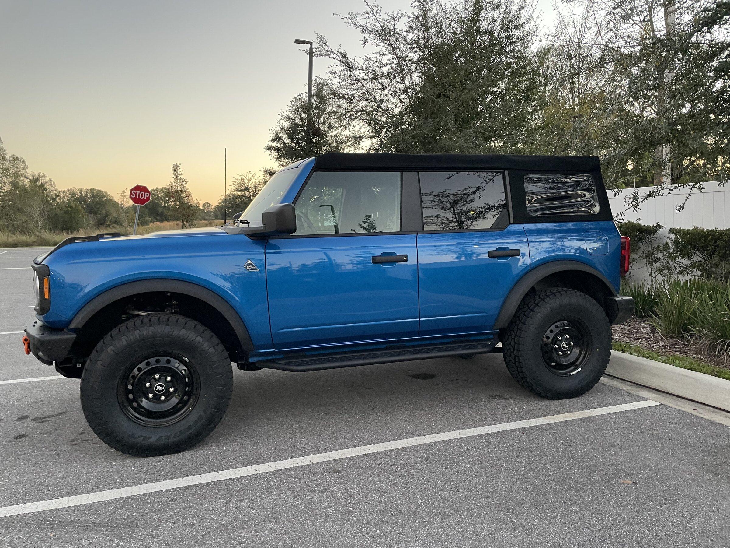

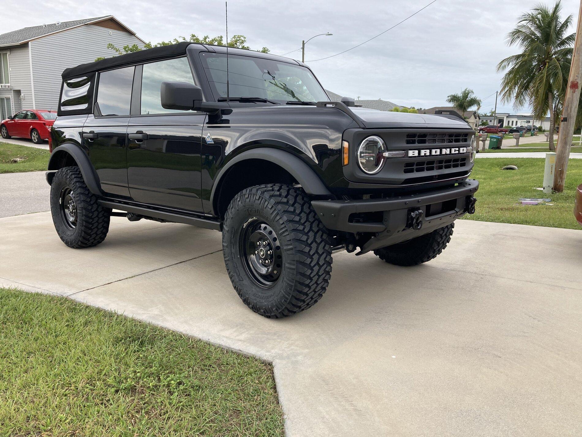

Here's the only photos I've found of what we are talking about (besides what posted on this thread already)
35x11.5
Ford Bronco Black Diamond Wheels on a Badlands? 2 inch 35x11.50R17 Toyo AT3 1
35x11.5
Ford Bronco Black Diamond Wheels on a Badlands? F7AC4749-6007-47E7-9665-F1EC175097BB
35x12.50
Ford Bronco Black Diamond Wheels on a Badlands? 26DAB285-ACE1-40DD-B80B-5D8C8A8FA5F1

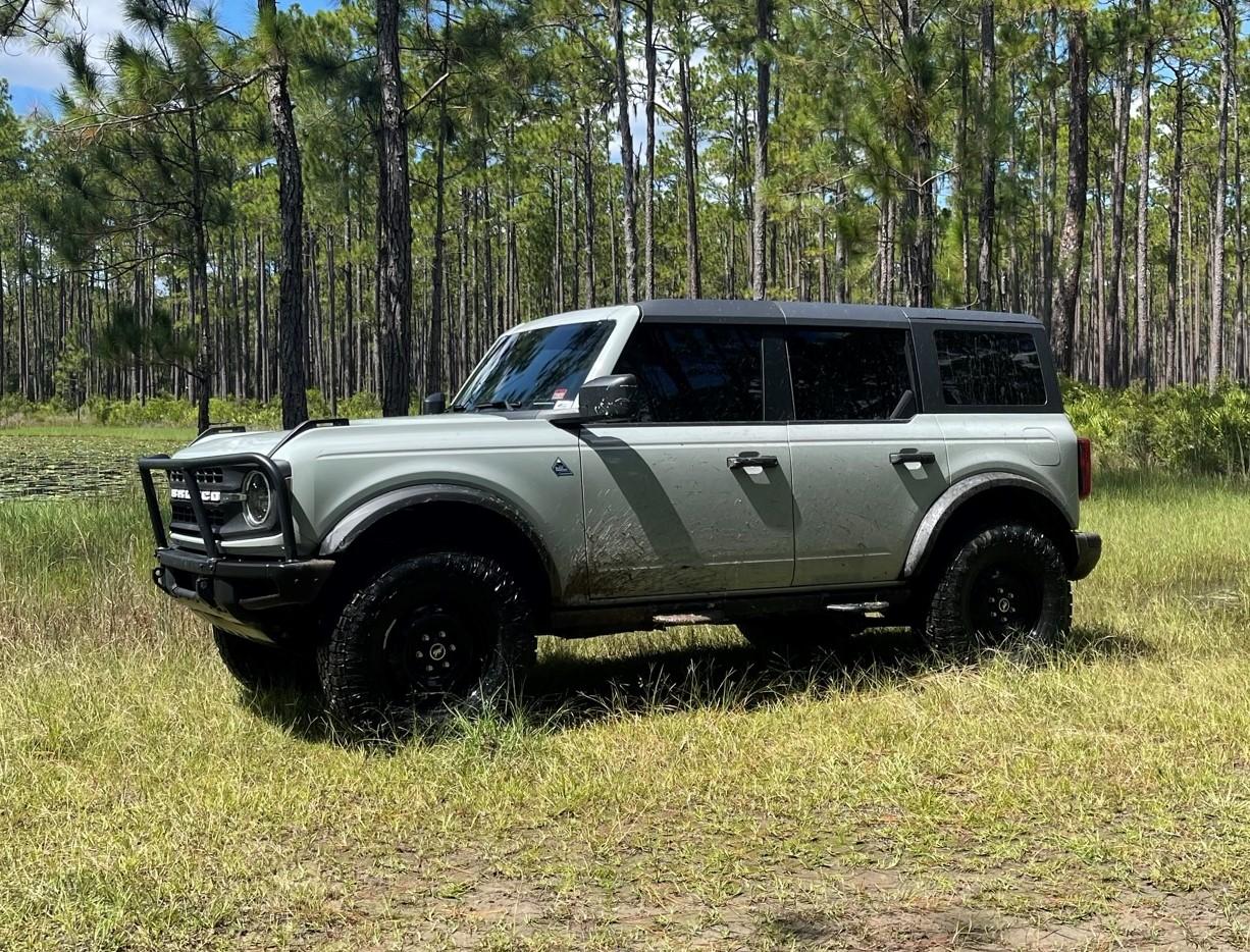

35x11.5x17 is a much better option for a 7.5" wheel. A 315 is just too wide for that wheel. Yeah people run them. But just because you can doesn't mean you should.
Another option would be the Mickey Thompson Baja Boss in 255/85-17. Not quite a 35 but fills out the wheel well quite nicely.
