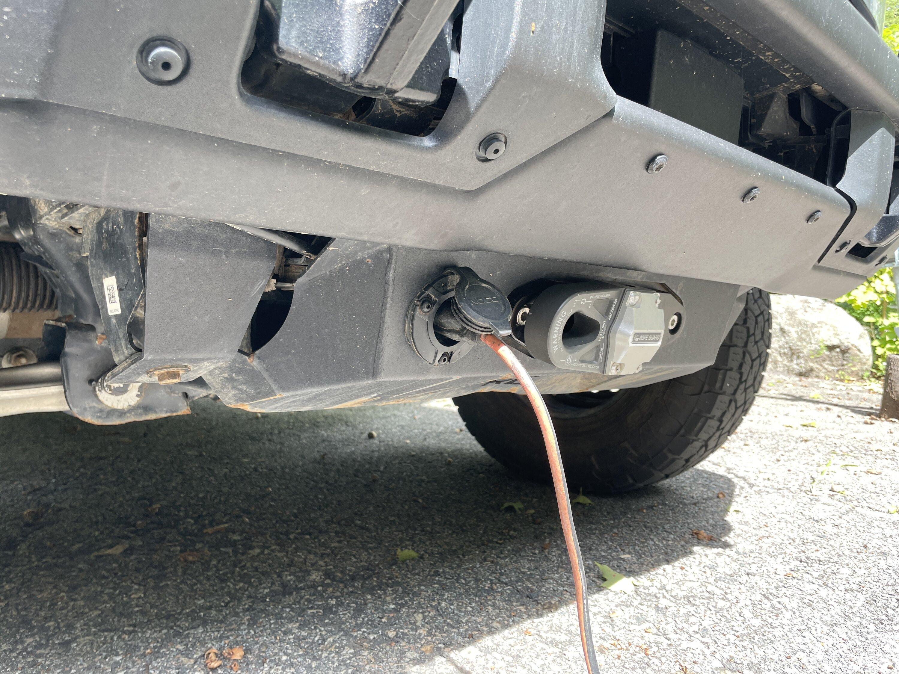

Pic? I’d like to see that.
I’m planning on connecting it to one of the two plugs on my Noco (other one is a battery tender). I mounted it in my RC hidden winch skid.
Ford Bronco Block heater plug, terrible location IMG_5136
