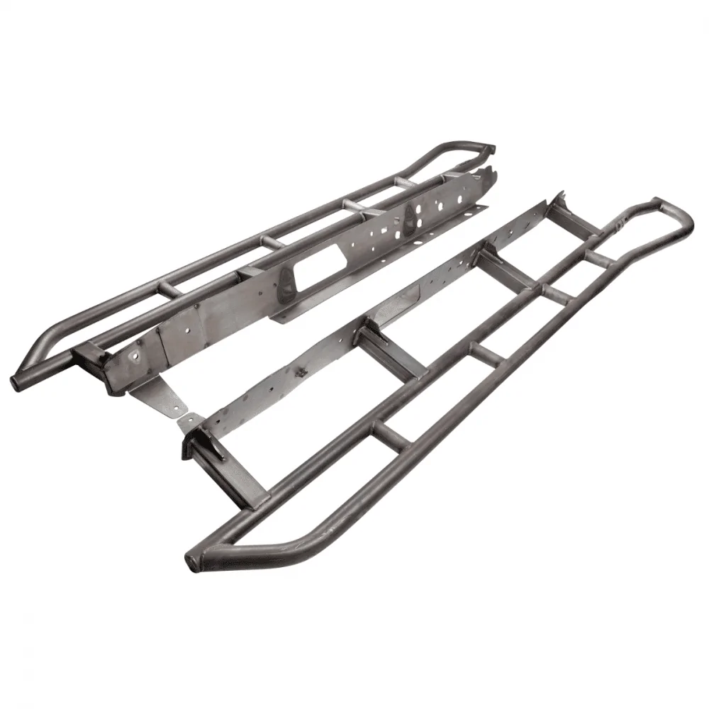

I don't have them but I've looked at them. My thoughts are that it is still body mounted even though it appears to be a sturdy design. My worry is that using the jack points could cause damage in some situations.
I'm still waiting on frame mounted. Fun-Haver is suppose to be coming out with them.
Ford Bronco Bodyguard Bumper Sliders? 2005t-ap-dclb_1
These are not the Fun-Haver sliders but this is what I'm looking/ waiting for.

Would you mind elaborating? Aren't the jack points you are referring to on the underside of the frame itself? Or are their jack points on the steps?

There are 2 hi-lift jack points built into each slider. They are meant to be used with an aftermarket hi-lift jack. I'm just not fully confident about jacking the truck like that on the body.
Some after market sliders and bumpers have hi-lift jack points built in. Its mostly an offroad only thing. Hi-lift jacks are not the best for standard flat replacement or tire rotations.
But yes, there are standard jacking points under the vehicle for the factory jack or whatever you use at home.

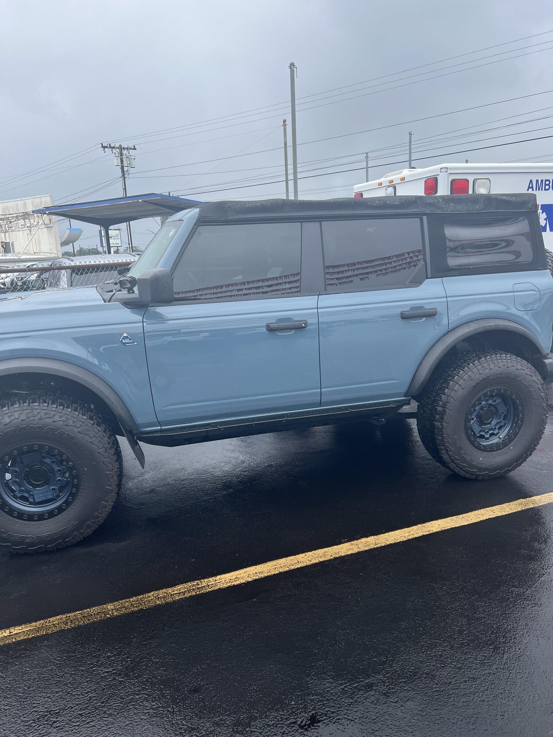

Yep, the stock bolts aren’t long enough to screw into the pinch weld. Guessing the videos on YouTube skipped over this because of sponsorship. Those metal clips are a fun one too.
one of the bolts you’re meant to reuse was also missing from my rails (pretty sure it flew off when I was driving since I ended up running over a screw). So waited a week for those.
I was worried it’d look off because all the videos make it look pretty bulky, but pleasantly surprised at how nice it came out.

yes, same! I'm very happy with them

Could you share some more pics of the side of your Bronco with the sliders? Wondering if they offer much door-ding protection.

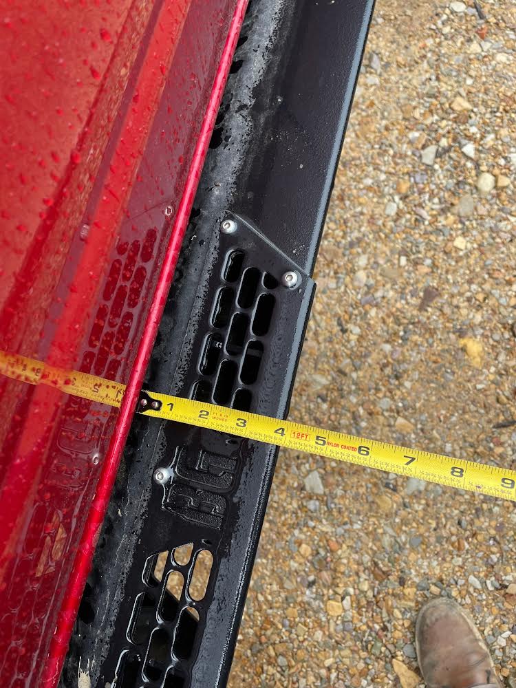

That is the side with the sliders:ROFLMAO:
here’s a better angle of it on another bronco if you’re trying to see how far it sticks passed the door. A fair amount of protection unless you get it from another lifted truck

You, sir, are awesome. Thanks so much!
