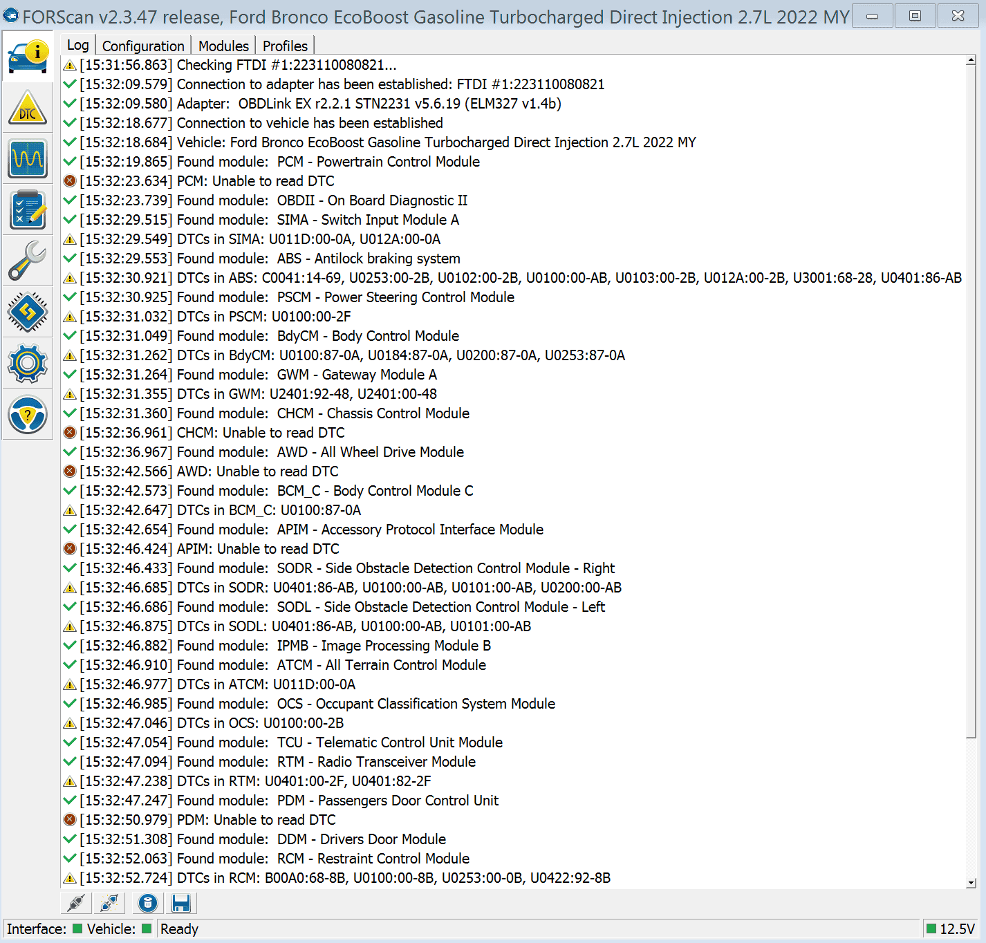

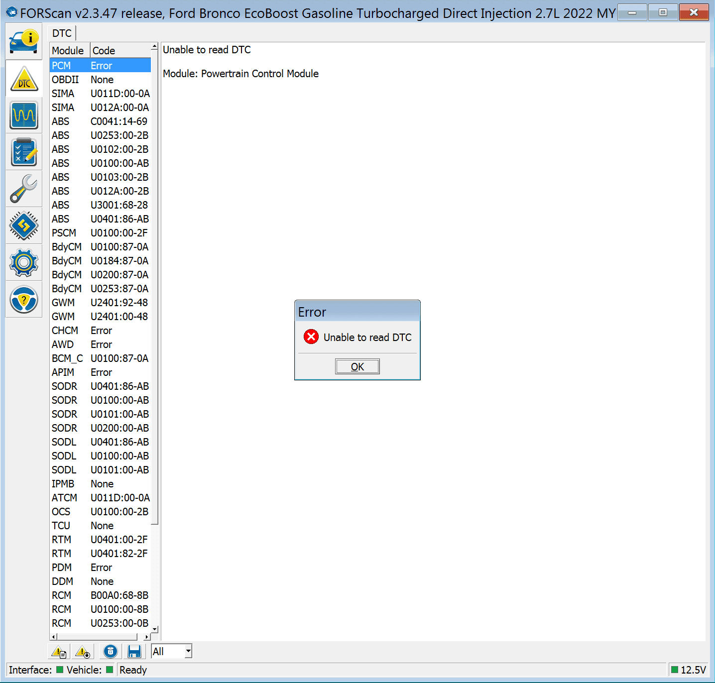

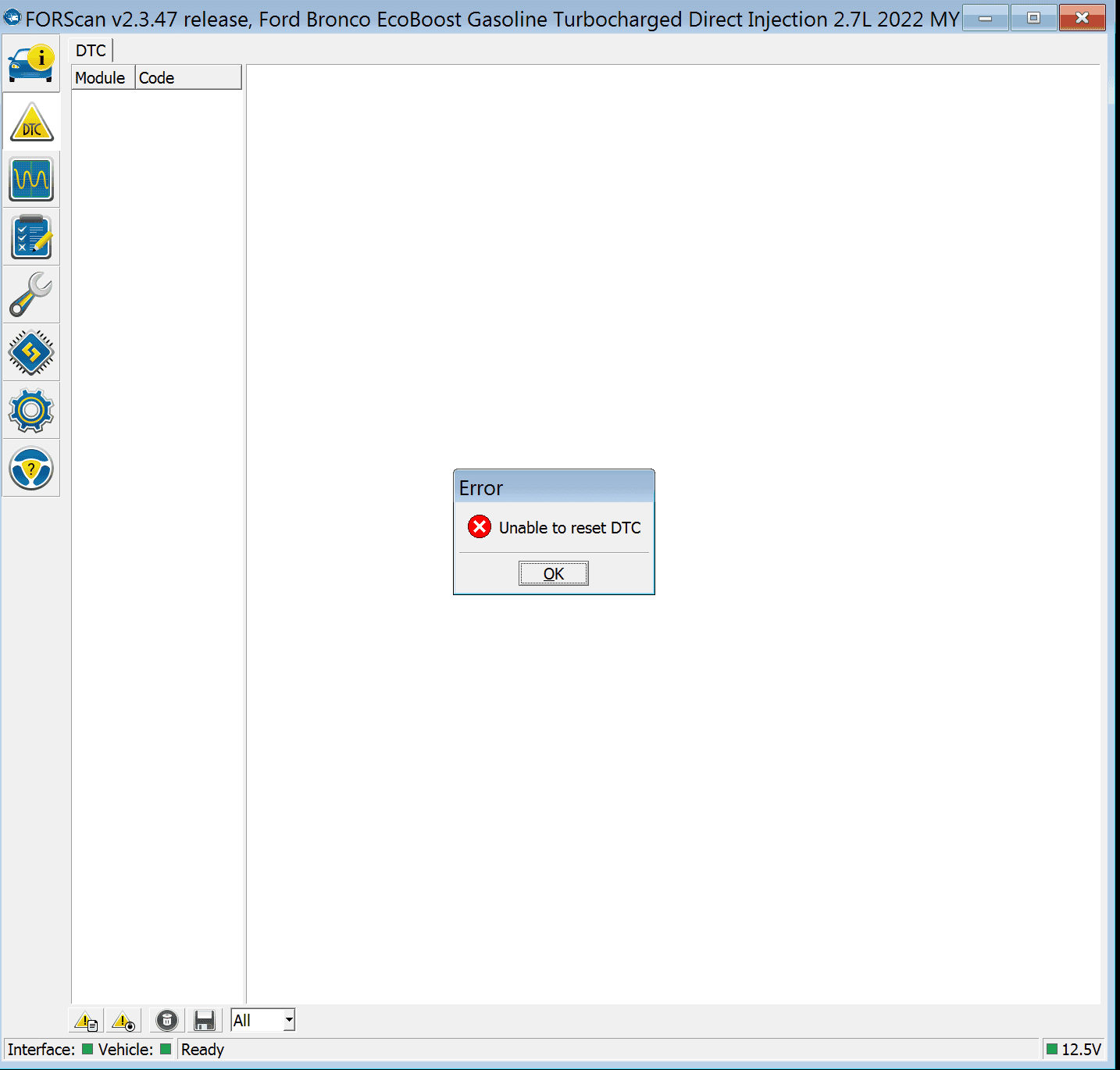

I tried DTCs, for some of modules app can't read DTC, for the ones that have been read, when I tried to reset one, and I got the "unable to reset DTC." I am using OBDLink EX with usb connection.

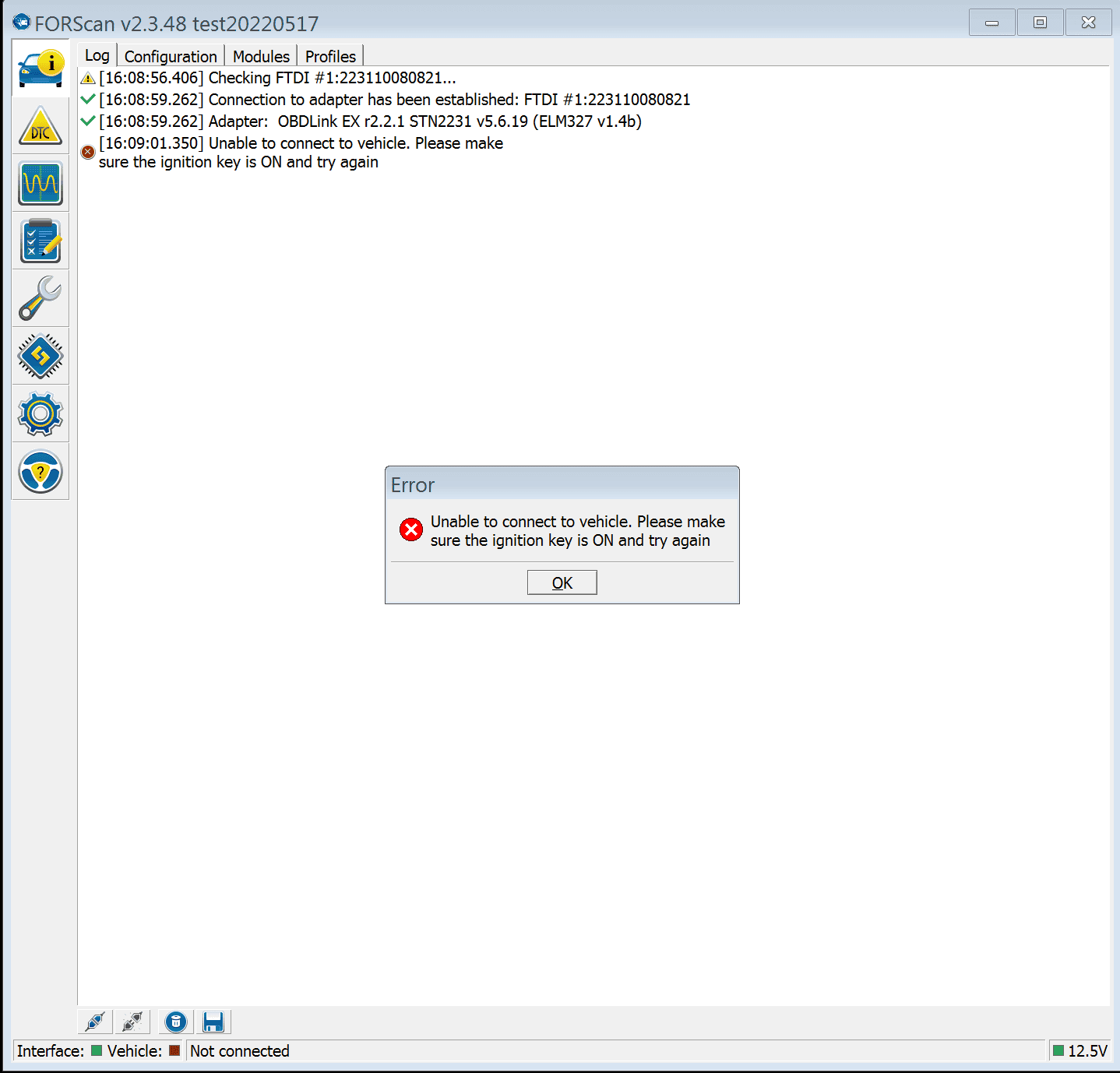

Thanks for the suggestion. I deleted the existing profile, now I get an error "Unable to connect to vehicle". The vehicle is ON, key fob is in there.
