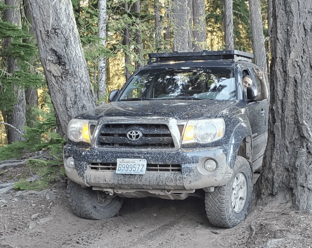

Width is my concern too, here in the Pacific Northwest the trails are tight. It looks like the tires stick out enough that by removing fenders and with some better rock sliders we can ignore the body width and just look at the width across the outside of the tires.
The Sasquatch models have a track with 4" wider (66.9") than the JL Rubicon (62.9"), and the tires are 1.2" wider (12.4" vs 11.2") as well. Since track width is the center of the tire that should be a total of 5.2" wider than a JL Rubicon if I am doing the math right. That is HUGE on tight trails. This pic below is from the Naches trail, 2nd gen Tacoma, I don't think there is an extra ~5" there.
Most of the Jeeps are on 35's or larger on these trails and push the tires out considerably, does anyone know how wide they end up at the outside of the tires typically?

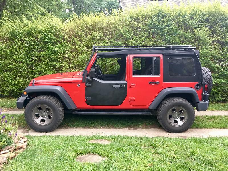

Odd query, but has anyone seen info on the size of the window opening, particularly the height? Might be an optical illusion, but the height of the door makes things look a little claustrophobic to me.
As a point of comparison, my Jeep's half doors (which I love) vs its full doors (which I do not love). Again, maybe an optical illusion, but the Bronco windows look even shorter to me than Wrangler windows.

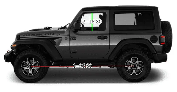

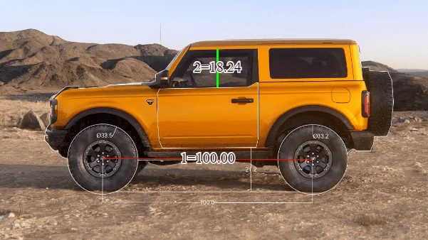

Here's what I see in an online measurement tool:
