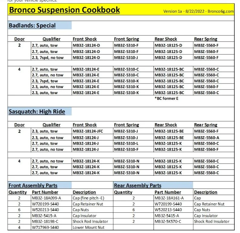

Yes that thread verifies the different part numbers of the shocks and has the side by side photos showing the reservoir being in a different location. The confirmation on the bumpstops may be buried in there too. The bumpstop part numbers being the same was verified/confimed by Flip from Ruxer Parts who is one of the contributors of the 'Suspension Cookbook" when I was trying to order the parts for mine to assemble the 6112s. But there are tons of post saying they are different.
EDIT: Ok I found the confirmation for the bumpstop part numbers being the same on one of the tables in that thread. They are listed under the Shock and Spring numbers as Front & Rear Assembly Parts and refered to as "Shock Rod Insulator" but I think most people call them a Dust Shield or a Dust Cover and the bumpstop is inside.
Just a general heads up for folks that come across this... that table is outdated, incomplete, and a tad misleading.
Many of the part numbers have been superseded by new parts. And the table also shows different suspension components based on whether you have the tow package or not. That is incorrect. It is determined by the curb weight, not whether you have the tow package or not.
Definitely awesome that the community put that together a few years ago, but yeah... not 100% accurate.

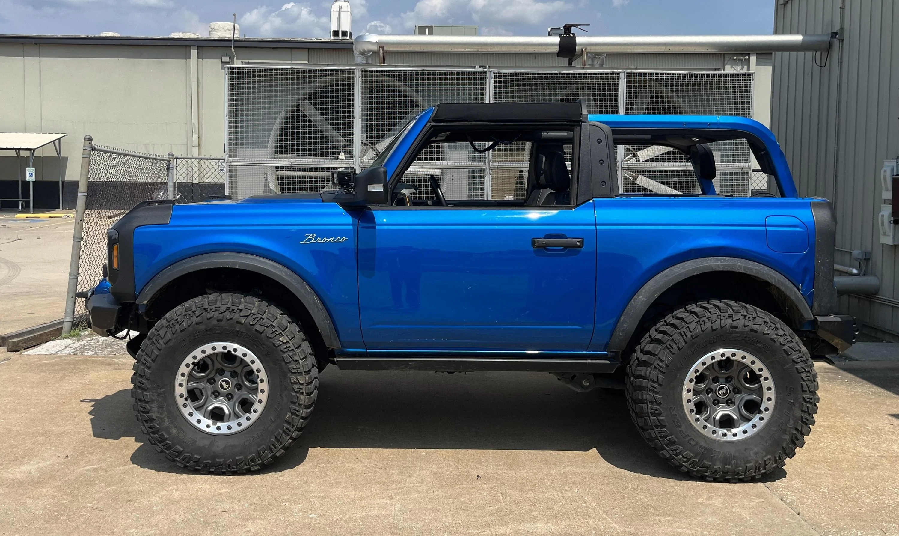

+1 here with a non-Sas Badlands in Velocity Blue with Sas wheels added. My 6100 Bilstein's are sitting in the garage waiting for me to get motivated for the install. :wink:
