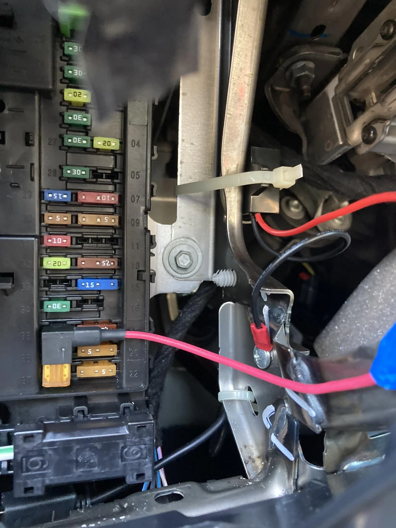

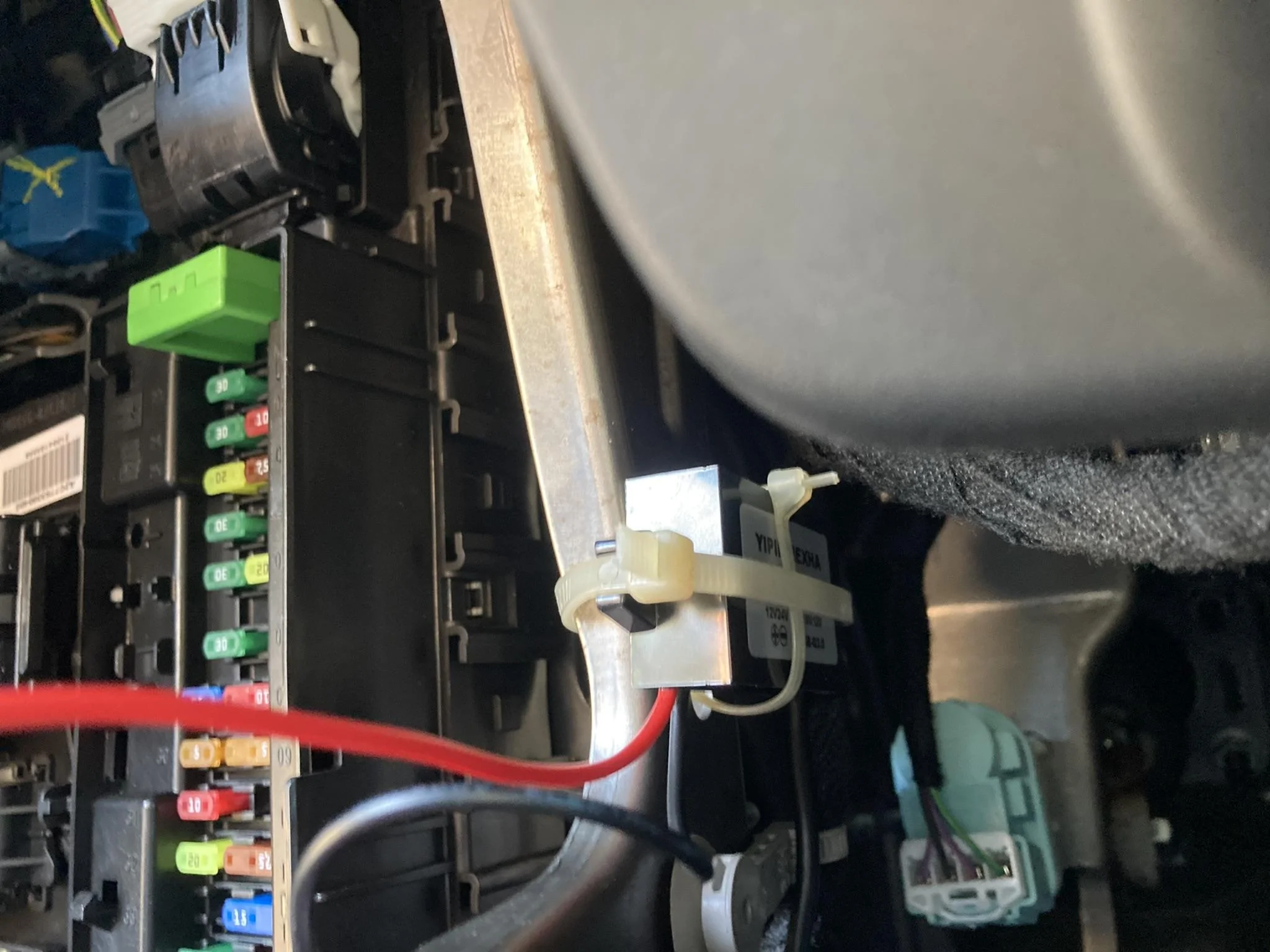

I bought the Tackform dash mount with motorized charger head, and added a dedicated power supply near the passenger compartment fuse panel. Ran a 3-foot USB cable across the front of the dash to connect the power supply and charger, for a clean installation. It made for an easy Saturday afternoon project. With the dedicated power supply, the radio is no longer trying to "talk" to the charger via the console power port (which it uses for wired CarPlay). I installed a fuse tap for position 35, an unused 5A circuit.
Ford Bronco Cell Phone Mount IMG_8720
Ford Bronco Cell Phone Mount IMG_8718
Ford Bronco Cell Phone Mount IMG_8717
