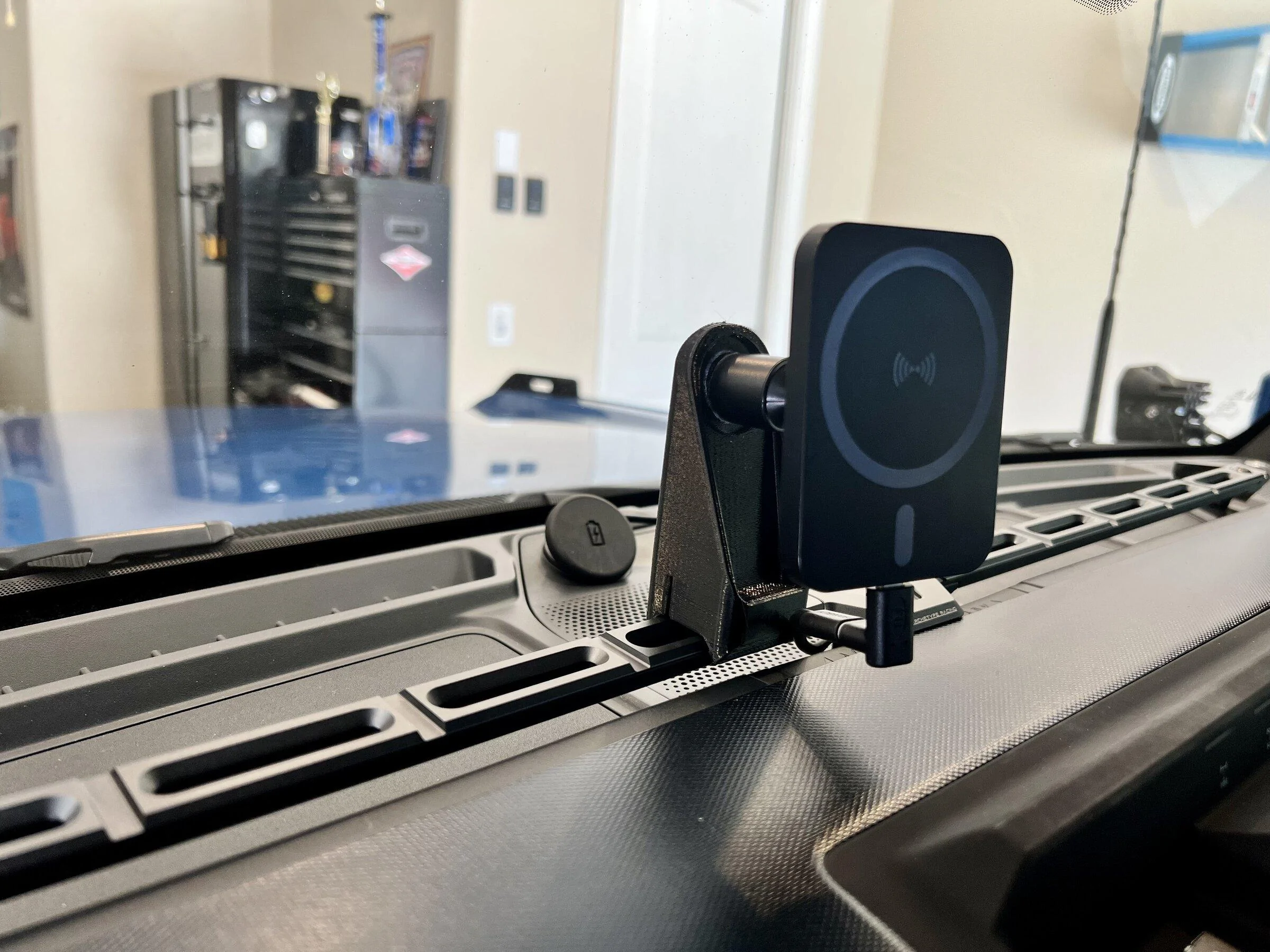

My current setup using:
1. Sticker fab pic rail with phone mount V2 $55
Sticker fab pic rail mount
2. ESR HaloLock charger from Amazon $35
ESR HaloLock Magnetic Wireless charger
The ESR charger there is a screw that holds the ball knuckle to the clip that mounts to your vent. Removed the screw and shaved down (with a Dremel) the knuckle ball mount to fit in the small circle of the Stickerfab riser. Used the double sided adhesive that comes with the Stickerfab mount.
Then simply hid the charging wire extra under the pic rail
Magnets are strong and the face ID works from the drivers seat.
