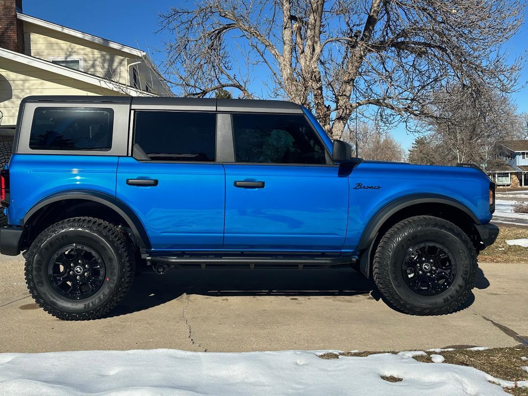

I ceramic coated mine myself. Super easy doing the top as you don't need to perform paint correction on the mic top. No clay bar or polishing needed - give it a good wash, use some surface prep (dilututed alcohol) and apply the ceramic. I used Gtechniq Crystal Serum light on the entire vehicle including flares and bumpers.
