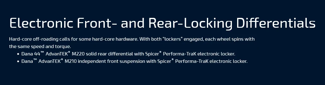

I think the service center was just more curious as to why I would be straying off of the recommended for any warranty concerns down the road. I had brought friction modifiers initially when it seemed like maybe they were talking about bulk gear oils of the right weight, they said they can add friction modifiers, I had the conversation with them about what I had read that any name brand synthetic gear oils will already have any of that it would need, if essentially needed at all. Seems like they were open to help me find the cheapest budget route or try to understand why I am wanting to stray off the recommended. Honestly the more I think about the intervals I might be doing these myself at the house and order the little funnel off Amazon.
Just know that friction modifiers are not required at all in electronic locking differentials which is what is in a Wildtrak.

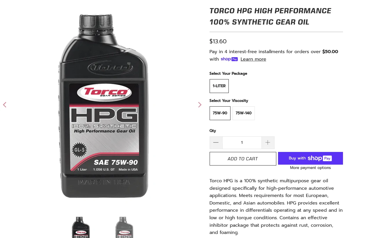

Also, what are your thoughts on this stuff? Its almost to much of a coincidence I stumbled onto it in research an the available viscosities.
Ford Bronco Change Driveline Fluids Early! Screenshot 2024-03-14 at 09-39-34 Torco HPG High Performance 100% Synthetic Gear Oil

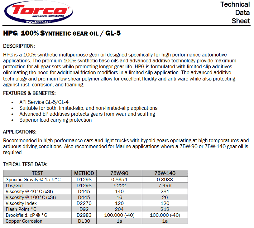

Screenshot 2024-03-14 at 09-39-34 Torco HPG High Performance 100% Synthetic Gear Oil.png
Ford Bronco Change Driveline Fluids Early! Screenshot 2024-03-14 at 10-31-04 Microsoft Word - HPG TDS.docx - HPG_TDS.pdf

Also, what are your thoughts on this stuff? Its almost to much of a coincidence I stumbled onto it in research an the available viscosities. (Never heard of it, but there are many branded oils that are made by companies like Warren Oil--not saying this one is. I would grab Valvoline or Mobil 1 from your local Walmart. Doubt you will find it cheaper anywhere else and Mobil or Valvoline will work perfectly in the axles. Valvoline has flex packs that make the installation of the oil a breeze).

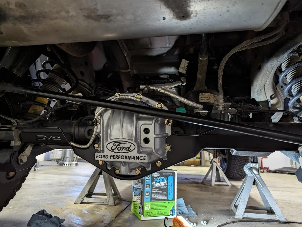

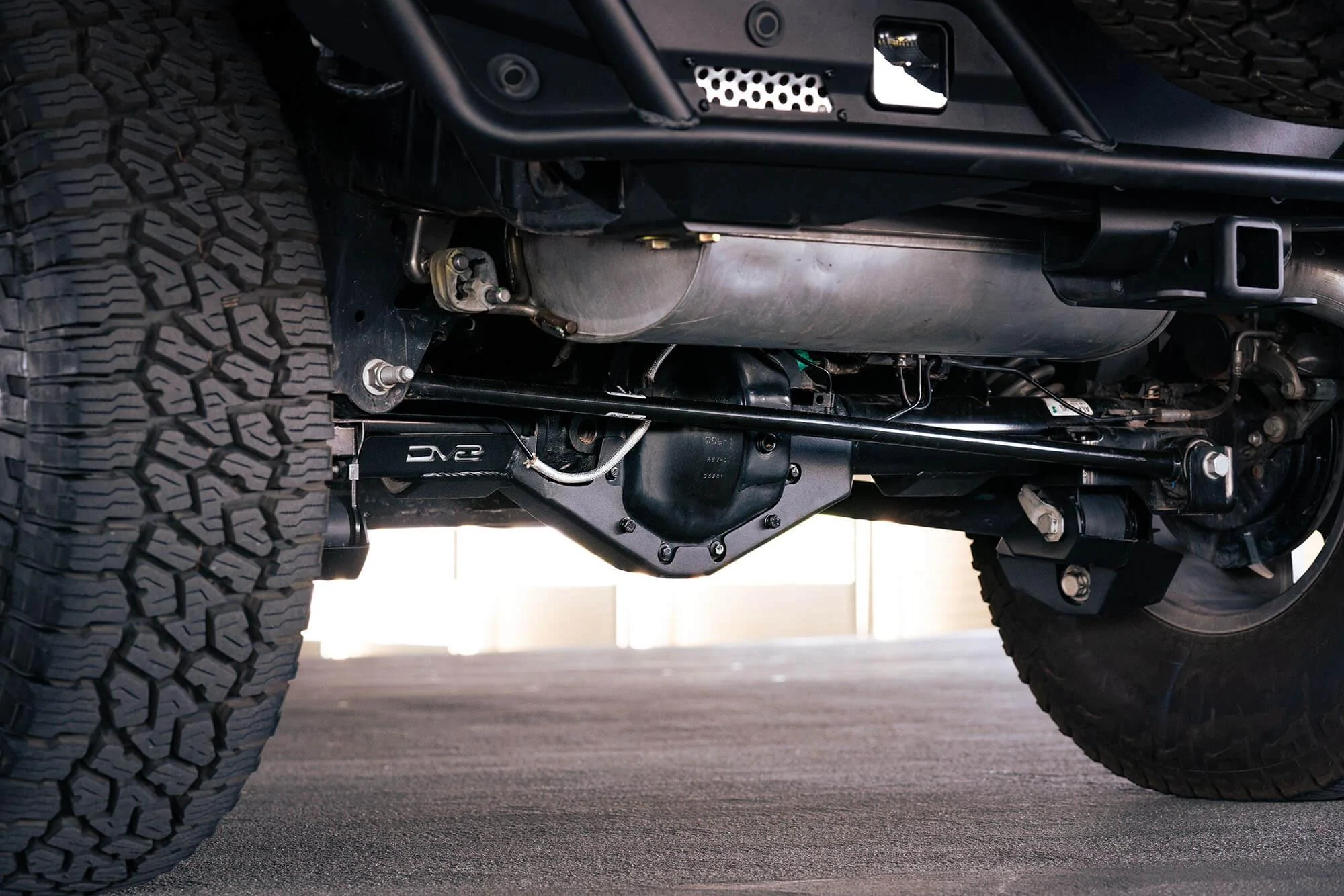

It looks like I will have the same issue with the DV8 rear diff skid. I just ordered the FP Rear cover and I haven't gotten the DV8 skid out yet but by their picture, there is going to be a lot of grinding involved to get it to work. :confused:
This last weekend I changed the front diff, rear diff and transfer case fluids. I tried several different ways to put new fluid in and I've come to the conclusion its a mess no matter what. :p
One thing I wish I would have realized prior to removing the rear diff cover is that the top of the stock diff plate plus the thickness of the gasket holds a lot of dirt and dust. When I removed the cover and all kinds of crud fell down on the gears. I was not a happy camper. Tried to wipe it out the best I could but I know I didn't get it all. Just clean the top as good as you can prior to opening the cover!
I installed the FP Diff cover plus the DV8 diff skid which I had to modify to fit over the new cover. I think it came out pretty good and I have the benefit of the new cover plus protection.
Ford Bronco Change Driveline Fluids Early! Rear Diff Cover and DV8 Diff Skid Install
