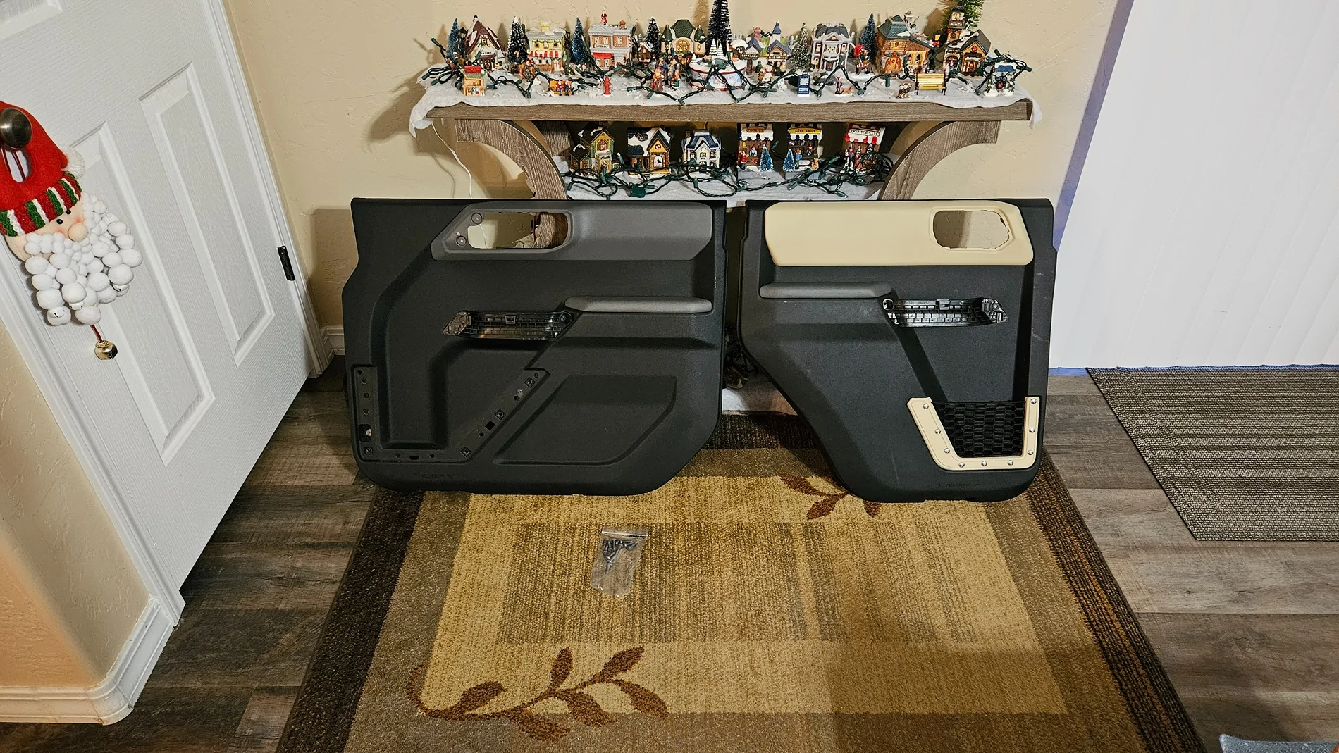

So I found some videos on YouTube but the only way to remove the rear door pockets is to remove the entire door panel and then drill out the tabs from the inside. You can remove them and install aftermarket pockets, but no way to reinstall factory ones? I assume the ones on the back of the driver and passenger seats are the same.

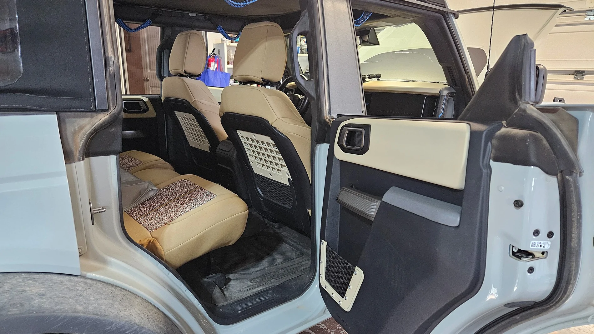

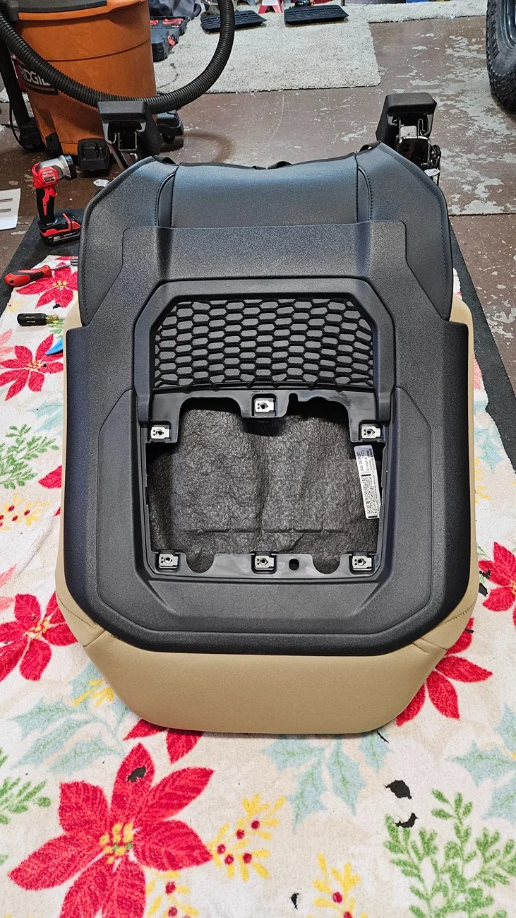

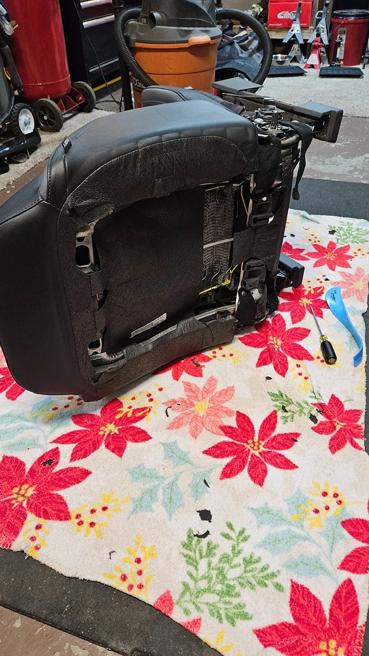

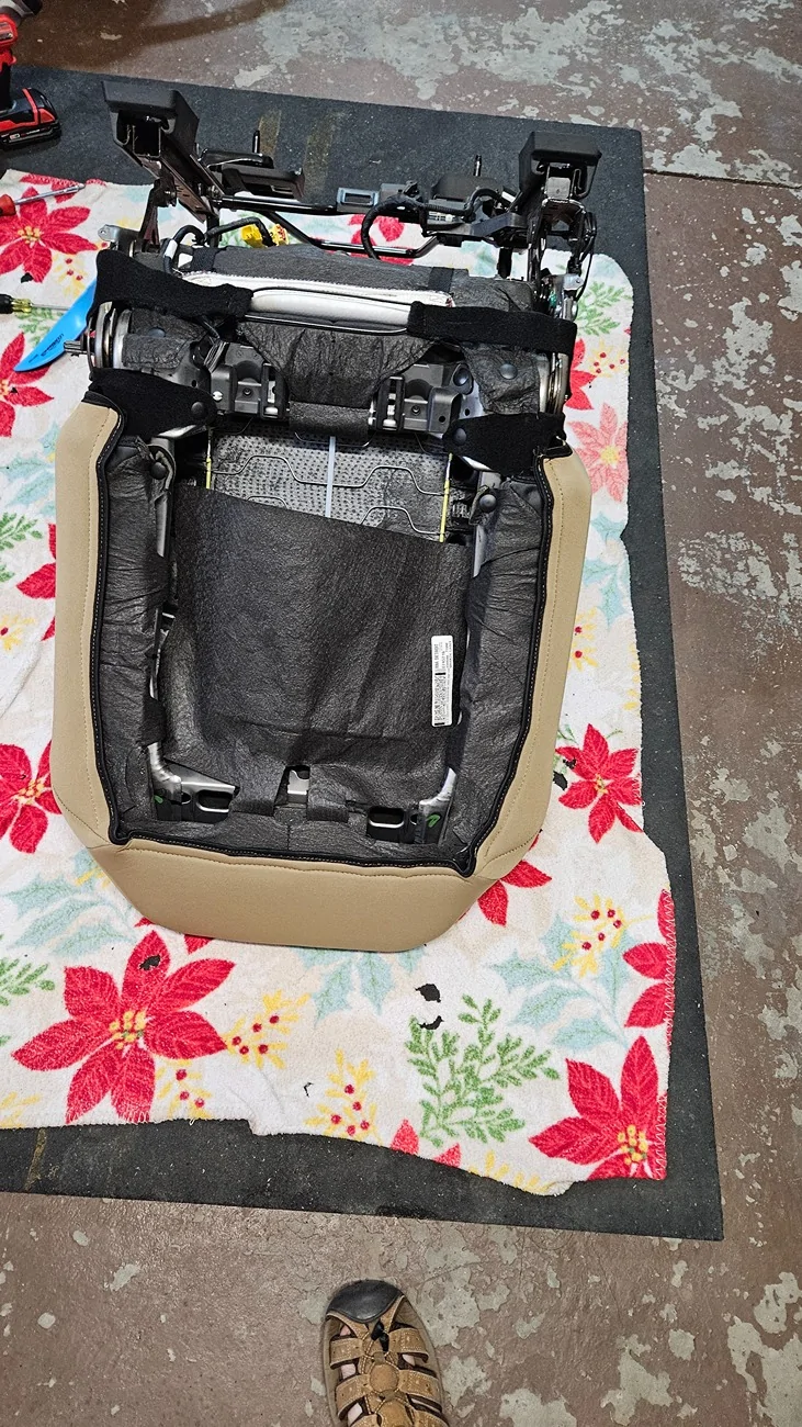

I just drilled out the door pockets and used nut and bolt. The back of the seats molle panels come out. They snap in and out from what I remember.
Here are some pictures that I dug up...

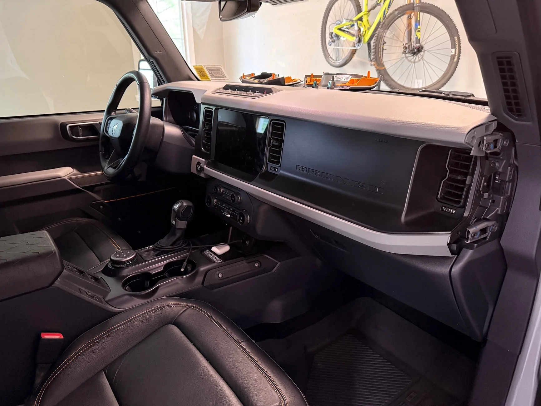

First step is done, black air vent tabs from BD USA (really nice product but a bit expensive) and ford center grab handle delete. I ordered some matte black overlays for the grab handles near the doors from stickerfab.
The only thing I can't find a great replacement option for are the door pockets. All of the aftermarket ones protrude too much into the footwell and that still wouldn't solve the issue on the back of the driver and passenger seats. Ford sells replacement ones for $200 a door, which is an absolute joke and replacing the four in the back of the car isn't as straightforward.
