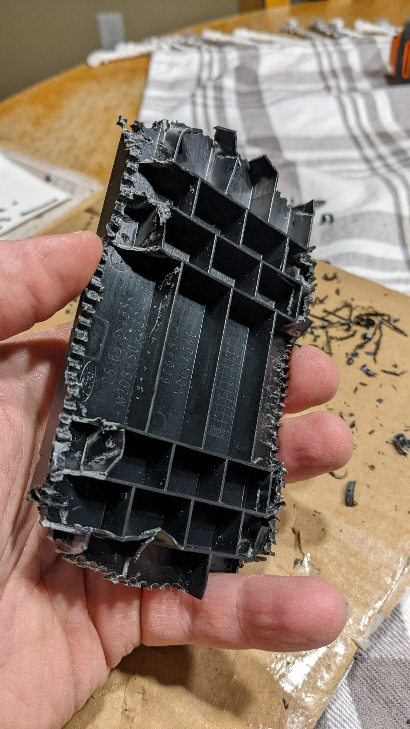

Stage 1: extricate the unwanted plastic from the console insert plug.

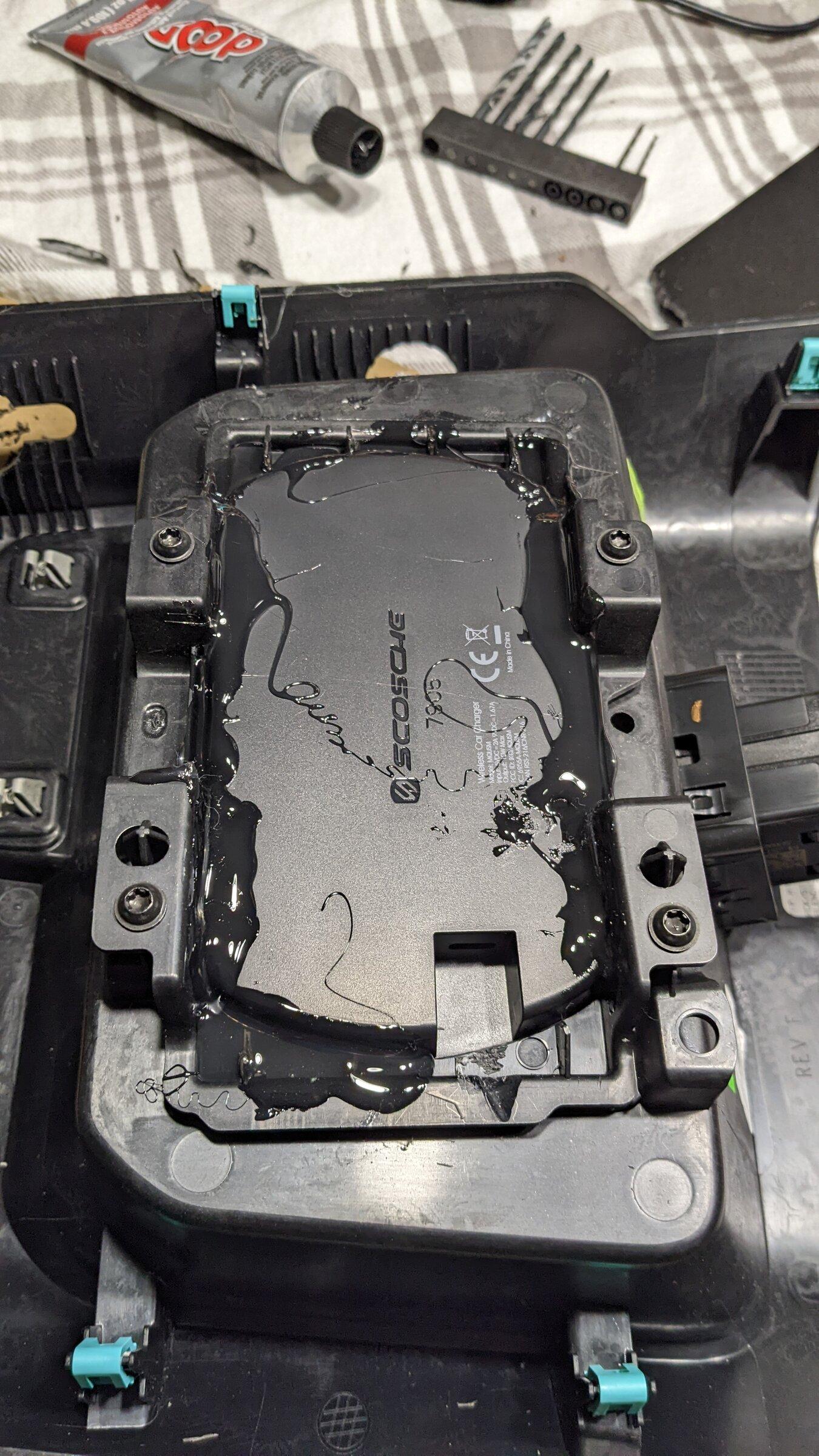

Stage 2: Glue in the charging pad with copious splooges of Goop automotive adhesive.

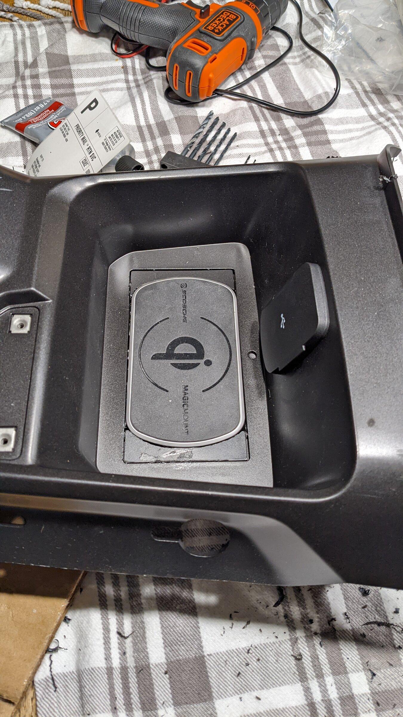

Stage 3: Install charging adapter on 2 of the 4 power wires feeding the inverter in the console. (no pics were taken).
Stage 4: Revel in your awesomeness for being a tightwad and enjoy your new wireless charging pad. 😁

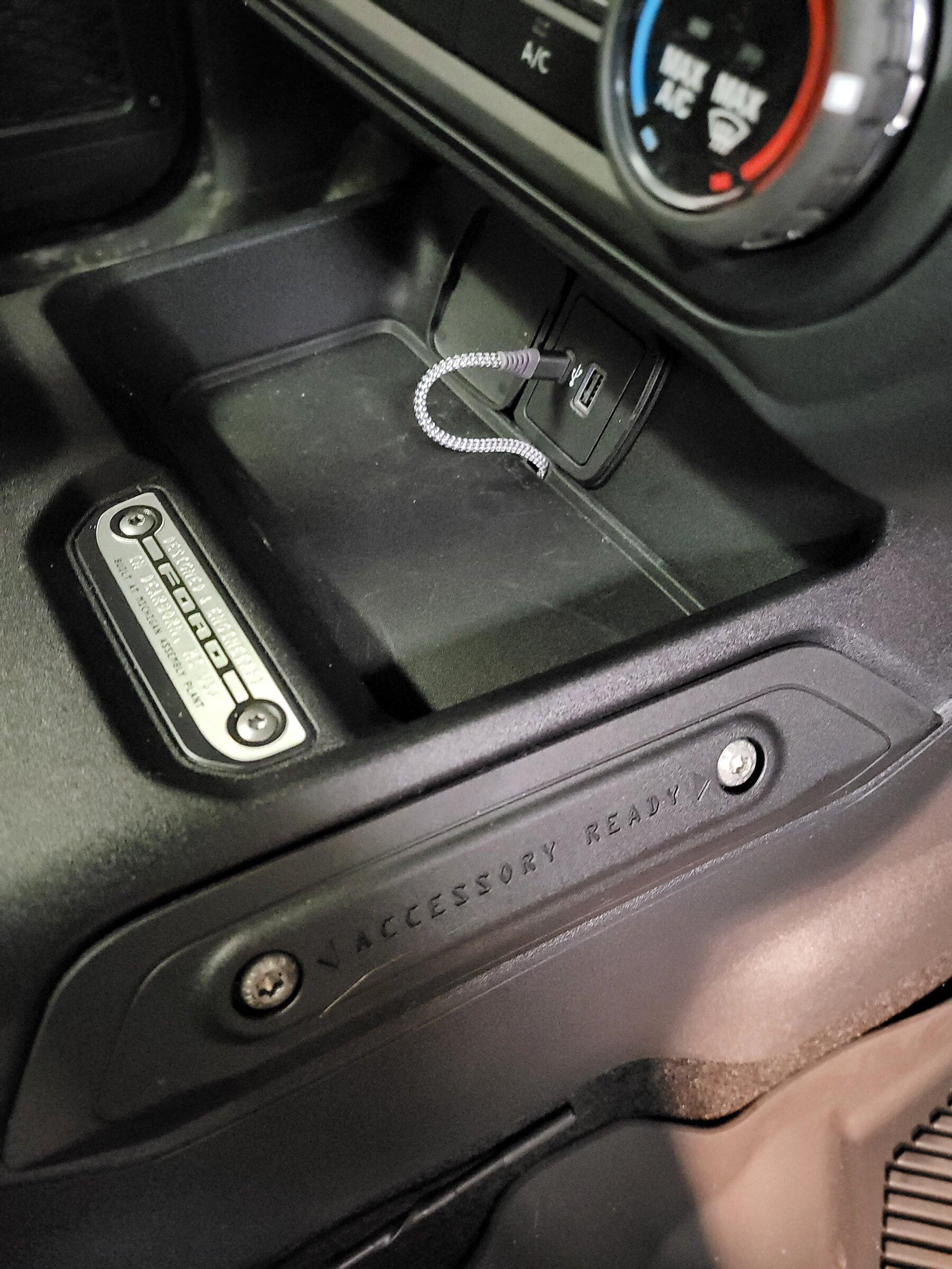

Silly but honest question? How thick is the charging pad? Could one just flip that plastic price over screw in with longer screws and put the rubber back in place?

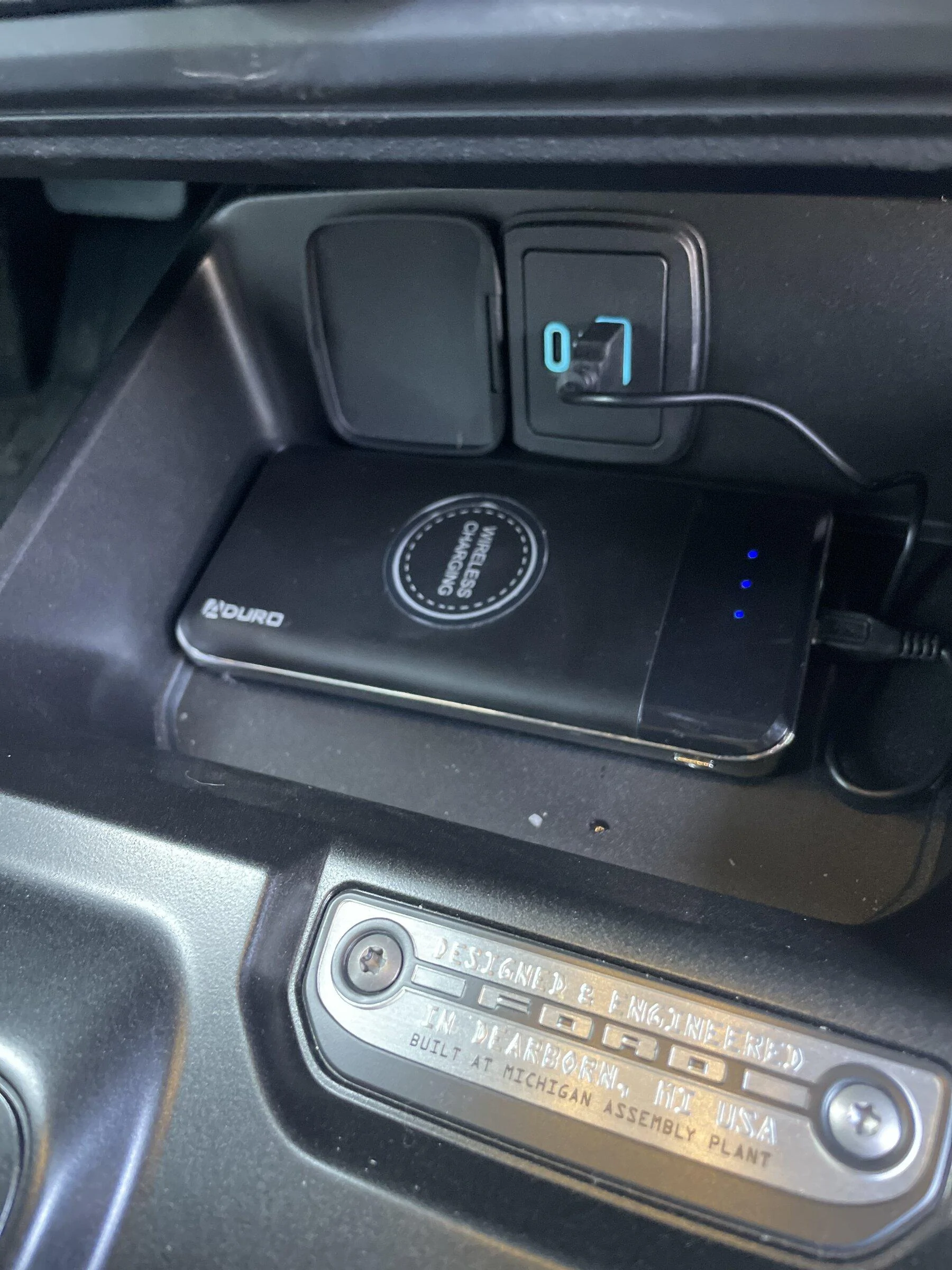

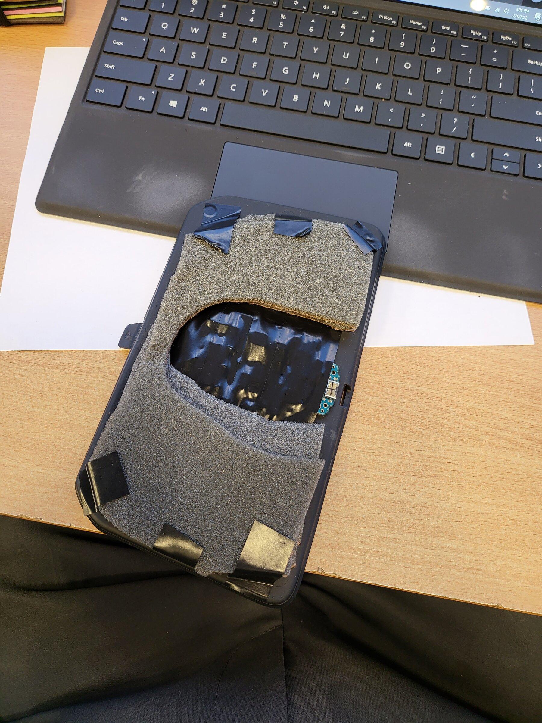

I took the circuitry out of a wireless charger and taped them to the back of the rubber mat. Added some foam so it sits flush, and picked up a 3" cord off Amazon.
The charging pad was about 3/8" thick. It was nearly identical thickness to the section of "plug" insert it replaced.
I put my rubber pad back in so this is invisible in daily use, but I like using my skills.
