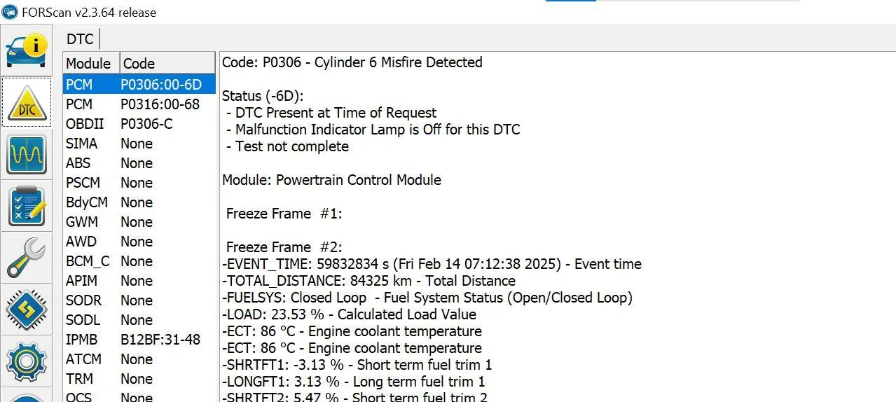

Bronco is currently at the dealer waiting to be further evaluated by Ford. My favorite independent shop already ran a few test and ruled out plugs and coils for the misfire codes. They did the compression test and verified low compression on C6. Anyone else have experience here?
Could be a number of different things, even if it is compression related. I’d be surprised if it is, but let the dealer do their diagnosis and see what they say
