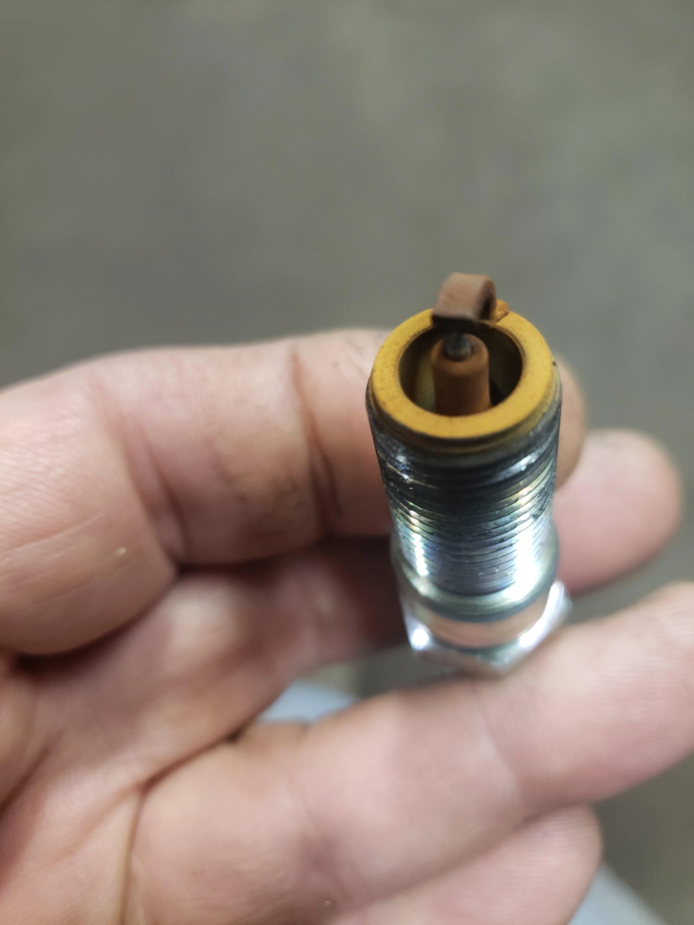

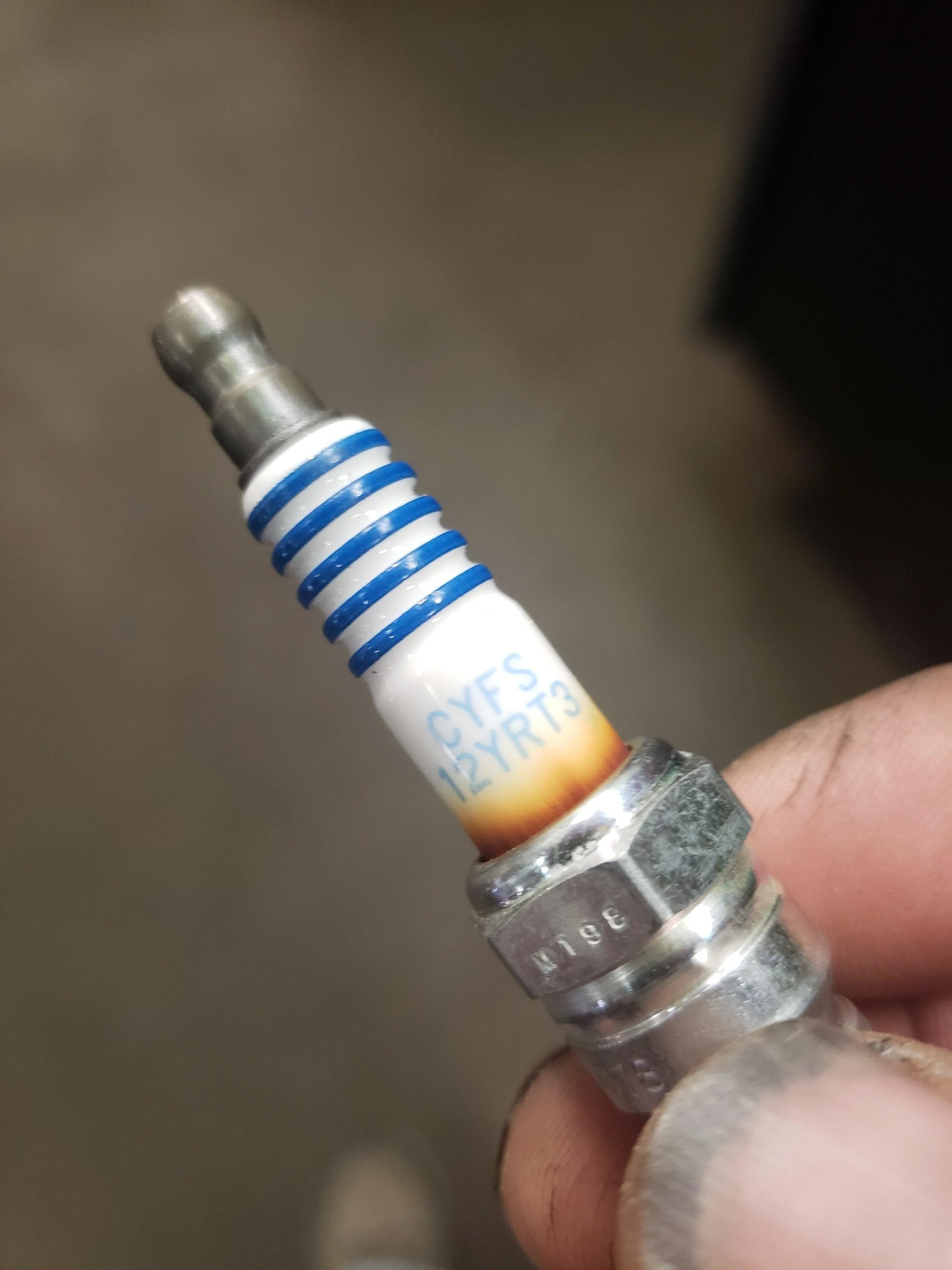

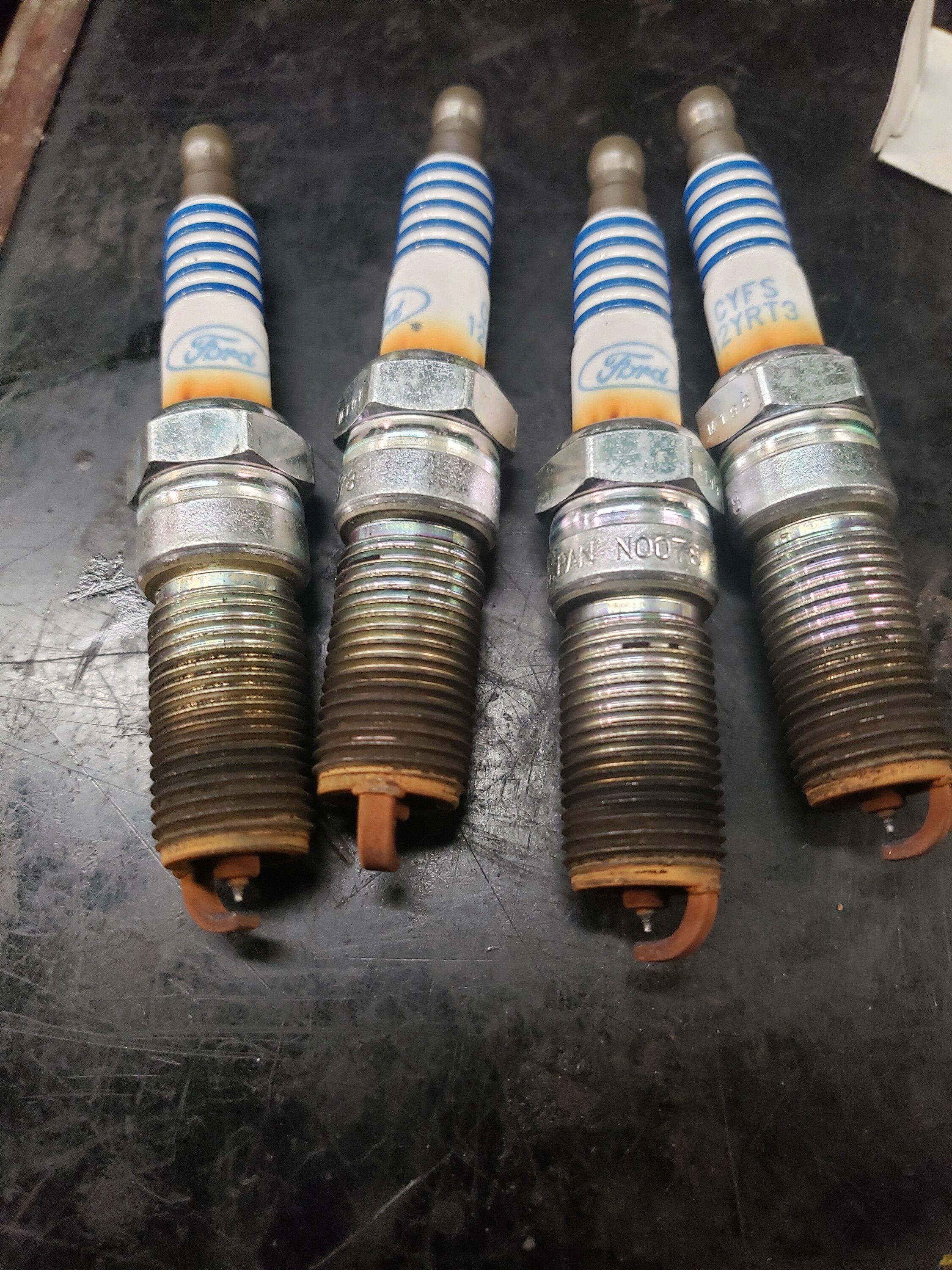

Yep, thats what they were! They don't show any sign of lean out...which is good. The amount of red oxide on em from only 10k leads me to believe they are a tad warm for the amount of boost I'm getting. Think the NGK 6510s are a good call at this point!
