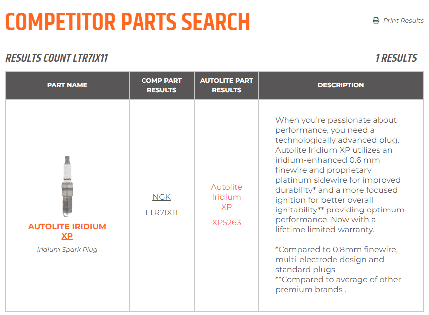

My book has zero listing for Bronco, but 21 Ranger I come up with motorcraft SP-594, and autolite XP-5863. My paper copy that shows heat ranges doesn't go that far tho. Would SP-594 be correct for Bronco 2.3L? I can at least start there...assuming that XP5683 is the equivalent heat range, then XP5263 may be exactly what I want...and that crosses over to your NGK# above
Yes, Ranger and bronco use the same plugs, so if SP-594 works for a 21 ranger, it'll also work for Bronco.
