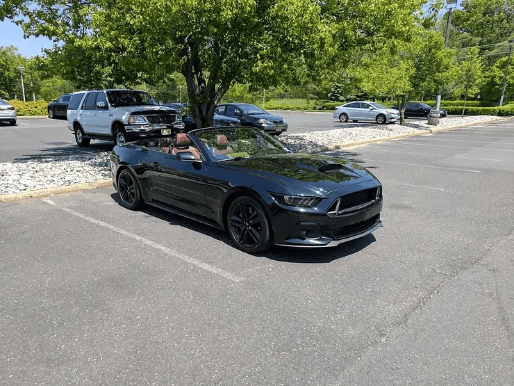

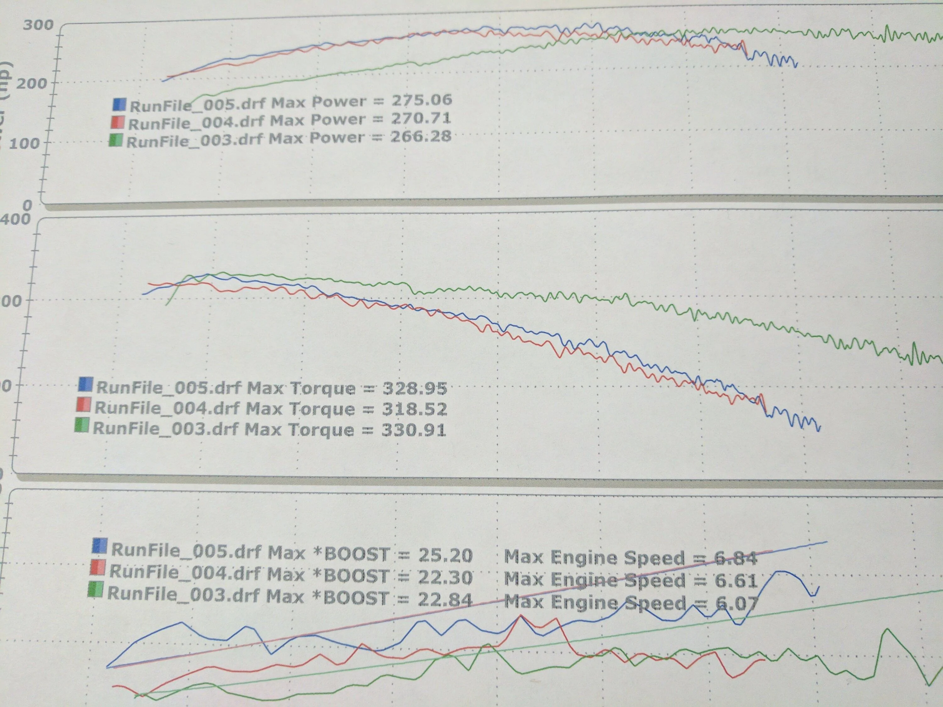

I'm still looking at Mishimoto, figure go catalog, and then after whoever produces the downpipe, I'll wait to see which catback works without drone:
Ford Bronco Preference concerning CAI for 2.3 1679065414716
Ford Bronco Preference concerning CAI for 2.3 Gia Dyno
CFM Baffled Billet Valve Cover Breather Kit
MMR CAI
UPR Dual Valve Oil Catch Can
FFTec Charge Pipes
Synapse DV
Steeda Throttle Body Spacer
Boomba Intake Manifold spacer
NGK 6510
FFTec Street Intercooler
Krona Catted DP
Turbosmart Wastegate Actuator 10psi
JDM Tuned using SCT4
Dyno results are low since their (JDM's) rollers are for F150s, on a regular dyno before the Downpipe and wastegate actuator I was at 311whp
That's why I can't keep them stock, I know what our girls are capable of, and that's before ya upgrade the clutch/flywheel, and the ecu's cracked to take advantage of parts like this big turbo

Man that’s low.. you needs to talk to Adam at Tune+, you should be at 400hp with a tune

it was 311 prior on a regular dyno, dyno JDM uses is for F150s, so heavier duty
Also traded her to get my truck

Gotcha, yeah all this 2.3 motor needs is the radium port injection, e85, t3/t4 turbo it’ll make 450hp comfortably all day

Dynos are dynos. Typically the only variable is the load they induce and usually are not translateable brand to brand. That said you appear to have used a dynojet which is one of the most friendly when it comes to higher figures so I would not take the "f150" excuse unless there is something tangible associated with the comment.

All I know is it felt more powerful towards that point and it was a Ford shop instead of a general tuner

No worries - just sharing information as I have dynoed a multitude of personal cars over the years on Dynojets, Mustang, MAHA, Dynomite, Superflow, etc. ranging from 200whp to 1200whp.
Dynojets are actually the most consistent dyno to dyno typically.

Appreciate it, gotta see what they use
