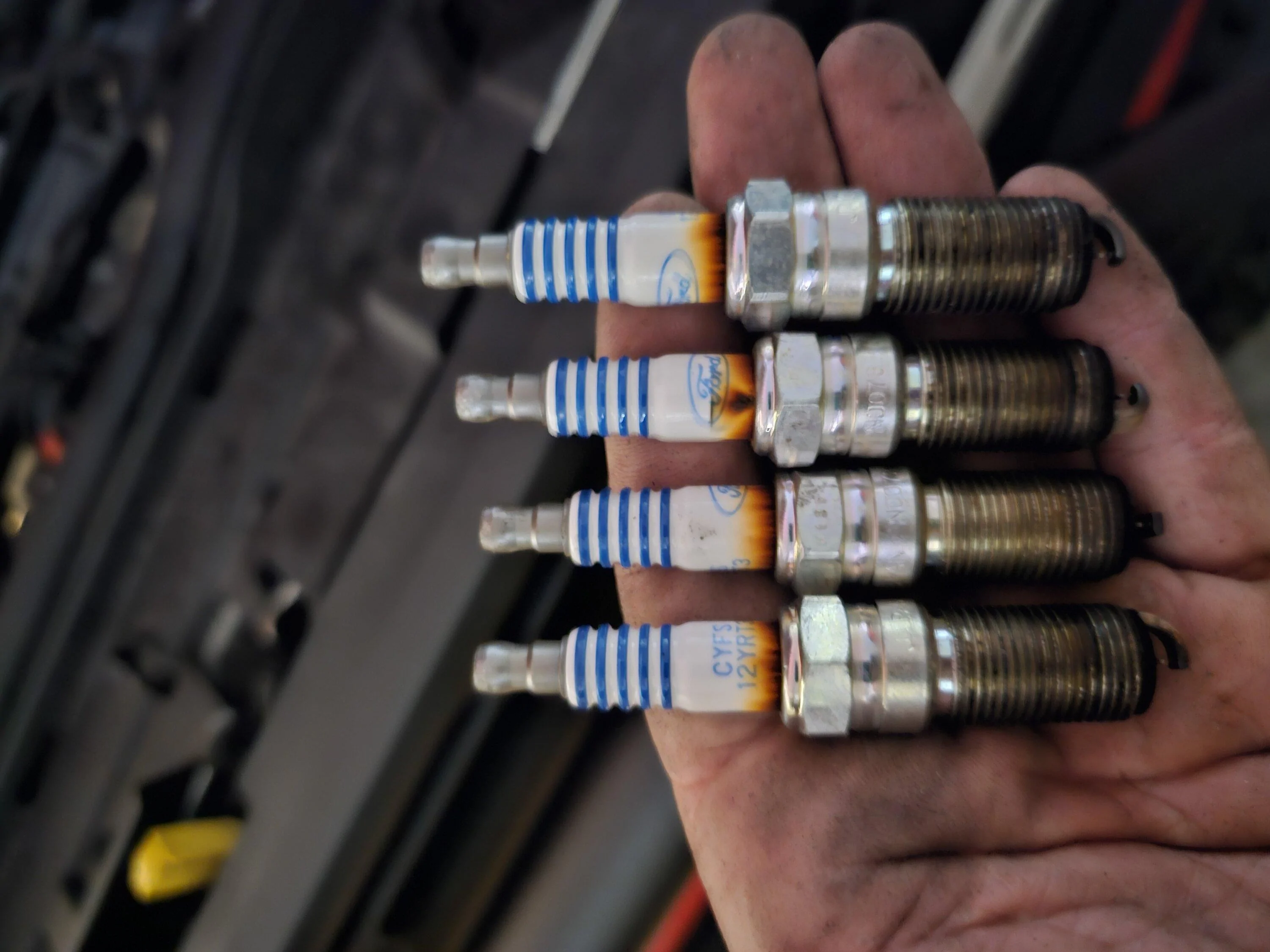

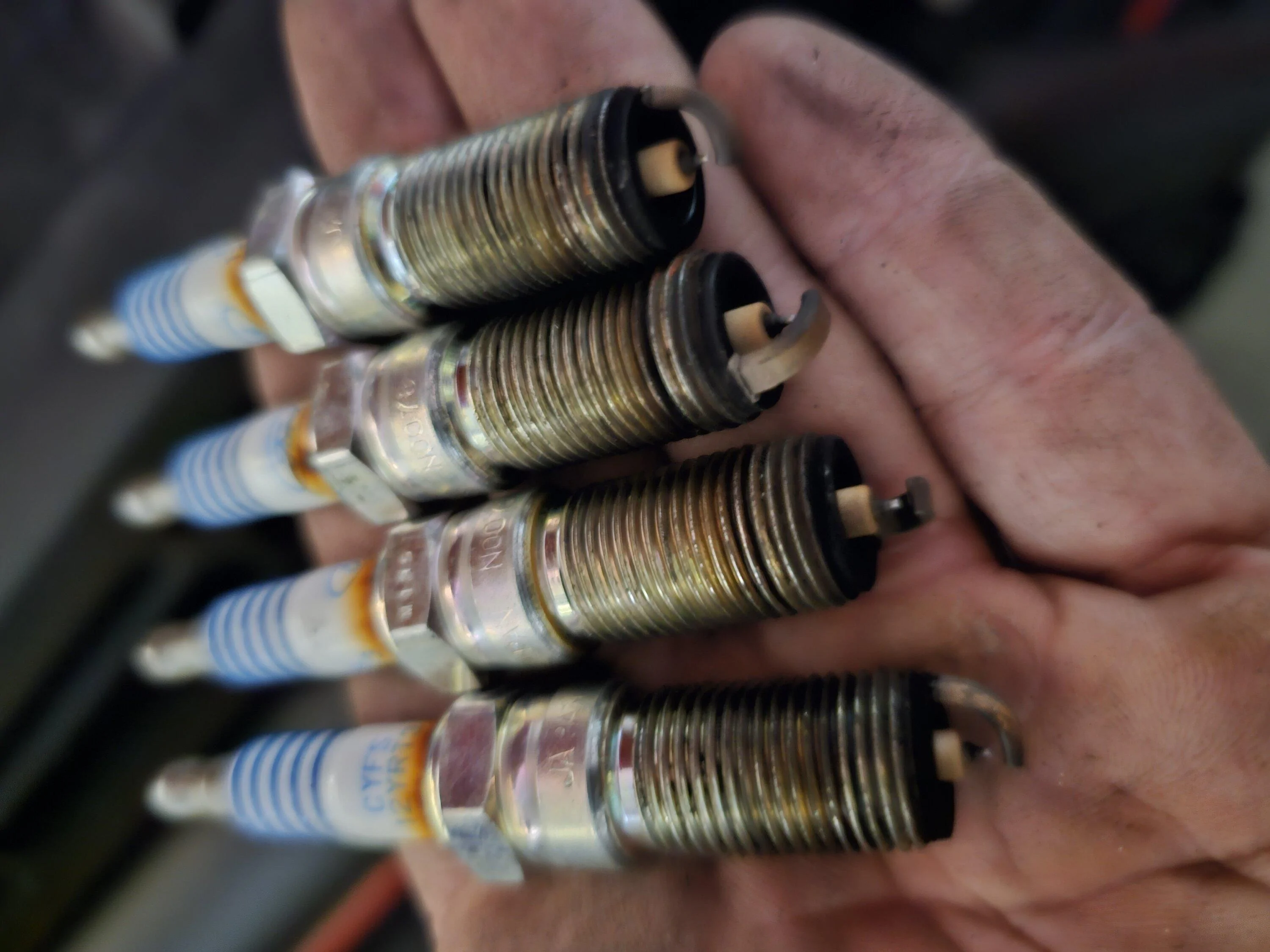

23k miles - stock plugs. Lots of mods. Running at 25 psi peak boost for the past couple of months. Switched these out today for the NGK 6510. I had noticed a slightly higher idle lately after pushing the engine pretty hard with the stock plugs in terms of idling at high 800s low 900s so maybe the new plugs will help get idle back down to normal. I gapped the new plugs at 0.026 per Panda, though, as someone mentioned on another thread, most ecoboost people say 0.028 is the way to roll.
Stock plugs were all gapped at 0.30 when they came out.
Just took her out for a test drive - warm idle is back down to low 800s and noticeably more pep with the new plugs...
