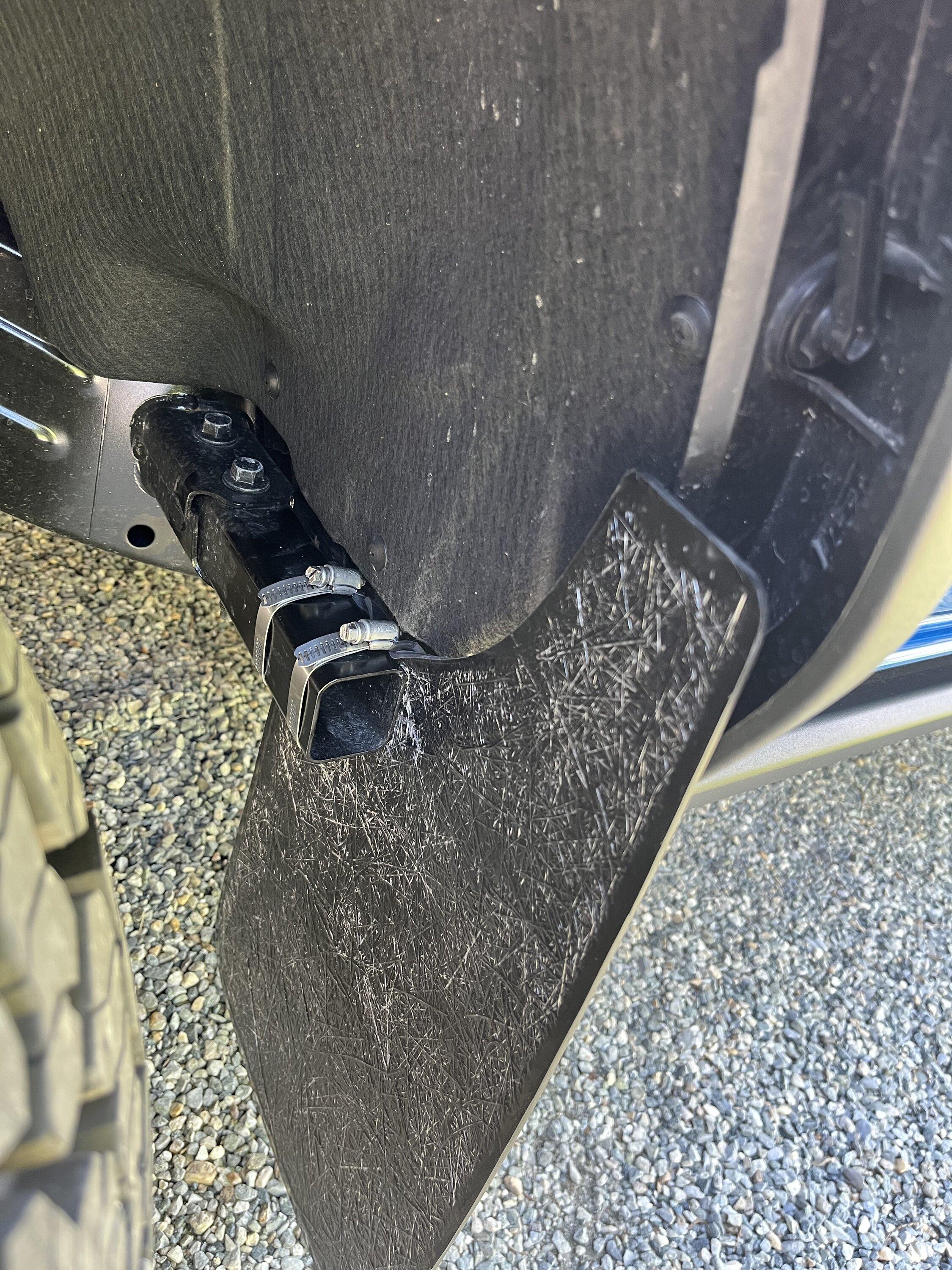

Amazon Ford mud flaps and 2 stainless plumbing straps.

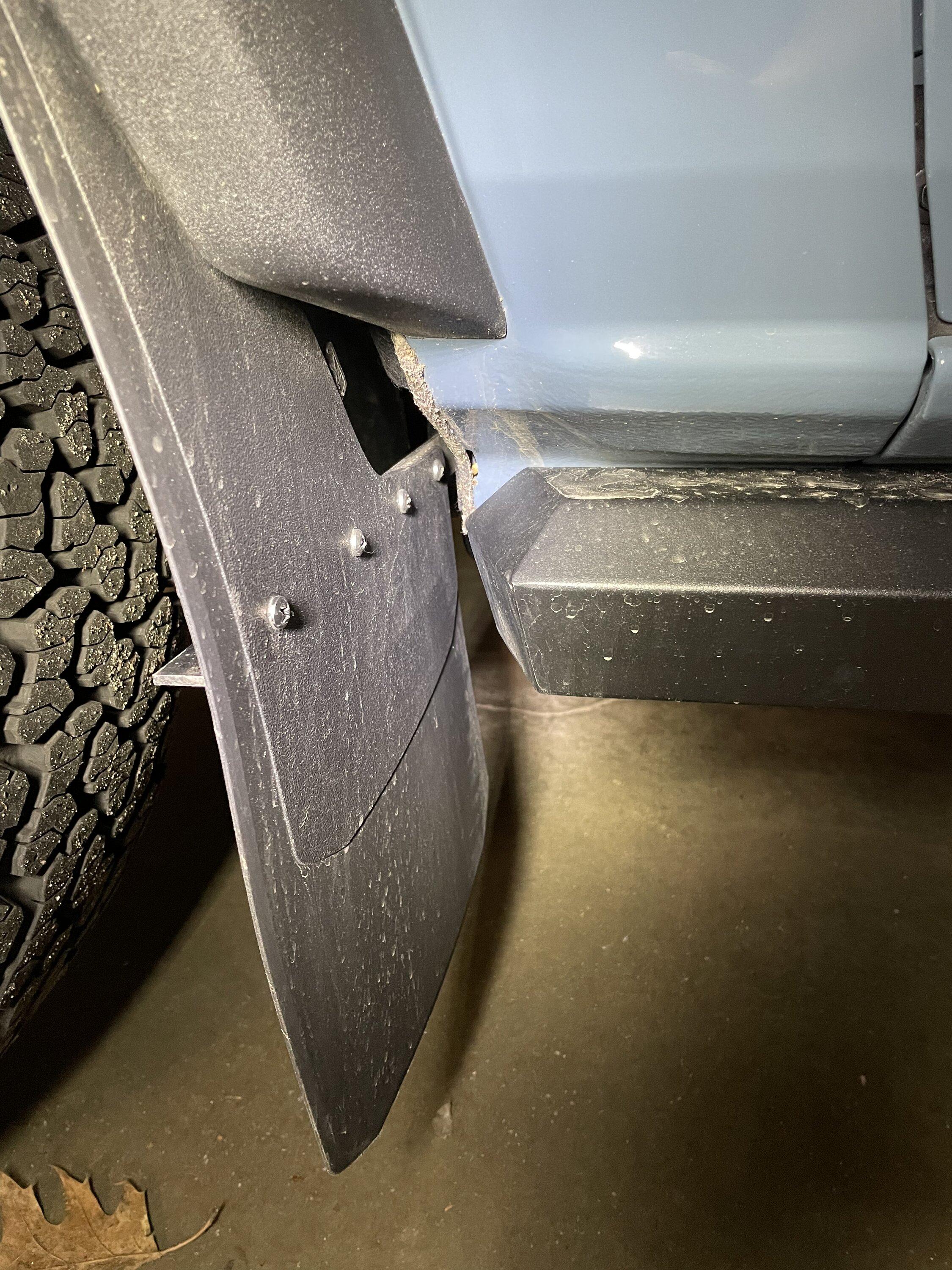

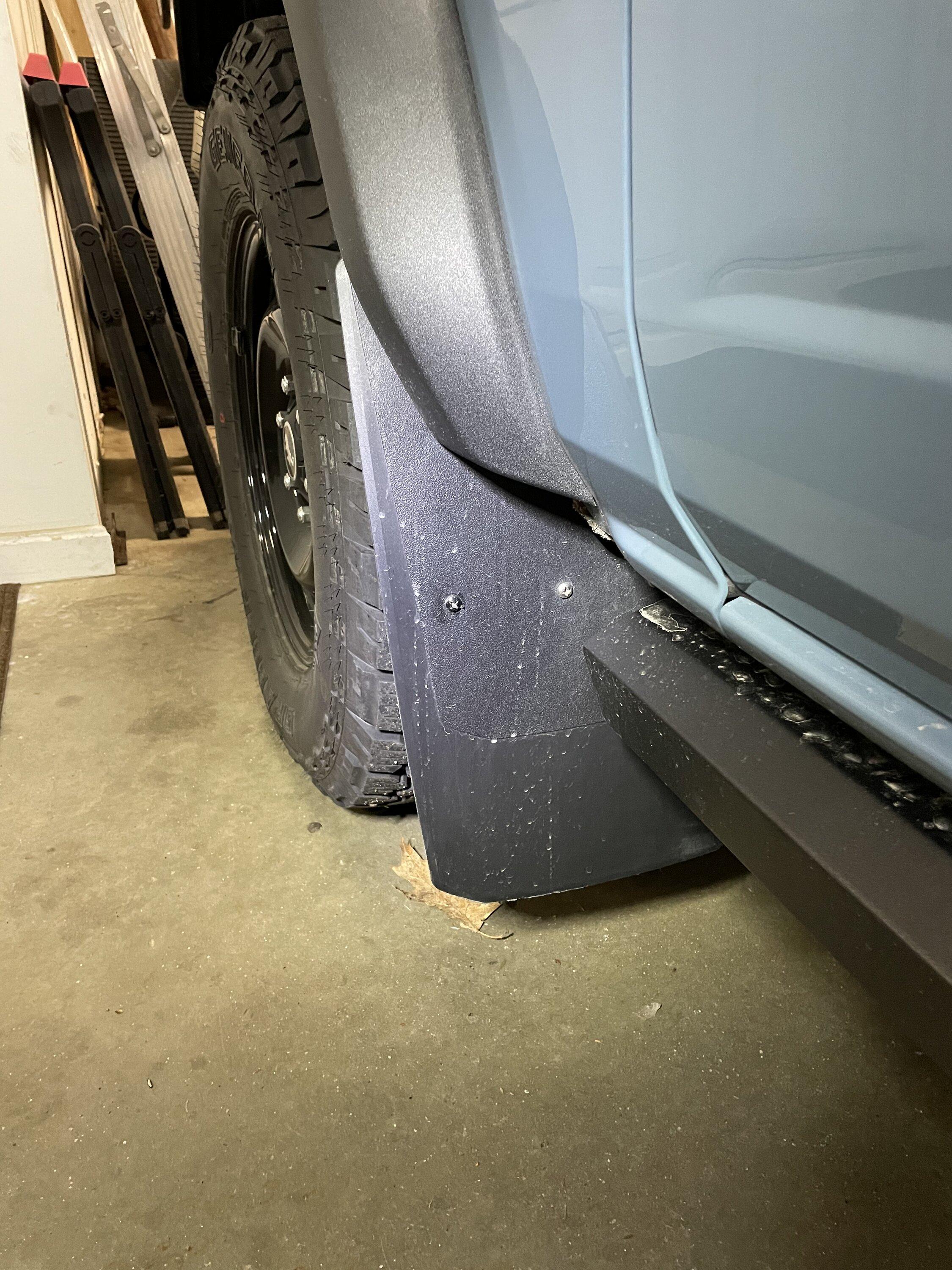

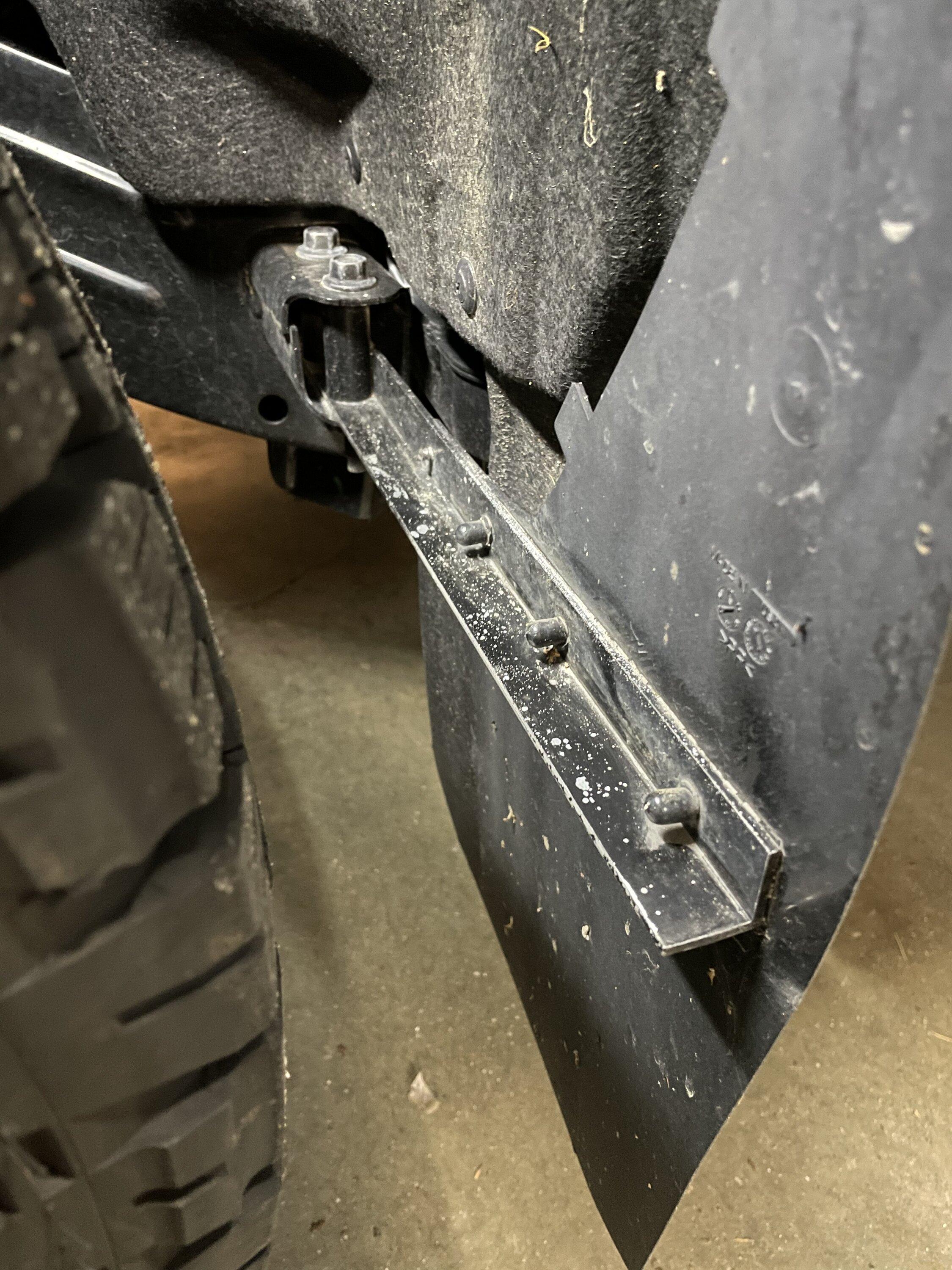

Ha! I did something similar with $20 flaps from autozone I attached to the crashbars with the factory bolts using aluminum angle bar and stainless self tappers. Works great at one eighth the price of other solutions.

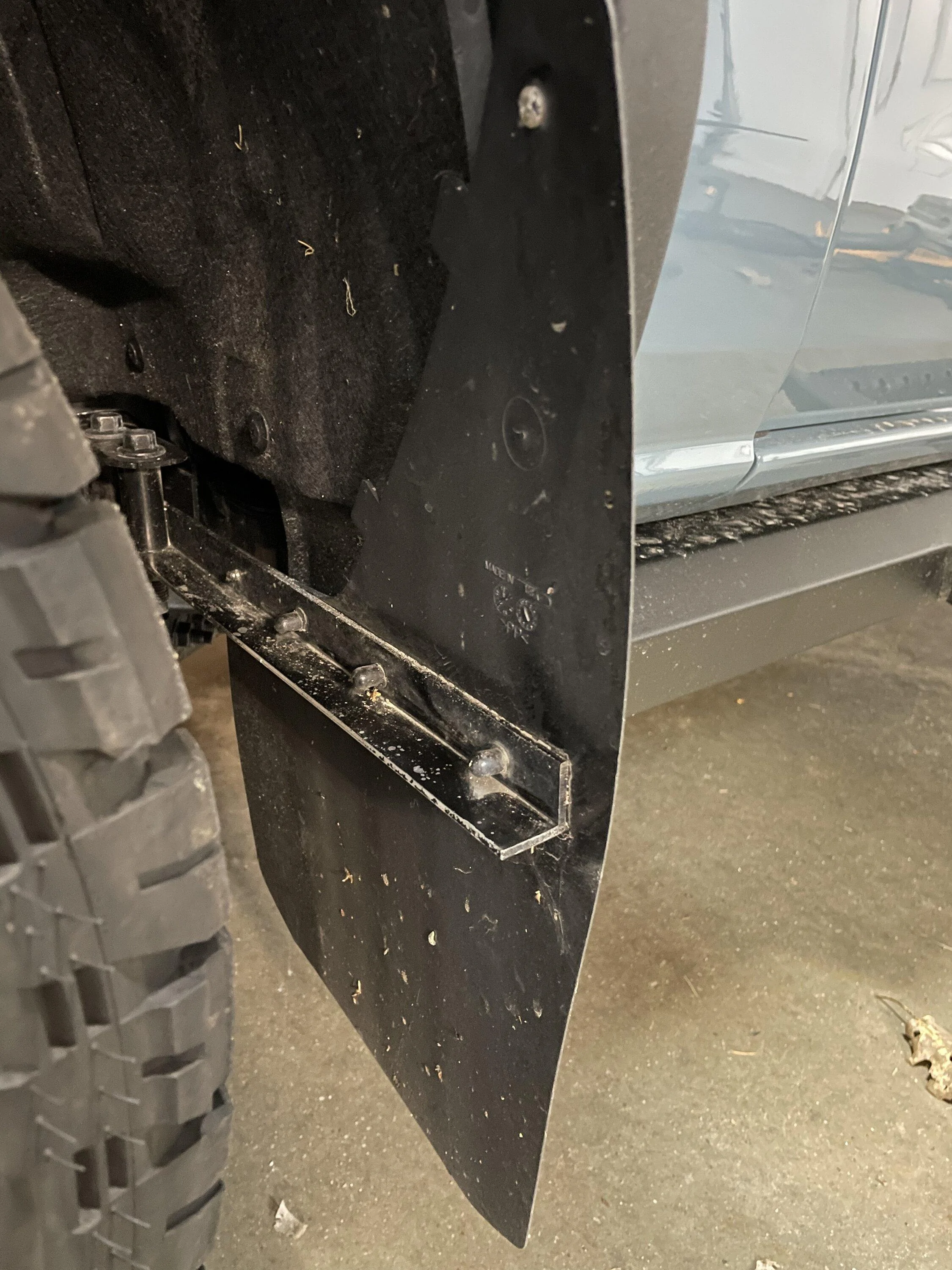

Can you attach a photo, im curious. ❤
The spacers you see at the crash bar mount is just PVC pipe cut to fit just inside the crashbars and are painted black. The self tappers are stainless. It does not interfere with factory crash bars or the side steps I subsequently mounted

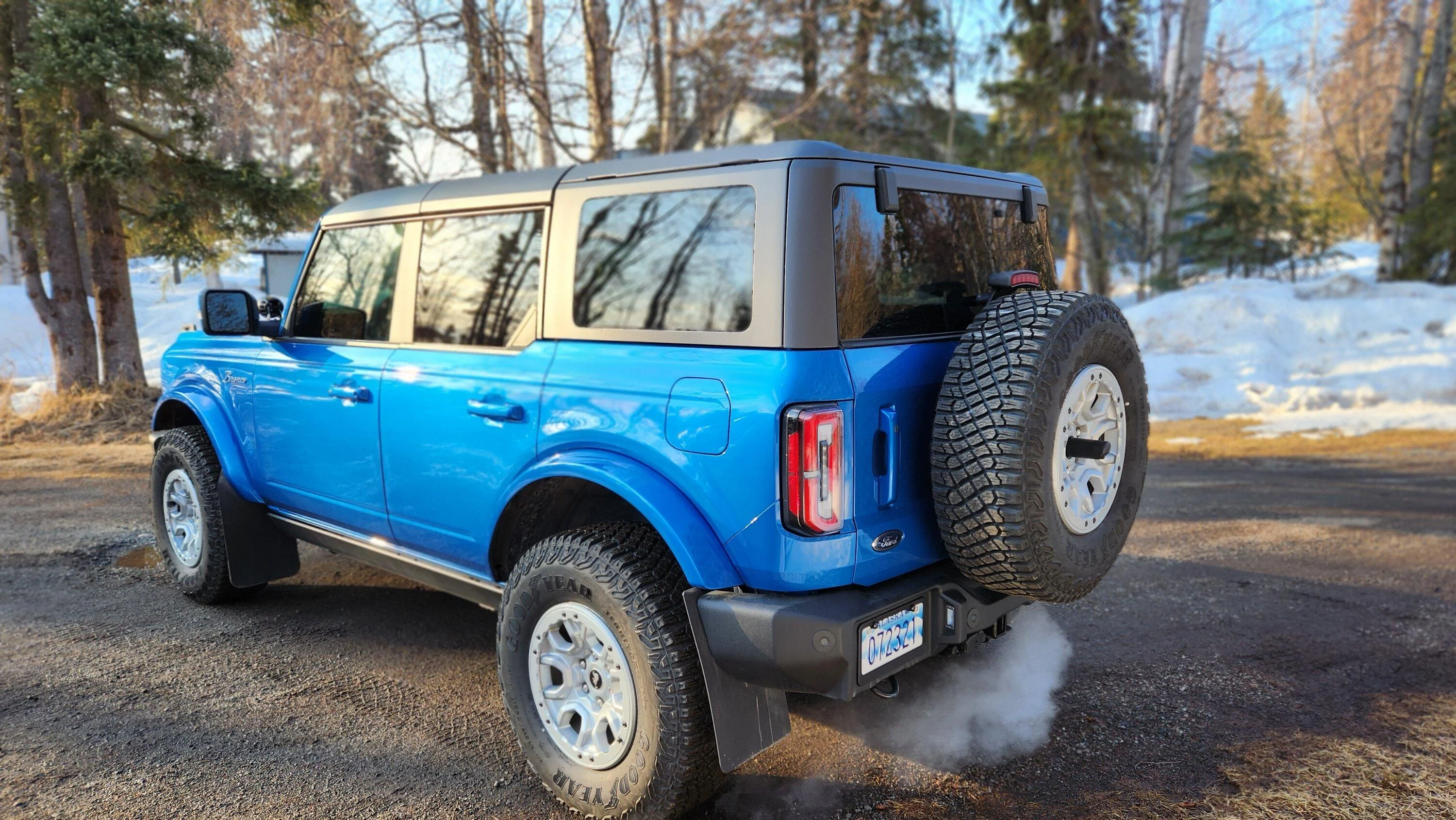

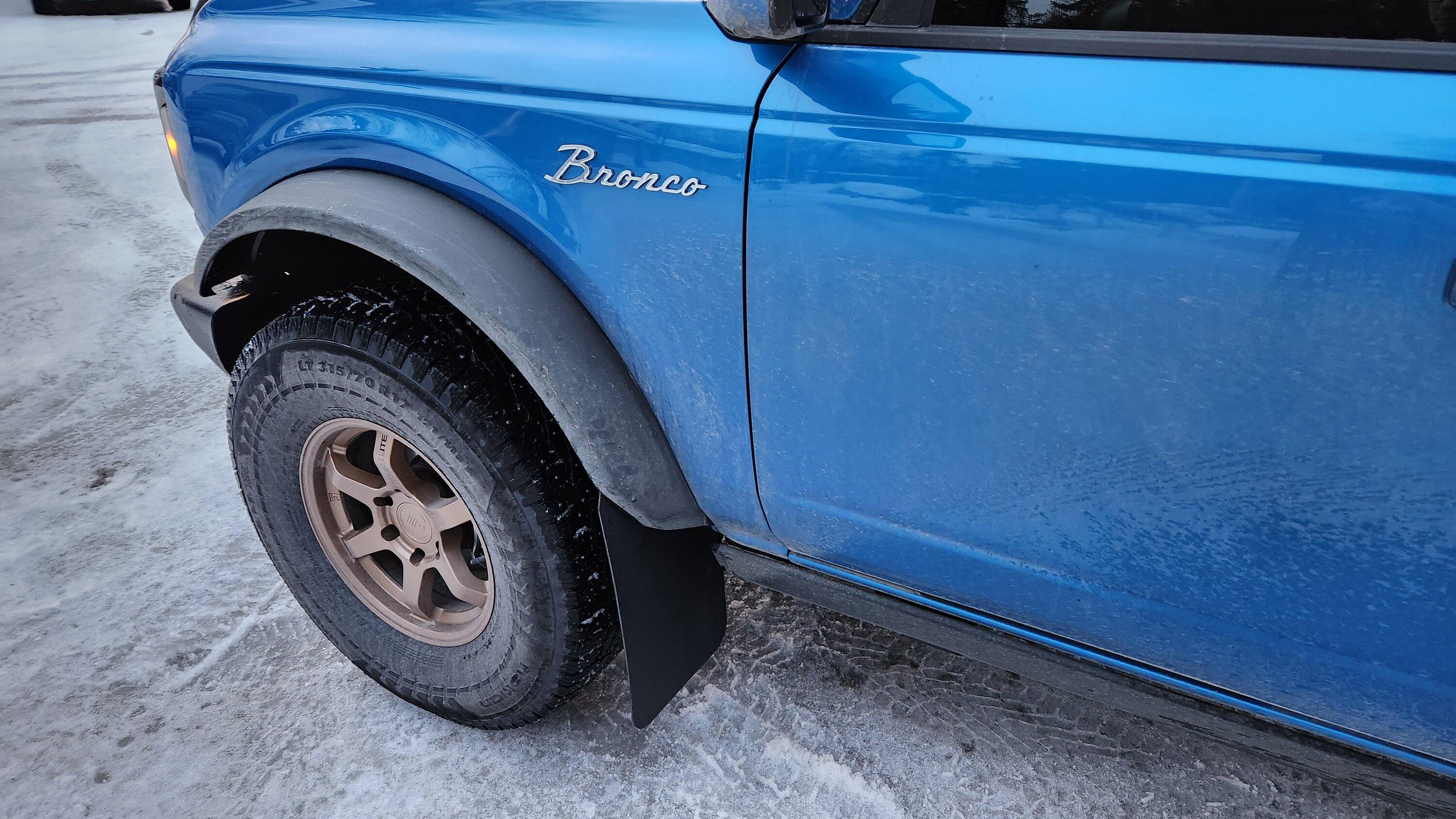

I used some universals and fabbed some mounts on the front. After taking the fixed running boards off I had to put longer front ones on.
