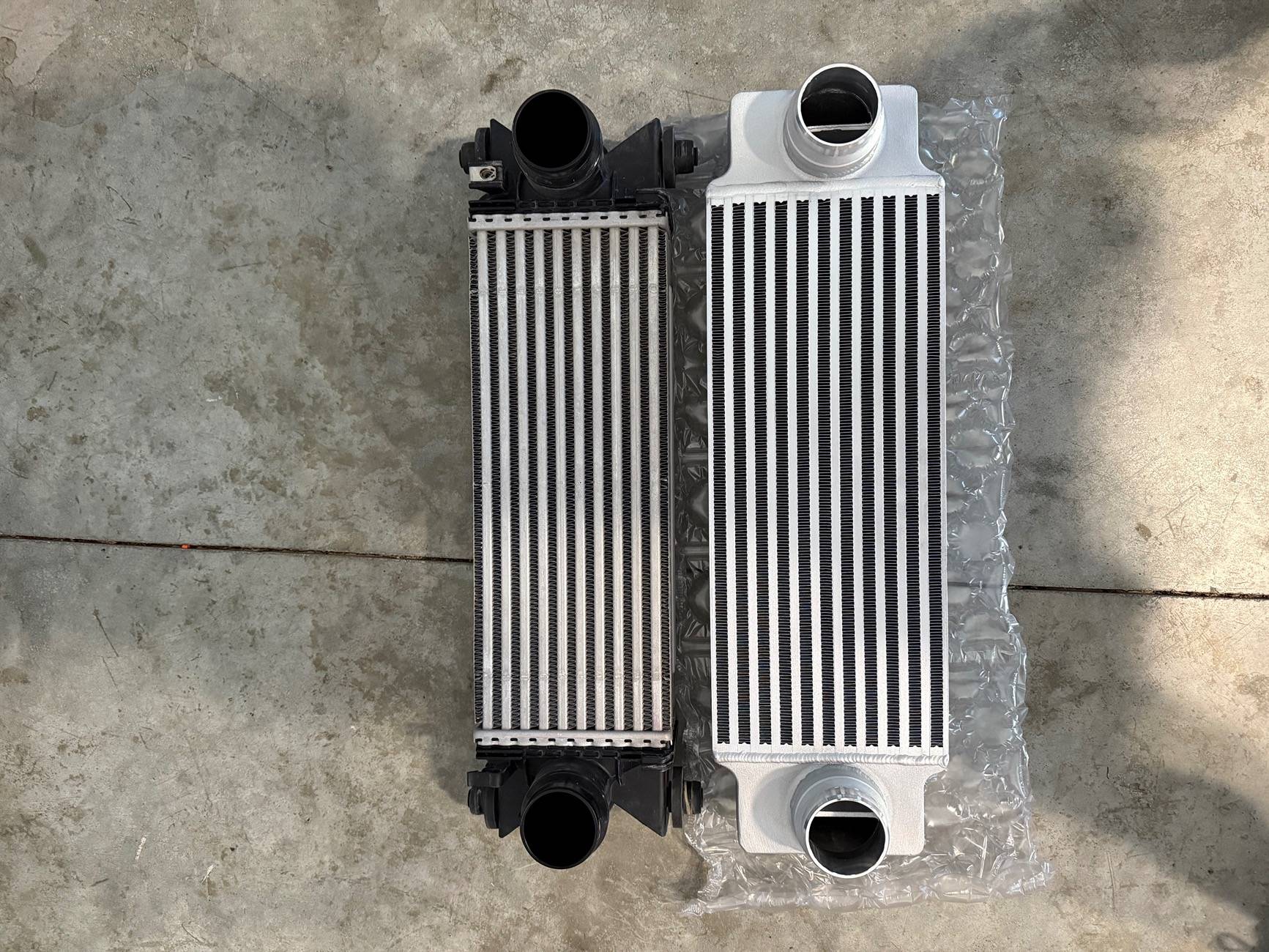

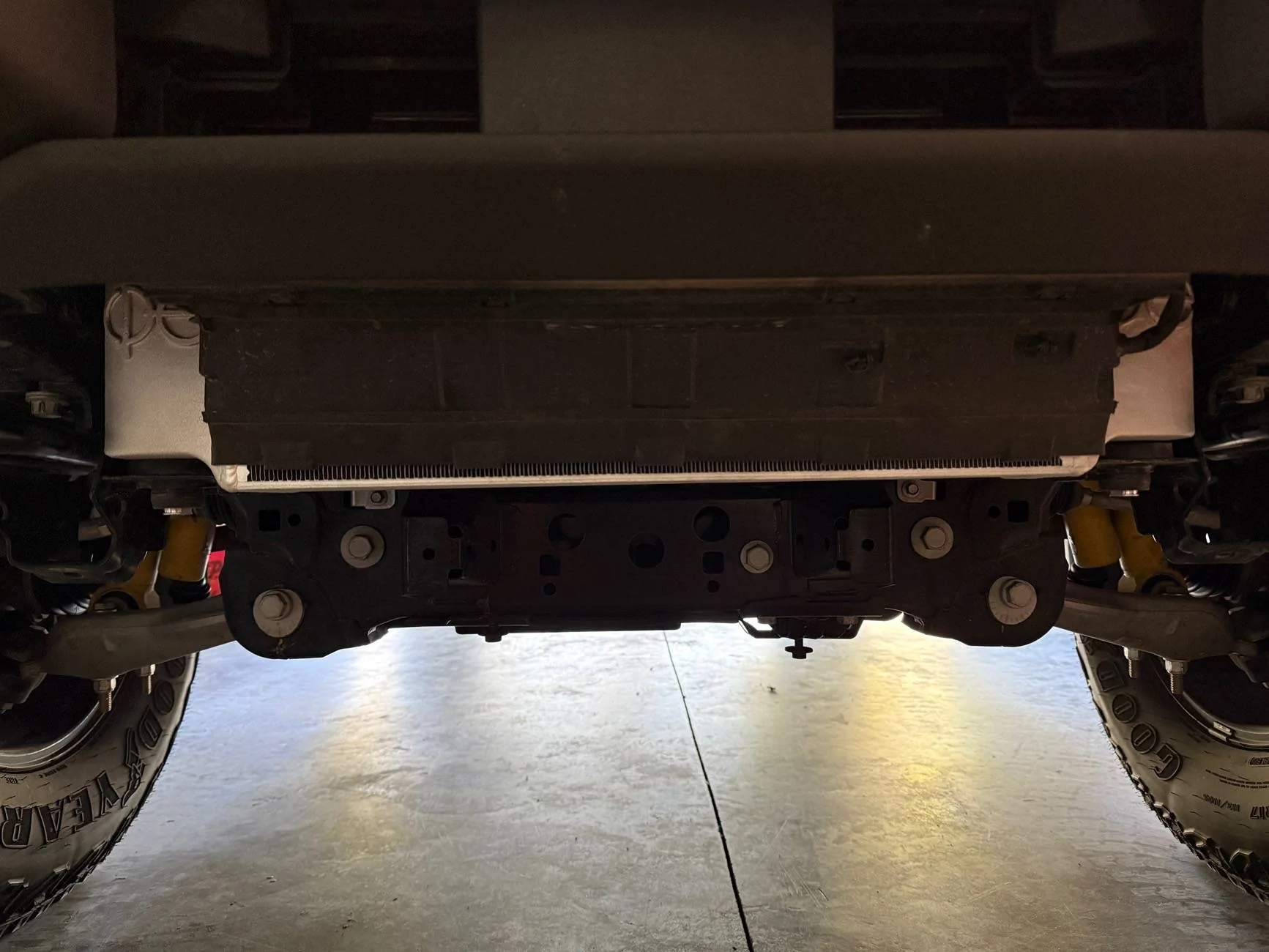

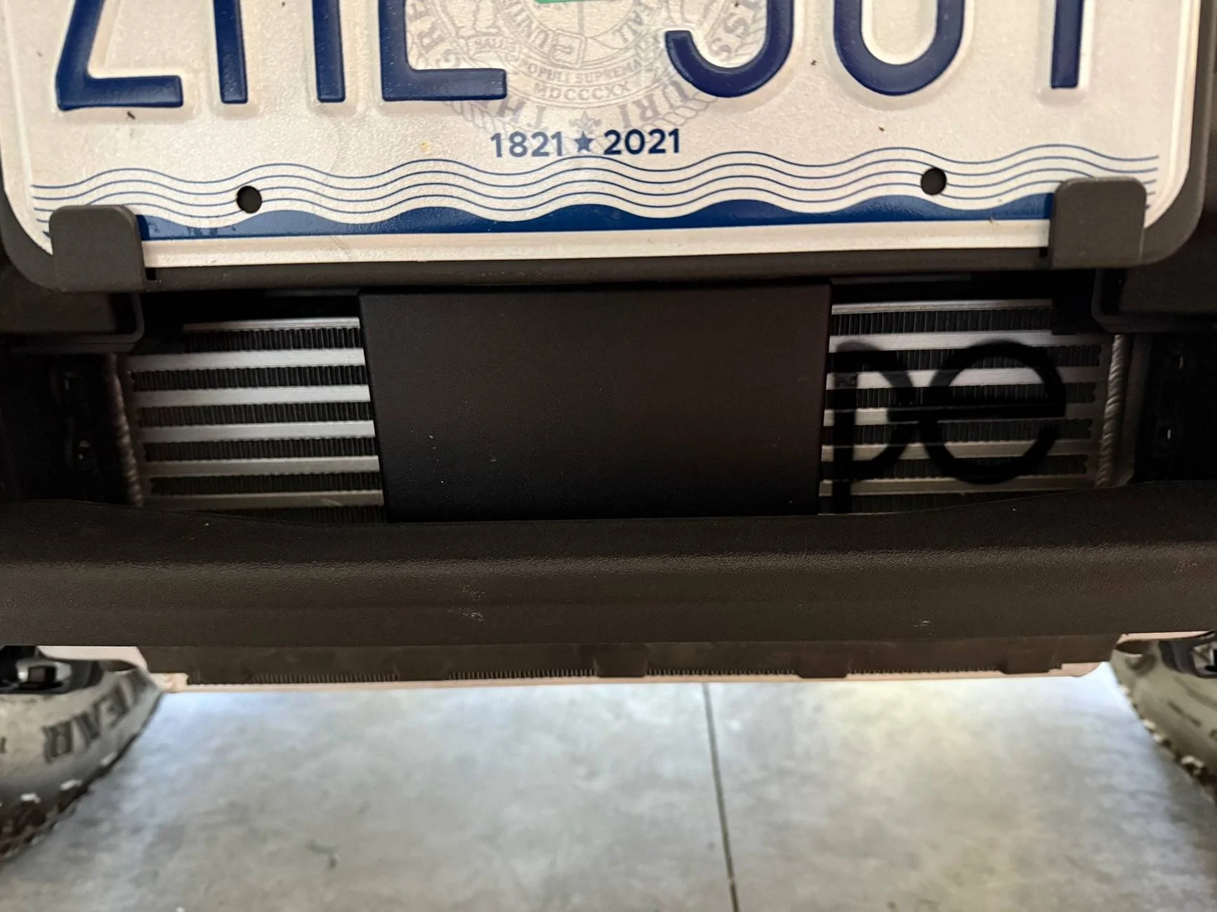

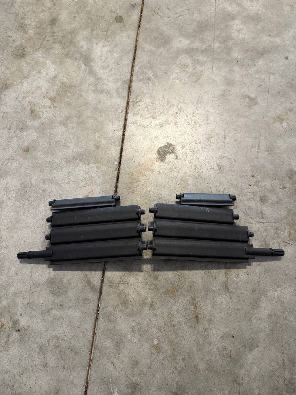

Just wrapped up installing the CPE Intercooler. Install took less than 30 minutes. The grille shutters are easily removed by pushing the tabs in on one side and sliding them out, leaving the motor intact and plugged in.
The CPE Intercooler is 3/4” taller than the OEM, much thicker, and has cast end tanks.
Fit and finish was top notch. If this is on your mod list, do it. 😎
Note: Removal of grille shutters is not needed for the install. I chose to do this for improved air flow to the Intercooler at all times. It seems like mine are closed 90% of the time.
