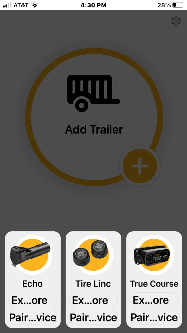

I have the app downloaded and I’ve registered and I’ve logged in and I’ve installed the device in the bronco plug and the blue light is flashing just like it should. When I open the screen for the app I get the screen pictured below and when I try to tap on the button to Set up the controller, it does nothing. The screen is just dead. I’ve deleted the app and reinstalled it and logged in again and I’ve disabled Bluetooth and reenabled it a couple of times as well.
