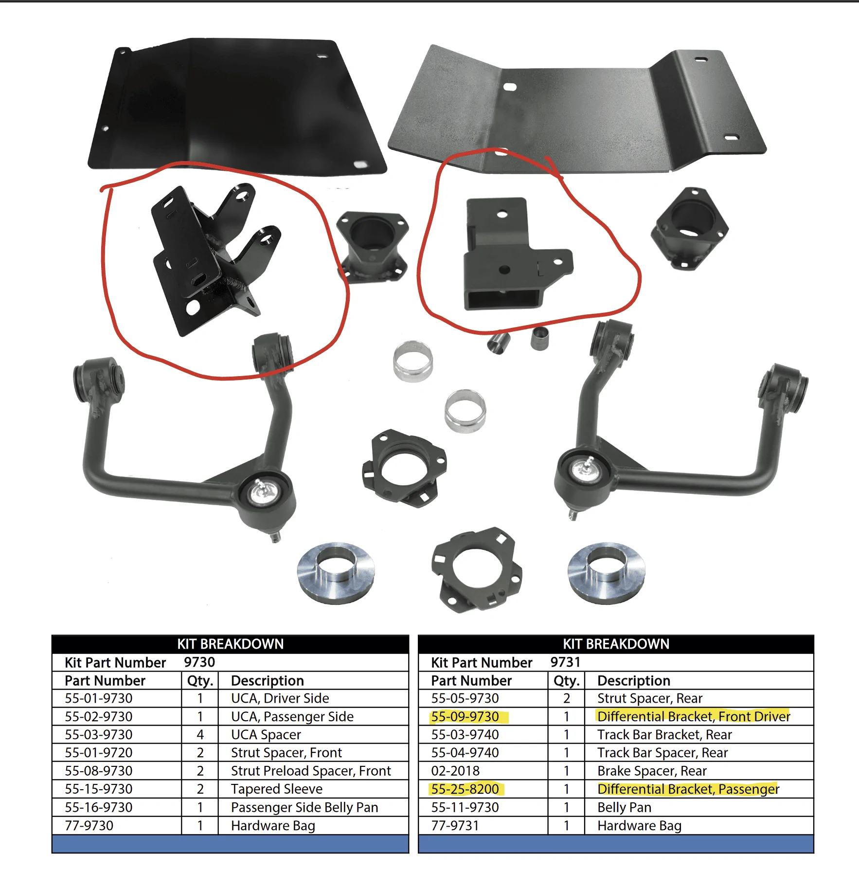

I saw the same thing and found Summit carries superlift replacement pieces. Coulnd't find any listings for the 3" lift components. The 5" lift diff drop looks like it requires the uprights.
The superlift 3" kit includes front and rear brackets. I think the instructions mention a spacer for the 3rd mounting location.
Edit: Link to install pdf. https://superlift.com/images/ePIM/original/9730.pdf

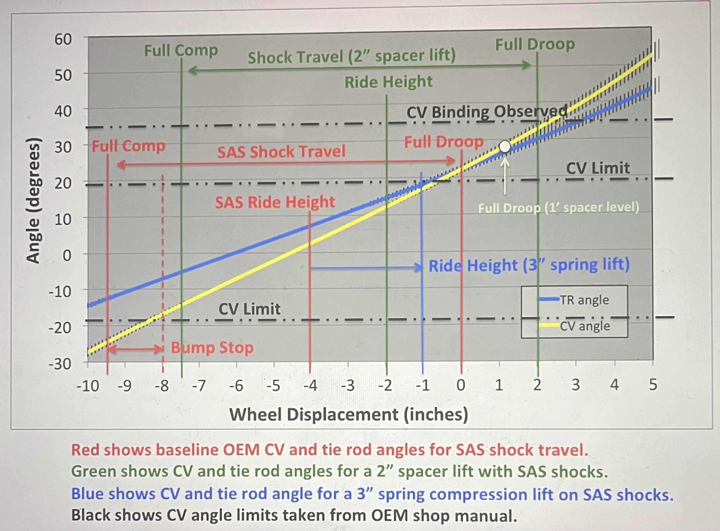

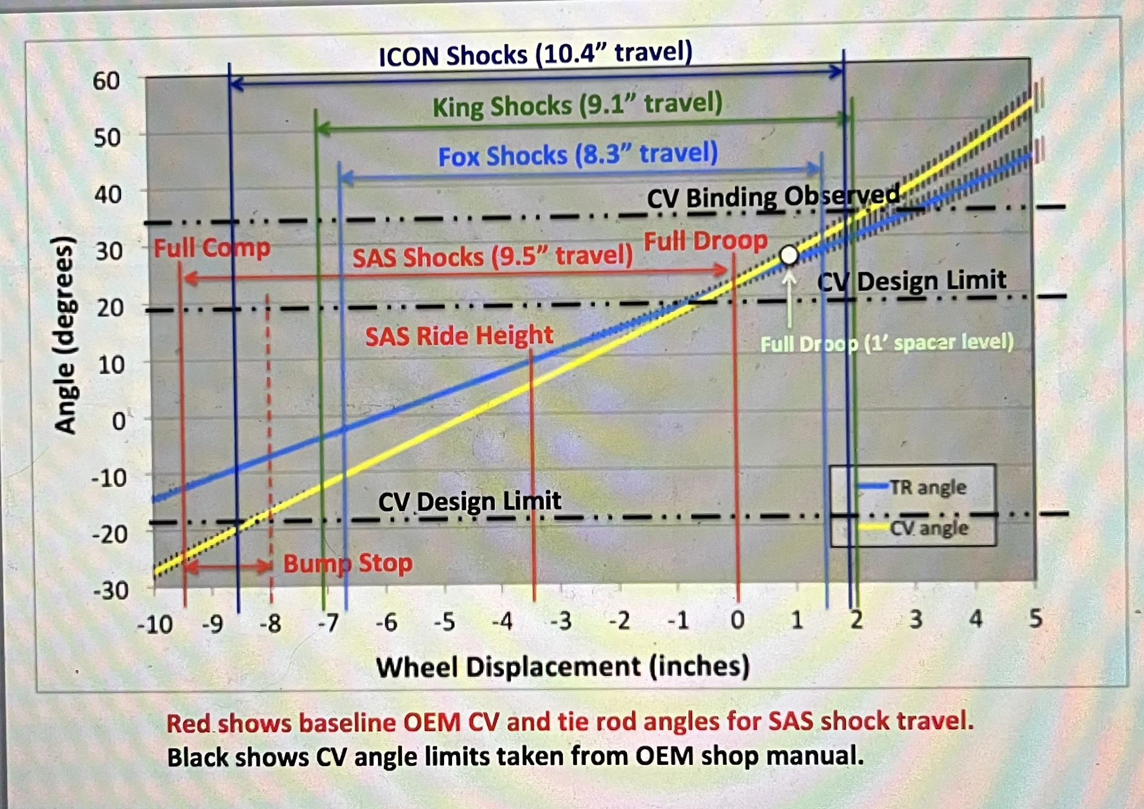

I disagree, the SAS package already puts the CVs at a angle at ride height. add 2" more lift or ride height and CV angle becomes an issue especially if you have a set up that keeps all of the available compression and droop travel. The CVs can and do bind and additionally the boots wear out MUCH faster.
A 1-2" diff dropped reduces the angle on the CVs and returns them to a near OEM condition at ride height.
on my setup Im using ford springs and factory shocks, and I have 12" of front wheel travel with ZERO bind 2" taller that SAS ride height and factory CV geometry at ride height. this is because of my diff drop.
as the video says near the end, a diff drop enables more droop than factory geometry allows for. I have 2" more droop than OEM. even with the ride height taller.
Ford Bronco Differential drop options? 1694191328139
The part you circled on the right is the rear track bar bracket.

The front end geometric design envelope is pretty tight. Not much tolerance beyond SAS geometry. CV angles climb quickly. Surprised there is not more interest in diff drops. Hard to see how a small <2” diff drop doesn’t make good sense for >2” lifts (spacer or spring compression).
