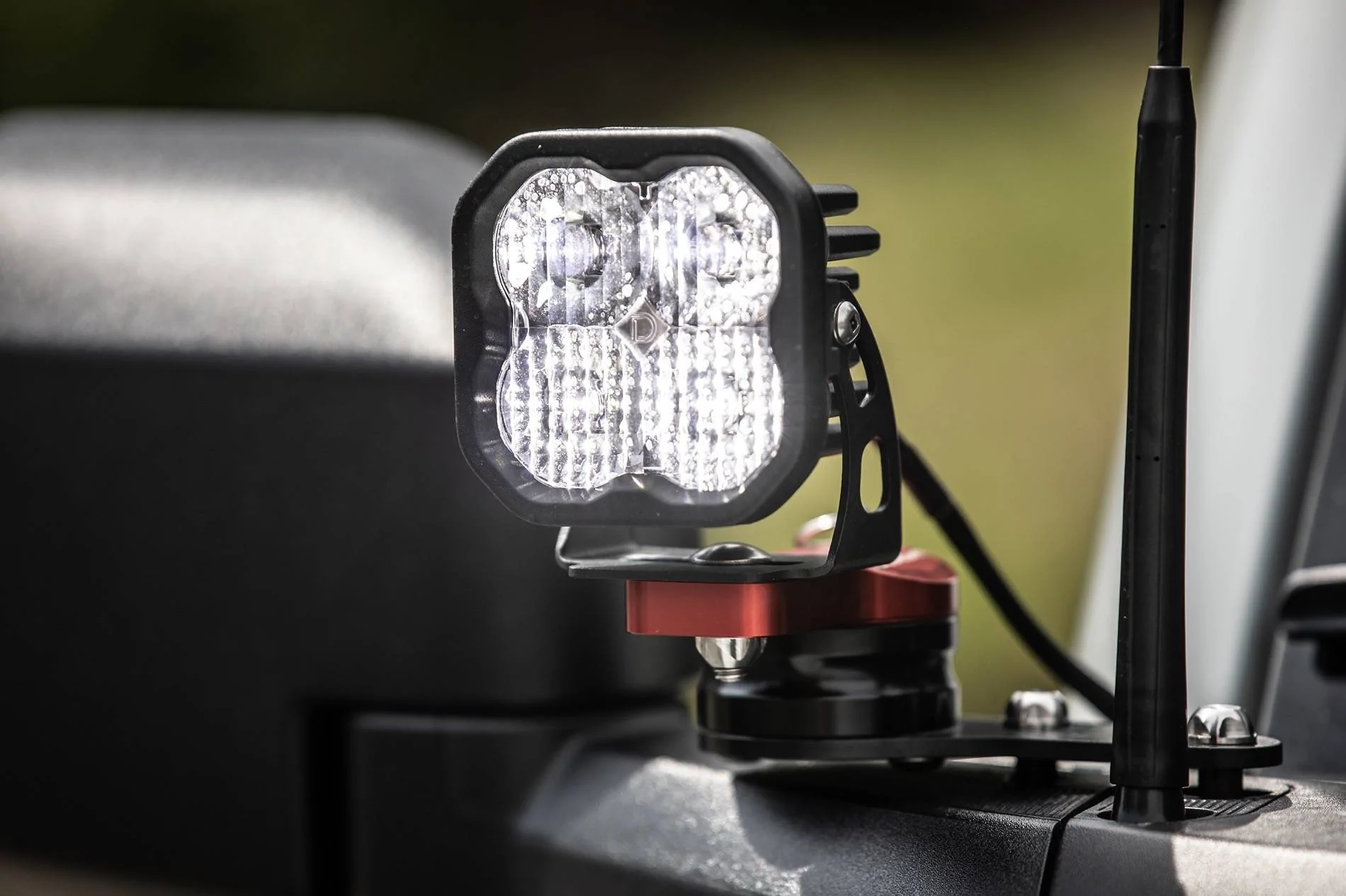

My setup, Diode Dynamics SS3 Max on Bad Ass mounts which pretty much violated all my advice above to some extent. But great lights, super bright and they're quiet. I don't hear any additional wind noise. I run an amber cover on them which diminishes their back lighting brightness during the day but they also don't get beat up on the daily commute. If you look at them lit up, dead on without covers during high noon, they'll burn a hole in your retina.

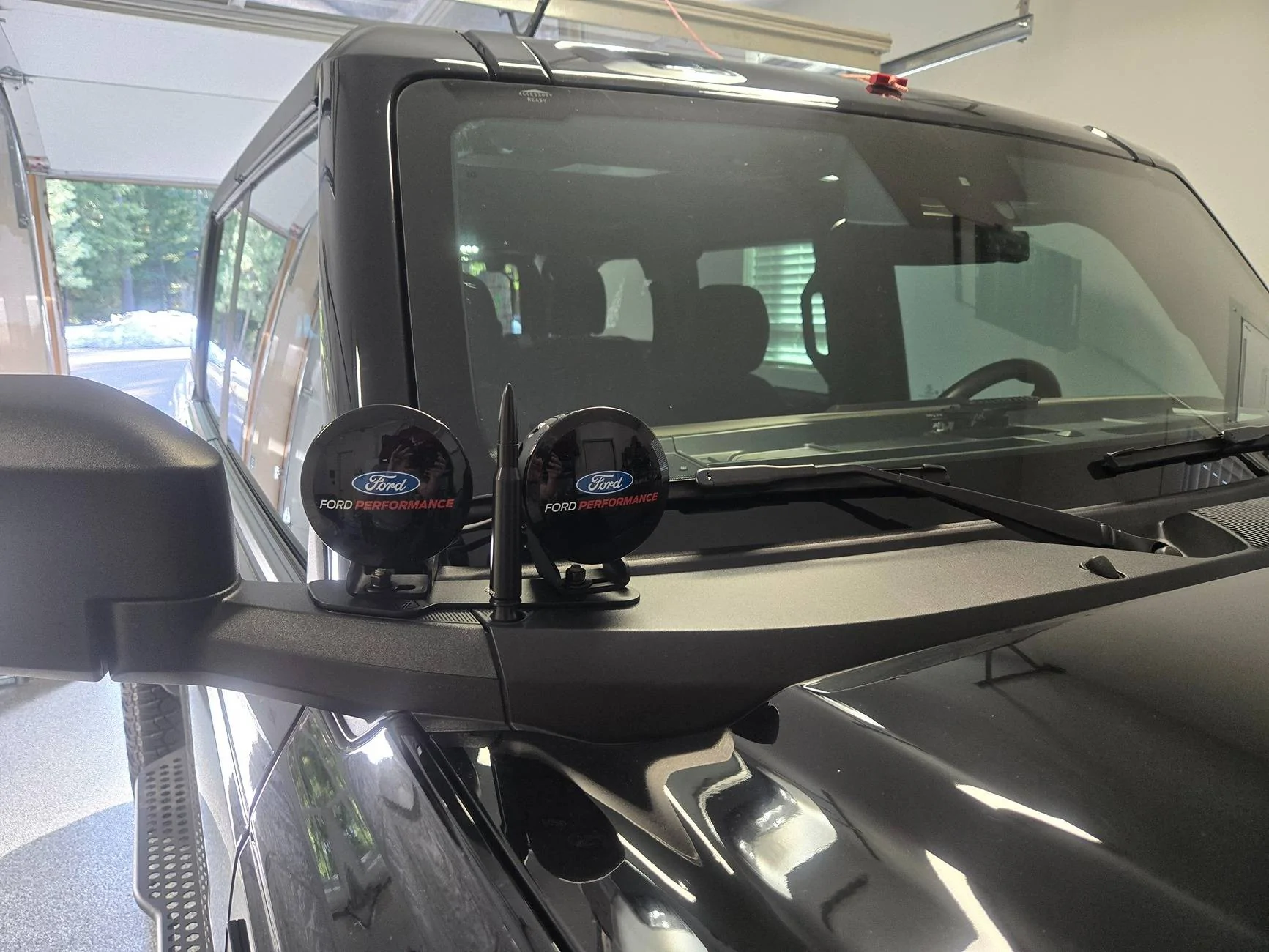

Ford Bronco Ditch light recommendations? 1000000633
These are what I'm running, using their harness as well. Didn't bother spending the money on anyones brackets either since Ford made the mirrors 'accessory ready'.

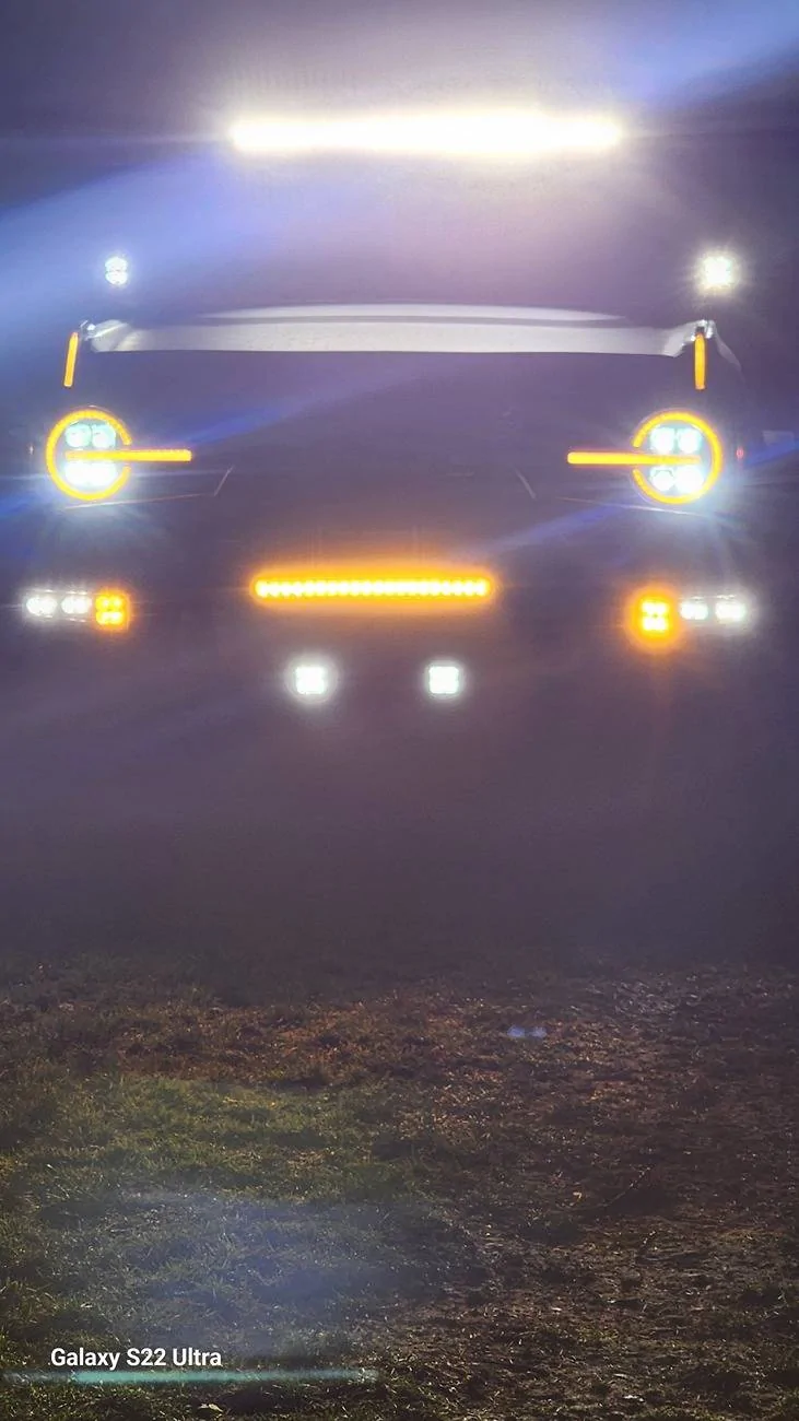

Ford Bronco Ditch light recommendations? 20250228_223424
Heretic. Also you can use this picture as a backup to your phone's flashlight.

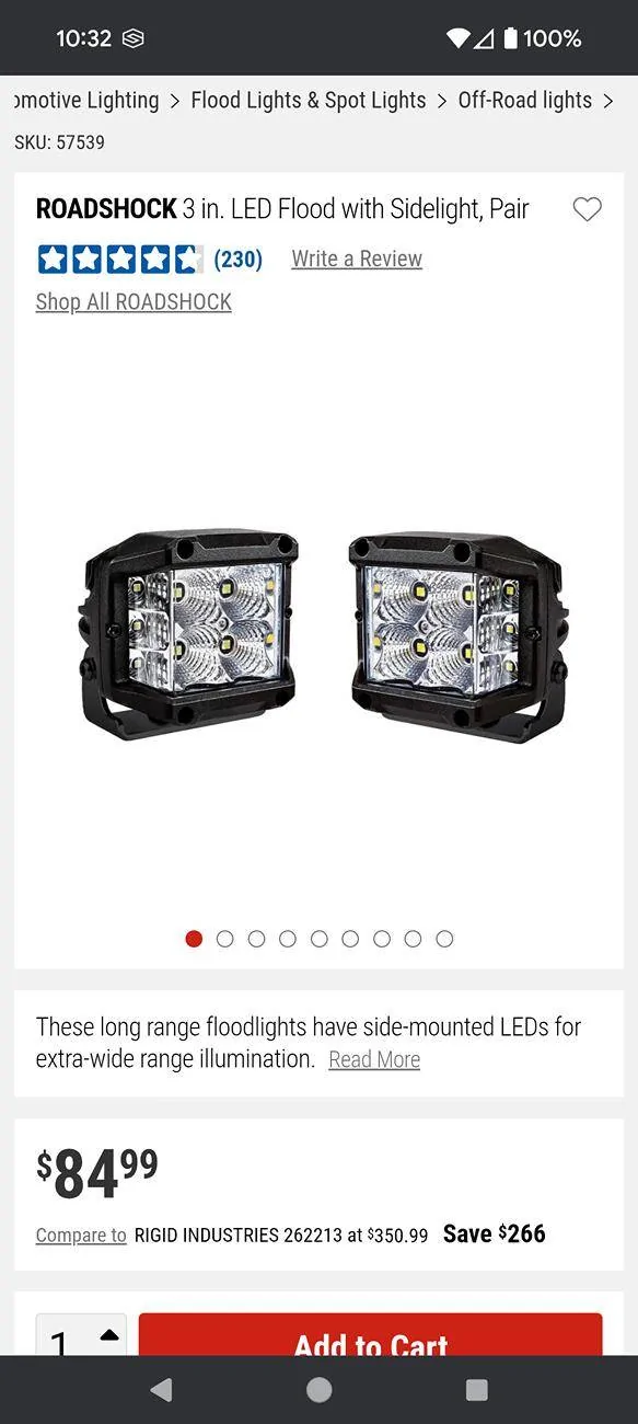

I found these looking for plow lights, they work fantastically for lighting up everything as fast as my 6.7 CCSB will go.
Ford Bronco Ditch light recommendations? 1749354451534-29
I bought these in 2020 and they are still rocking bright AF. Lifetime warranty, $100 A PAIR.
Ford Bronco Ditch light recommendations? 1749354687475-lg
https://www.superbrightleds.com/50w...-work-light-5-100-lumens-6500k+packamt-2-Pack
Obviously you CAN'T run these with oncomming traffic - mine are pointed so basically 10% of the light hits the road, the truck lights do the rest. There are 50W each, they are rowdy bright and the light punches far - tough to overdrive.
I bought these because I ran into some ditch rats in my pickup was brand new - I was pissed. Couldn't see them right off the side of the raod. Not anymore - these turn the night into daylight.
I put some, what I thought were nice, Rigid lights on my Bronco and they are total BS compared to these, they do have an orange backlight though. If you want to see the deer and everything else the goes bump in the light, you can't lose with these.

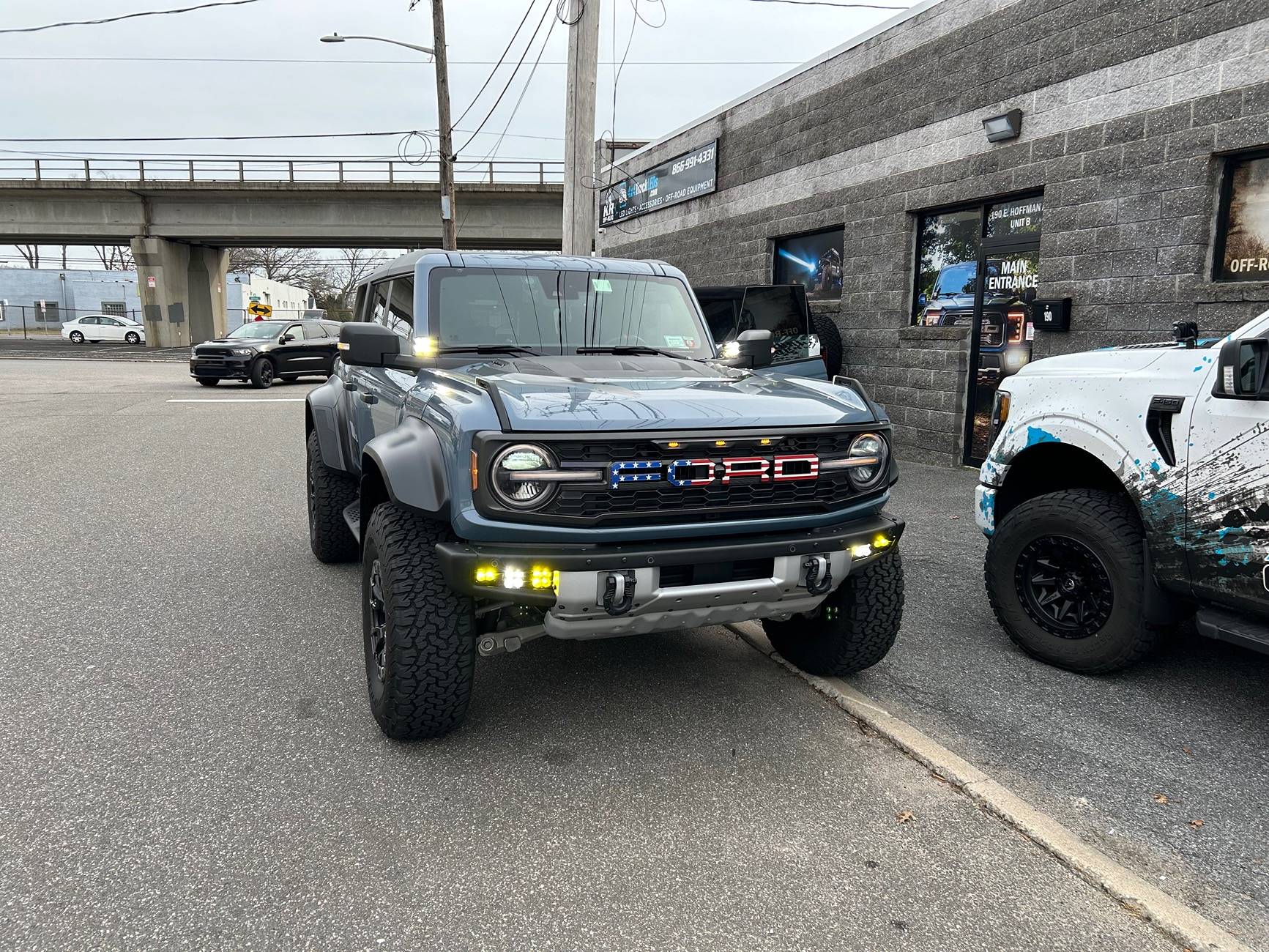

I had @4x4TruckLEDs.com install a light package for me before our Moab trip last year. Adam is a wealth of info. That said, I have Baja Designs ditch lights, Sqadron Pro. They are fantastic and throw a lot of light. As for your question about LP6s, it’s up to you. You have to decide what your lighting needs are. For me, for wheeling at night, I use a combination of Amber and clear lights that light up a few zones in front of me. Even if you don’t buy BD lights, go on their site and check out their info on lighting zones and different lights. I went with BD because they’re widely used on the race circuit and they have great customer service, by all accounts, haven’t needed it. But research, the web and YouTube are going to be your friends on this. Good luck!
