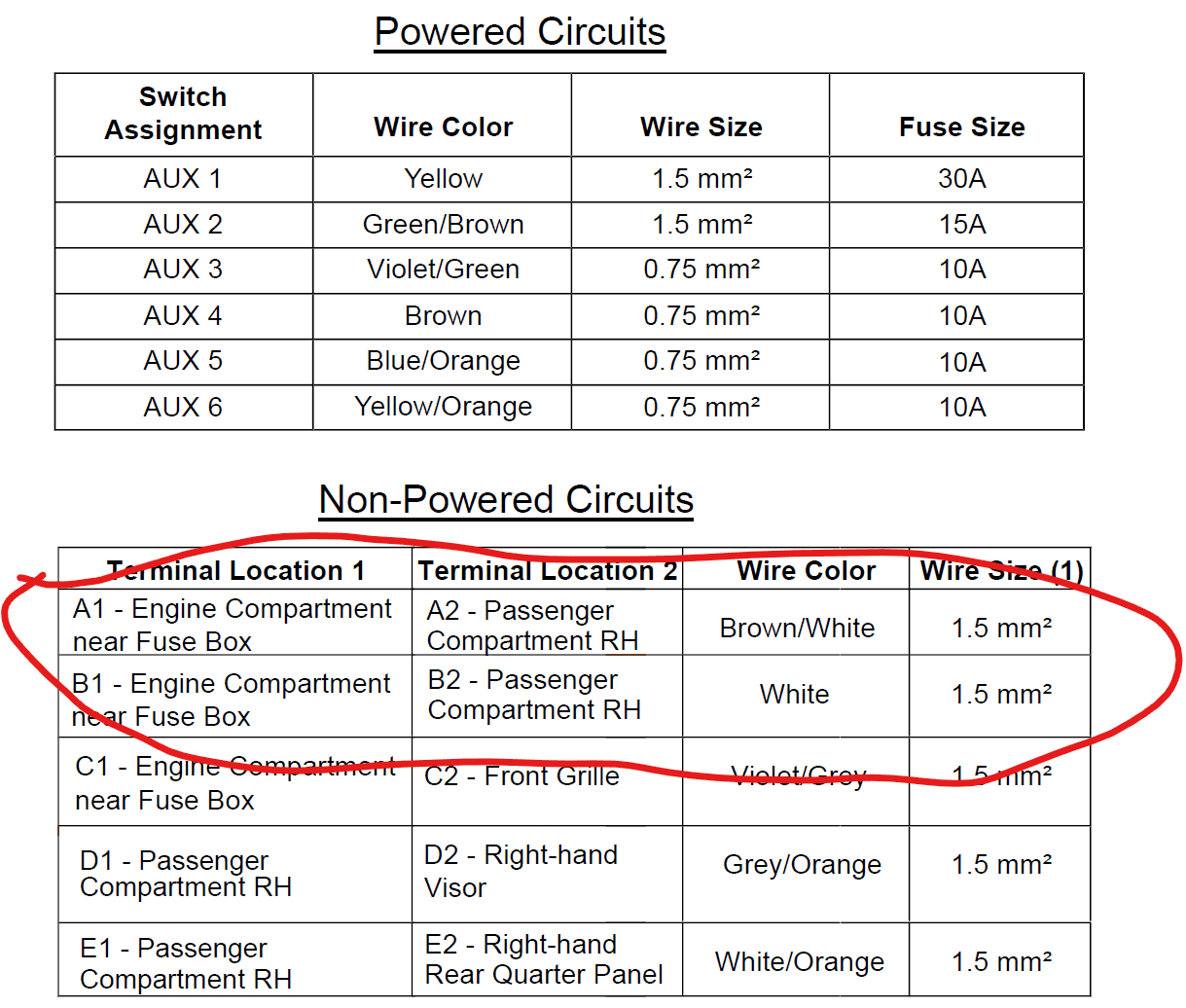

That's pretty easy, since you don't need the ARB switch. You just connect one of your upfitter wires to the trigger wire on the ARB harness. DONE.

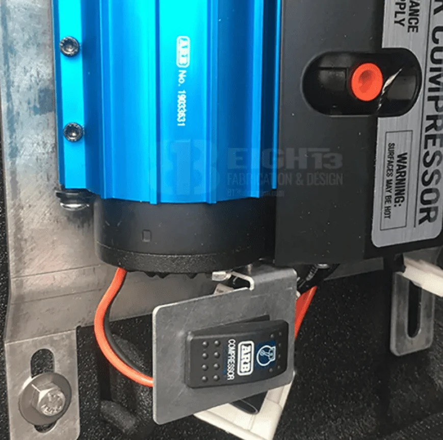

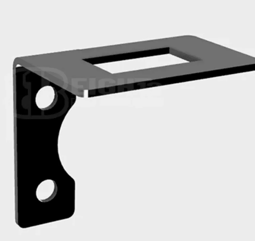

For anyone not wanting to use aux switch, this may be useful:
This switch bracket looks handy. I ordered the "passenger side" version to try (black bracket). 813fabrication.com

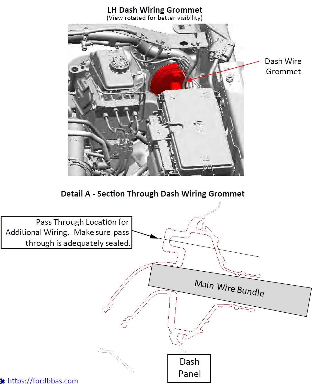

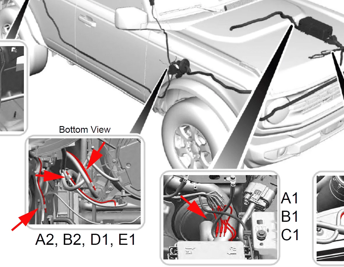

The secondary ARB harness is bulky since it has the wiring for lockers and 3 switches. With AUX package, there is already a wire routed that can be used instead for switched power. This is also useful if you want to use the AUX switch.

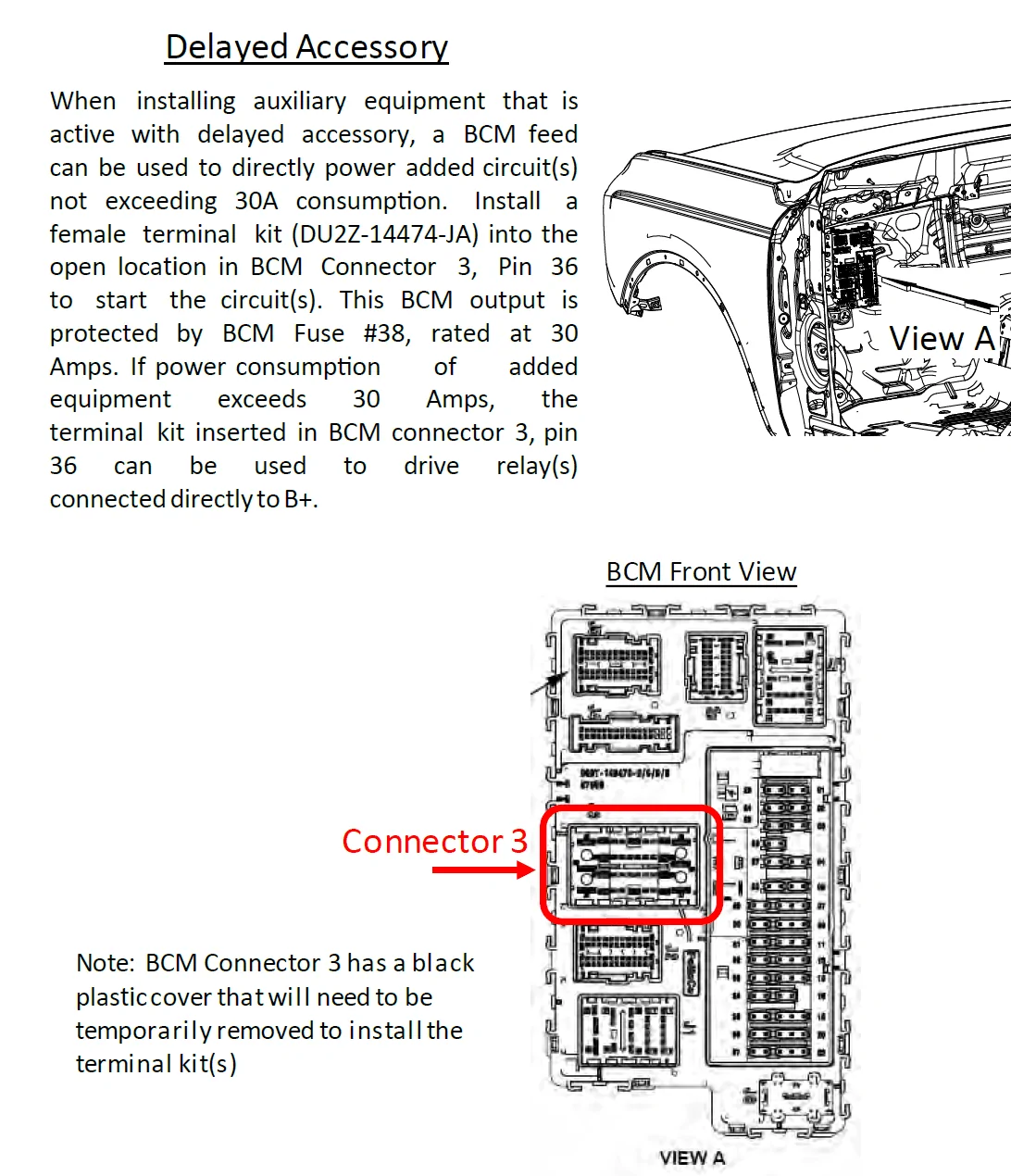

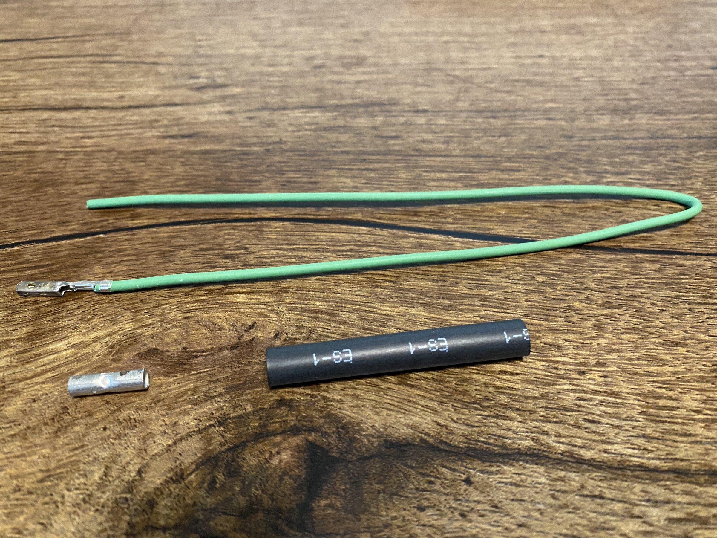

Although add-a-fuse will work, pro method is to add terminal and use preinstalled fuse. These are cheapest on ebay (<$10), since dealer can't order just one terminal.

Yeah basically ARB's harnesses are intended to be used with lockers and other things. 99% of us are not installing lockers so we can ignore all that locker stuff. In fact, the instructions tend to be confusing because they go on and on about lockers.
If you have factory upfitter switches, then you just care about that 1 trigger wire. The compressor wires directly to the battery and you will connect an upfitter to the trigger wire on the compressors harness to turn it on. So amperage does not matter, as you are just using a TINY bit of amperage to trigger the relay on the compressor. So use any upfitter.

We did not build that into our bracket because honestly those types of brackets already exist. But we will look into making a switch bracket that bolts right onto our ARB bracket (we did leave additional mounting points for future accessories)
