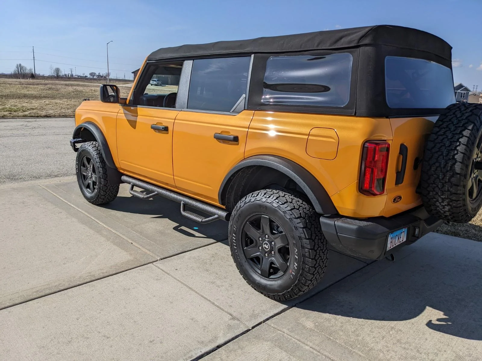

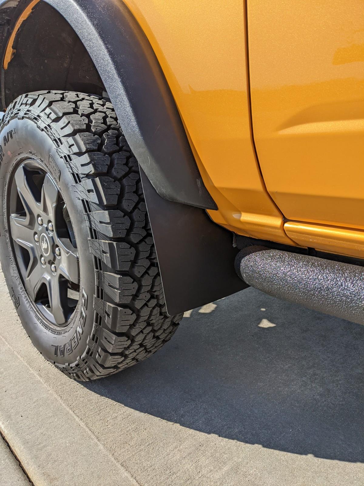

IMO the mud flap options so far are not very good. The Weather techs look weird and everything else I have seen looks like it belongs on a semi.

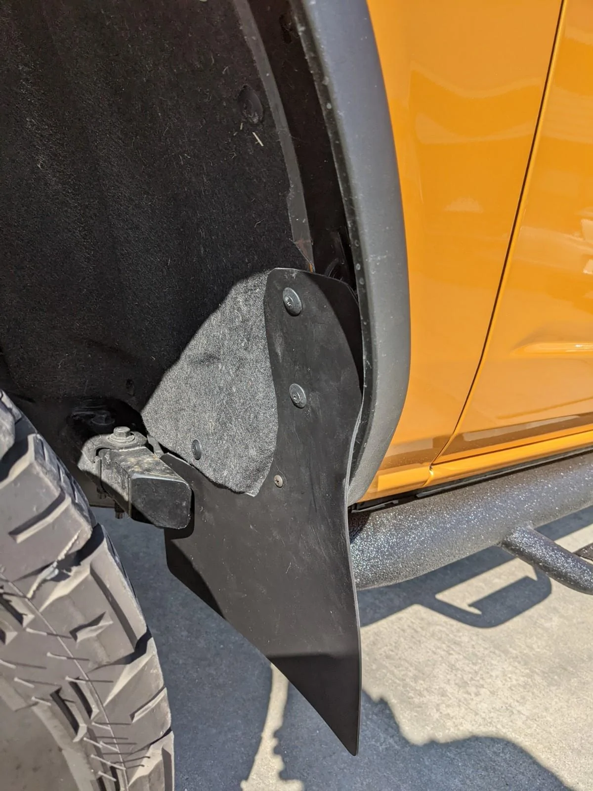

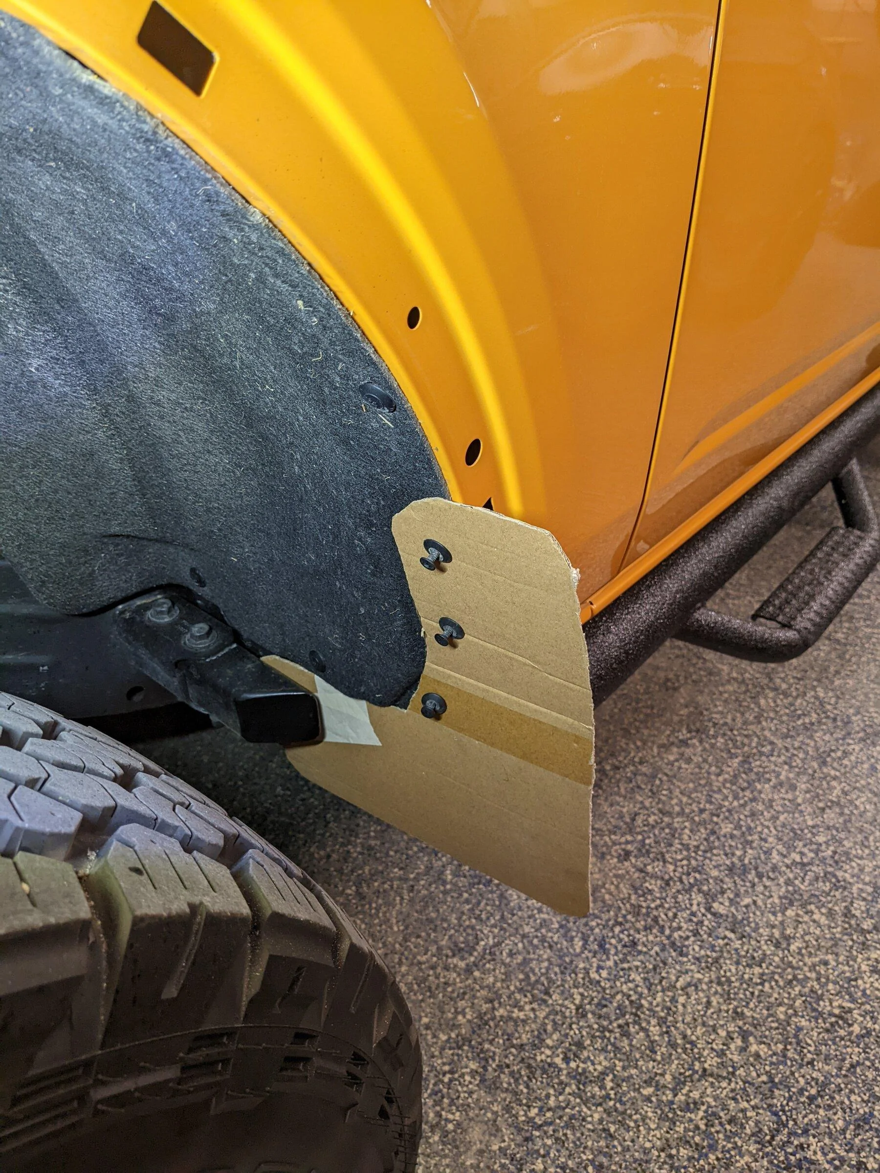

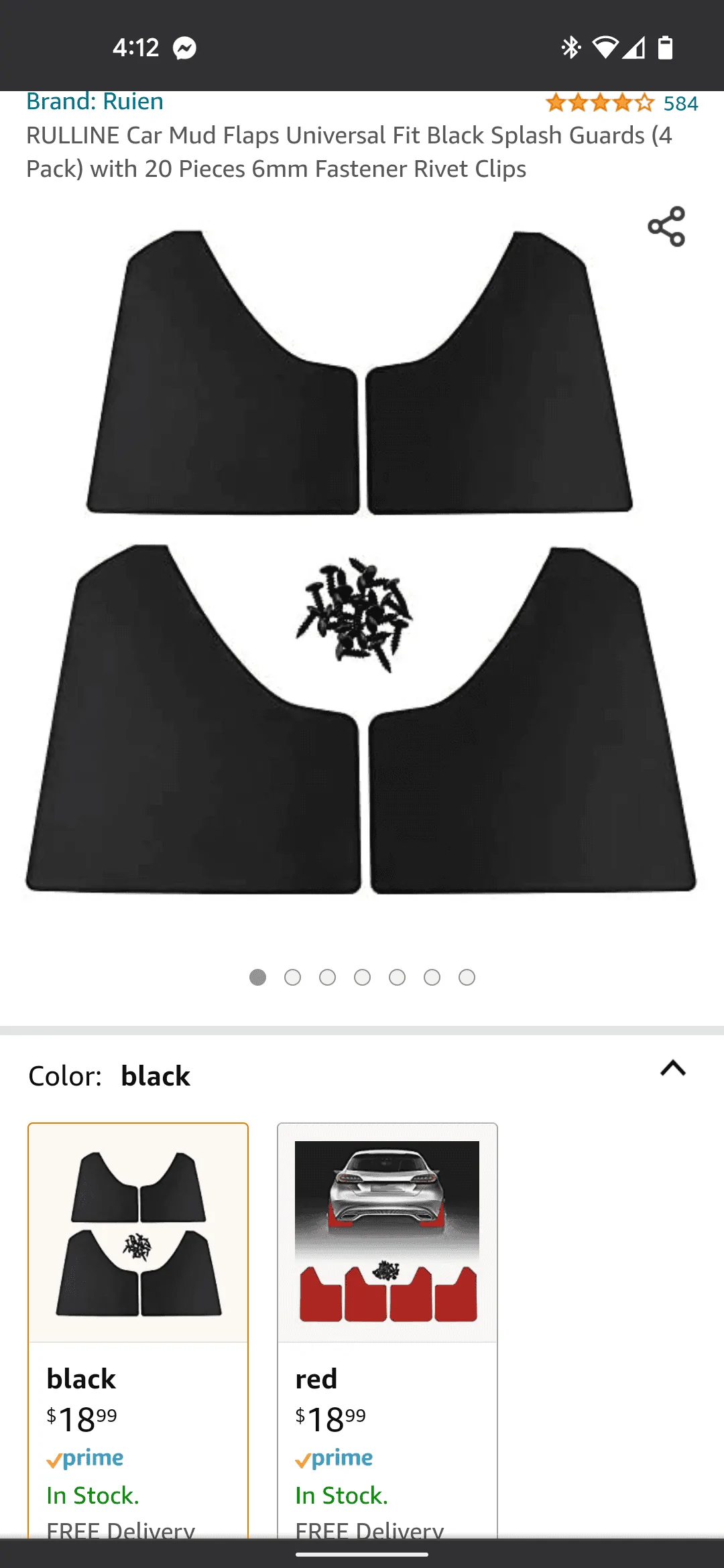

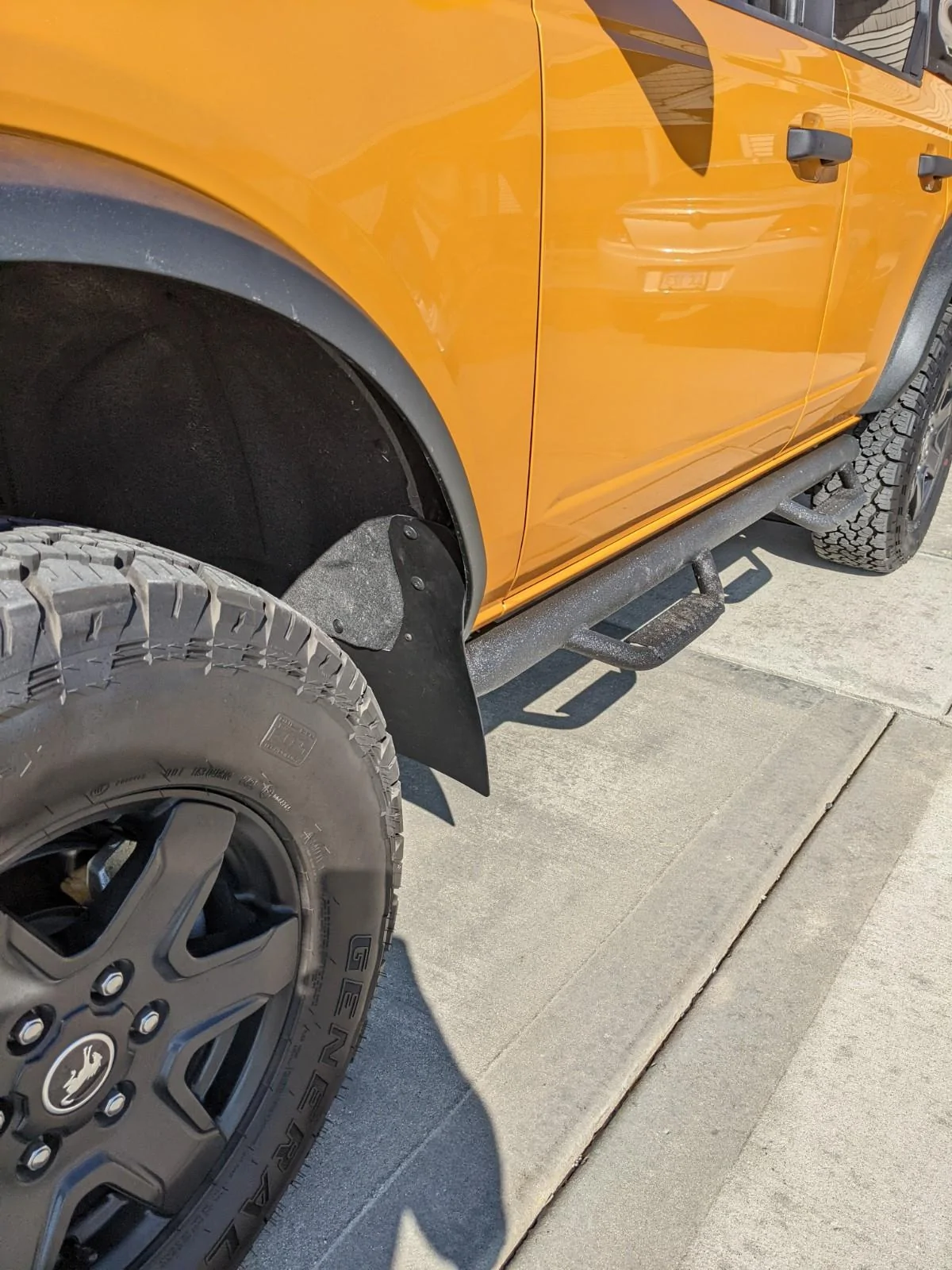

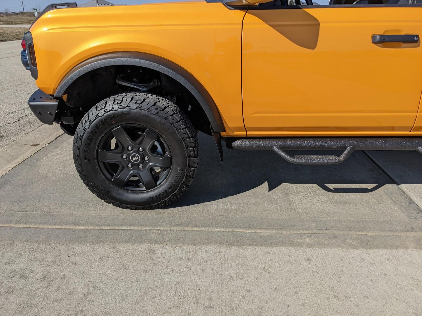

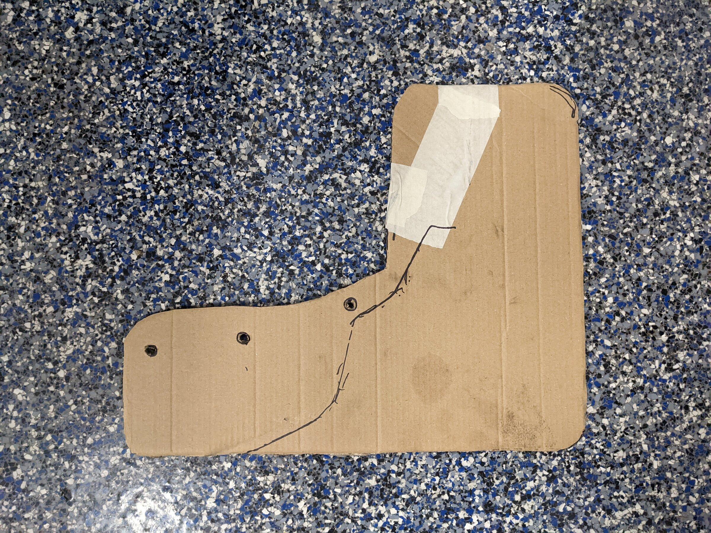

I purchased these universal flaps from Amazon for $18. With some trimming and a little bit of heat, I was able to get them to fit up where they look nice (almost unnoticeable which is my goal) and should function well.

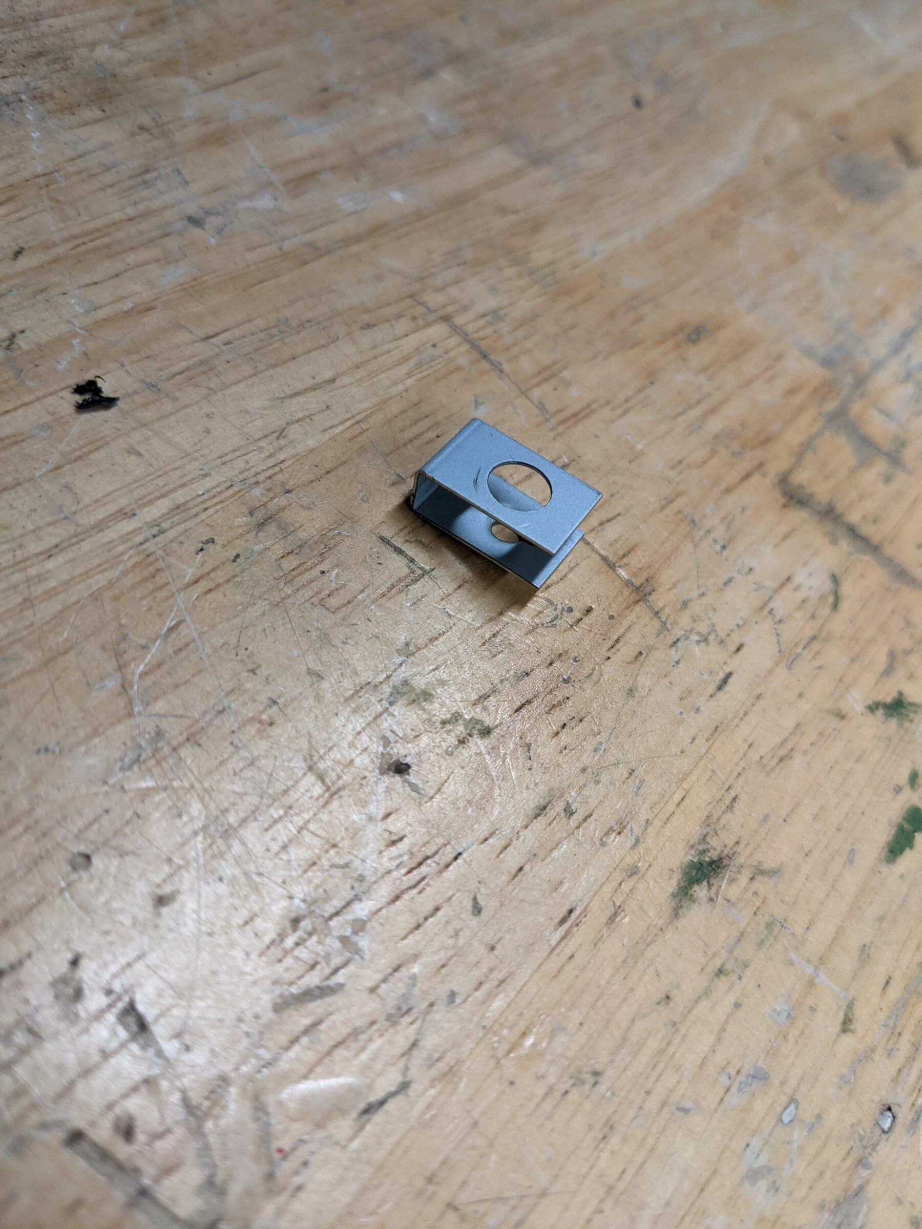

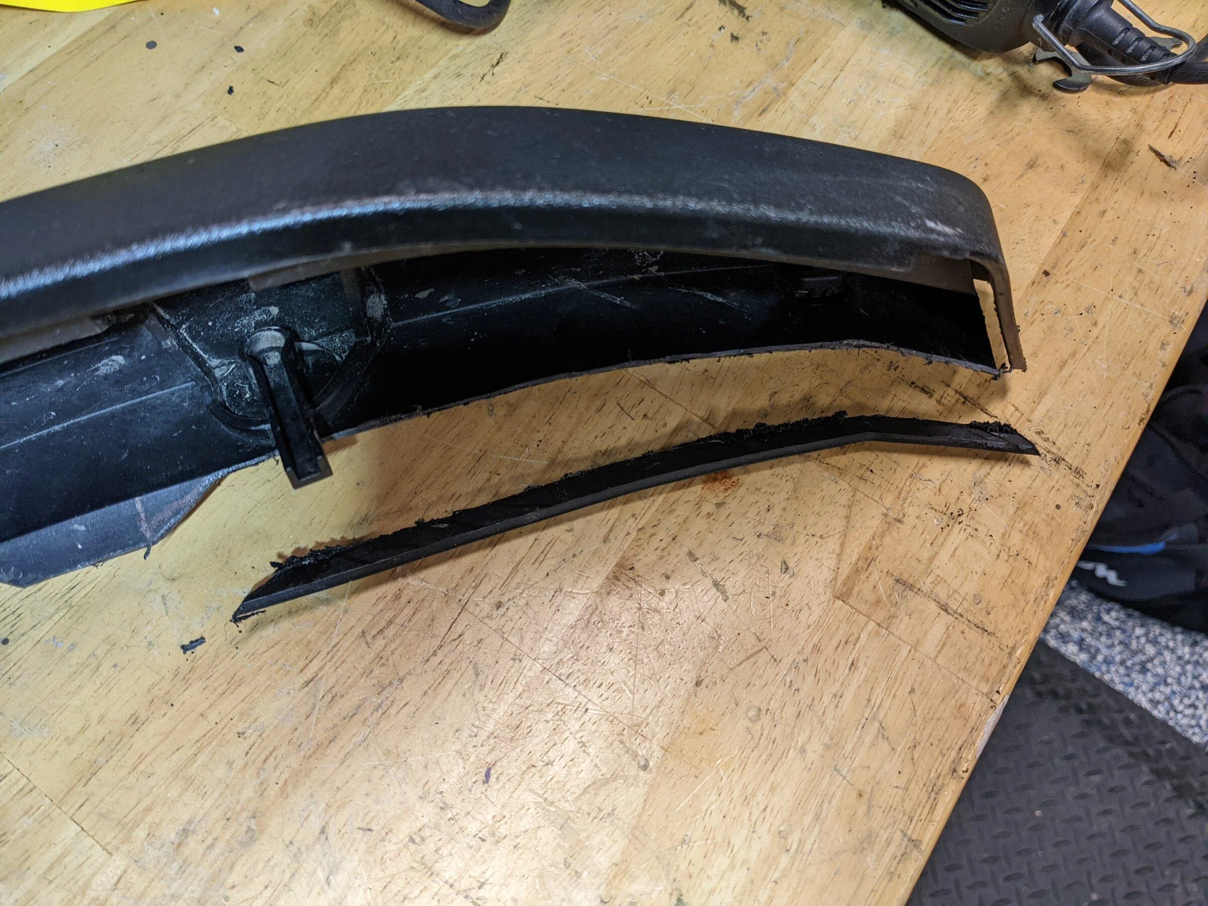

I was able to use the three existing factory fender liner fastener holes. I even reused two of the stock fasteners on each side. For the bottom hole the factory clip was not long enough so I used a metal clip nut and a screw. I did have to trim a small amount of plastic off of the inside of the fender flare to get them to sit down flush.
I'm pretty happy with how they turned out and my total investment cost is $18. And since I am only putting flaps on the front I still have two more to replace these with down the road if needed.

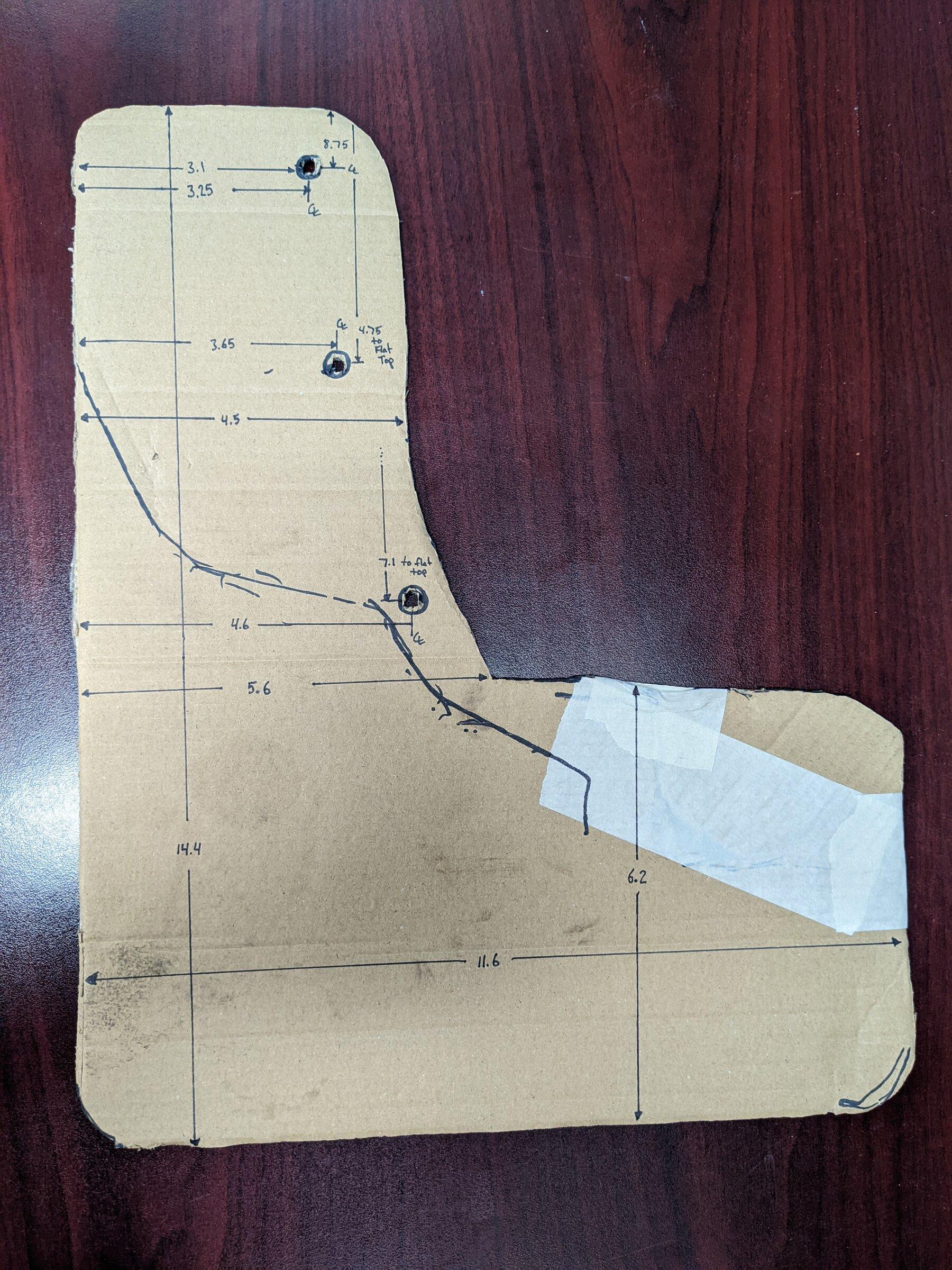

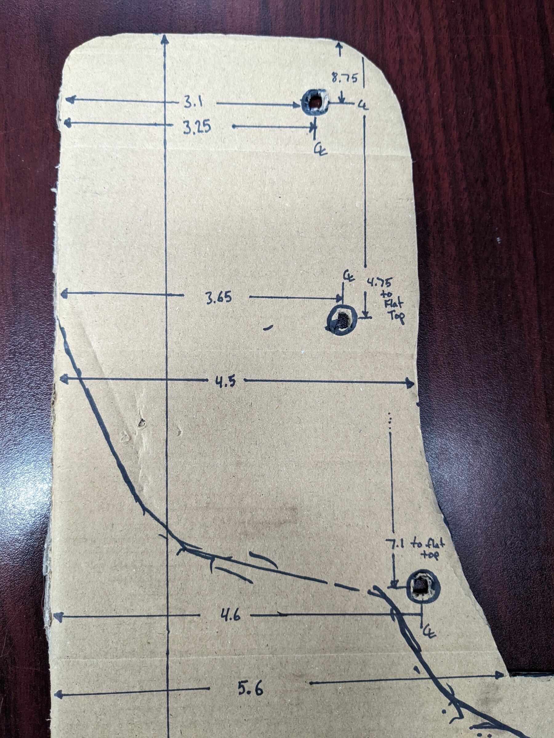

Someone asked for dimensions on the template so I figured I would share with everyone.
This is outstanding, thank you
See if this is about correct. I drew it up to scale in cad. The Full Size will need to be large paper. The MudFlapLetter PDF is split into 3 pages that can be print out on normal letter size paper, Just cut and tape it together to make the template. I do not have my bronco yet so I really don't know if the scale is correct.

When I am back at work next week I will try to print that out and then put it over my template!
Awesome! Champion!
