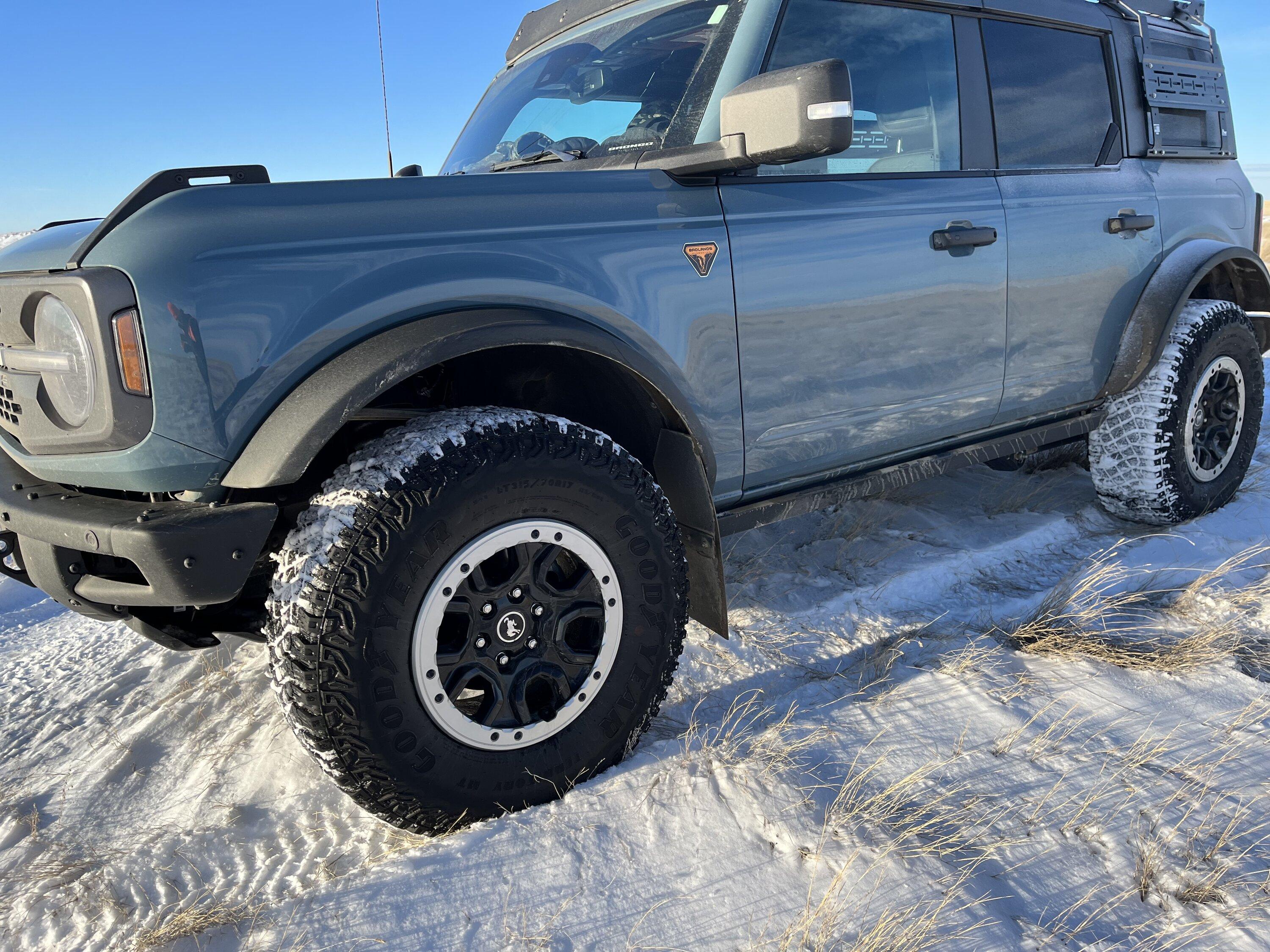

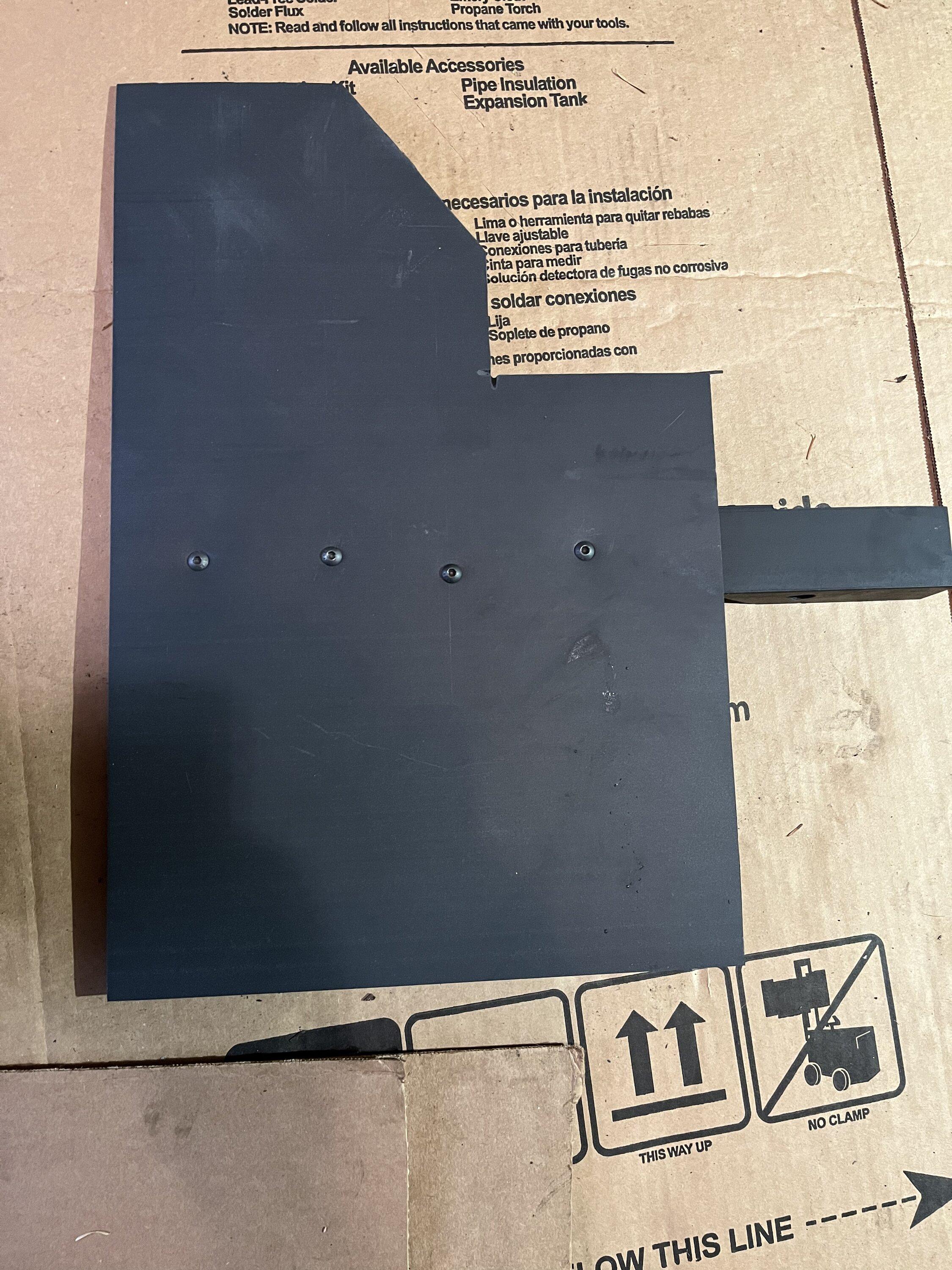

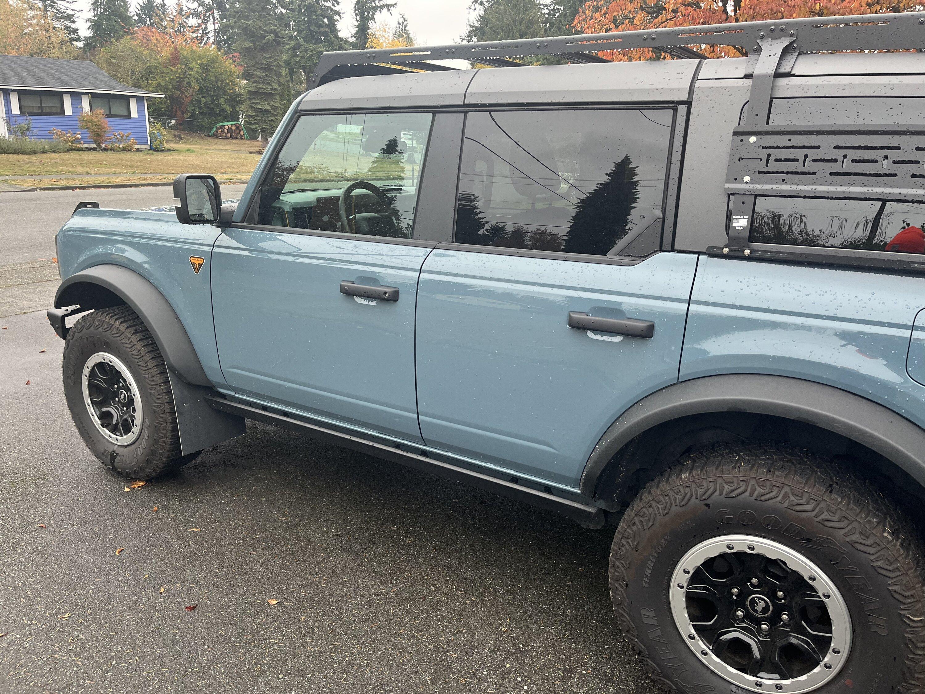

Thanks man! I need to get around to bolting the rears on.... the brackets and flaps are cut. The material held up well smashing through snow drifts in Montana. The sides of the bronco were clean after 2.1k miles this week with 300+ in 4wd on dirt and snow roads.

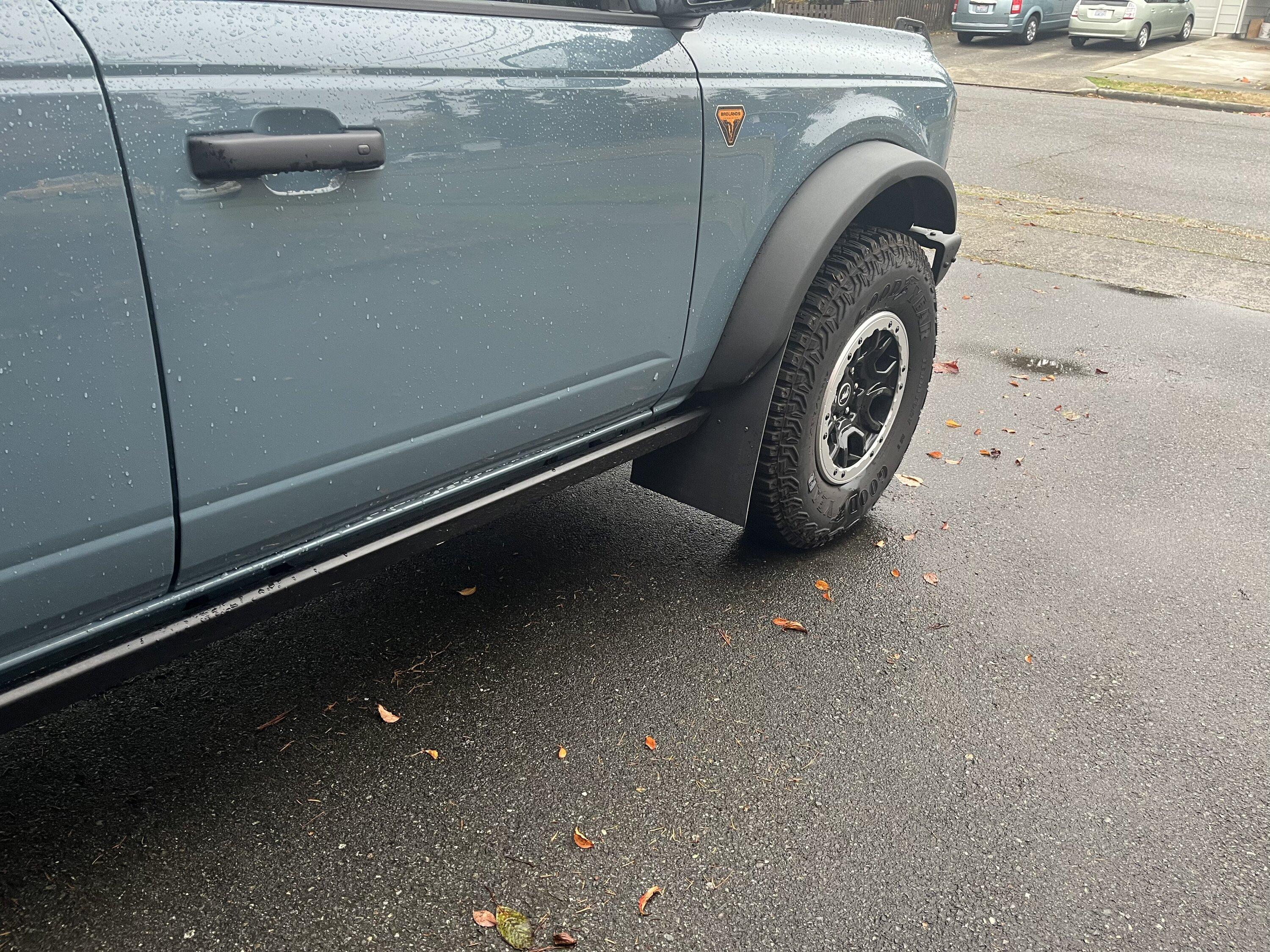

I built my Mudflaps using your templates with slight modification and different flap material, more like the rockblokz. I haven’t mounted the rears yet but the front performed well on a Montana mule deer hunt and on other muddy roads around the PNW.
What did you use for metal on the front flaps?

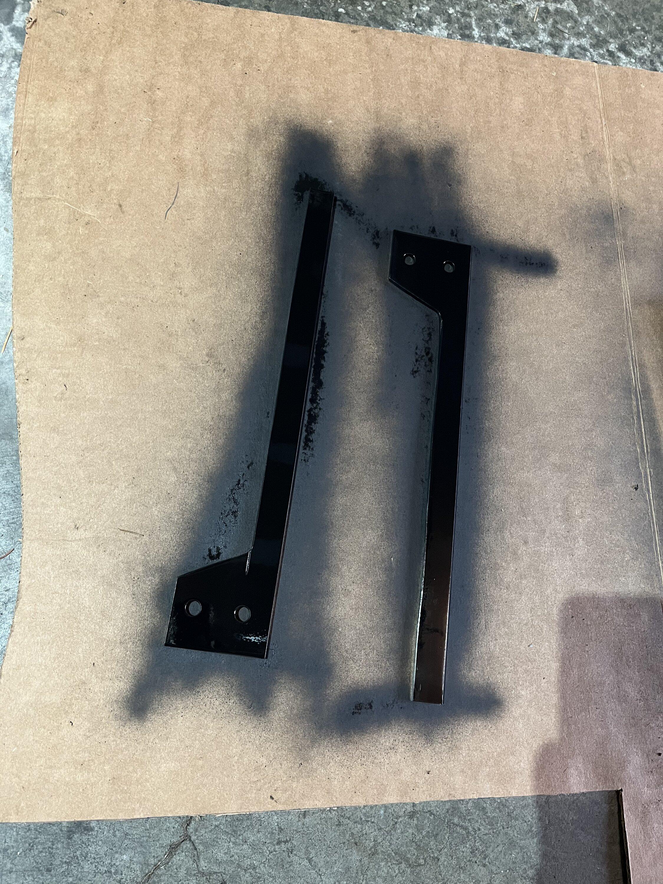

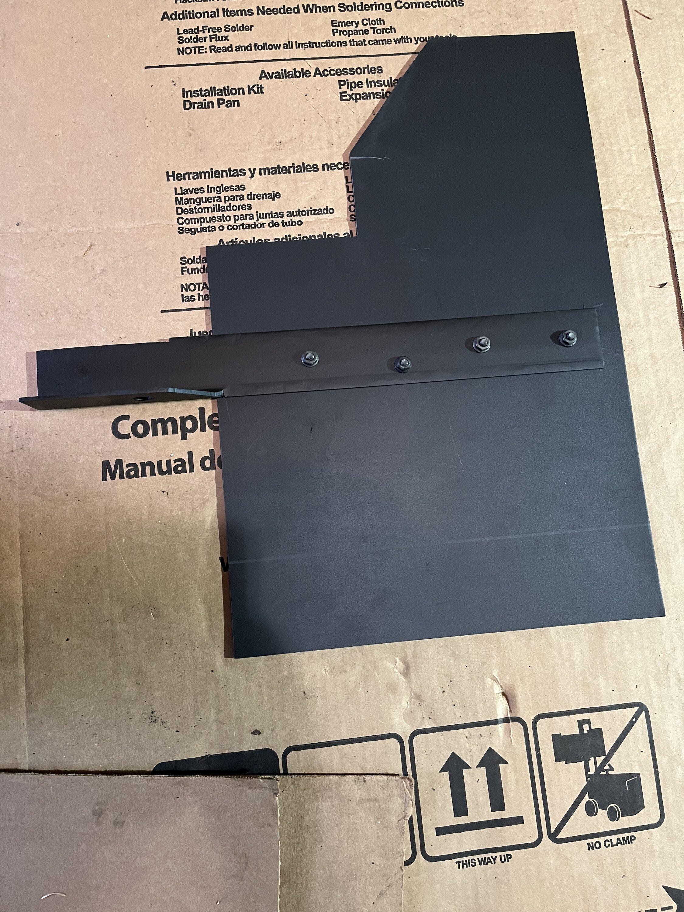

I bought 1/8 inch angle steel and cut/ground to the dimensions of the drawing provided by OP. I only used one mounting hole and used the existing bolt for the crash bar, but I flipped it the other way so it screws down instead of up.
For the rear bracket I used 3/16 steel for a little more strength because it sticks out from the frame further and does not have the wheel well behind the flap like on the front. I painted everything with black rustoleum.

I'm curious what material did you end up using for these mud flaps? And did you fabricate your own metal brackets or buy them somewhere?
