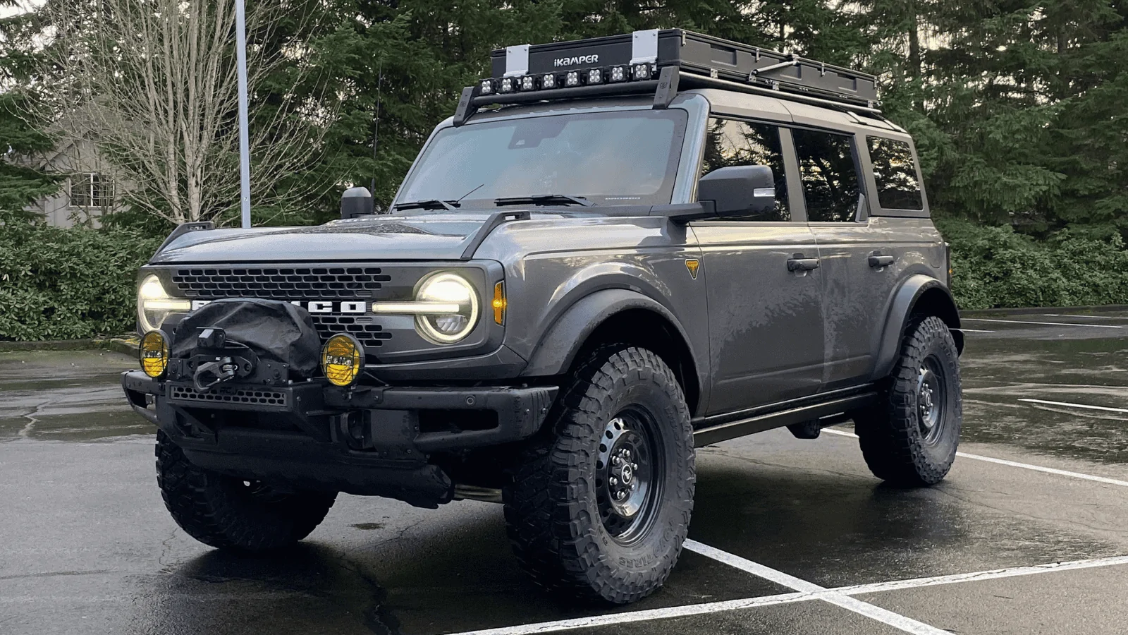

I'm currently on 315/70/17 D load Wildpeak RTs and they are miles better in comfort than the Toyo RT C loads I had on prior. These RTs are heavy though at 76 pounds...
