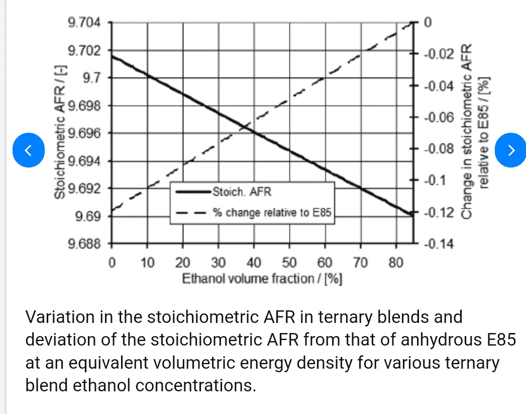

I will just leave this here. It's not enough to matter as long term fuel trim can adjust for E0.
Ford Bronco "DO NOT USE 93 OCTANE" ? Screenshot_20240504-084431 (1)
Clearly, stoichiometric AFR decreases with increased ethanol, which means that the mixture will be rich without the additional ethanol.
Follow the science.
Follow the science.
Yes this is correct. Except this is not a flex fuel vehicle and not changing its own stoich on the fly. The fuel trims will compensate but why do that? You’re running e0 for nothing. The fuel trims are going to be taking away fuel all the time then compensating. And you’re losing the knock protection the ethanol brings. This is a fools errand.
