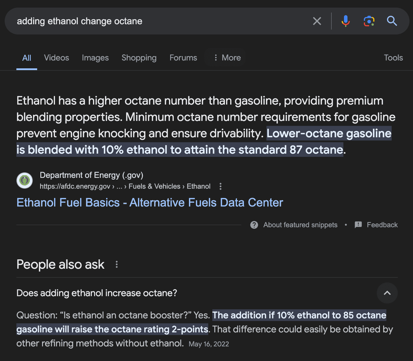

I mean lets just google that for you then. Took 5ish seconds. Truth is, adding the ethanol will always increase effective octane based on simple preignition resistance. If you see spark knock with 88 e0, depending on how bad you might not see the same spark knock on e10 87. And if you blend up to say e20 87. Thats adding the appropriate measure of E85 to a tank of e10 87 to bump the blend to e20, you will 1000% have more spark knock prevention/protection. Push that to e30 and so on and the effective octane goes up with it. E20 87 is like 89/90 effective octane. Just like E70+ pushed effective octane well over 100. 102-105ish. This is super simple stuff that you as a professional calibrator should know. E85 when taking to the limit might require a much higher fuel volume demand, but compared to similar octane gas like 110, its pennies to pounds better cost to performance wise. Until you get to the limit of E85.
In closing, Ford has calibrated this and many other factory vehicles to run on e10 pump gas. If you run e free gas, you are then relying on fuel trims to continually remove fuel added to maintain stoich. Lets hope a wideband doesnt degrade or go bad which will likely result in a rich condition and engine light along with horrible gas mileage and poor performance. Plus the wasted money spent on e free gas that not only isnt doing anything for mileage or performance, but is also not helping nor hurting the fuel system in any way.
What you should be doing is running 93 e10. This will give you the greatest "pump gas" knock protection as well as give you the most spark you're going to get on that fuel from the factory calibration. And on the chance you will need MAX power and tq, you should add in around 2 gallons of quality E85 then top off with 93 for an effective e20 blend or about 94/95 octane. That should top out what ford allows for spark added in the absence of knock, and will get you all the power your bronco should be capable of making. The vehicle is more than capable of adding a bit of fuel via the fuel trims to offset for the higher fuel volume demand, but you will also get a big octane bump from it without spending a shiteload on race fuel.

Thanks, but that makes octane a meaningless measurement then. Regardless of blend, the knock resistance of a fuel "should be" consistent. In other words 93 octane E0 "should" have the same knock resistance as 93 octane E10.
If additional ethanol increases the knock resistance of a fuel by 2-3 points, then the rated octane should be that final number.
In other words, 93 octane E10 is not 95-96 octane while 93 octane E0 is 93 octane, they are both 93 octane (AKI).
Perhaps you are suggesting that even though both fuels have the same AKI, that maybe they have different RON and MON numbers, with a bias that favors ethanol blends in some applications for knock resistance, but you really have not made the case for that. Keep googling.
