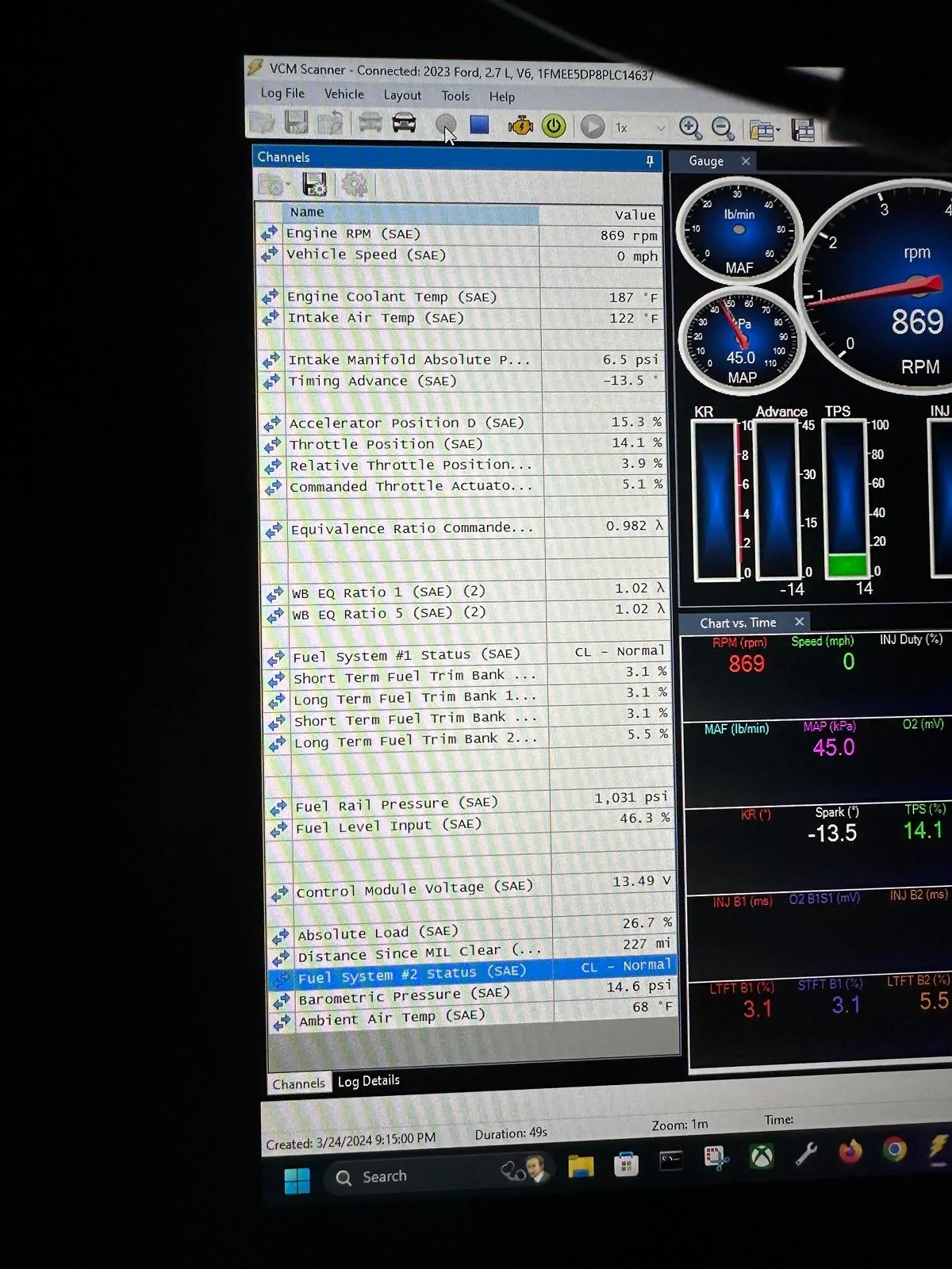

So hello, new guy here. Former coyote amateur tuner with HP Tuners. Just sold it to switch to the Bronco. Landed a brand new 23 Badlands SAS with the 2.7L.
I hear its a bit sensitive to octane. And from my time tuning coyote 5.0's, and using 93, e20, e30 and also octane boosters, I can tell you from experience that any engine starving for octane, will LOVE a bit of extra ethanol going through it.
So as you know (or dont) pump gas is basically e10. 10% ethanol. I used to mix a bit of straight E85 with my pump 93 to bump that up to e20 and even e30. Now as far as I assume, these EBs run in closed loop mode all the time like most modern fords and have a wideband O2 up front measuring AFR as the exhaust passes through.
If the bronco is like the mustang, then it should be able to correct for extra ethanol with fuel trims adding fuel so it can keep stoich of 14.08ish for e10 pump.
Buuuuut, you will get the added benefit of more octane from that extra E in the tank. Basically pushing your 93 to 96ish give or take. And for most factory vehicles, thats more than enough to completely stop any weather related knock you'd normally see on 91/93 only. Or worse 87. This will get you all the timing the EB is capable of adding and it should run very strong. Knowing the size of the tank, the current E content of whats in it plus the E content of the E85 going in, I can calculate exactly the amount of E85 at any given fuel level I would need to add on top of topping it off with 93 to get that perfect e20 or e30 blend.
Now with all that theory carried over from the coyote world, has anyone here done any of this? I assume HP Tuners is not supported and neither would be any data logging with VCM scanner...?
I'd like to test this in my new badlands, but Im unsure if we have WB o2(s) sensors and also do we have the ability to live log the engine for fuel trims at least??

Yā€™all got me curious. And yes sir I can log it. Looks like wide bands and running in closed loop. Thatā€™s excellent. Couldnā€™t read it out as expected like you said.
Ford Bronco Any one try E blend like e20/e30??  Not just 93. IMG_7914
They are widebands and are closed loop all the time. You can run up e30 with 0 issues on the stock tune, but they have the timing clamped down pretty low. I'm one of like 2 or 3 tuners that figured out the ecu swap stuff to make the tuning work with HP tuners. Hopefully some day we can get past all that but right now it is what it is! It's $650 for a used ecu and the loaner computer for me to remotely program it with.
All good man. When Im ready to do it, I will get with you. I used to tune coyotes including my own whipple 10r80 car. Ran 9s on e30 and a stage 1 whipple with no other mods. Car was a beast and I had that 10R80 acting right. HUGE pain in the ass getting all the TCC settings and shift schedules correct. Smooth out all the quirks that guys taking them to the dealer for thinking its hardware and not tuning related. Shame I sold mine, but Im loving the bronco. I'll run some e30 in it next week see how it likes it. I only logged it once to see if I could. I will need a real channel list at some point for this one.
