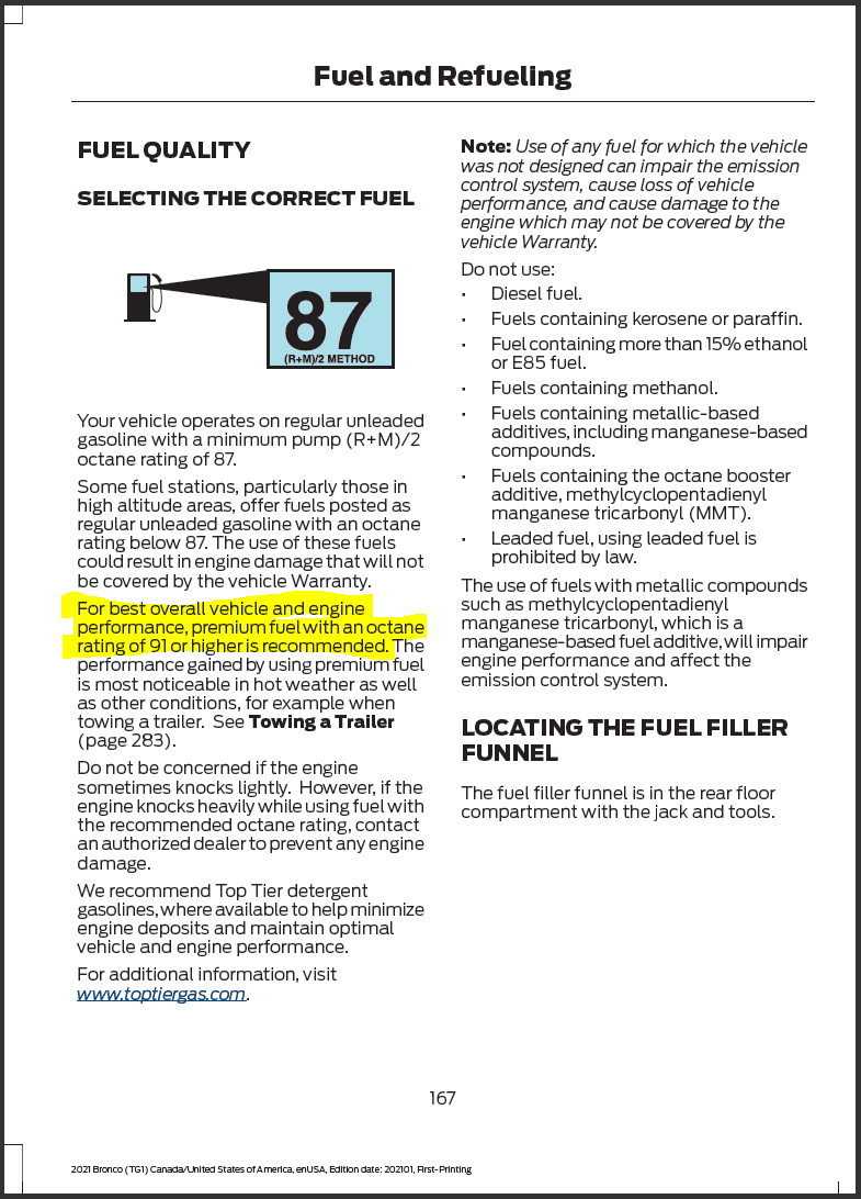

I've seen the difference in torque/ HP numbers discussed "on the internet" but the owners manual is silent on the actual numbers.
Any idea where the official numbers come from?
Your vehicle operates on regular unleaded gasoline with a minimum pump (R+M)/2 octane rating of 87. Some fuel stations, particularly those in high altitude areas, offer fuels posted as regular unleaded gasoline with an octane rating below 87. The use of these fuels could result in engine damage that will not be covered by the vehicle Warranty. For best overall vehicle and engine performance, premium fuel with an octane rating of 91 or higher is recommended. The performance gained by using premium fuel is most noticeable in hot weather as well as other conditions, for example when towing a trailer. See Towing a Trailer (page 283).

I got the 1% off the Ford tech sheet, where are you finding 3.75%
Torque 415* (410 regular fuel)
2021 Ford Bronco Full Tech Specs | Bronco6G - 2021+ Ford Bronco & Bronco Raptor Forum, News, Blog & Owners Community
You’re right. The 2022 spec sheet lists regular as 315/410. An older CNET [article](https://www.cnet.com/roadshow/news/2021-ford-bronco-power-hp-fuel/) listed 300/400. Does look like the increase is even more minor than originally published; 15 and 5 rather than 30 and 15.
Maybe it’s time to start migrating back towards 87 for me! Wonder how much (if at all) it will impact my 18.7 lifetime mpg…
