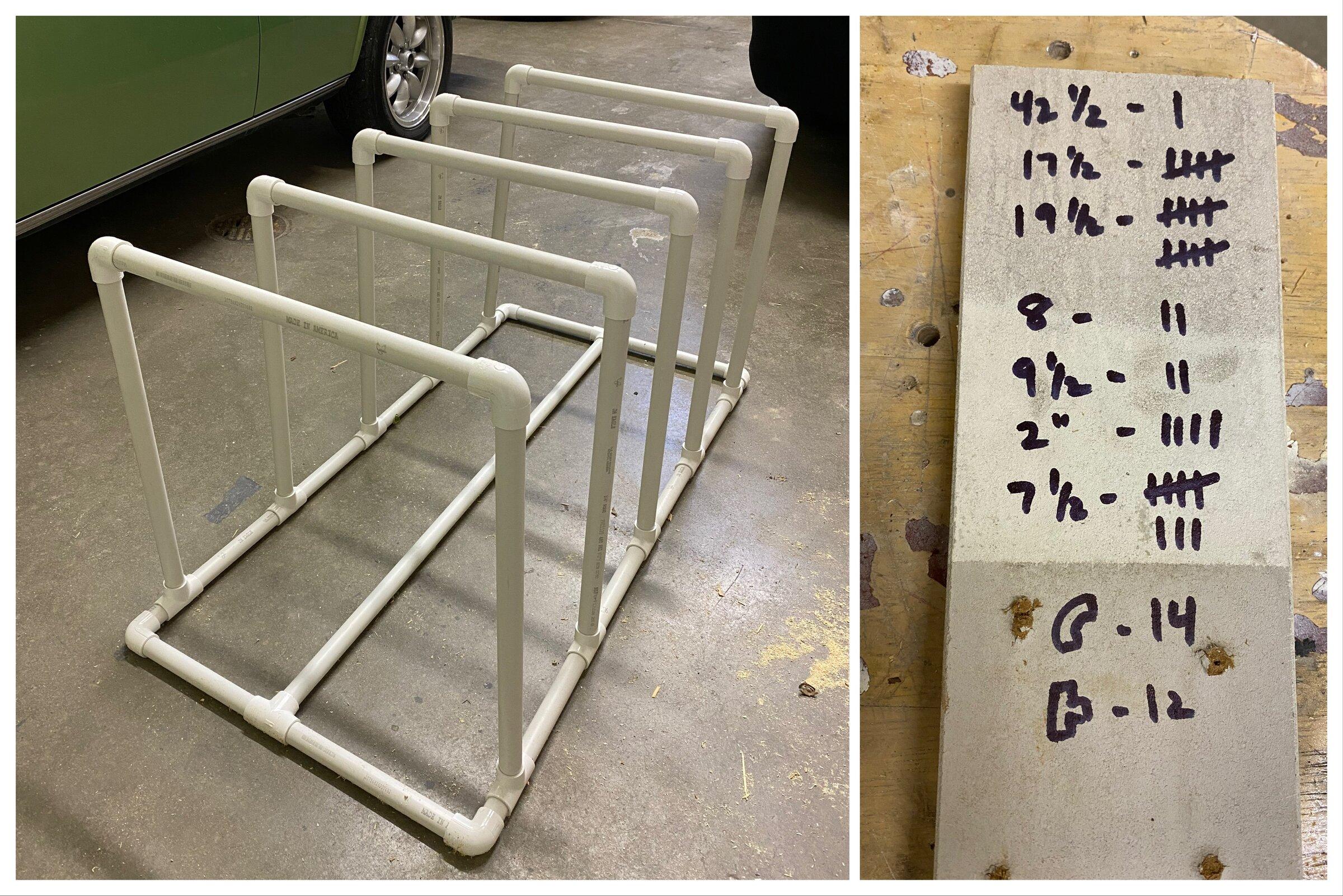

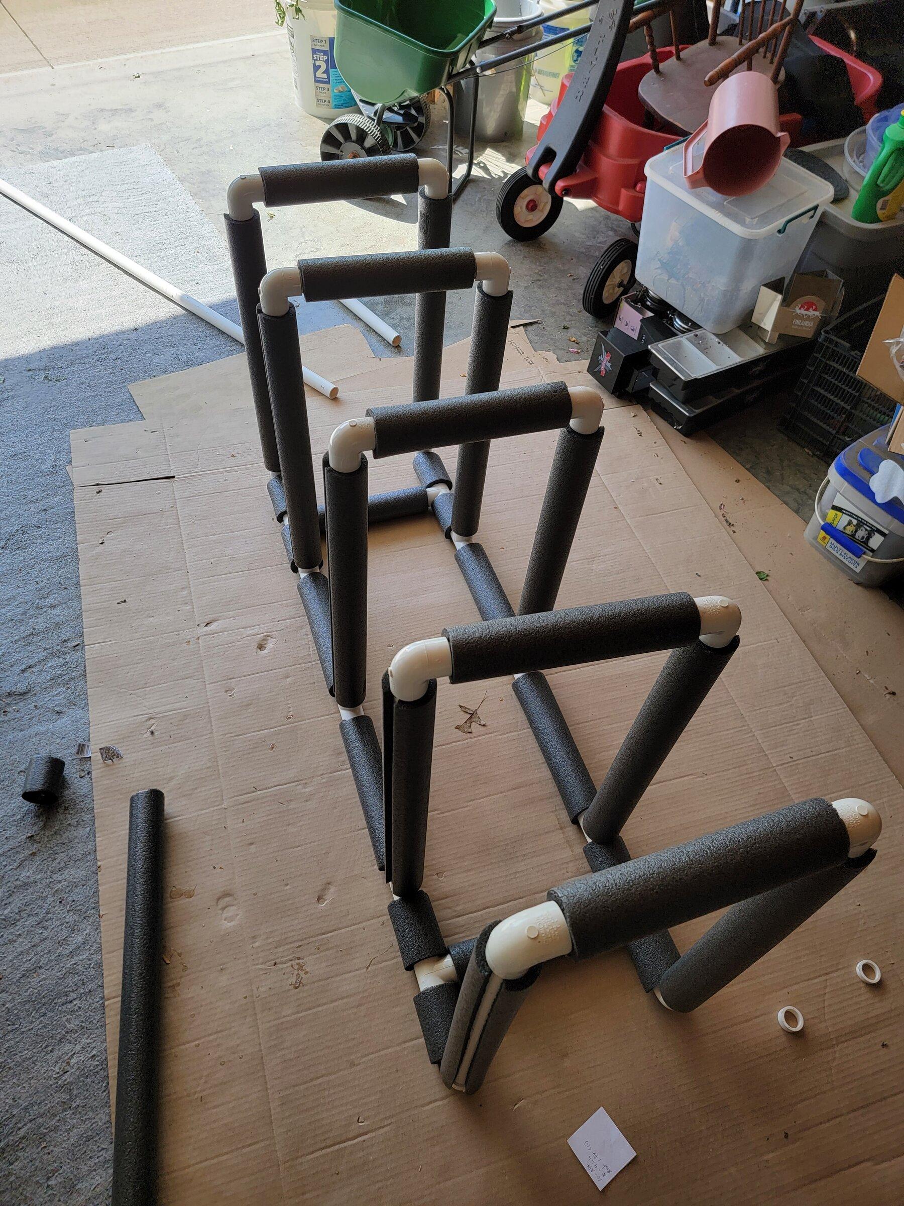

I found this Door holder idea on the inter webs for a Jeep and decided to utilize the plans for my 4 door bronco.
4 - 10' X1" PVC pipe
 schedule 40
6-1" pipe insulators
 (black foam)
14 - 1" PVC elbows
10 - 1" PVC TEEs
1 - Can of PVC cement
Cut the pipe into 10 - 2 foot sections,
 8 - 4 inch sections,
and the rest into 1 foot sections. use the images above to copy the assembly. Message me for more info if you have questions.

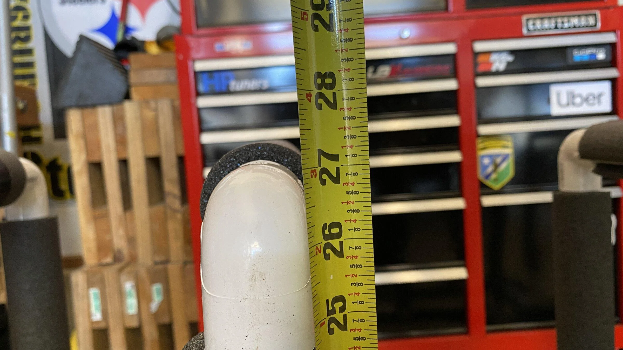

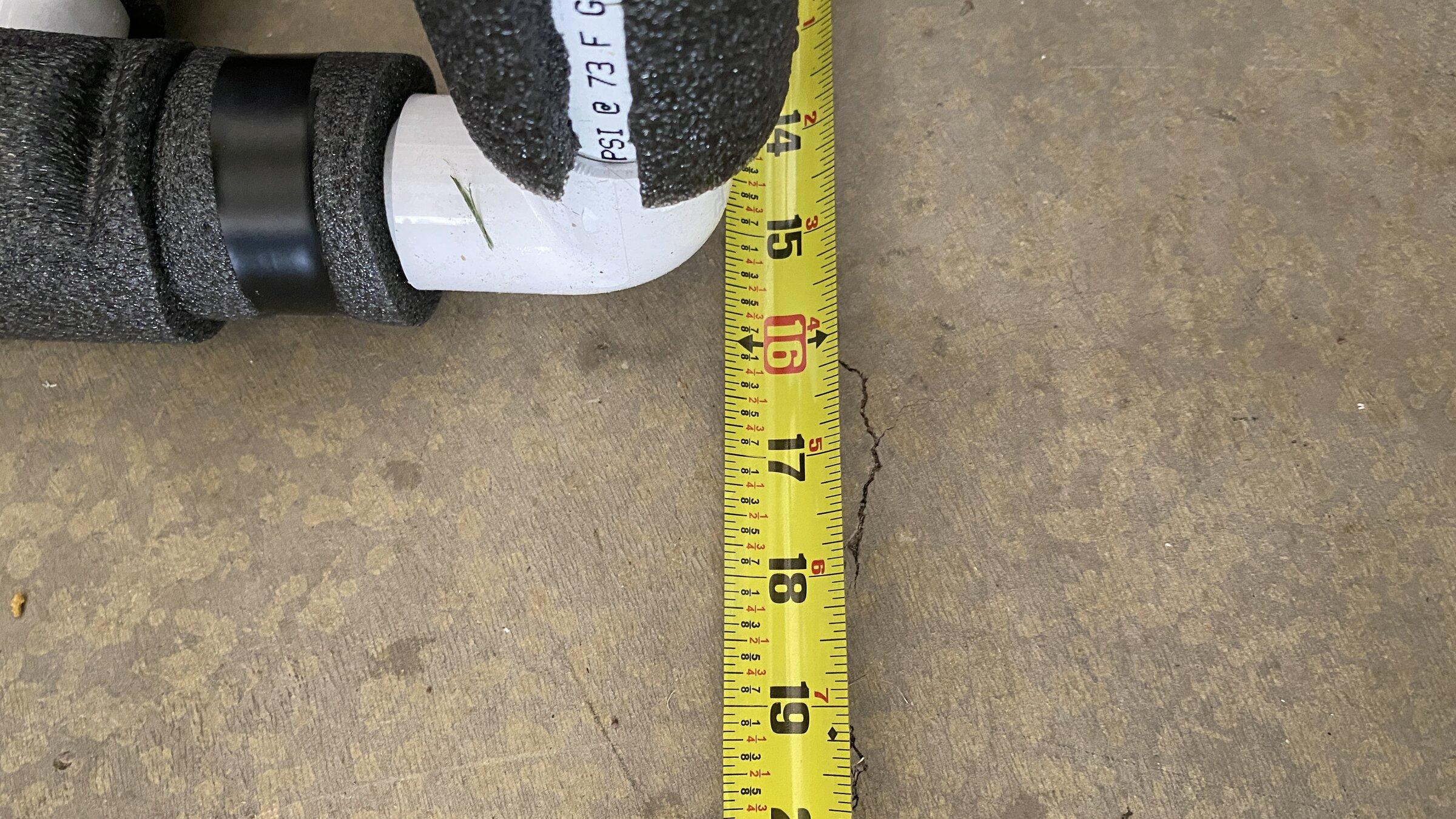

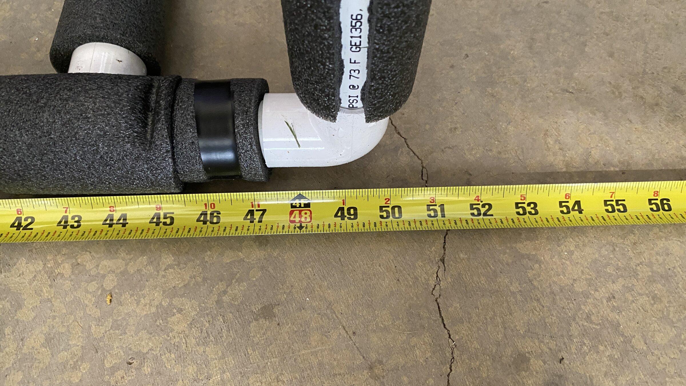

What is the width of this? The instructions indicate 1 foot sections but it appears to be longer than that and would also need to be in order to mount to the dolly's pictured later. Thank you
I dont know off the top of my head. I can get pics of measurements later

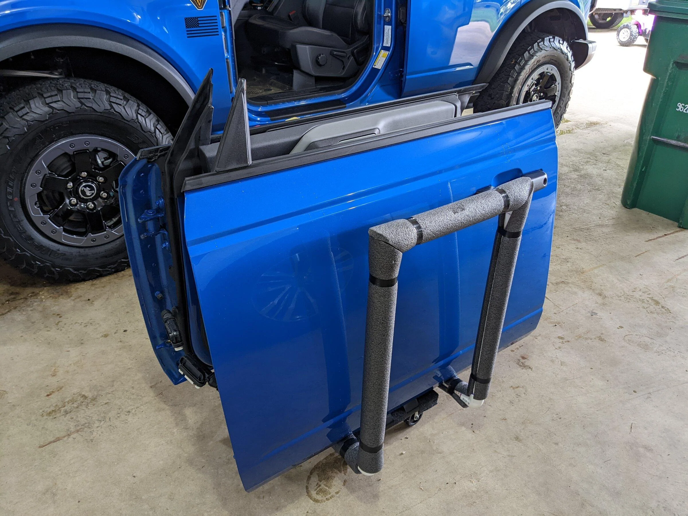

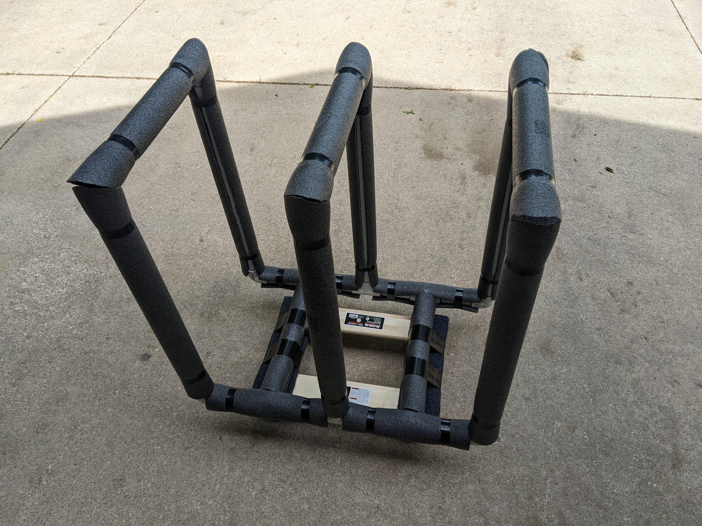

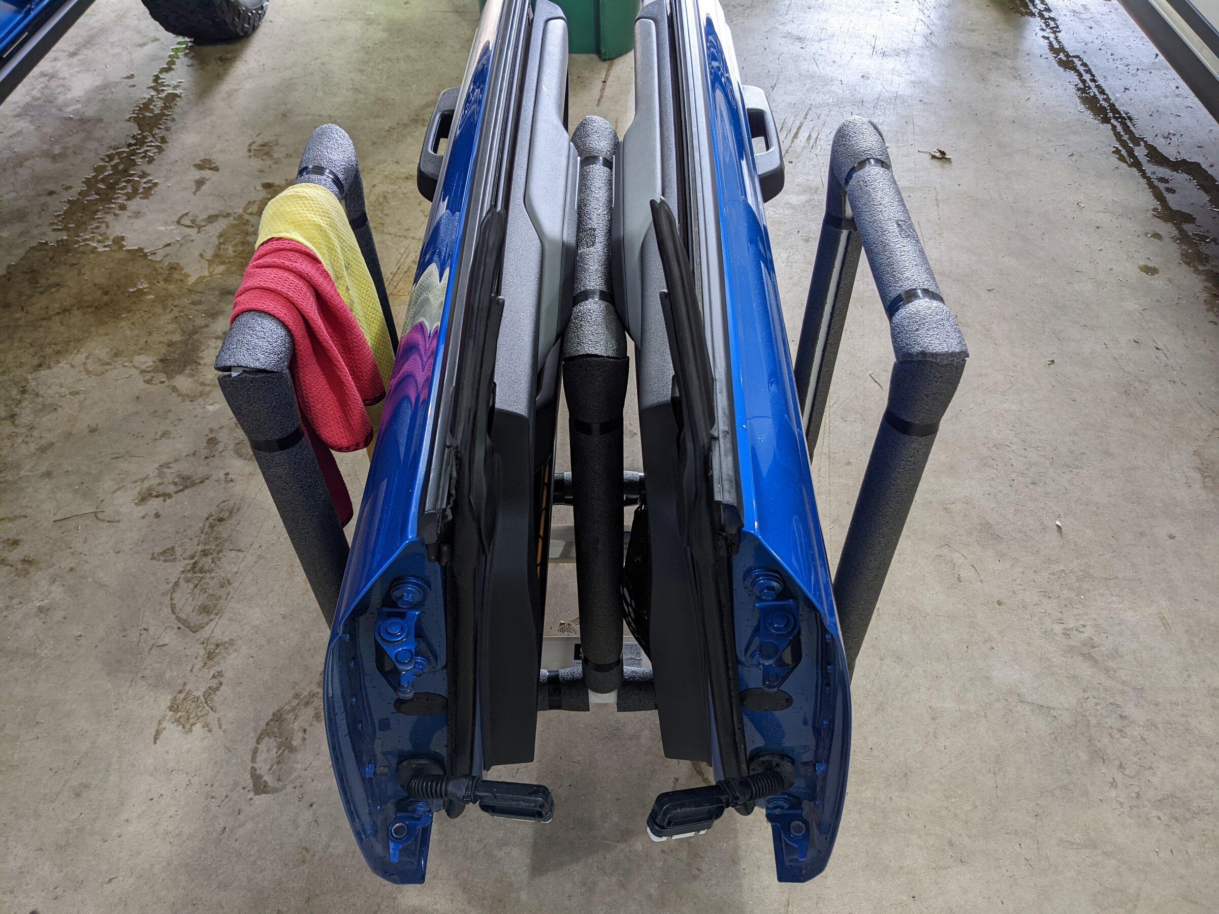

Thanks for the guide! I changed it up a bit and made a rack for just 2 doors. Plan to do another rack for the other 2. More material and cost, yes, but easier to store and move around.

I am mid build on the 2nd cart for the back doors but need more PVC and foam. Building 2 carts needs more material, so you'll need 5 10' sticks of pipe and 8 sticks of foam.
I also made mine a couple inches wider in both directions.
