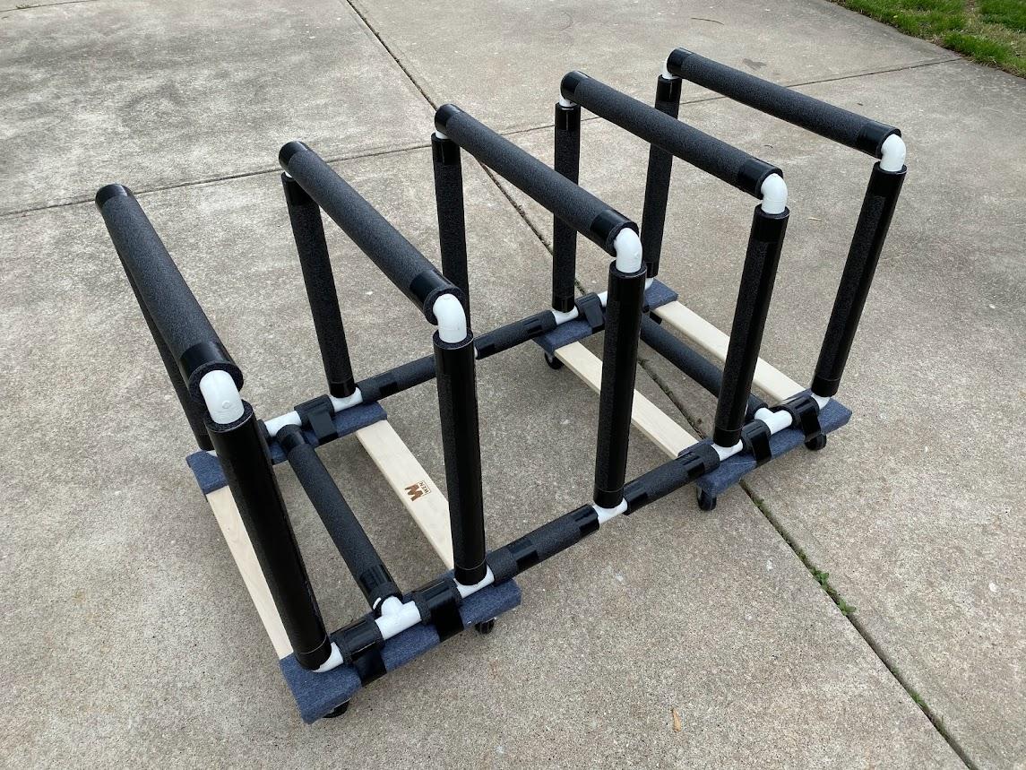

I found this Door holder idea on the inter webs for a Jeep and decided to utilize the plans for my 4 door bronco.
4 - 10' X1" PVC pipe
 schedule 40
6-1" pipe insulators
 (black foam)
14 - 1" PVC elbows
10 - 1" PVC TEEs
1 - Can of PVC cement
Cut the pipe into 10 - 2 foot sections,
 8 - 4 inch sections,
and the rest into 1 foot sections. use the images above to copy the assembly. Message me for more info if you have questions.

This is very nice, and I think what you did to secure the rack to the dollies is just fine.
Thank you sir. Yeah, if I see any issues with how they're secured to the dollies, I'll figure out a way to bolt them down. But so far so good.
