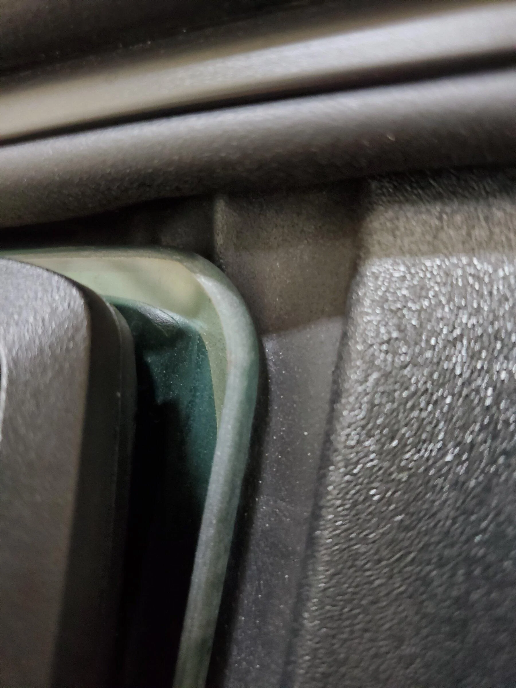

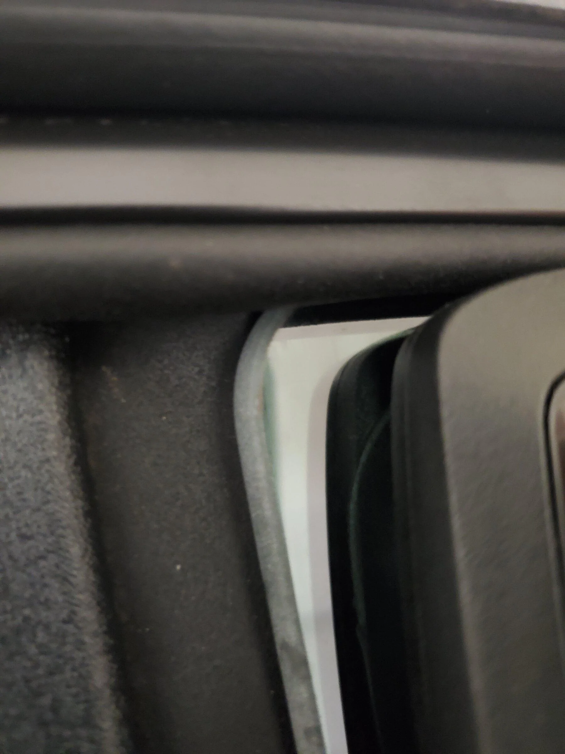

Does anybody know how to recalibrate a door window? When fully closed, the driver side door window is about 1/4" low compared to the passenger door window. The gap causes air to whistle in the cab when I'm driving.
My service department is 3 weeks out for their guy to recalibrate...
* Note the black thing in front of the glass is my key fob so my phone camera would focus on the edge.
Driver side door window with 1/4" gap below molding.
Passenger window tucks up under the molding.

The problem I'm experiencing is more complicated than resetting the "Bounce Back Override". Your windows are already aligned and your two sec rule...repeat process simply reboots the window up/down controls so your windows operate correctly.
The glass on my driver door is out of alignment and has to be manually adjusted which requires a pretty involved door panel removal and more...
If anybody is experiencing a whistling sound inside the cab, it's possible that one of the door windows is out of alignment - it's easy to see the problem if you compare the fully closed positions of each window - you can try to DIY with the steps outlined in the "Shop Manual" attached in post #14 by @Ksjrb03 or you might ask your dealer to fix it...

The service department at my dealer has corrected the window problem I experienced - the service tech indicated that the fix is a 40 step process that takes several hours.
