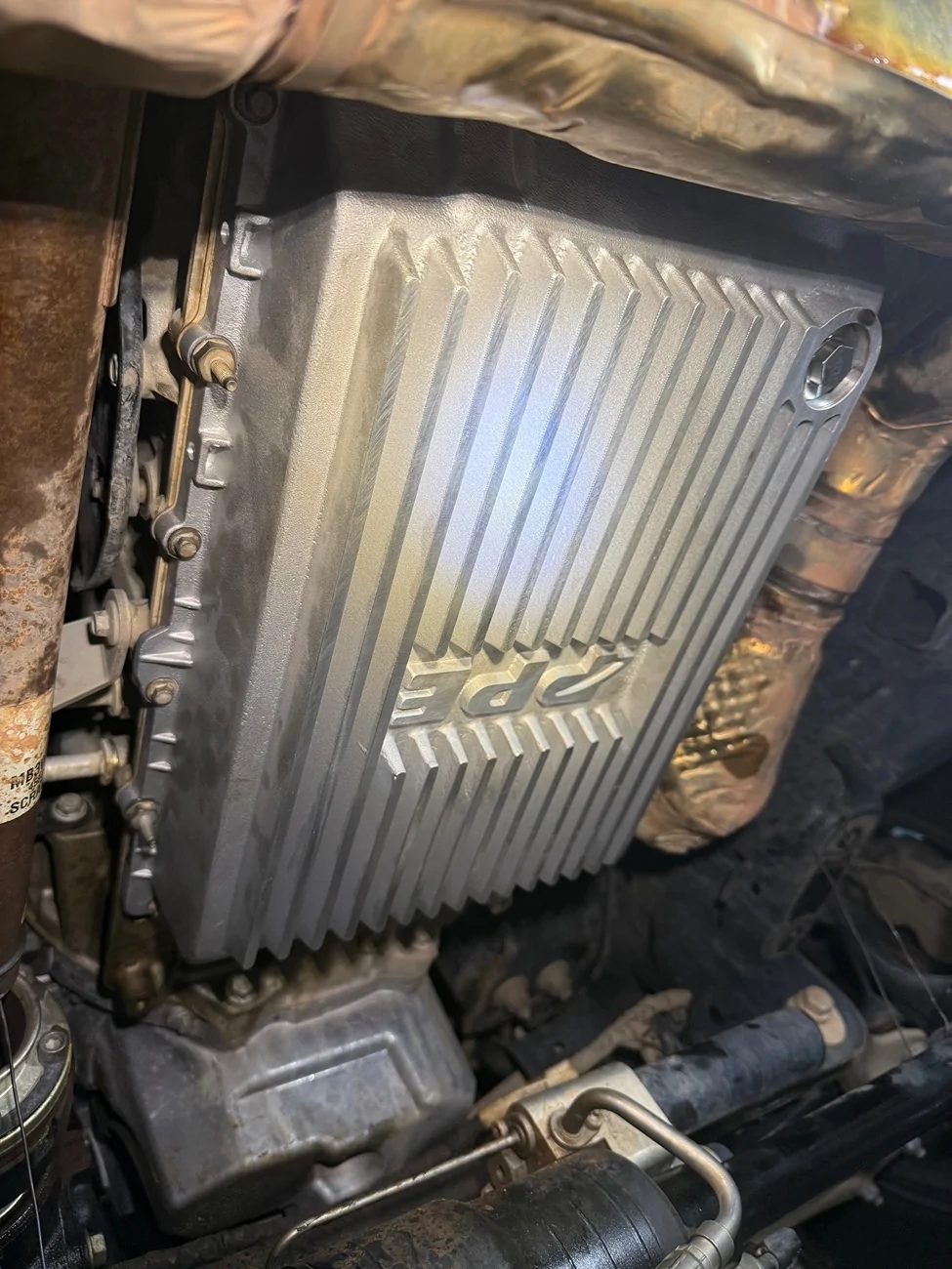

Get a PPE pan with drain plug then can refresh when ever want.
I put the PPE pan with extra capacity in long ago. It helps the whole process for sure, but even with the added capacity, a single drain does not remove but about half of the fluid, necessitating multiple drains for a significant flush. That and the almost unreachable fill spot right next to ones searing exhaust makes the process difficult.

The flush machine is great but ned about 60+ qts to get a full change on previously untouched ATF fill because all it does it dilute old fluid with new so it uses a lot to get to new state and at the price per Q of full synthetic ATF (critical) its very costly.
With PPE pan, efreshing whatever you can every other oil change or selected frequency is more than enough to keep additive packages fresh which is the main point, while not wasting costly ATF.
Id say your early PPE pan puts you in an ideal situation with no need for a flush at all. You just need the optimal ool for accessing fill plug and to fill.
On my S550 Mustang I used 3' of extensions thst worked great and same lenght of tubing on a funnel.

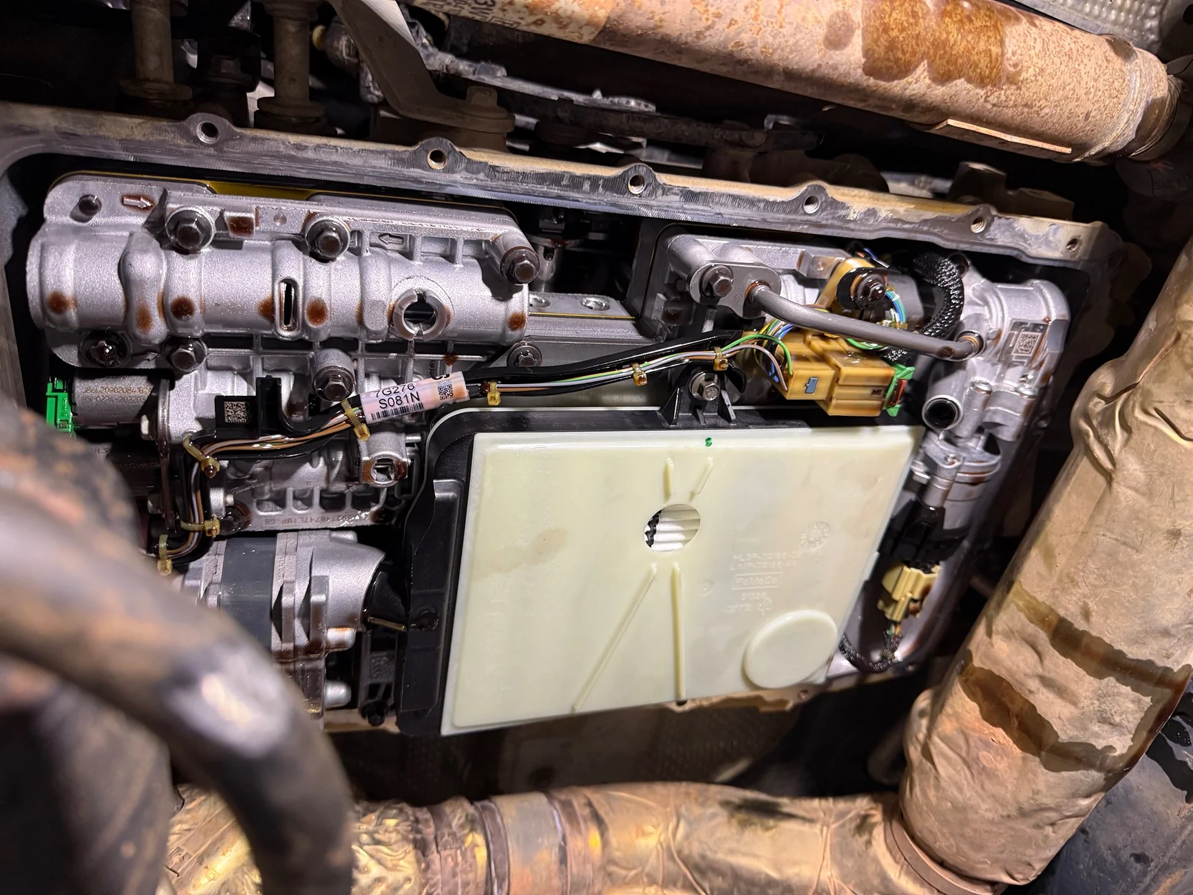

You’ve got to drop the plastic pan on these things, and the transmission housing is aluminum, meaning very easy to strip the mounting threads if not done correctly. Because of that, I would only trust the Ford dealer to do it as insurance in case anything goes wrong. Someone not paying attention over torques the screws, and you have a problem on the transmission housing itself now. That said, inspect their work when done for this very reason. A flush won’t get the filter out, and if this is the first time you’re having it done, then you absolutely 100% want to replace the filter, as it’s holding all of the initial breakin material still. Which, given that I switched over to the PPE pan myself at just 4,000 miles and was stunned to see how dirty the filter already was, is significant.

I actually bought a 1/4” drive torque wrench when I installed the PPE pan and new filter. Even removing the fill plug when trans is up to temp isn’t all that difficult once you figure out the exact way to precisely put your hand on the plug w/o burning yourself (and get over the fear of burning yourself). One also needs an inexpensive fluid pump to get fresh oil into the trans.
