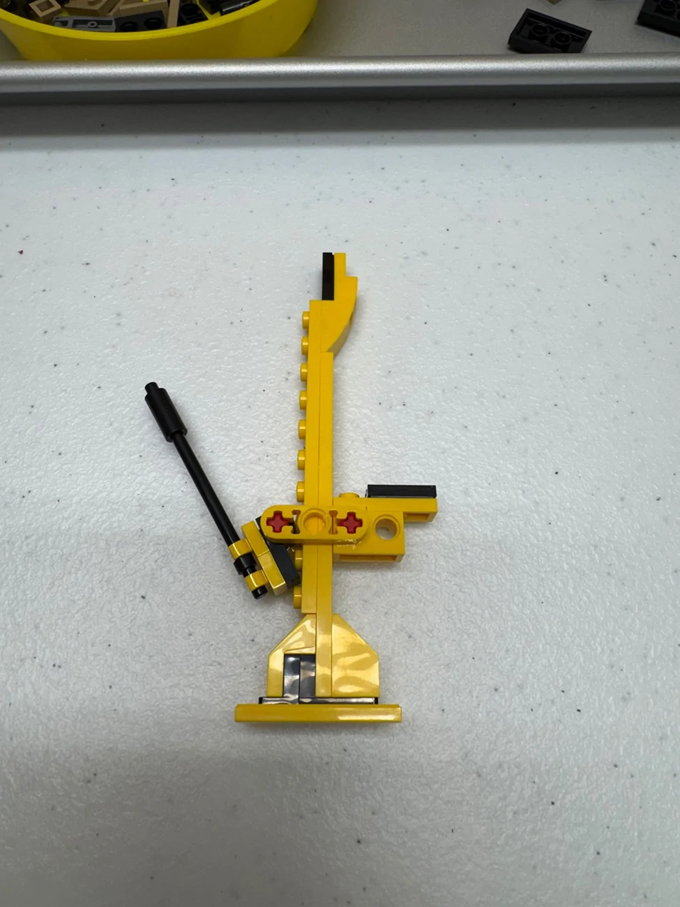

For some humor…yes that’s a Lego farm jack

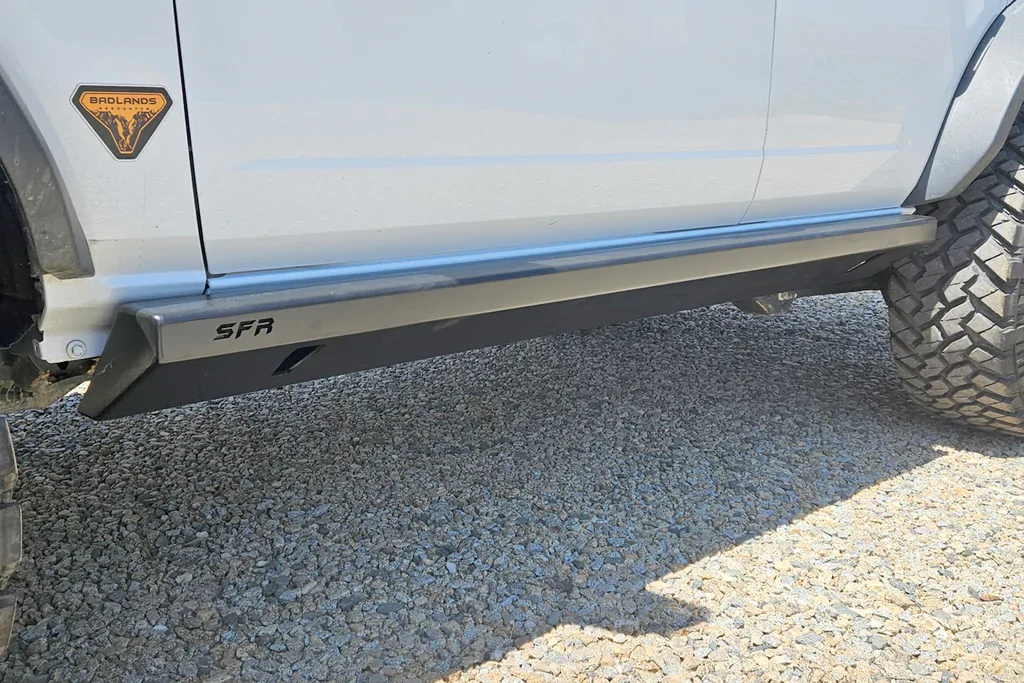

Same category as traction boards, useful but more effort and hazard than I want to deal with. Most manufactures don't make sliders or bumpers that really work with high lifts anymore.
StinkyFab has sliders that have notches for high lifts front and rear.
Yes and no, the notches are a gimmick. High lift is the worst jack to use to change a tire and that is what those notches are for. When offroading you need to be able to put the jack in the most stable location, while stuck (rocks, sand, etc) and not damaging the body when it comes down.

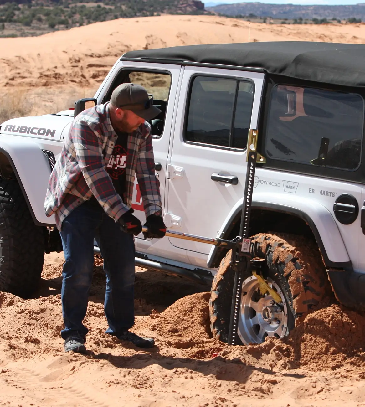

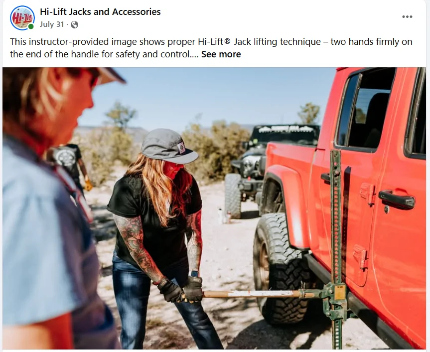

I tried to find a picture of a high lift being used to help get over an obstacle but everyone stacks rocks now... So like a good troll I went to https://www.facebook.com/hiliftjacks
We use to use them in the sand at the pismo dunes but then the kenetic rope showed up. Hell I still have my wheel high lift adapter in the garage, talk about a lot of effort to get an RV out. You actually jack at a 45 degree angle so it slowly pushes you forward out of the holes.

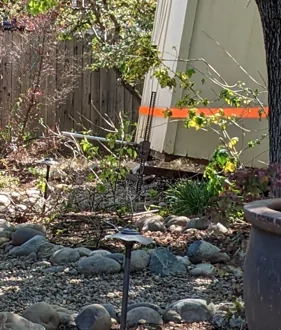

Last time I used mine was to move a shed and all you made fun of me for not using a winch...
🤷‍♂️ It ain't why I bought 'em, but @StinkBug are they a gimmick?
Personally, I hate Hi-Lift jacks and don't find them to be useful on the trail. They are dangerous, and difficult to use. I stopped carrying one many years ago. That said, I wouldn't call slots that make it possible to use one a gimmick. Without the slots there's zero chance of getting the jack to do anything on a ramped surface. We designed our sliders to be far enough from the body for good protection on the trail, with the added benefit that a hi-lift will also have clearance from the body. They are functional jacking points and I've personally tested them, even though I despise those jacks. Other people like them and carry them, so why not cut the holes so people can actually use them if they want?
