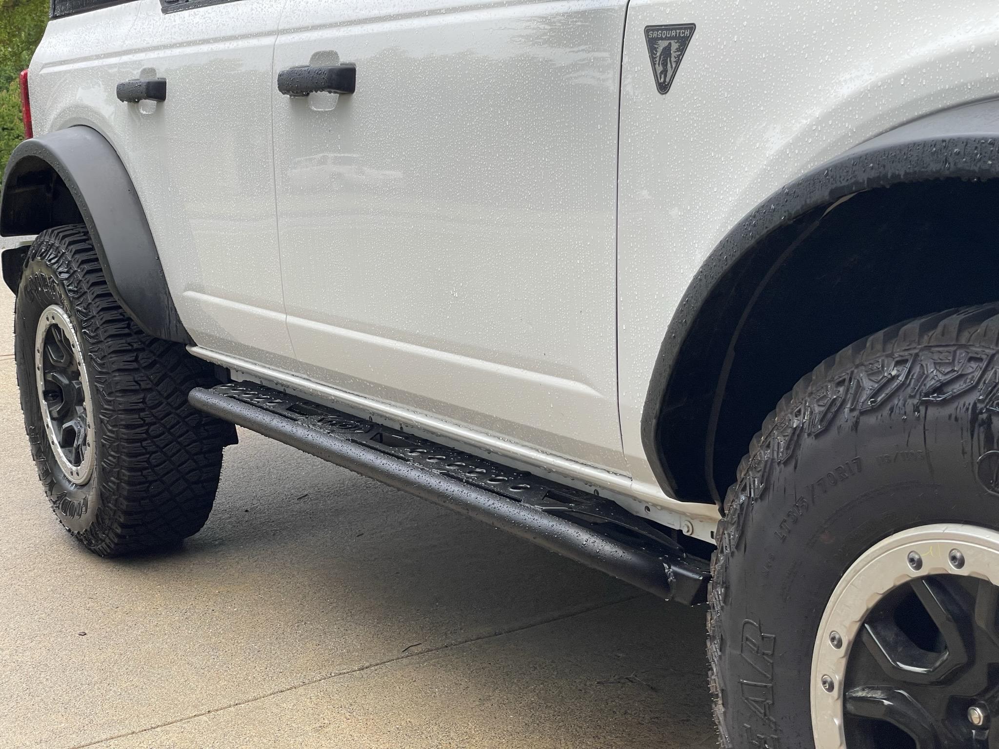

got the passenger side mounted last night. need to cut the gusset on driver side to make room for the brake line. hoping to get that done tonight

I just bought replacement bolts at the hardware store that worked well. Installed my sliders on Monday. Drilled some of the frame holes but still need to do other ones. My right angle drill was too big and I don’t want to remove them again so I’m getting a smaller one. And I also had to trim the drivers side for the brake lines like others. Don’t see how else they would not rub. I did have an issue with one of the pieces of metal with the 2 nuts welded to it. It appears one of the nuts was damaged in the threads and it needs replaced. If they don’t want to send me a replacement I’ll probably cut the nut off and weld a new one on. Just need the time.

As for the brake line, try unclipping the plastic that surrounds the front body mount on the driver side. This allowed a little more slack in the line, as well as pulling the frame clip between the front and center mounts, and we zip tied the line to the wire harness. Our Bronco had about 1/4" clearance then.
