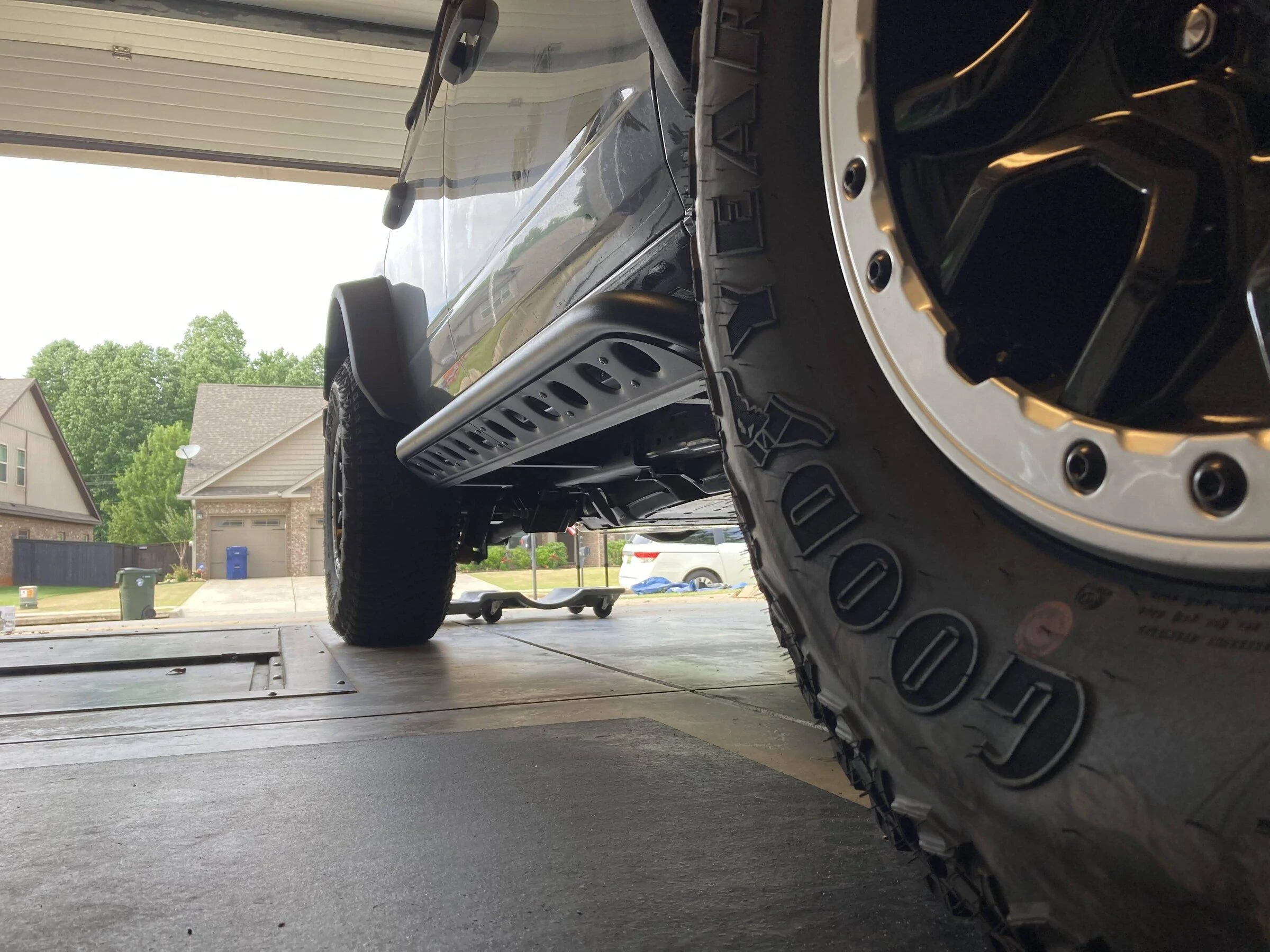

My install went OK. I didn't get the holes drilled yet so I'm in "step config" and not full "slider config" lol. I had help from my neighbor. Would have been impossible doing this by myself.
I didn't even try doing a fit check on the driver's side, I went straight to cutting steel (hat tip to @Frankie945 for the pics). Glad I did as there is no way it would have fit without it so it saved me a few minutes to go straight to cutting. No clue how LOD got this to fit as-designed.
In terms of the rest of the fit, everything aligned perfectly, so it was pretty easy.
I did have one gaffe during install. On the passenger side there is a really tight fit getting the 4.5in bolts through on the rear end by the gas tank. I have small-ish hands and it was still tough to get both washers and the nut up there between the gas tank and the frame. Those of you with meat hooks will probably need to recruit a 10-year old kid for help, lol. I dropped two of the washers into the gas tank armor plate. Recovered one, but the other is lost for eternity. We tried dropping the entire armor plate, but the gas tank isn't strapped in independently so it lowers with the plate...Once we discovered that we bailed on that recovery and I went to the hardware store to buy another large washer.
One other note that I'll mention that I hadn't seen reported on here: On the rear end of the driver side install, I had to push the 4.5" through-bolts to the top end of the hole tolerance before tightening. If I let them sit on the bottom of the hole tolerance, the nut on the inside of the frame made contact with my brake lines. This is obvious when doing it yourself, I only mention this in-case someone is getting this done by an outside shop, I'd check this when you get your vehicle back.
Finished product looks great. I hope to rent a right angle drill next week to finish the install.
