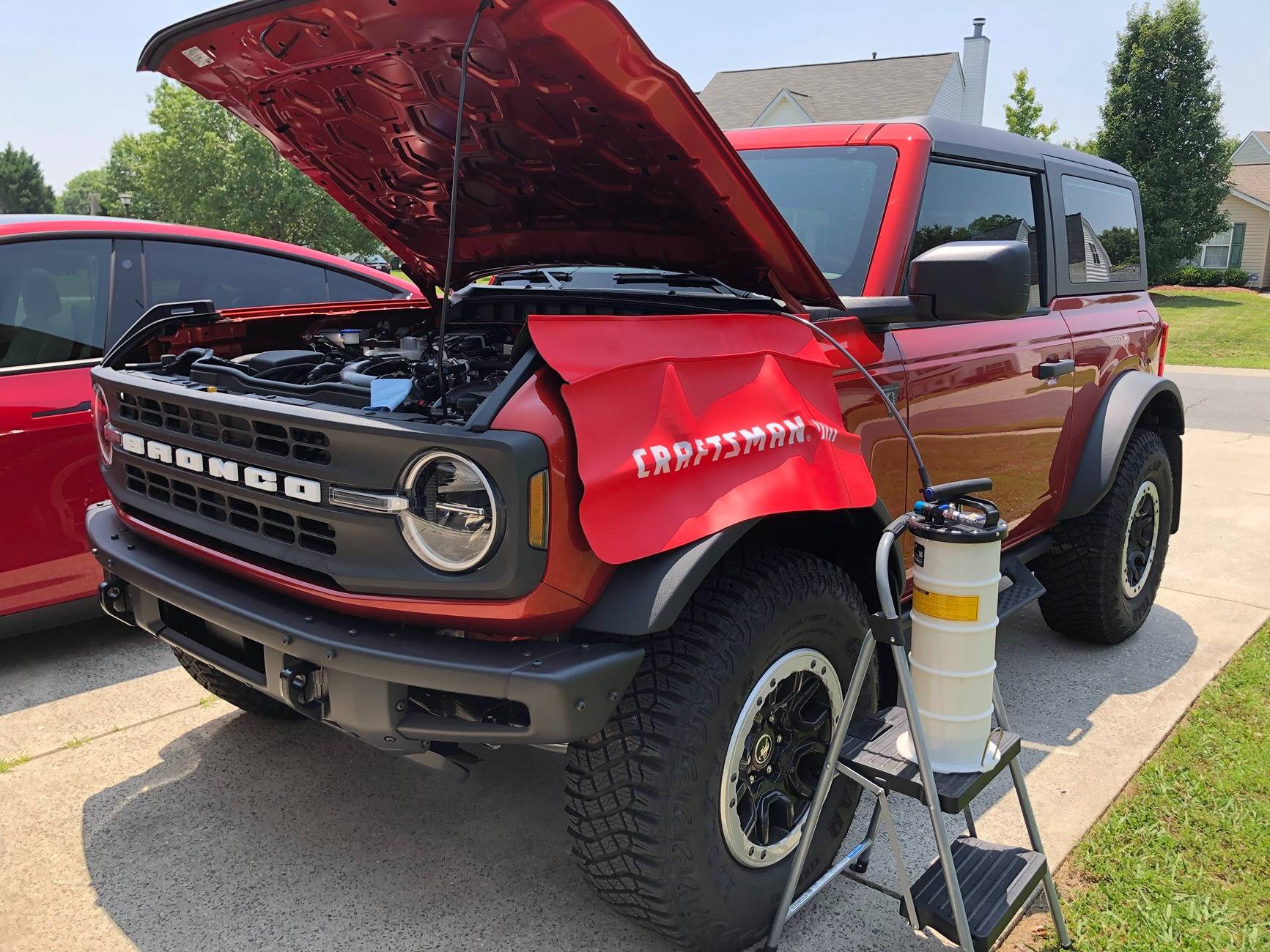

I hate the drain plug if you are changing your oil at home, 6 quarts of oil drained in a few seconds splashes everywhere. I use an extractor and just remove the last few ounces through the drain plug. It takes longer but It's more controlled and cleaner.
