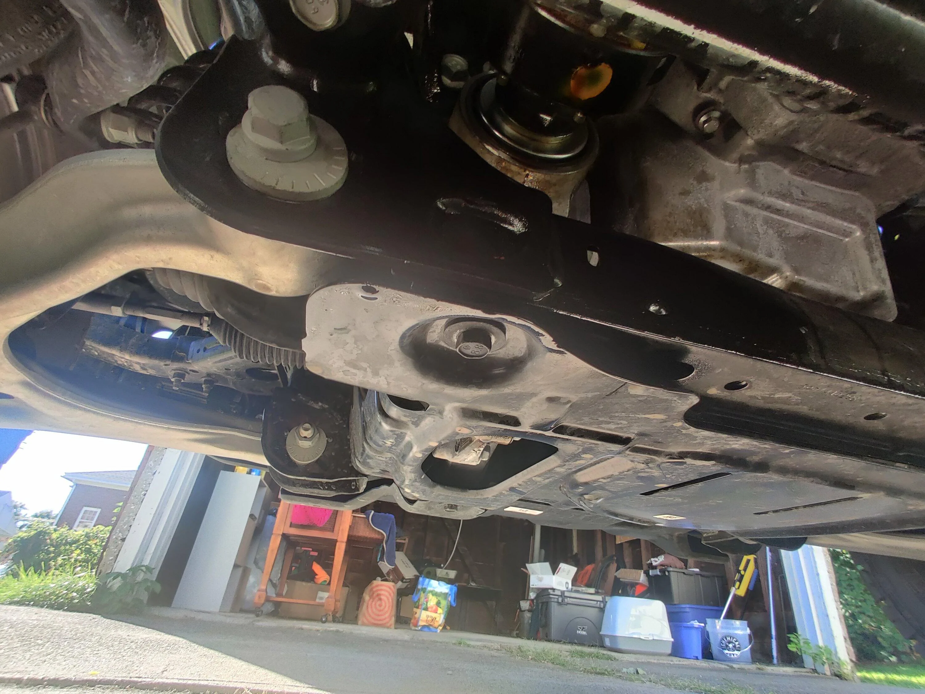

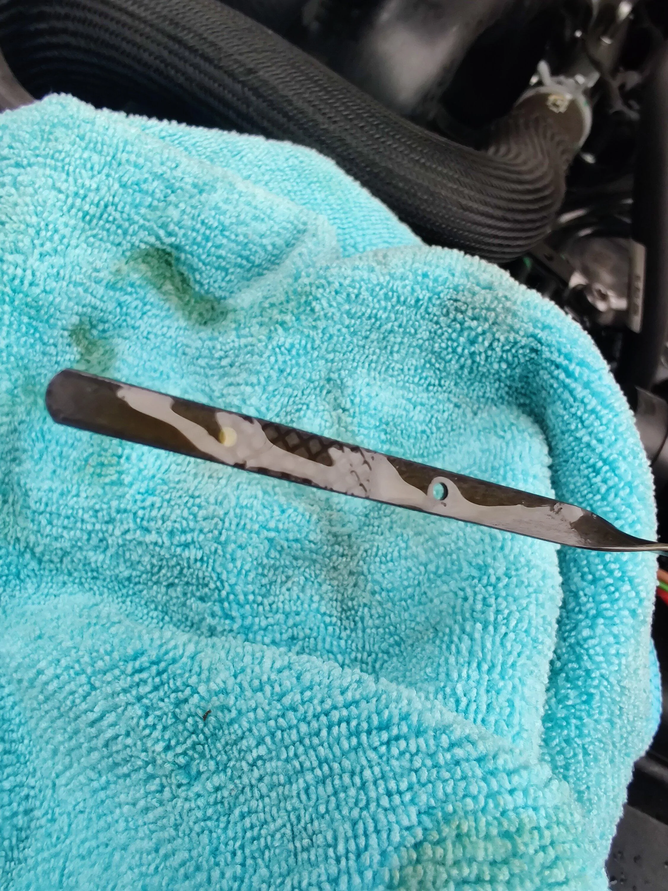

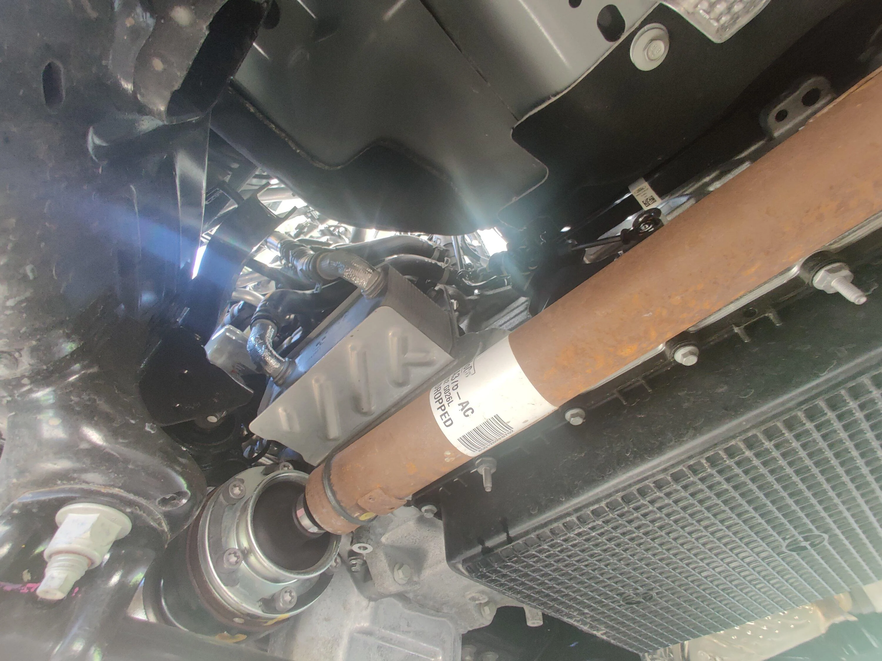

Got these yesterday, raining today but you can't really see much I guess.
Thanks for sharing the photos. I can't actually tell where the top of the oil is showing on the dipstick, but I think the space between the holes at the end of the dipstick represents approximately one quart. :unsure:
If the tech didn't remove the oil drain plug at all and just dumped in another 6 quarts for the service fill, the oil level would probably be WELL above the twist (e.g., a couple of inches) to reflect 12 quarts versus 6 quarts. Maybe he drained the pan and changed the filter, but simply overfilled the amount needed?
You definitely have a problem on your hands, and you deserve to get it fixed. You also shouldn't drive it until it's fixed. But I doubt you would have been able to drive it around town for a day if there were truly 12 quarts of oil in the engine. I can see driving around with 7, 8, or possibly 9 quarts of oil in the engine, but not 12 quarts. 🤷‍♂️

The leak you are showing isn't the front crank seal it is the front differential pinion seal. Also doesn't look that overfill. The hole in the stick is the full level they come from the factory at. On the 2.3 the oil filter is mounted above the "leak spot" you show in the pictures. The lube tech probably just didn't clean up after he changed the oil. They do make a mess when removing them.
It's hard to see where the level is but it almost looks within the hash marks. Is the last picture showing oil coming out of the channel? If so that is the diverter when you pull off the filter, it collects the oil that would spill and channel it to where you can collect it. Is it possible the oil is coming from the filter? The filter maybe not tight or double sealed or something.

Thanks everyone I appreciate the advice and I agree now after checking again and hearing the responses that it may have just been a little over the full mark. Crank shaft or differential seal hopefully isn't a leak or more serious problem and is maybe just a filter installation issue. Love having this resource as I had to wait the weekend before I can call on Monday

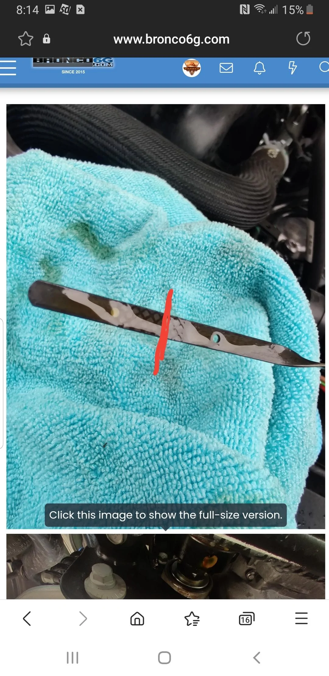

Hopefully no harm done. Does this appear to be the level? If so, you might have lost maybe 1/4 quart. That doesn't seem like a lot but I can attest that small amount could look like a disaster.
Btw, that oil filter is a pain in the ass to get to. I have long arms and I have trouble reaching it if the tire is not removed. I can see it being a problem for many people.
Yes little more but basically around there. I'm thinking the oil filter might be the cause of the mess underneath tho which would be good news. Fingers crossed just forgot to clean up and filter is loose

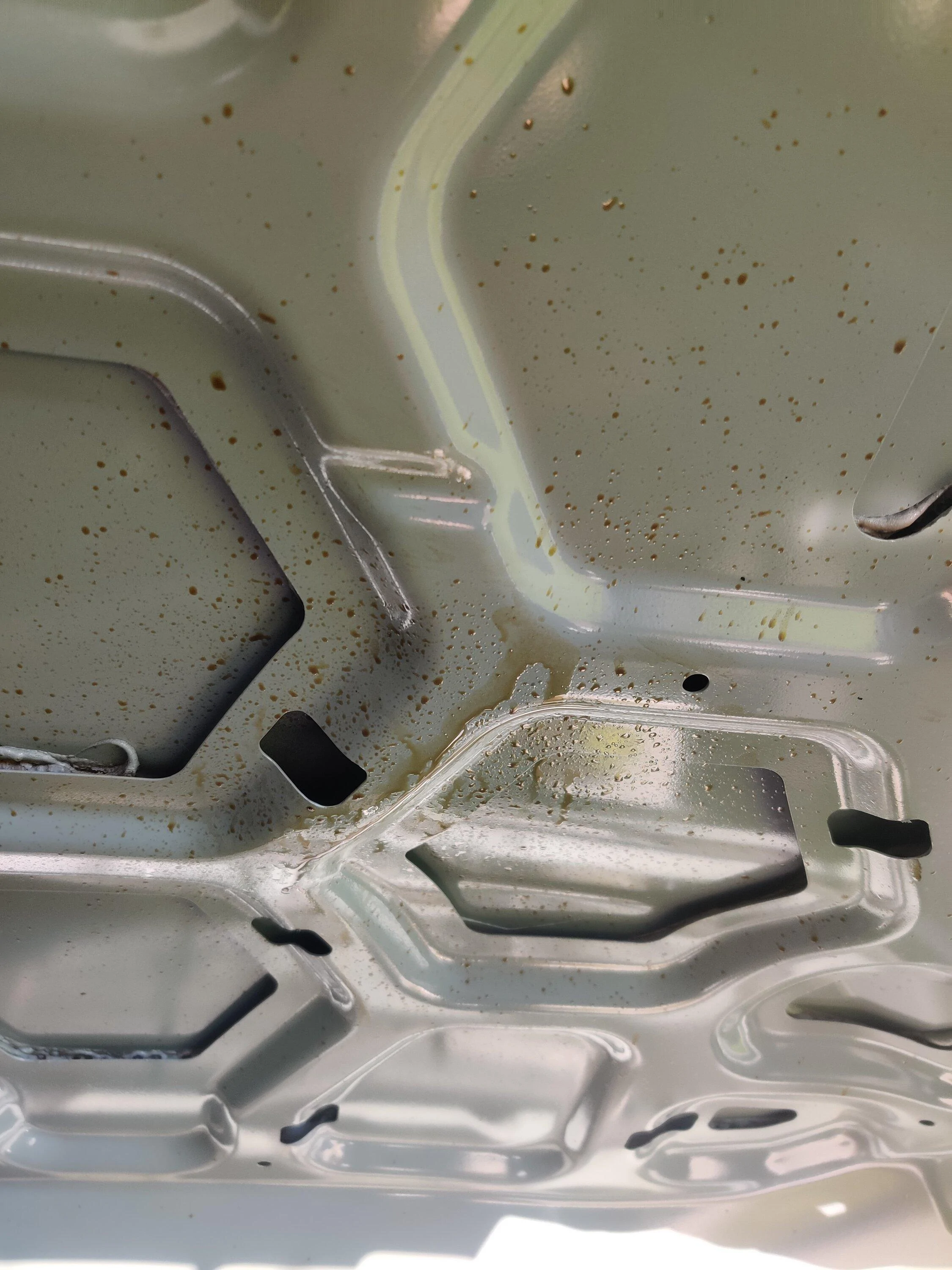

Hello, just brought my BD in for the first oil change at my Ford dealer on Friday. Went to do some engine work and oil is all over the place. Underneath the hood all in the bay. It seems they may not have drained the original oil so I'm running twice the amount. Drove only for one day around town. Also seems like oil all around the crank shaft. Question is can I drive it and also do you think one day of driving has done engine damage? Would appreciate any advice as I'm panicking a bit. Thanks
I would think the cause could be the engine oil filler cap not secured at some point. Happened to me once, and got oil all over including spraying on the hood underside.
Also, the oil on the underside of the hood, seems a bit dark for newly changed oil. So I wonder when the issue actually occurred, had you looked in the bay recently, prior to the oil change?
Yeah definitely wasn't there before I just detailed the outside and had it popped to do some drying
