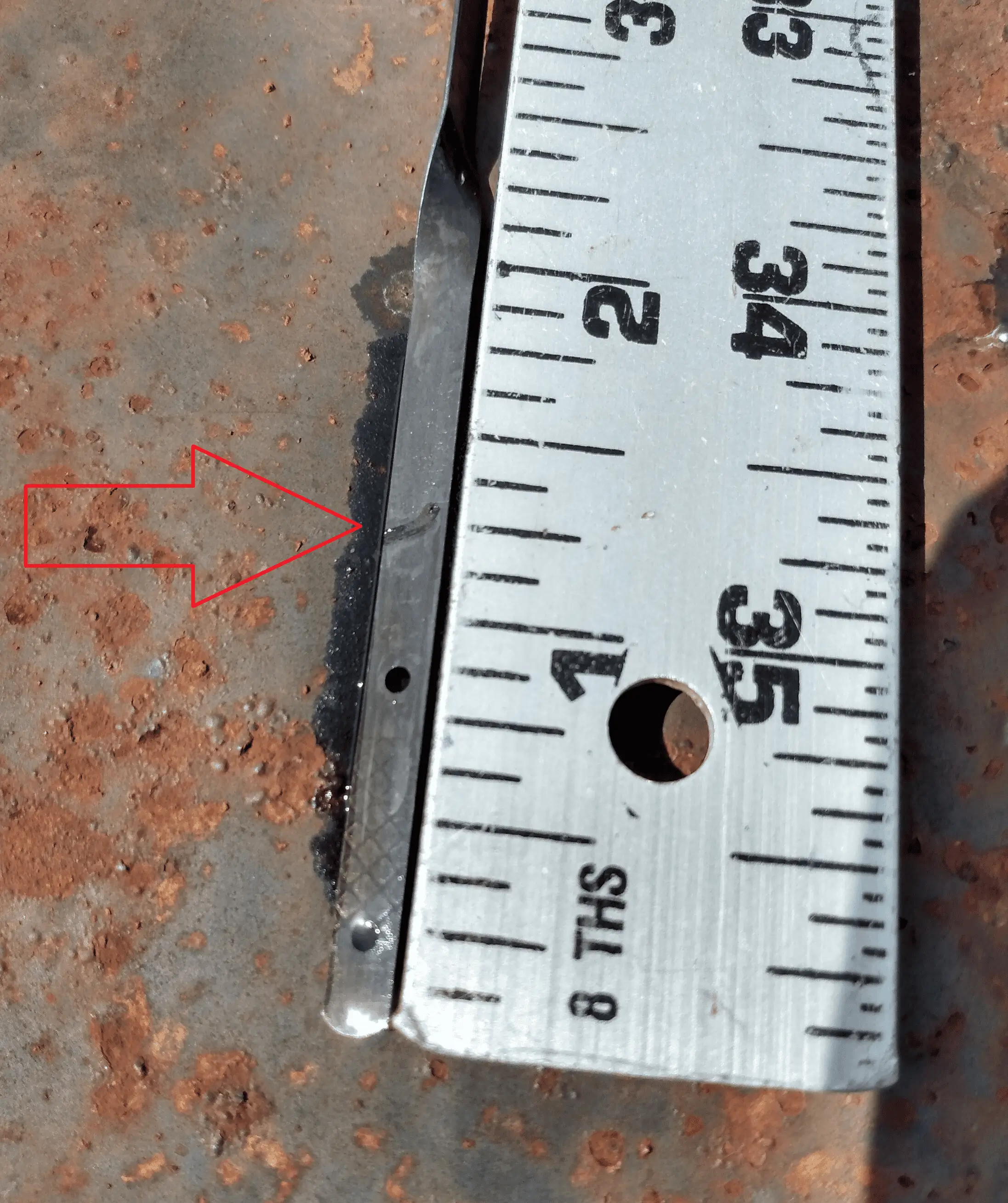

I just did my first change at 1050 miles. Oil life was at 85%.
It prob wasn't necessary, but I like to do an early oil change just after break-in. It's more of a habit since I've rebuilt a few engines on 60's-70's cars.... there's usually more wear during those early miles.
My Bronc was overfilled at the factory, the level was over the 2nd dot on the dip stick. I drained out 7 qts, and put in 6 qts which took it to the top of the cross hatched area on the dip stick.... just right.
Original fill was at the 1-1/4" mark, where the arrow is. It should be just under 3/4"(below the 2nd dot)
