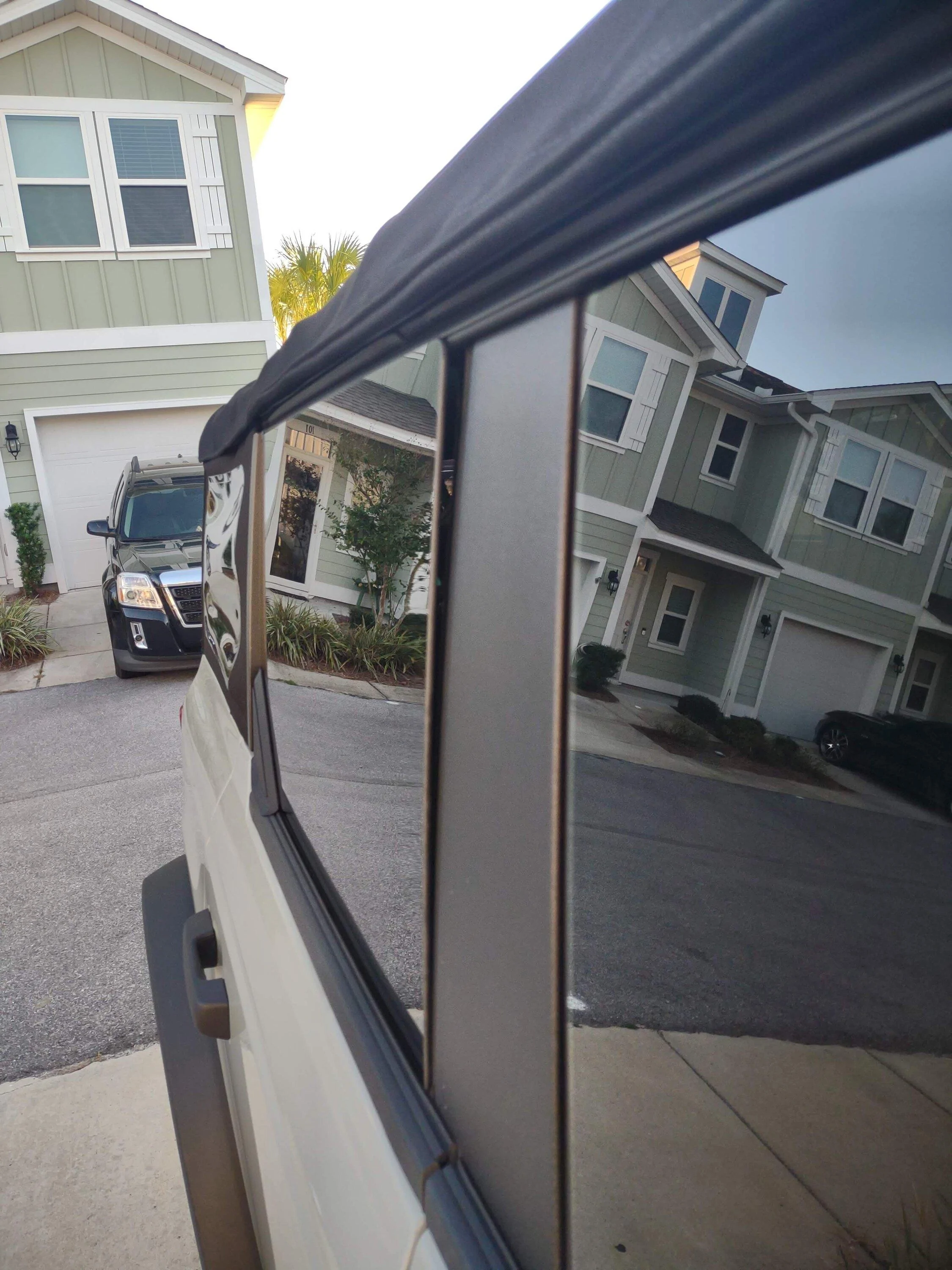

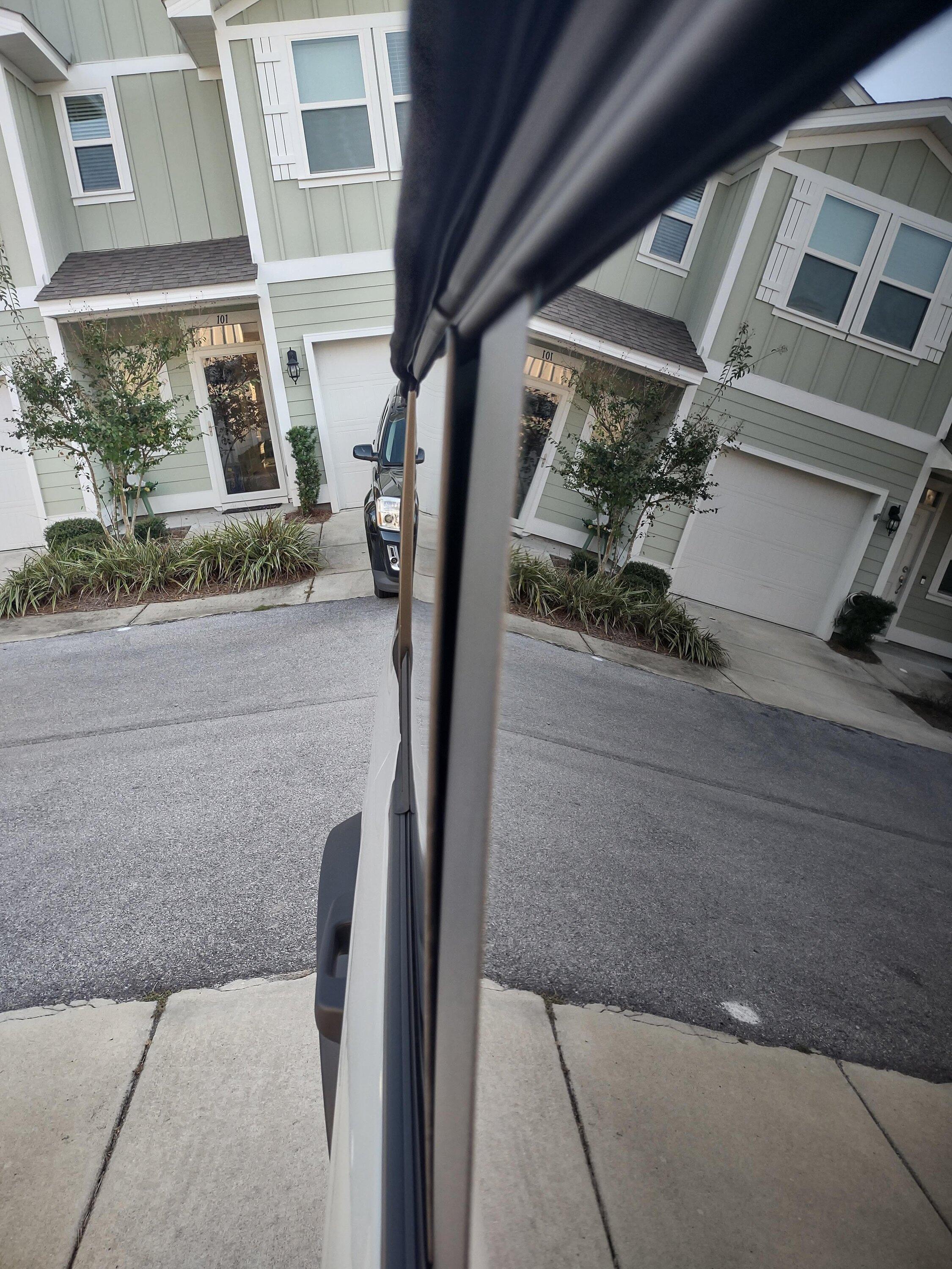

My passenger side rear is terrible. It will retract back down and not stay up, or it will go up 1/2" to far and leave a large gap. It does it quite often.

I get this scenario quite often as well. The rear passenger window occurs more often than the others. Often, its just roll down and back up, other times I must do the window “retrain” steps. I also get windows that roll up part way (even though the auto setting should go up all the way).
