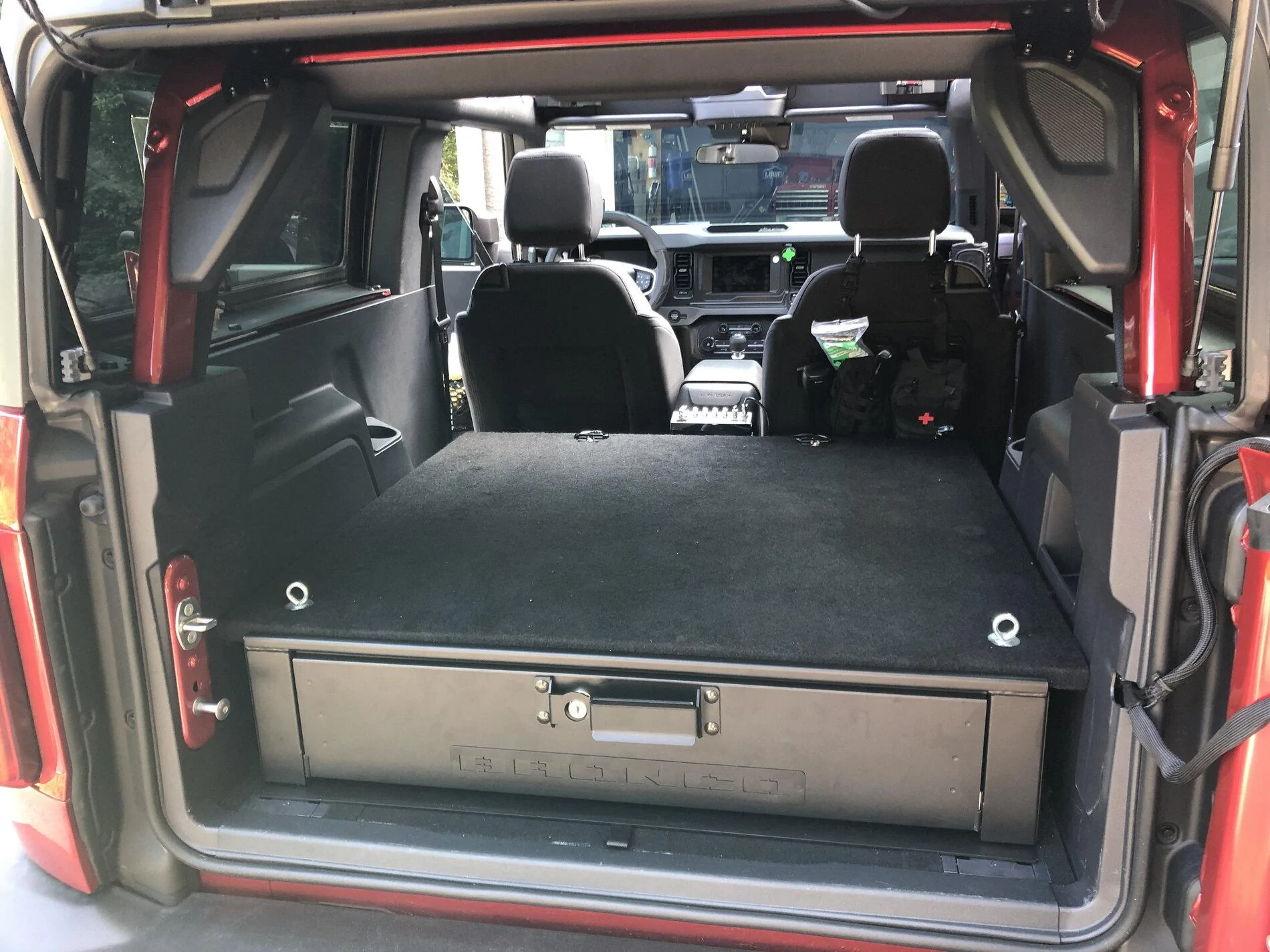

The 4dr and 2dr Broncos have very similar rear compartment sizes once you remove the 2dr rear seats.
The official Ford Accessory metal drawers for the 4dr fit just fine here. The front side bolts go right into the same factory tie down positions.

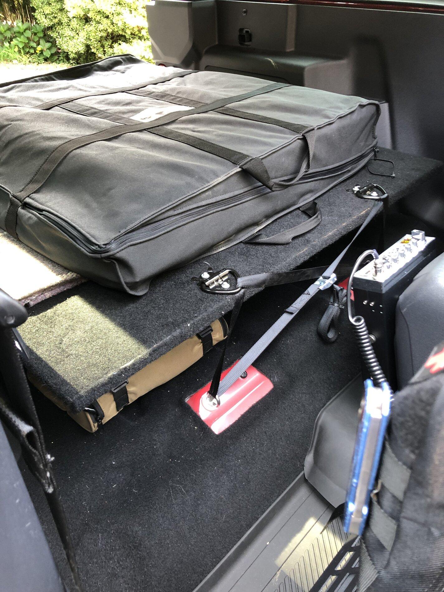

The floor on top is the original 3/4 plywood from my first build thread, that I simply moved to the top of the drawers. It is currently bolted into the top of the drawers in the front with eye bolts, and secured on the seating side with some straps until I build some other solution there.

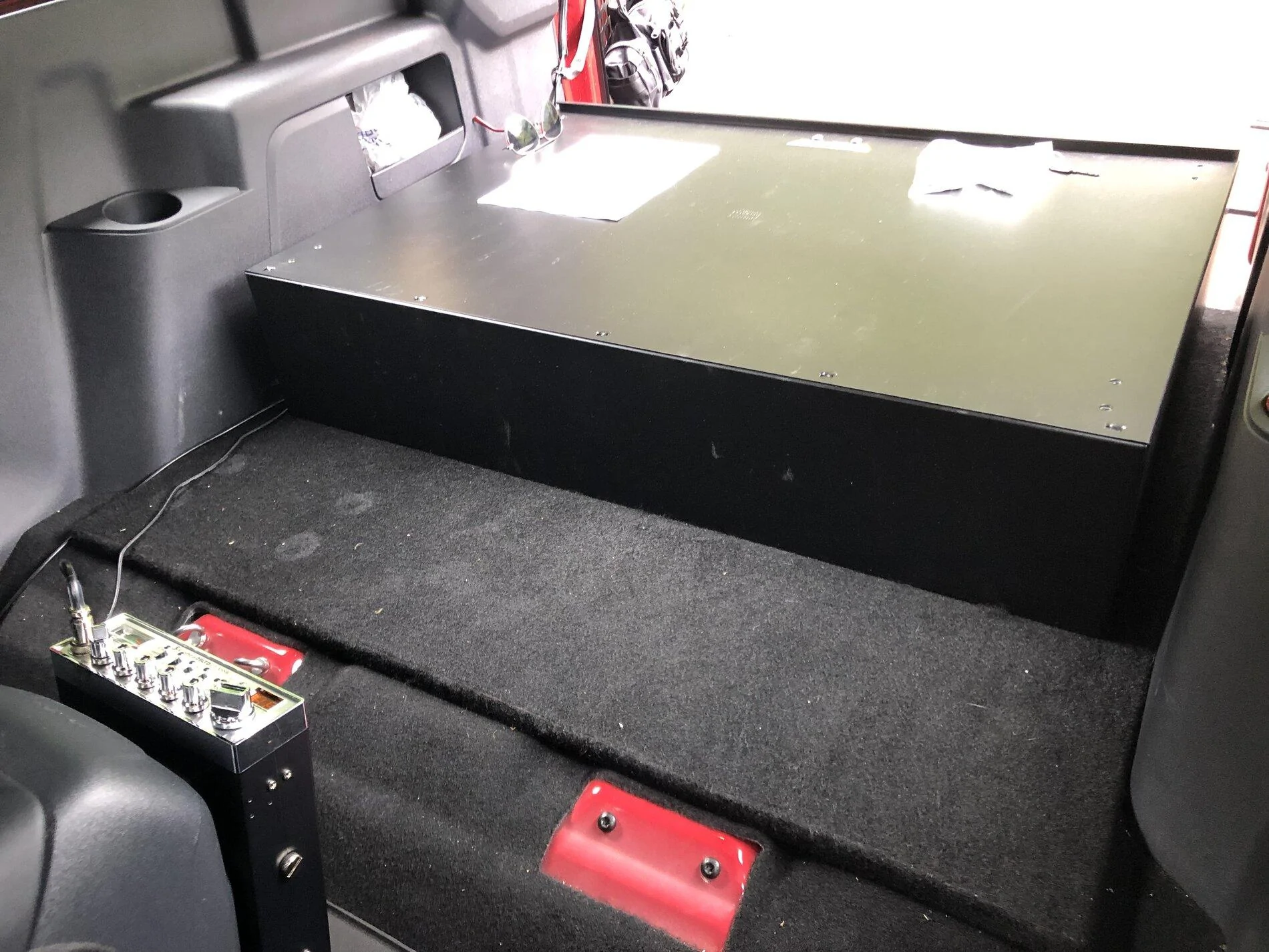

Do you have any pics of it without the box or seats? I'm thinking about removing the seats myself.

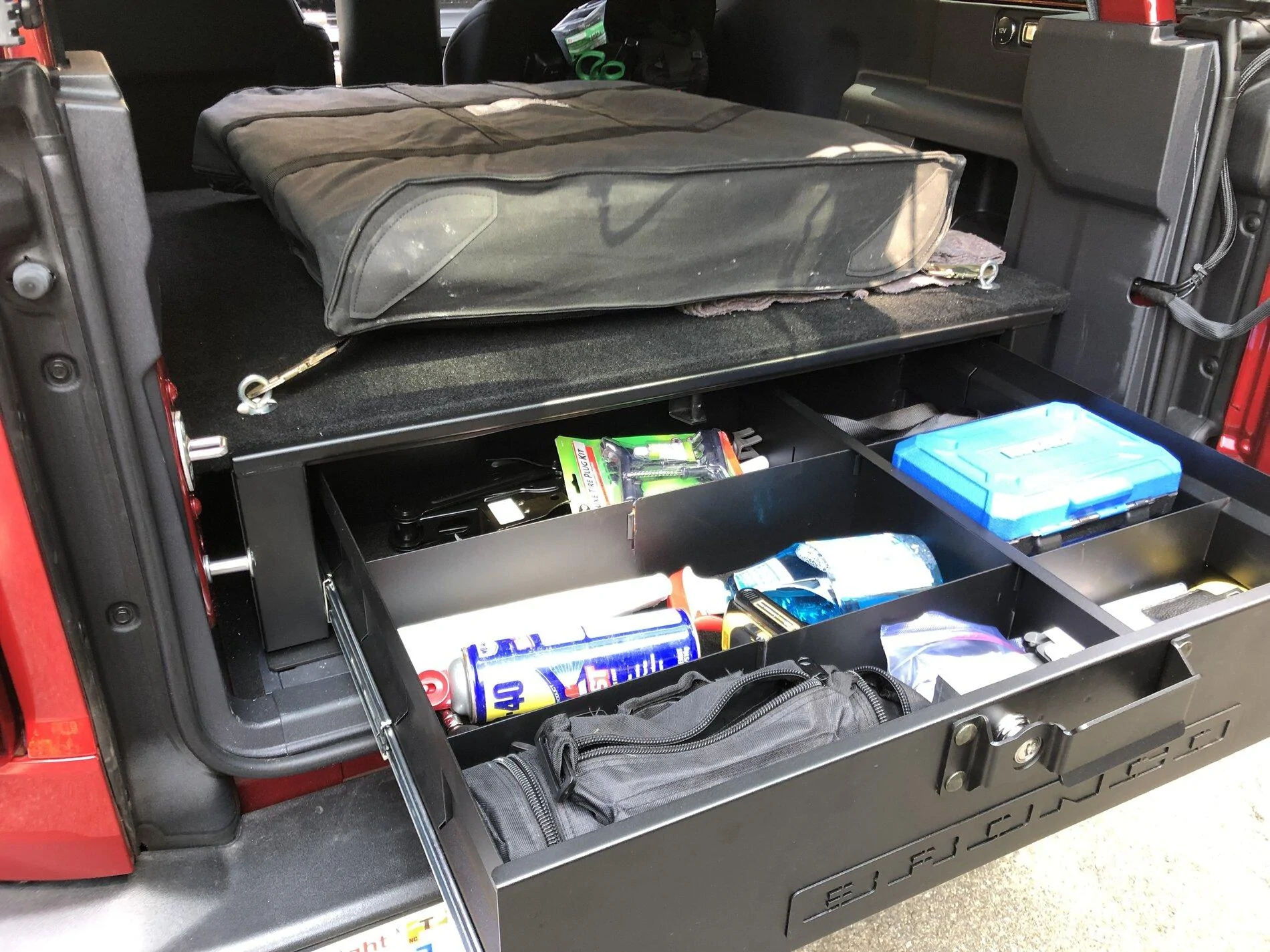

Yes, you can slide out the drawer bins/internals completely if you want, but you can't access the factory compartment without removing the entire drawer system (one of the drawer support brackets blocks the factory lid).
I removed all the factory emergency jack stuff from that compartment before I installed the drawers, and then just put those items into the back bin of the drawers themselves.

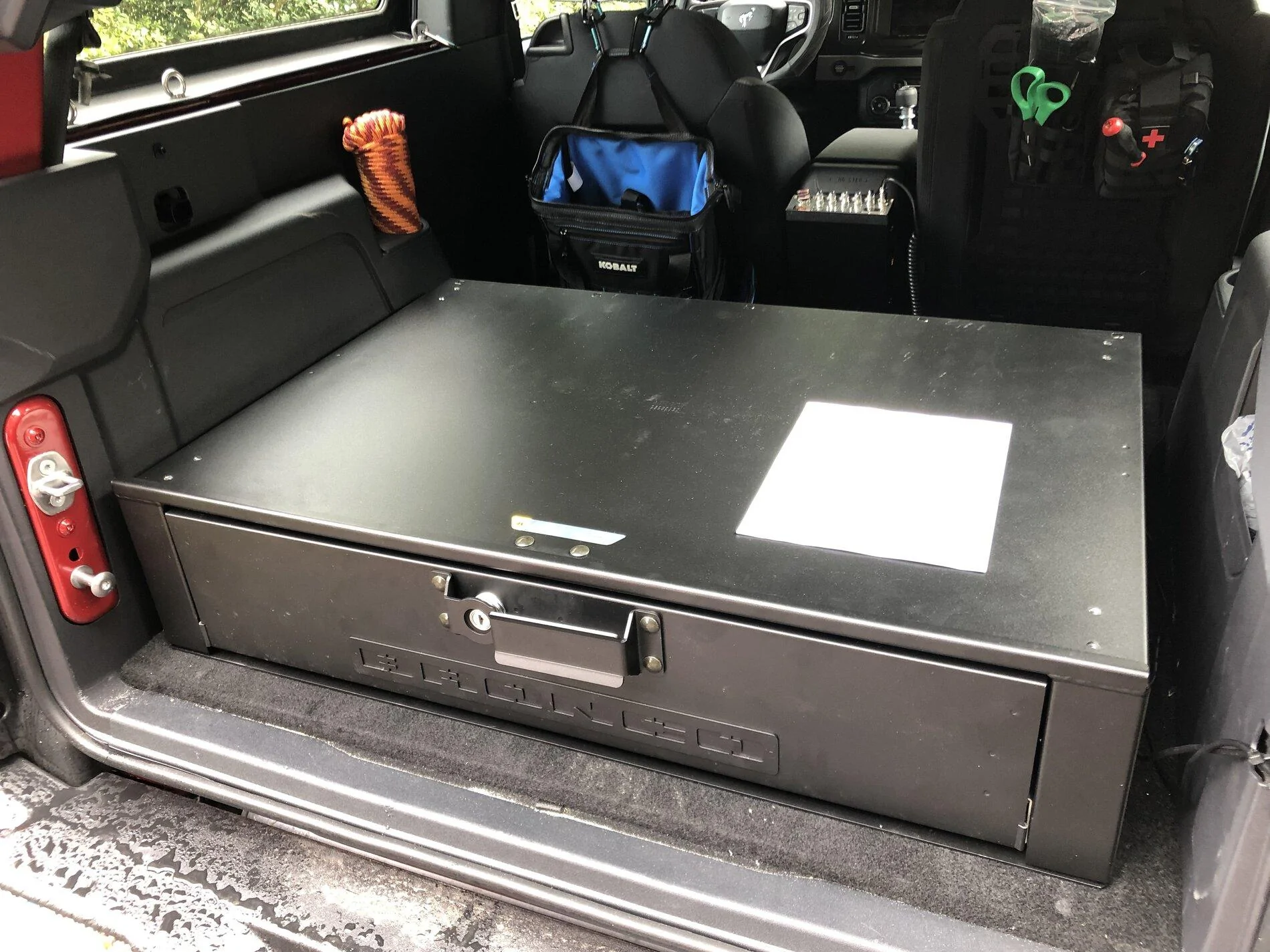

Do you have pictures of the drawer installed without the plywood on top?

This is from my first installation attempt, when I put the drawers on top of my original plywood floor. It looked odd. I didn't like the raw metal look of the top of the drawers.
Also, the drawers come with a 50 lbs load rating / warning for the top side, which is why it seemed better to put the plywood on the top as well.
