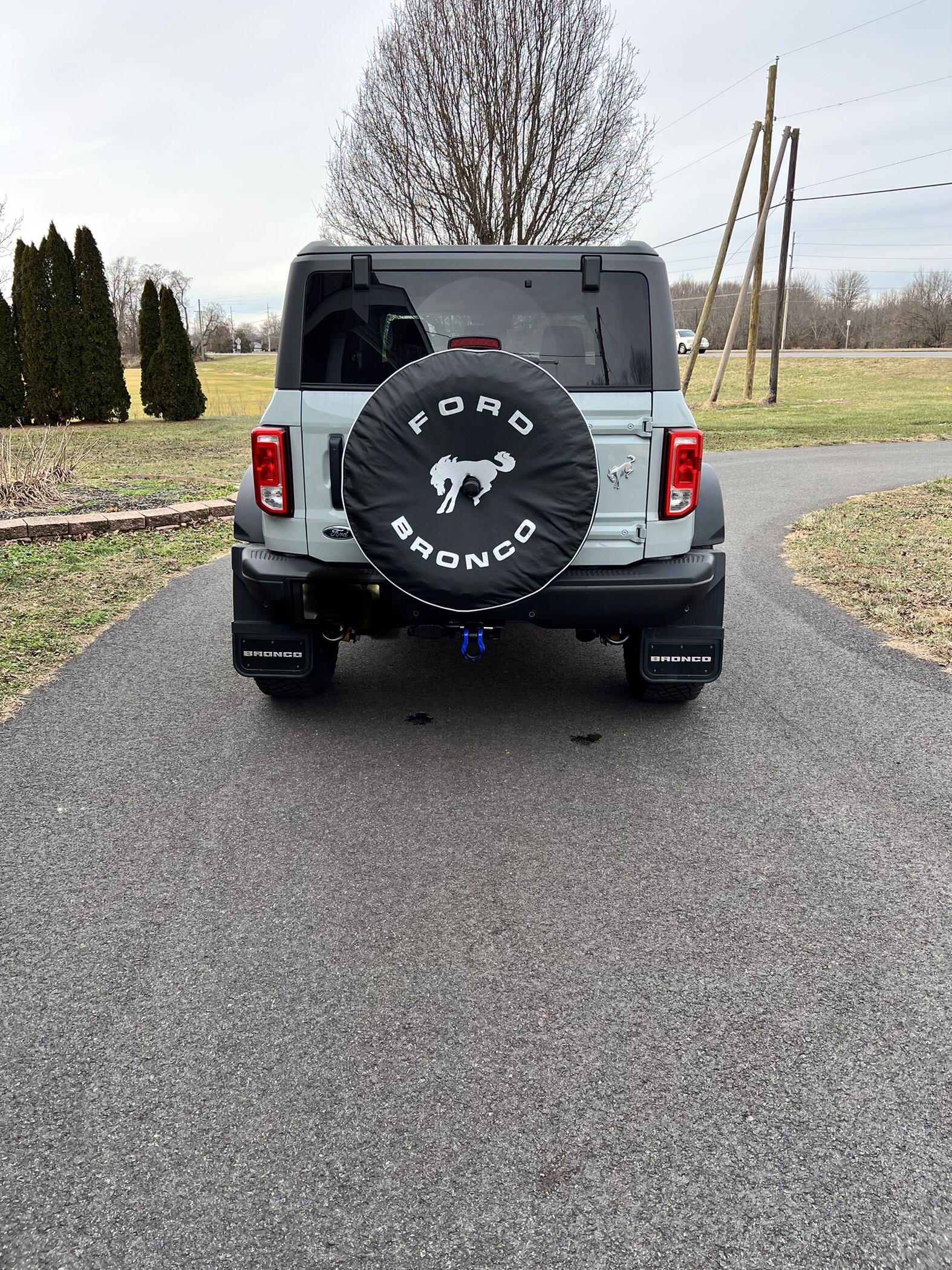

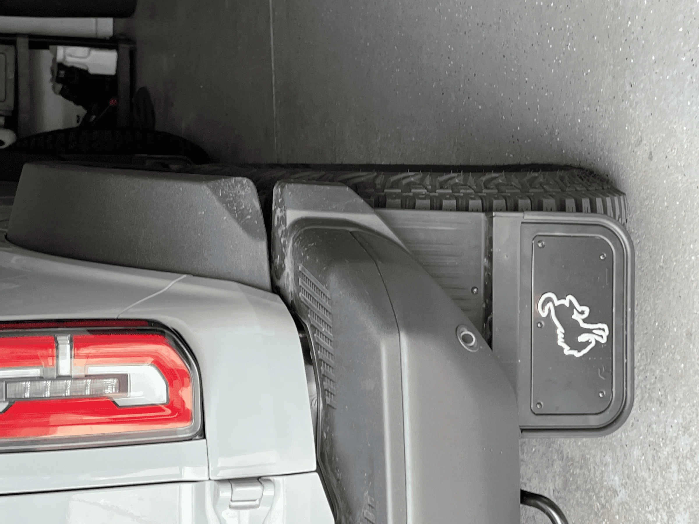

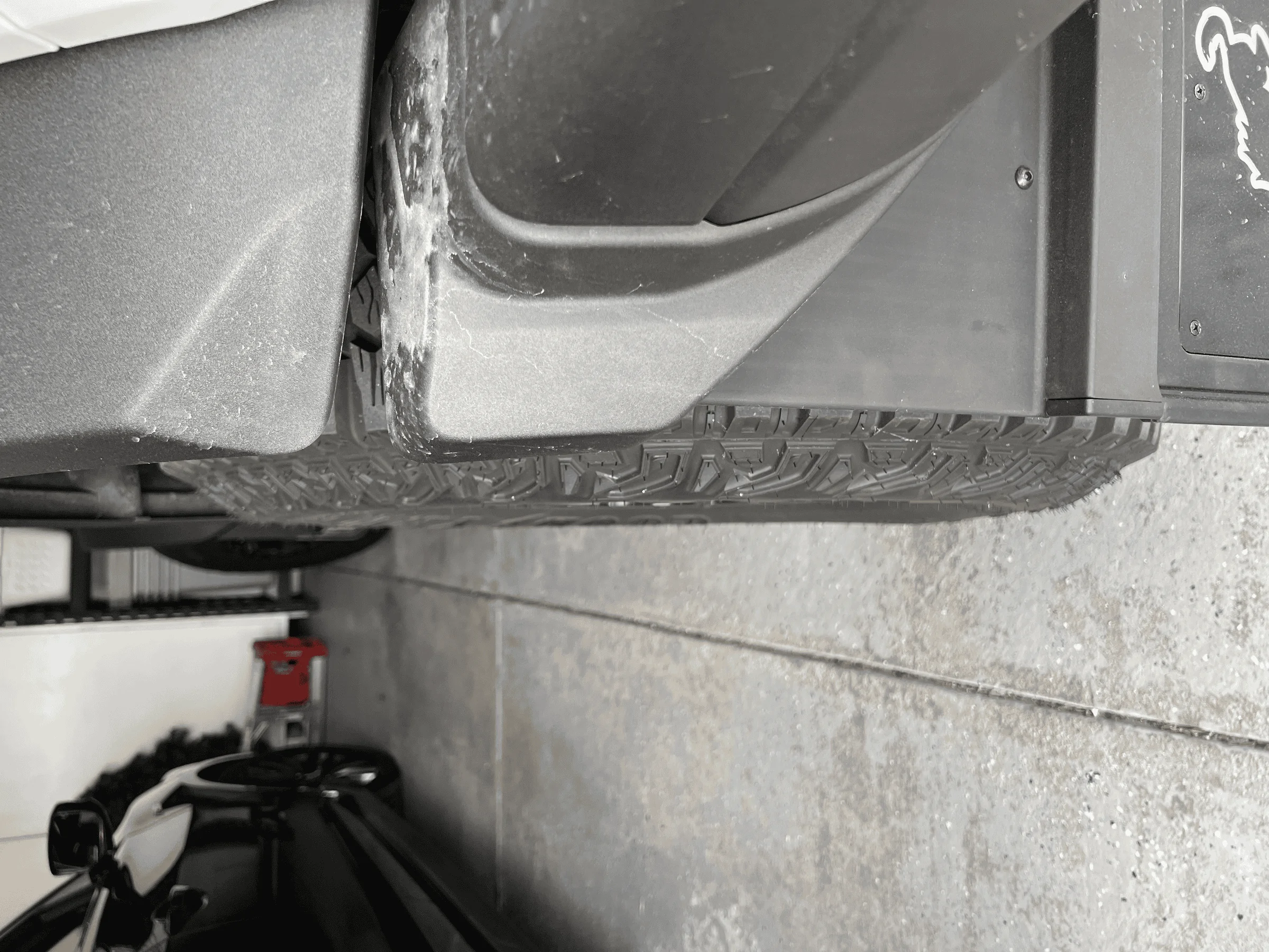

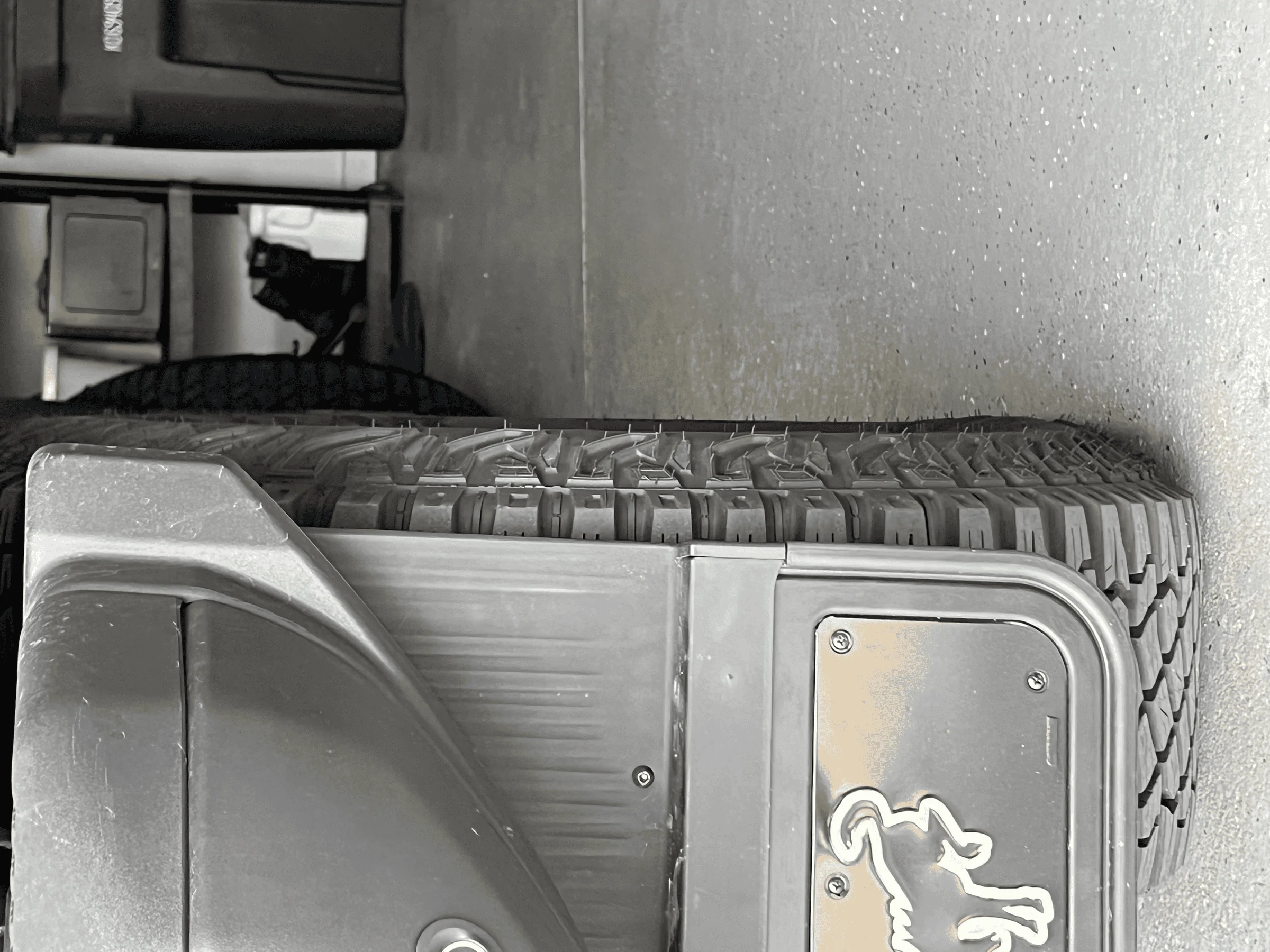

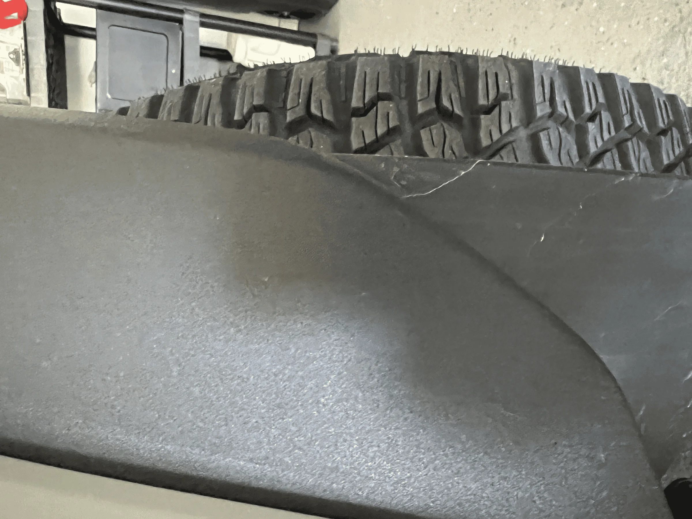

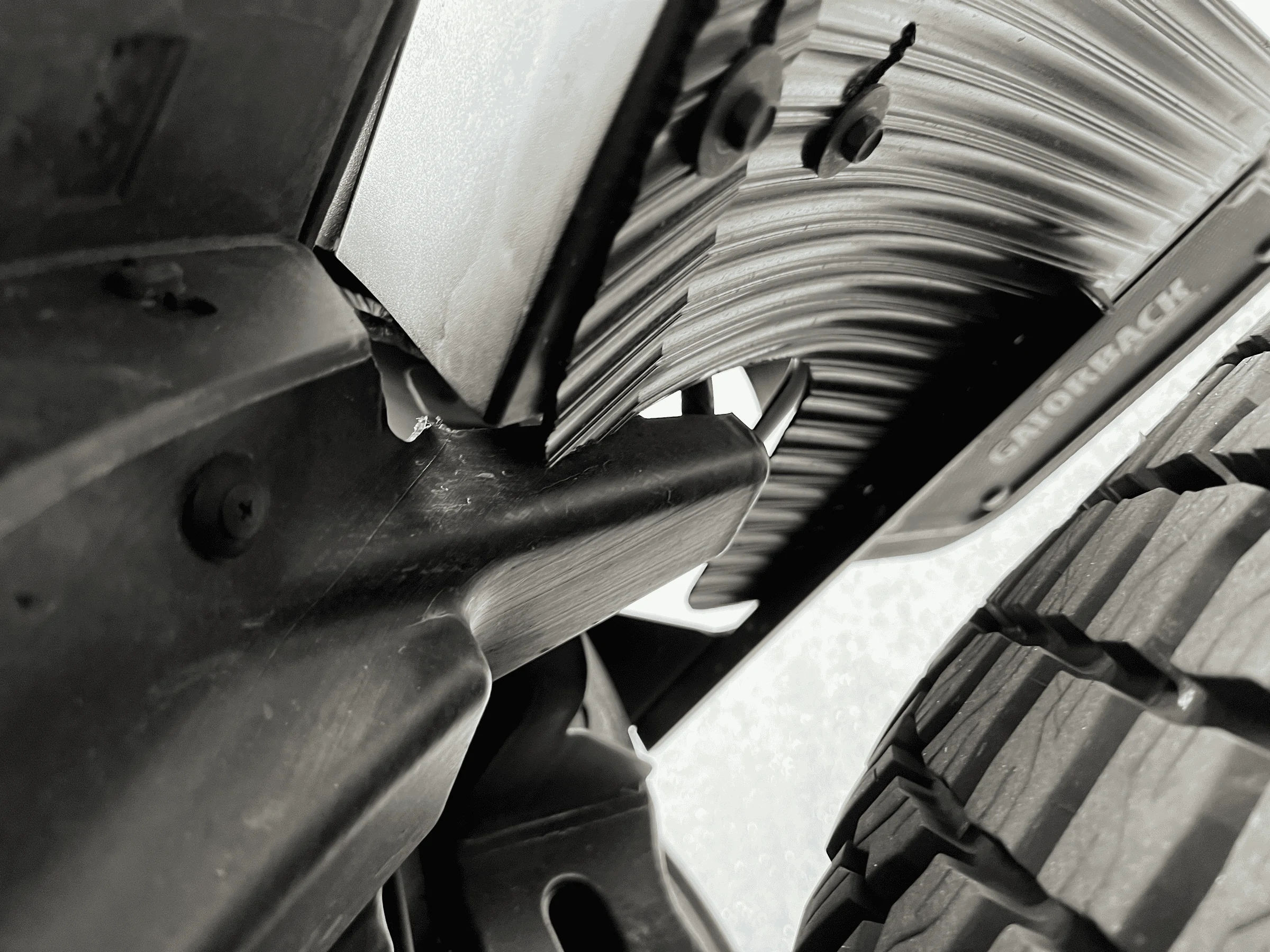

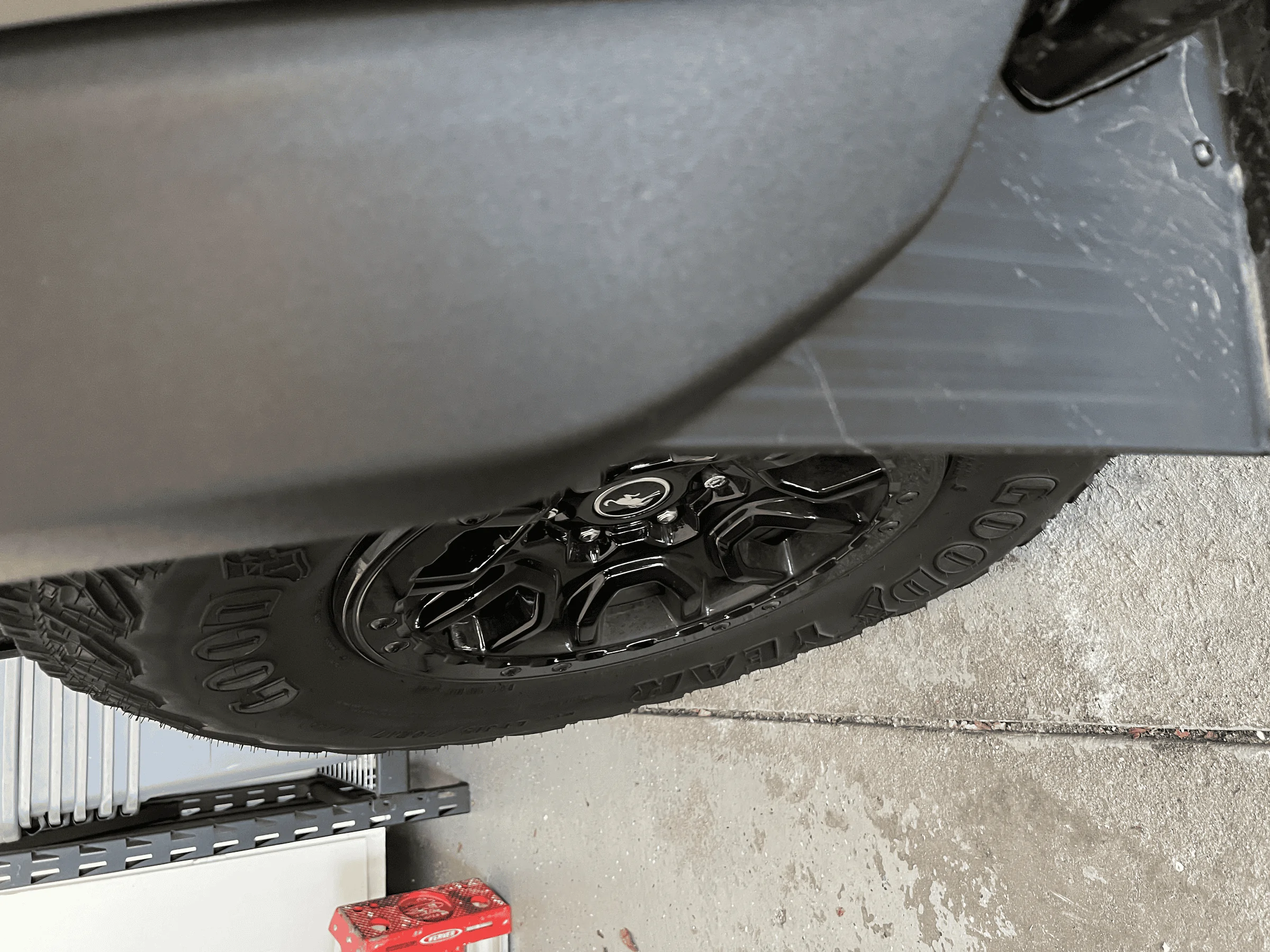

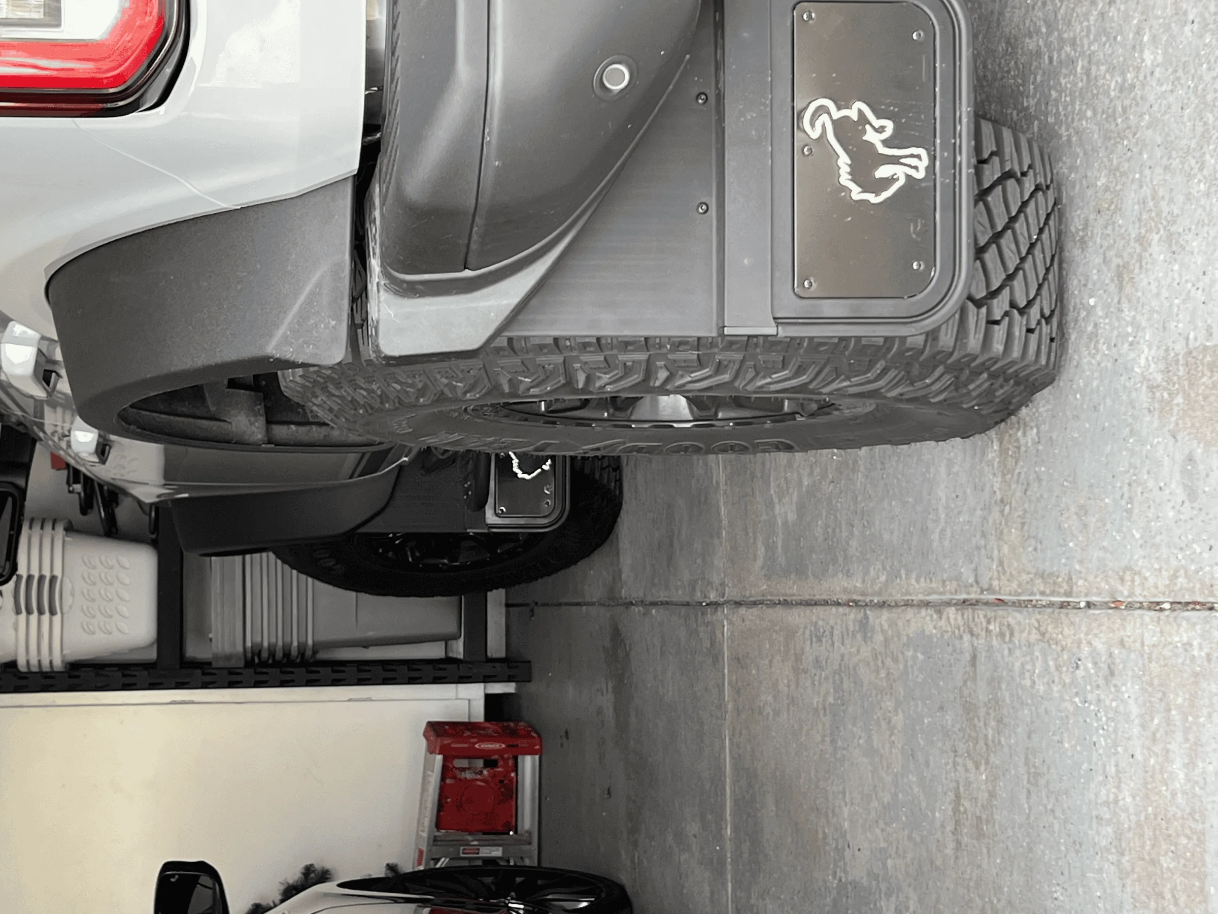

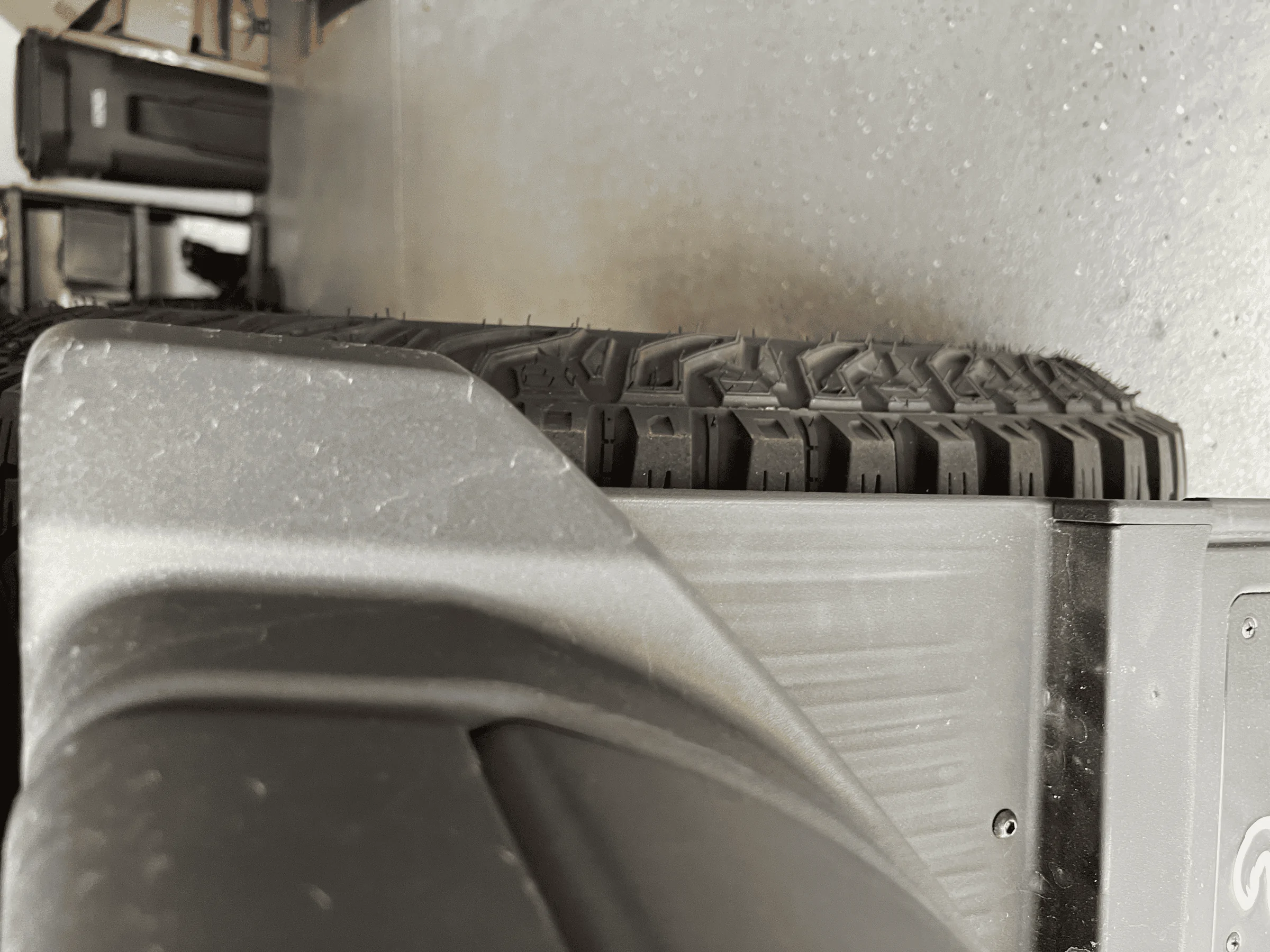

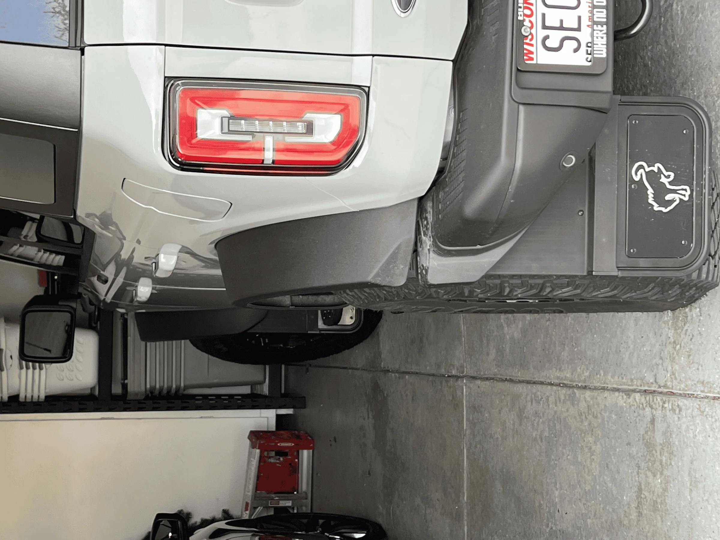

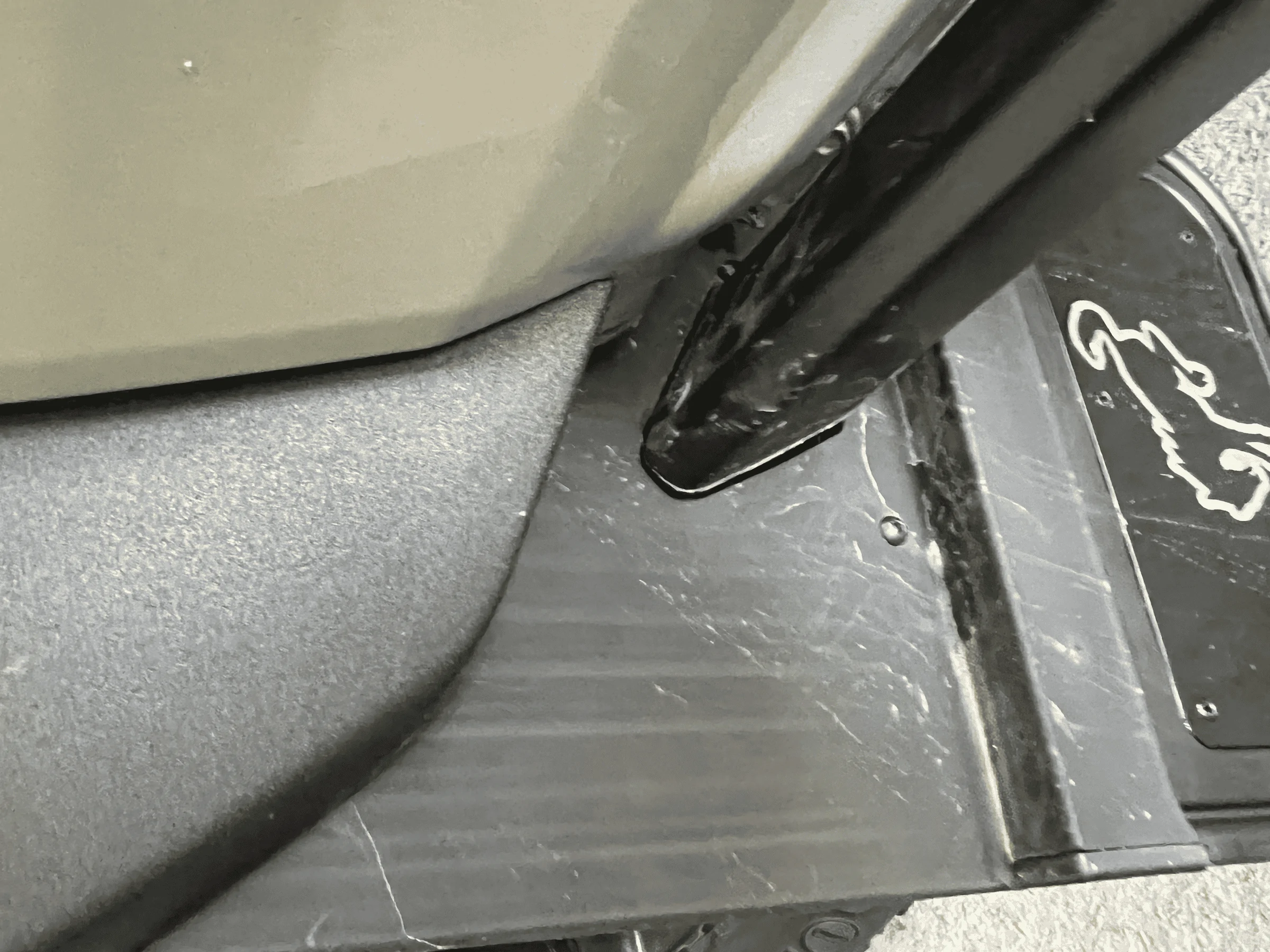

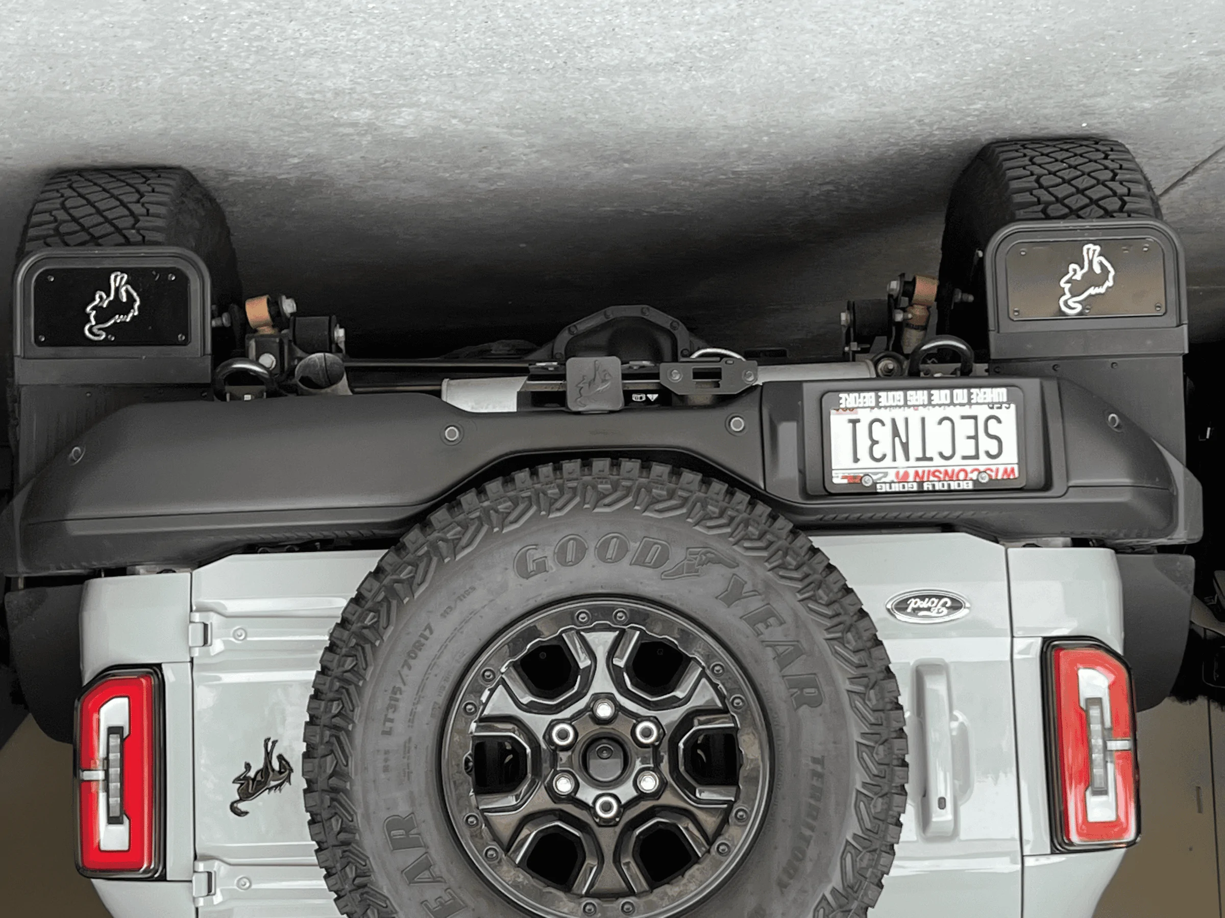

Here ya go. Measured. The back ones sit like 9.25 and like 9.75 off the ground. The front are both 7 something.

Dammit I hate when I put the pictures up the right way and they flip, arggh sorry.

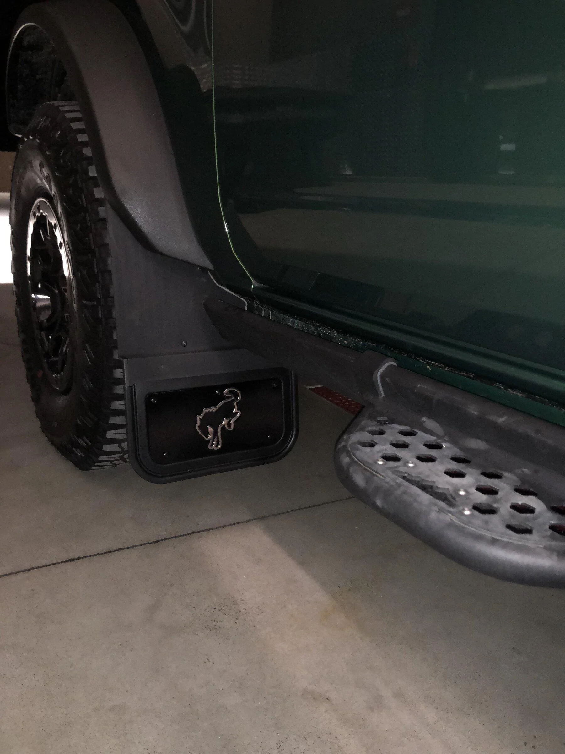

Just finished installing all of mine by myself. Their build up is a little erector set like but, the install was very simple! This is a dealer issue. Ford corporate has absolutely nothing to do with this at all and barking up that tree will net you nothing, sorry. Go meet with your service manager at the dealership. Be firm but, donā€™t be a prick.

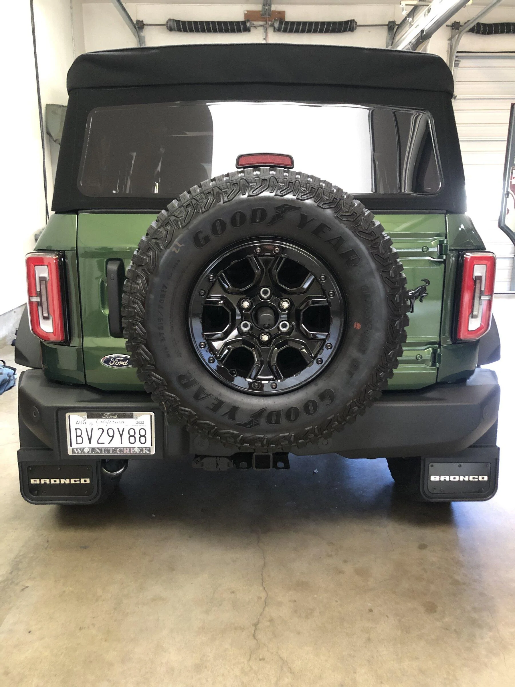

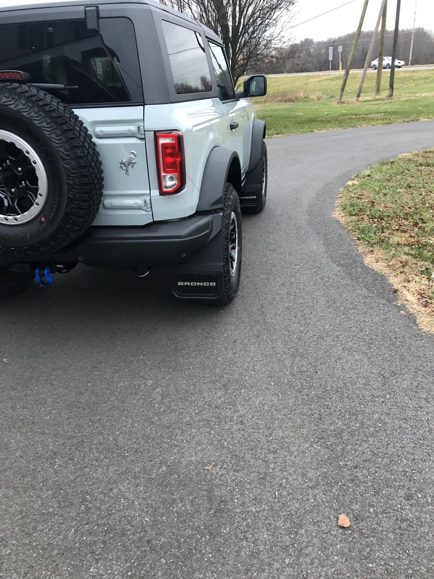

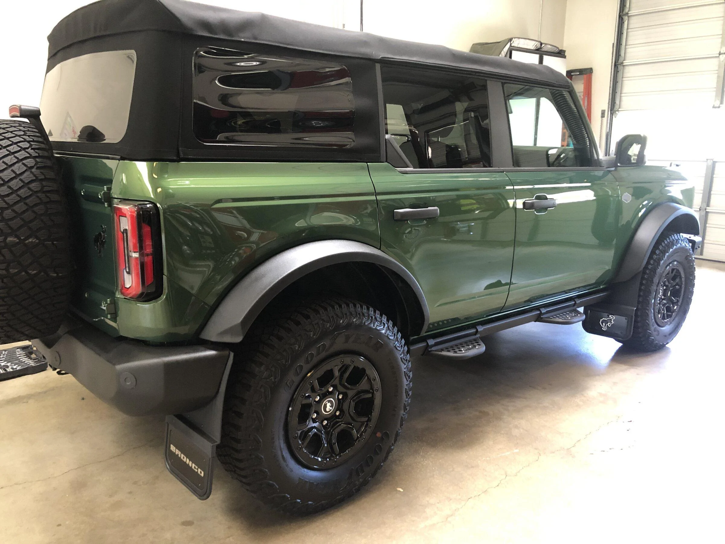

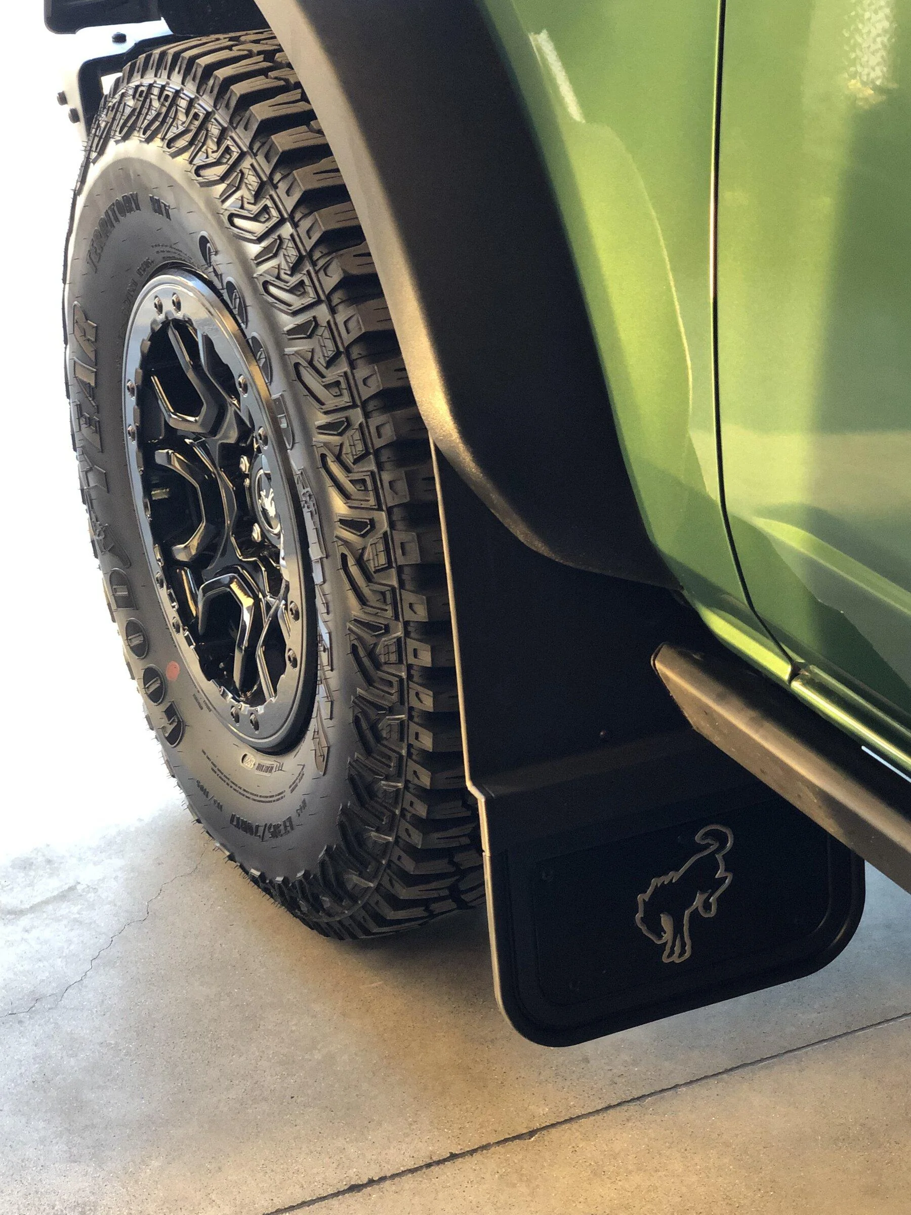

Your pics are fucked bro all flipped and shit this what they should look like installed the correct way

Second @Firefight911 . See the service manager, bring your tape measurer. Show them that they are installed at varying heights and from the rough looks of it protrude by different amounts as well (but that could be the angle). If the mudflaps are missing hardware or otherwise damaged from their install, bring that up as well.
For $300 to install, they should have no issues.

You can loosen the screws to slide them left and right. Regarding the height, itā€™s hard to screw that up since it installs onto fixed points on the bronco. Not sure why thereā€™s such a huge difference between the front and back.
My dealer did a pretty good job. The only thing I had to fix on mine was the rear passenger side which wasnā€™t level. But I think they were making a judgment call. Something with that corner of the bumper was off so they maxed out as much as they could without the flap being exposed. I took it home, dremeled about 5/8 off the top of the flap and reinstalled it and itā€™s nice and level now.
On a Sasquatch I think itā€™s about 10.5 off the floor for all 4. Itā€™s been awhile but thatā€™s the number I remember.
