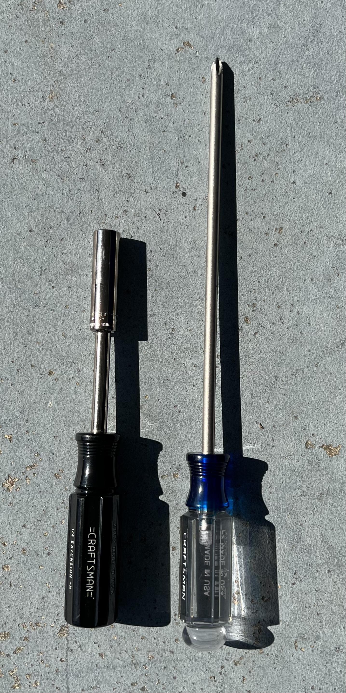

Fix worked like a charm. Not only did it get rid of the window rattle, it also got rid of the high pitched whistle when the window was cracked an inch or so.
So what I did is use a long 10mm socket on a 1/4" nut driver. After I loosened the nut I used a long screwdriver behind the clip to get leverage to push it outward and hold while I tightened the nut.
Simple fixes are great aren't they? To think I listened to it for six months.
